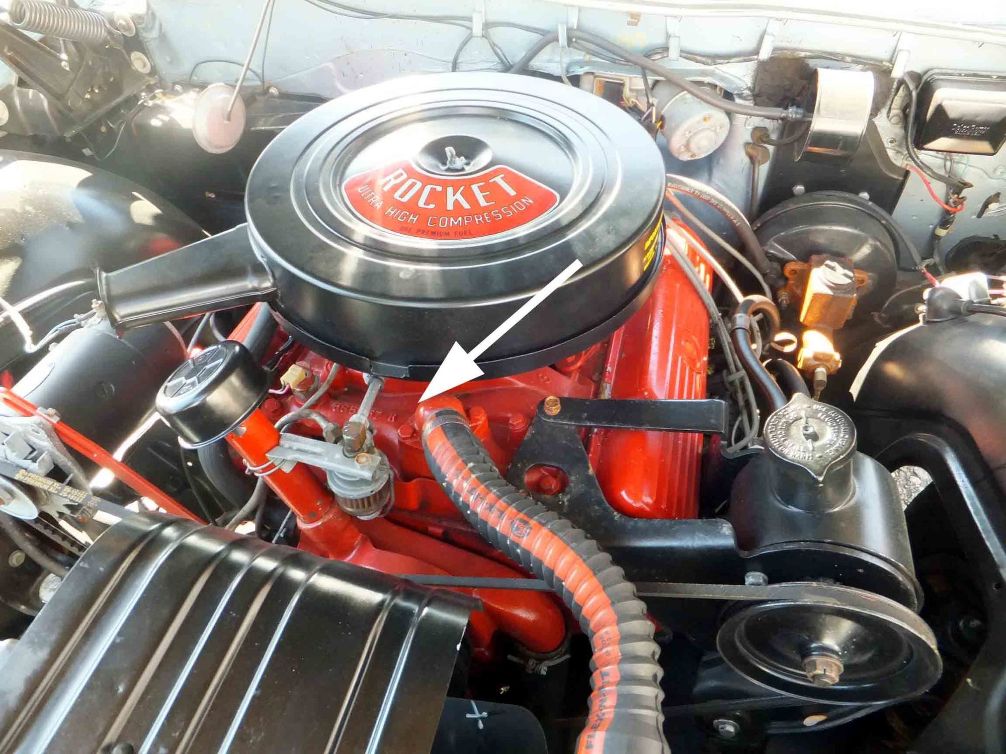

The 1962 fuel filter is a glass bowl type with replaceable element. It mounts in a bracket that attaches to the oil filler tube, like so:
You'll see it has steel lines from the pump to filter and filter to carb.
Don't you love fooling with 60 year old stuff that no telling how many people have had their fingers in it?
My guess is either the glass bowl broke or someone couldn't figure out how to open it and change the filter. Those type filters have never been out of production and every garage used to keep the glass bowls in stock.
Yeah luckily they didn't hack too much stuff, that I've seen, but yeah parts are rare if they even exist so the stuff they did throw away, well, it's gone I suppose.
The manual mentions fuel filter but I have yet to see a pic or part number so I was stumped
RA lists the element but not the bowl.
