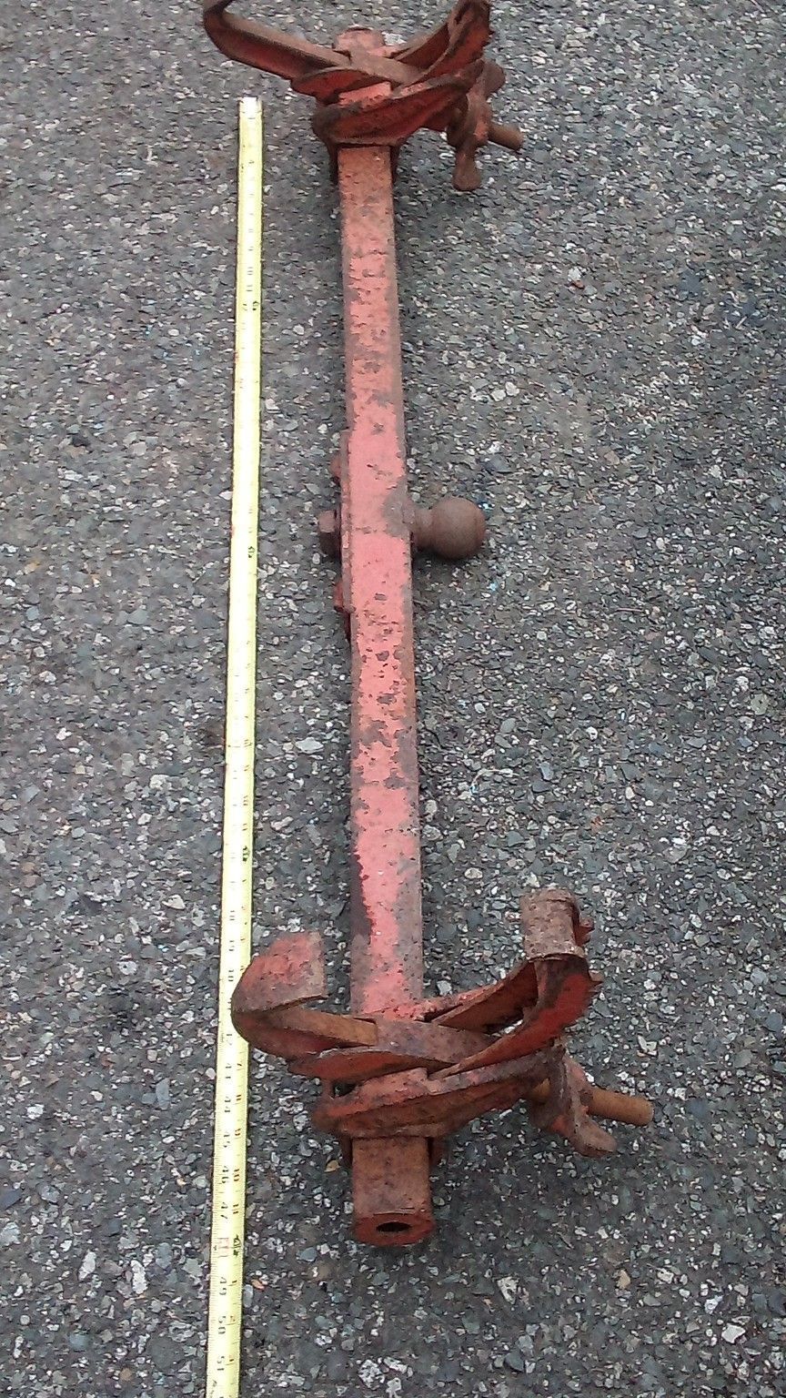

RPO U89, Wiring Harness, Trailer Electrical. A $10.53 option for 1968. Olds did not offer a trailer hitch from the factory. You needed to have that installed by the aftermarket if you wanted to pull a trailer. There were also "clamp-on" hitches available for lightweight trailers that did a good job of bending the back bumper.

Joe - Great feedback. Yeah, those "clamp-ons" were the unfortunate go-to hitches back in the 60s early 70s for us cheap kids w/ no $$. They were great for bending bumpers.

I cannot imagine clamping that bumper hitch to a 68 - 69 or any bumper I cared about !!!!
