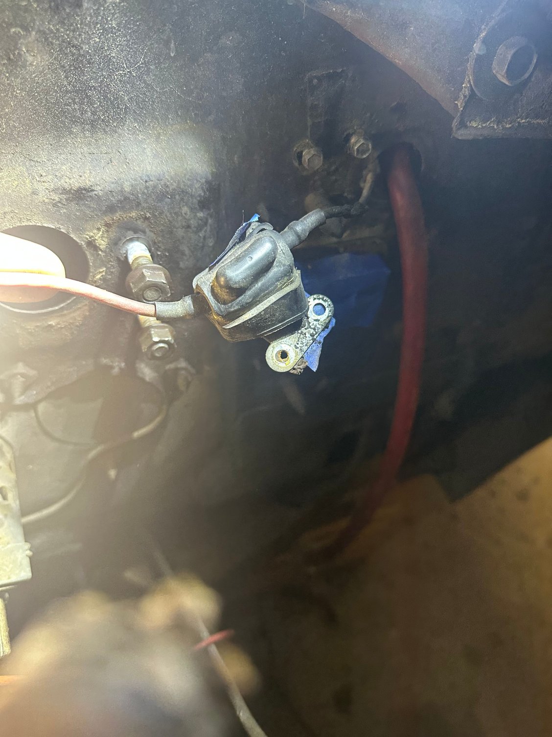

What is this
Trying to figure what this relay is

1971 Olds Cutlass Supreme Convertible. It is right above the bulk head go thru the firewall orange wire with black stripe

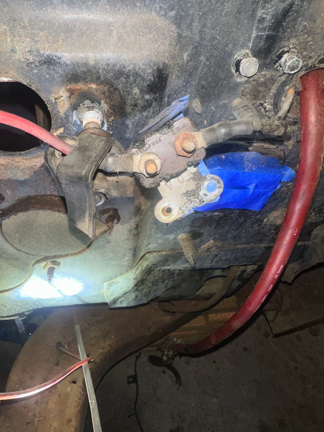

It’s not the horn relay on the fender. It bolts up to the two screws above the blue tape which is the bulk head. Painting my fire wall and I have a new under hood harness and don’t know what this is

It's a circuit breaker....I'll post an image in a minute.

Might be a circuit breaker for the convertible top.

FYI, a relay needs at least three wires to operate. This is a circuit breaker, used on high-current accessories like power windows or power seats.

Yours is rather mangled. You can purchase replacements if needed.

It's rated at 40 AMP
