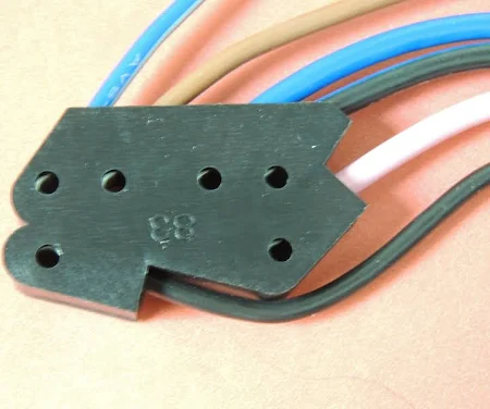

1962 Starfire, how do you clean the female flat connectors for the window switches

I thought the window switches used pin terminals, not flat ones. Can you post a photo?

I didn't know the correct nomenclature, sorry. How would I clean the female pin connector

It kind of depends on which connector style you have, thus my question. GM power window connectors tend to look like this.

That's what I have in the Starfire.
I have sprayed contact cleaner into the female half of the switch, connected and disconnected several times and have good continuity through the connector now.

These plastic connector bodies do open up. If you look closely at the edges, you will see seem with a few small lock tabs that snap into place to hole it closed. Be careful that once open, all the wires and terminals will come out, so be sure you know what goes where. The terminals inside the connector look like this. New ones are available.
This is the style for wires coming out the sides.
This is for wires coming out the back.
