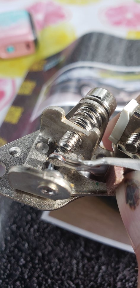

Evening all, looking for a little advice!
Pulled the points out of my '66 Toronado just to do an inspection after I found a damaged distributor cap (the button was broken off) and I took a few pictures. Does this set of points look damaged to you guys? I really have no experience inspecting points but it looks to me kinda like the center section of the side that doesn't move is welded to the movable side? Maybe that's normal for these things? I thought this set was new when I put them in but I'm really not sure if they were new now that I look at them. The stamping says "made in USA" so I assumed they were good quality.

They should be fine and look normal enough. Used points should be gapped/set with a dwell meter, not a feeler gauge because the feeler gauge cannot account for pitting in the surface contact area that can be seen. It's best to always set them with a dwell meter anyway. A film of cam lube on the distributor cam helps slow the wear of the rubbing block which changes the dwell and the timing.

I recall days past (1950s - 1960s) when you bought any set of contact points for any application i.e. tractor, car, truck, motorcycle, etc. blah, blah. There was never a hole in the middle of either the stationary side or the cam (moveable) side. Then, supposedly Blue Streak STANDARD design to provide some unknown cooling (which I never bought into). First, there was hole in the middle on one side only, then contact points were manufactured w/ a hole in the middle on both sides (AC Delco, Excel, BW) they all appeared to copy this notion. Hey, if you can save a penny here & a penny there I guess it all adds up.

Many aftermarket makers used these "ventilated" points, perhaps as an advertising gimmick, or not.
GM did not follow this thinking evidently. I've never seen a set of OEM Delco points with a hole.
The only thing I do see is a misalignment that is causing the points to contact on only one side.
The moveable contact is probably bent.
Points are cheap, and not worth screwing around with.
Toss them in the trash and get a new set.
They should be replaced every 10.000 miles.

Its been a very long time. 70 Buick GS had dual point distributor. Dad would use a matchbook's striker to clean points. Always side to side. And not let the point touch until he clean them.

This is just me, but I think those points don't look too bad. All they need is to be "resurfaced" so both sides are more flat and perpendicular to each other so that when they are touching there is the most contact surface possible. In the old days we would slide a piece of 1200 grit sandpaper doubled up on itself with the abrasive sides out between the points, let them close, then draw it out. Doing this about five or six times would accomplish the job. Some people would steal their wive's cardboard nail file and do the same thing but that is a little more abrasive and wouldn't take as many strokes. HighwayStar 442, your idea of the matchbook striker is a good one too.

Ok good stuff, thanks everyone. I haven't seen enough sets of points over the years to develop any kind of reference for worn out or damaged ones. I put the old set back in for now (they appear to be original Delco ones) and will see about getting some NOS ones.

I'm w/ Charlie. For the cost of a set of contact points why resurface any of them &/or question their integrity. Toss them and buy a new set. Install a new condenser at the same time. Contrary to seemingly popular belief(s) a contact points condenser is NOT to eliminate radio interference. A contact points condenser traps runaway/over current(s) to prevent arcing across the contact points (increasing longevity of the contact points). Additionally, the contact points condenser assists in the immediate shut-down of electrical current between each opening/closing of the contact points rendering clean efficient current delivery each time the field collapses.
