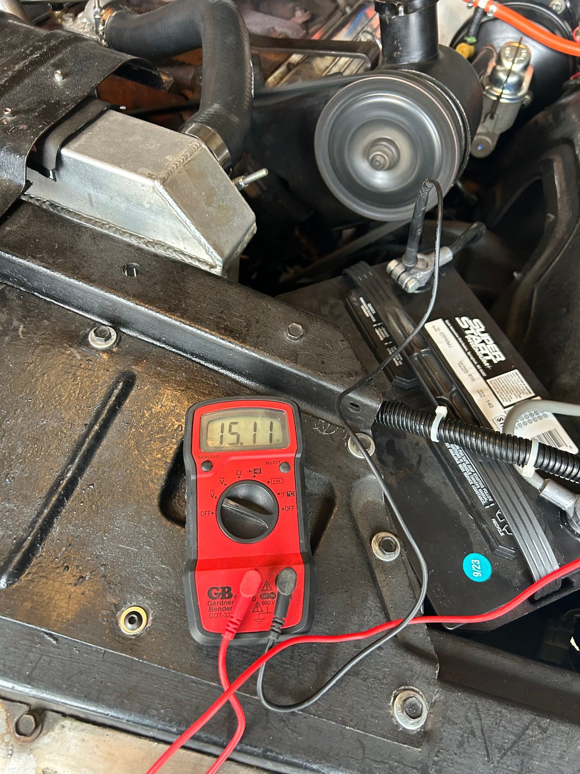

Alright guys, more help with the '61 Olds 98.
The GEN light has been on for a few years. I have been through a couple voltage regulators. I have also had the generator rebuilt.
The most recent issue has been sluggish, stalling driving and sporadic sputtering. It ended up being a bad regulator because when I replaced it, it ran perfectly fine.
The issue I have now is that the GEN light is ALWAYS on when the car is on, fully lit, and I measure the voltage at the battery and I get upwards of 15 or more volts and climbing.
Could this be the voltage regulator? Could it be the wrong amperage? My vehicle without factory air utilizes the 35 ampere regulator. I believe this is what I have in there but would it hurt to buy a new one and swap it out to see if the GEN light goes out?
Any other ideas on the GEN light being on all the time?
Thanks guys!
Old Jul 27, 2022 | 07:26 PM
Posts: 42,475
Chances are the regulator is bad if you're getting 15+ volts.

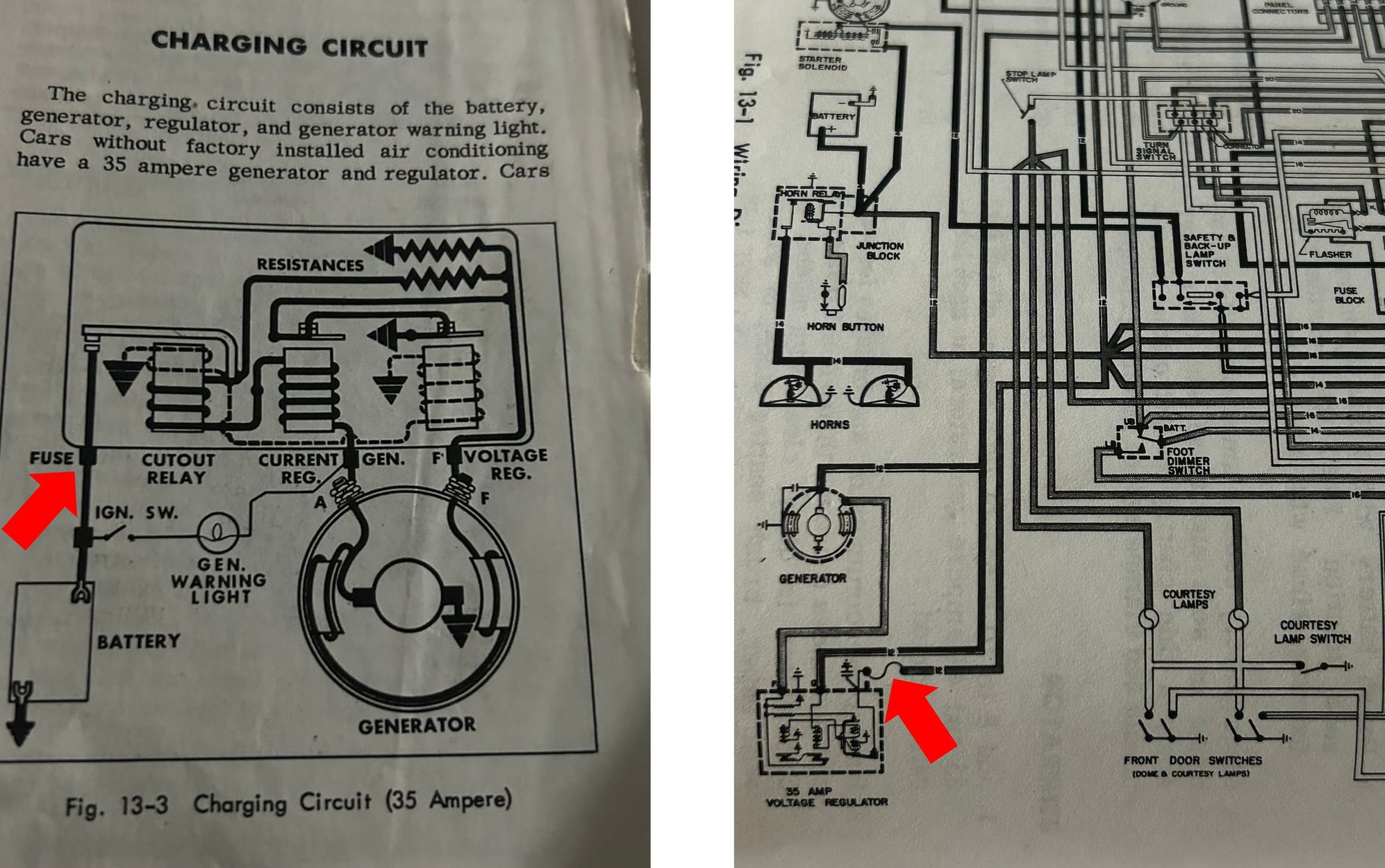

Ensure you polarized correctly - pretty simple. Here's the URL link and dialog >>POLARIZING THE ELECTRICAL SYSTEM
momentarily connect a jumper wire between the ARMATURE terminal and the BATTERY terminal at the regulator
If you notice in the other thread, I highlighted w/ arrows the two terminals to polarize your GEN via the VR.
EDIT: What you're doing is training the GEN to move voltage in the correct direction. What I do, is disconnect the wires from the VR. Then reconnect the wires, then polarize.

Not 100% sure on a 61, but 63s and I think 62s have a generator lamp relay. Time to get out your FACTORY wiring diagram and CSM.

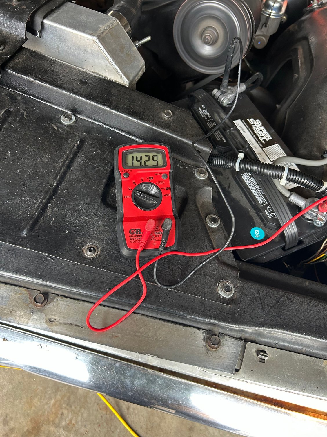

I just got back inside from the garage, it's a drizzly 40 degree evening here in MN.
The battery has been disconnected. I disconnected all three wires from the VR. I removed the VR from the firewall. I made sure there was good metal to metal contact between the VR and the firewall. I tighten the VR up to the firewall. I then reconnected all three wires, left to right (looking head on at the VR), BATT, ARM, FIELD. Once all were connected properly, I connected the battery. I used a 12 gauge wire to jump the BATT and the ARM terminals. Rubbed the wire slightly and it sparked nicely. Started the Olds, and she was running rough, then evened out. Even lower voltage than before; with the idle settled down, and nothing else on in the vehicle, 12.4 volts was the highest, even after upping the RPM's. GEN light still on.
Do I completely replace the VR and start there? Could there be something going on with the fuse block and wiring near the ebrake pedal? I am at a loss. This GEN light has plagued me for years.....

See if you can validate or invalidate if there is a generator lamp relay located on any of the wires emanating from the generator as suggested by rocketraider (post 14). I'd assume it most likely is indicated with the term relay, but maybe not. At any rate, you need to focus in on the generator portion of the schematic. You can take another better picture (would help) showing the generator and wires to/from generator. I think the VR is directly below the generator in the wiring diagram? See if you can see/validate where the generator lamp relay or any wire leading a generator lamp light/bulb (which would reside on the dash panel). Odd yours is B&W - I would have suspected a color wiring diagram.

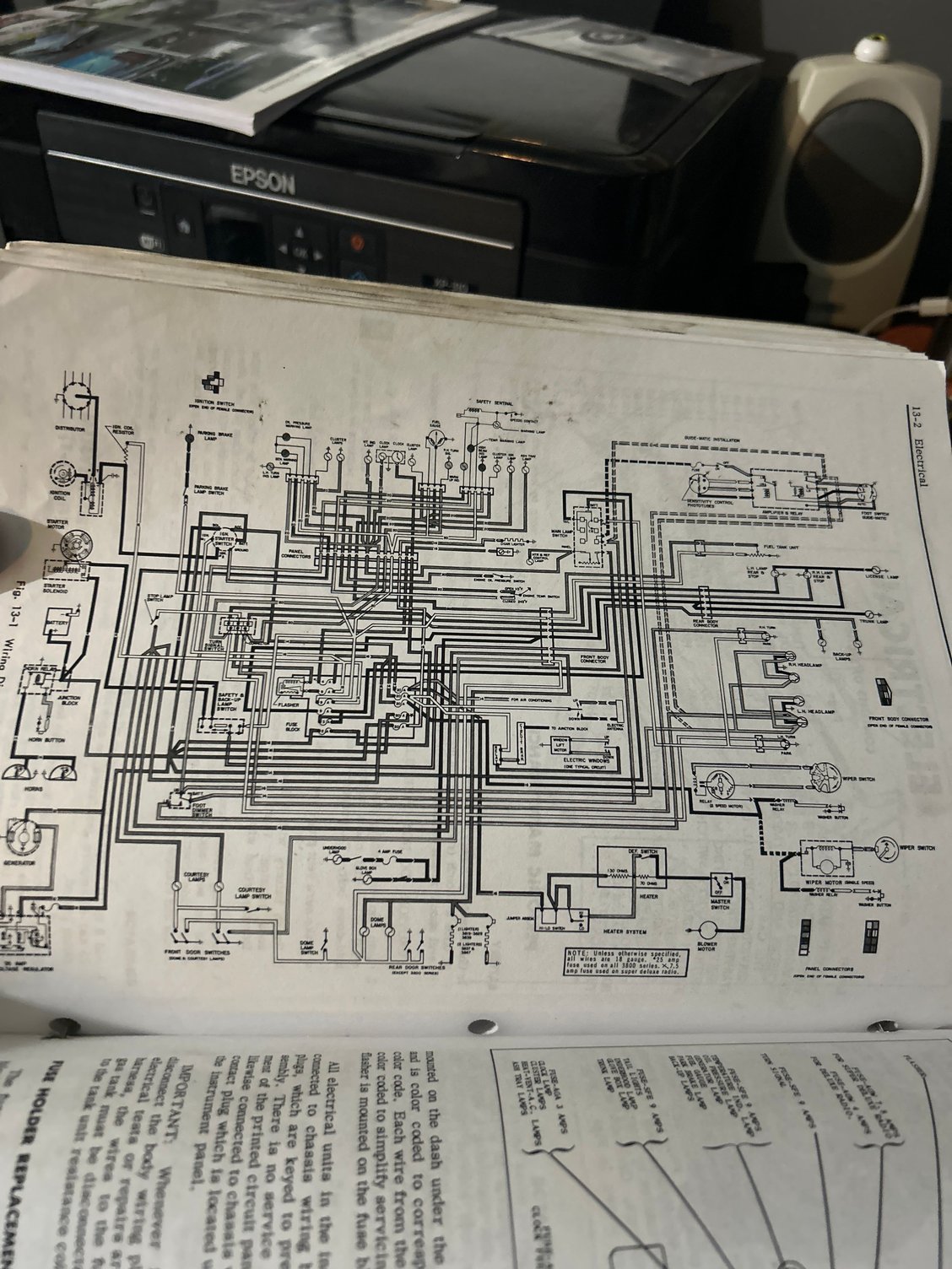

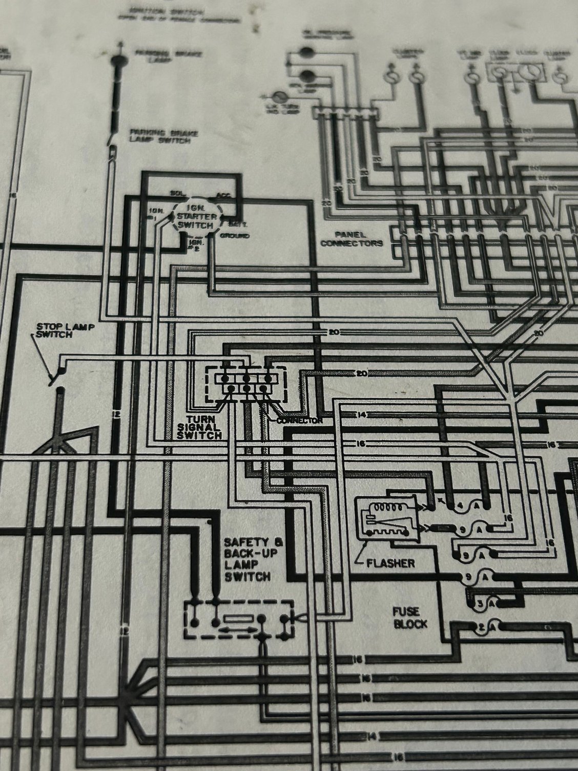

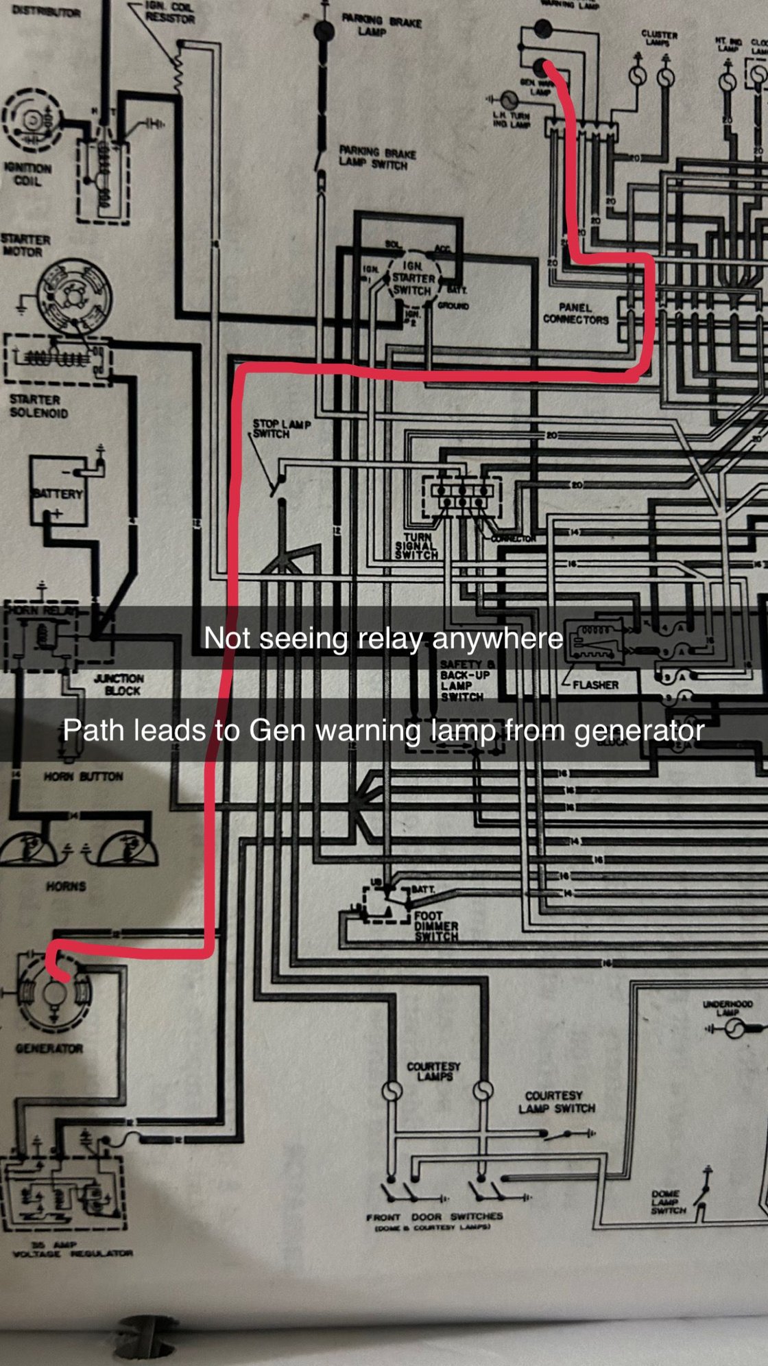

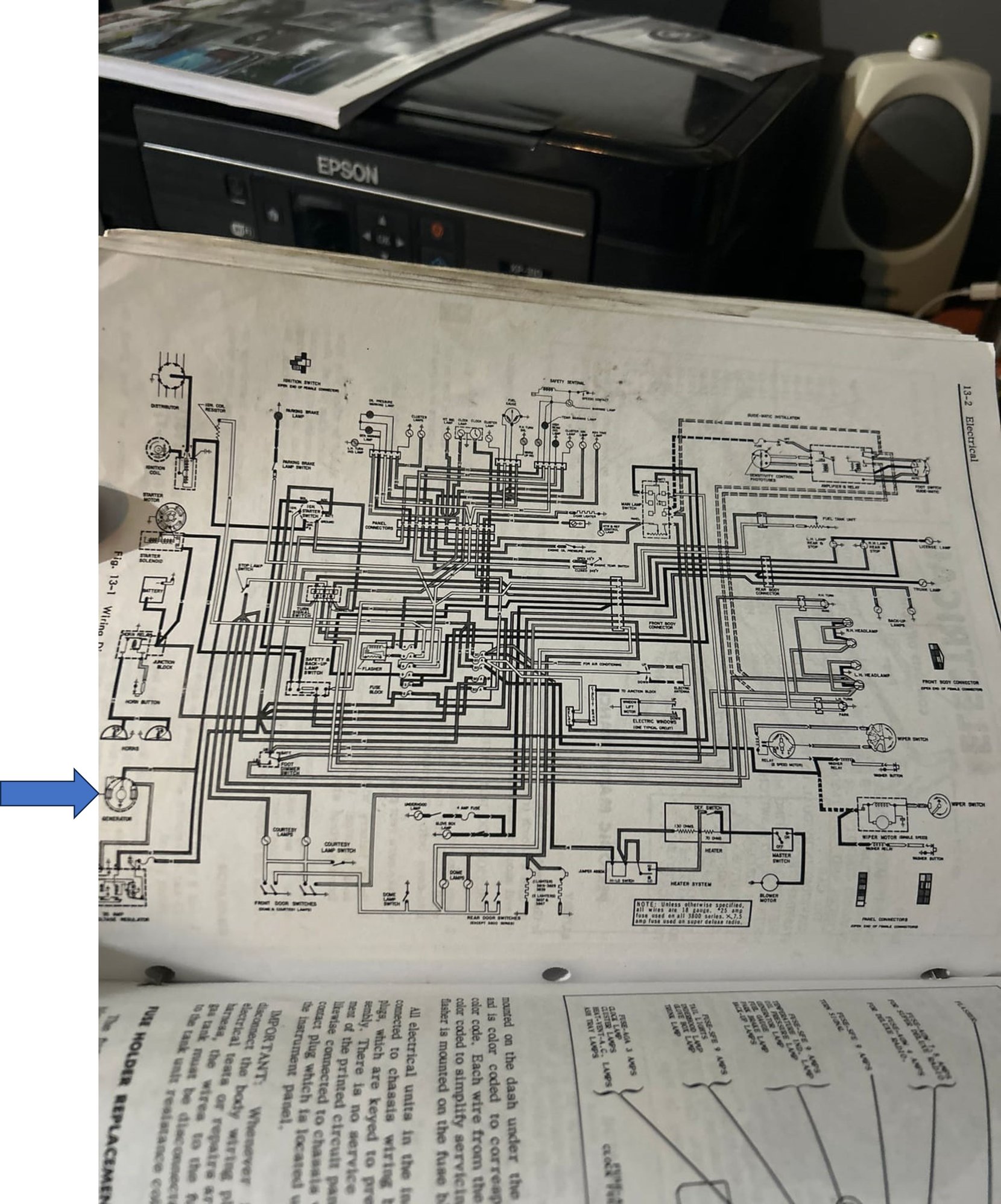

Colored would have been nice! I don’t see a relay lamp anywhere. Below are some pics. Red line is the path from GEN to lamp on dash. And then I circled the 9amp fuses clustered together, gen light is one of them, along with oil pressure lamp, backup lights, park brake lamp.
Old Feb 8, 2024 | 07:09 PM
Posts: 25,797
Excellent. The other gauges work in that circuit correct? So, the fuse is not a candidate or all the lamps/lights would be affected. Any chance you can post your image without the red line? And, without the word text.

Here are clearer pics. I really appreciate the help and guidance here Vintage Chief.

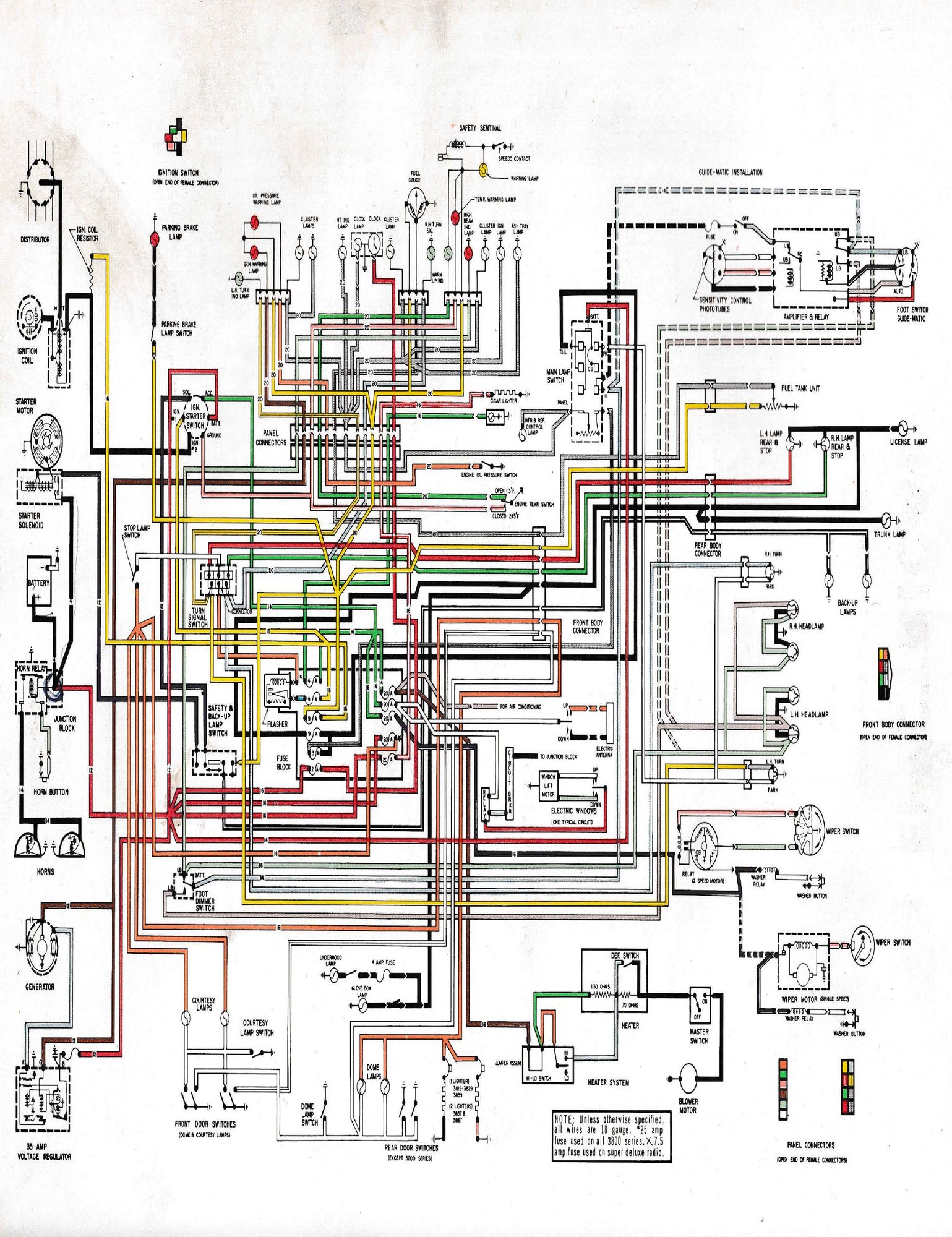

Will these help?

Will these help?
I will take a look at those thanks for that!

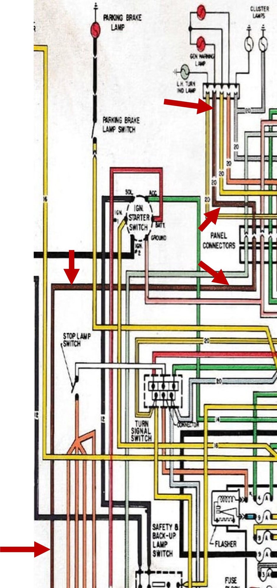

Chief the black and white diagram has the wire colors labeled.

so the GEN lamp has no wire attached to it; it seems to be an insert and twist bulb into the backside of the cluster.
Old Feb 9, 2024 | 02:20 PM
  #31
Posts: 25,797
Note there are x3 wires which exit the connector directly prior to feeding the dash lamp cluster - Brown, Yellow, Orange. Trace the Brown wire.
Old Feb 9, 2024 | 02:36 PM
  #32
Posts: 25,797
You could perform the operation a couple ways: (1) Using a test light you can probe the Brown wire anywhere along its path; (or) you can measure for continuity &/or resistance w/ a VOM/DMM along the Brown wire. If the Brown wire does not demonstrate continuity from one end to the other end, there's an open in the wire or a short to Earth (causing the lamp to remain on continuously). If you measure a large resistance (there should be none, or a minimum of ~0.5Ohms) then the wire is meeting resistance. In both cases there's the likelihood the Brown wire is gaining ground via another pathway, rubbing, chafing, etc.
Old Feb 9, 2024 | 03:36 PM
  #33
Posts: 25,797
It would be super sweet if you found that brown wire was the issue. If the wire isn't the issue & you can validate the wire itself is not the issue, & you can validate the GEN + VR are charging the battery w/o issue and those components are working: (1) you learn to live w/ the GEN light remaining ON or (2) you pull the circuit board for a review. The board foil is shorted, worn, broken etc. There are two separate threads of similar nature regarding a bad circuit board.

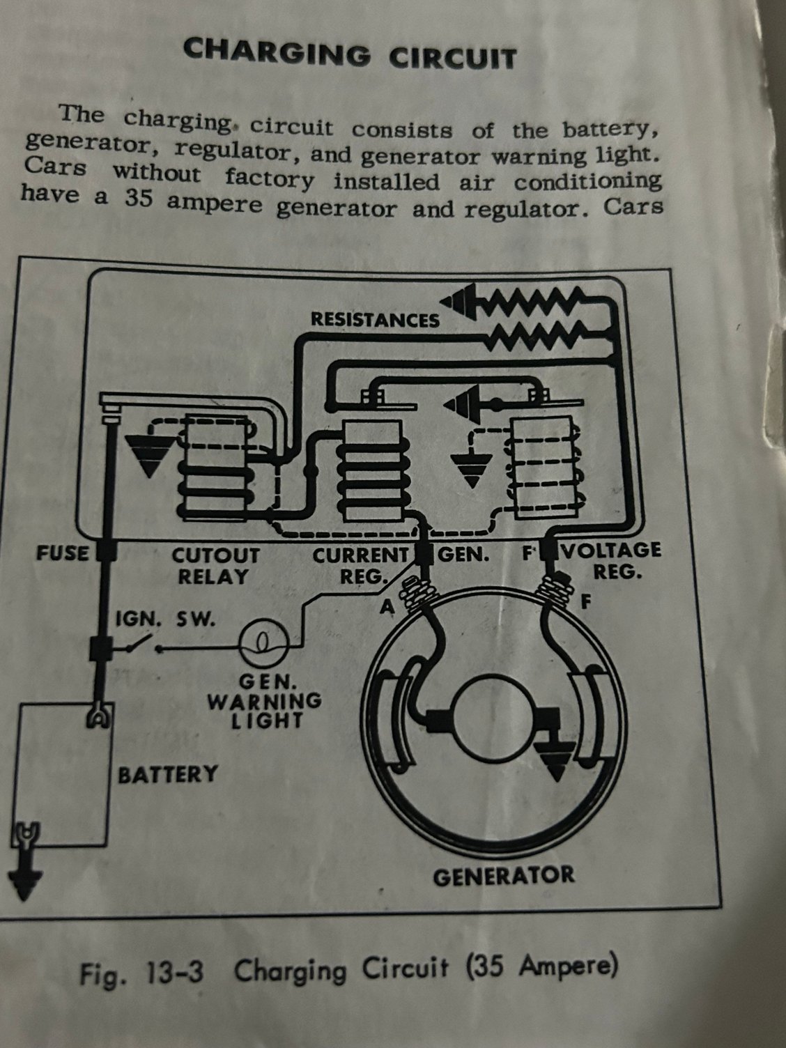

Shaking & running like crap, stuttering etc. are signs of a bad tune-up - fuel mixture delivery & timing. The charging system is independent of those running engine performance conditions. Tune-up the engine: New spark plugs, new contact points, new distributor cap, new condenser & new distributor rotor & new distributor coil wire. When is the last time the spark plug wires were changed?
Convince yourself the GEN +VR are operating the charging system - e.g. supplying voltage to the battery & managing the voltage delivery to the electrical devices in the car. As stellar mentioned, generators average ~13 VDC at curb idle. You need to validate the GEN is charging the battery. With all lights & electrical devices off, take the engine RPM to ~1500RPM and measure voltage at the battery. Do this several times. What voltage do you read at the battery while increasing RPM? Perform the same test, while performing the same test, turn on the headlights (minimum) another electrical devices. Take readings (again) at the battery. What voltage do you read at the battery?
The number one place to suspect issues in electrical on a vehicle is the ground side of the electrical system. It's vital you have crispy clean connections from the (-) battery terminal post to the engine block. You need crispy clean connections from the engine block to the frame & chassis with a solidly connected ground strap/wire. You need same clean/crisp ground strap/wire from engine to firewall where the dash panel obtains its ground and where the VR is mounted to the firewall. All of the connections need to be spotless and clean - free from corrosion/oxidation. Wire brush clean all wire terminal ends, battery terminal ends, the battery posts themselves. You need solid metal>metal. Wire brush/Sand the metal on the block, chassis, frame, firewall - anywhere the ground attaches to the vehicle. The ground side of the electrical circuit is the most important part of the circuitry.
Funny thing is, before I started digging in to all this electrical again just a couple days ago, I have fired up with olds a few times over the past few chillier months in the garage. Pumped the pedal a few times, cranked her, and she started right up, Idled perfectly. No stuttering, no shaking. It wasn't until I tried re-flashing the different voltage regulators I had on hand that it started to run very, very poorly. I think I fried the one remaining good one of the 3 I had on hand. This has happened in the past; the vehicle would act funky and act as if it wasn't getting enough fuel, stuttering and barely keeping 12 volts while driving. Turns out, after replacing the VR with a brand new one, it ran like a top, as if nothing ever happened.
I am going to search for a new VR tomorrow, locally. I'll let ya know how it turns out after I get it installed, and after I check the charging system under the conditions you mentioned, I will attack the brown wire to the GEN lamp, and test that as well. I am seriously thinking that the cluster and panel the GEN lamp attaches to may have some issue going on. But I will troubleshoot tomorrow, Norm.

The wiring diagrams show a fuse protecting the BAT wire right next to the voltage regulator, independent of the main fuse block. If I had to guess the fuse would be located under the hood. Has this fuse been checked?
Old Feb 10, 2024 | 06:35 AM
  #38
Posts: 25,797
I forgot all about that fuse - good observation for calling it out. I recall noticing the fuse in the blow-up image of the VR then went to locate it in the wiring diagram (itself) & couldn't find it. I think I then discounted it when I saw the fuse for the GEN warning lamp on the fuse panel, but I was also trying to validate the other four wires on that wire. I might revisit this fuse for a better look. It's the wire located on the VR "B" terminal between the IGN SW & the battery via the junction block. From the blow-up it appears to 1st feed directly to the VR CO (Cut Out) relay. Might explain why so many VRs are failing? My mind resembles mashed potatoes at the moment.

On a side note, I picked up a new VR this morning, I polarized it, and below are what I’m getting for voltage at the battery.
This is voltage with the new VR, car running, idle has not come down yet. I let it warm up, then kicked it down.
Engine running, lights on, interior light on.
Old Feb 10, 2024 | 10:27 AM
  #40
Posts: 25,797
I'd say your numbers look good from the perspective of putting out plenty of voltage to recharge the battery - almost too good, but they look good. With an Alternator (not Generator) you shouldn't expect to see voltage >15VDC. That fuse displayed in the CSM wiring diagrams (which is supposed to exist) could exist anywhere on that red wire to be honest. Wiring diagram doesn't show location, only a point of reference relative to other wire(s) wiring.
Does the GEN warning lamp remain at the same brightness both when you turn the IGN SW to ON but prior to starting the car?
Does the GEN warning lamp remain at the same brightness when the car is started & running or does the GEN warning lamp change brightness depending on load of the vehicle i.e. while driving, increase in RPM or w/ other devices turned ON?
