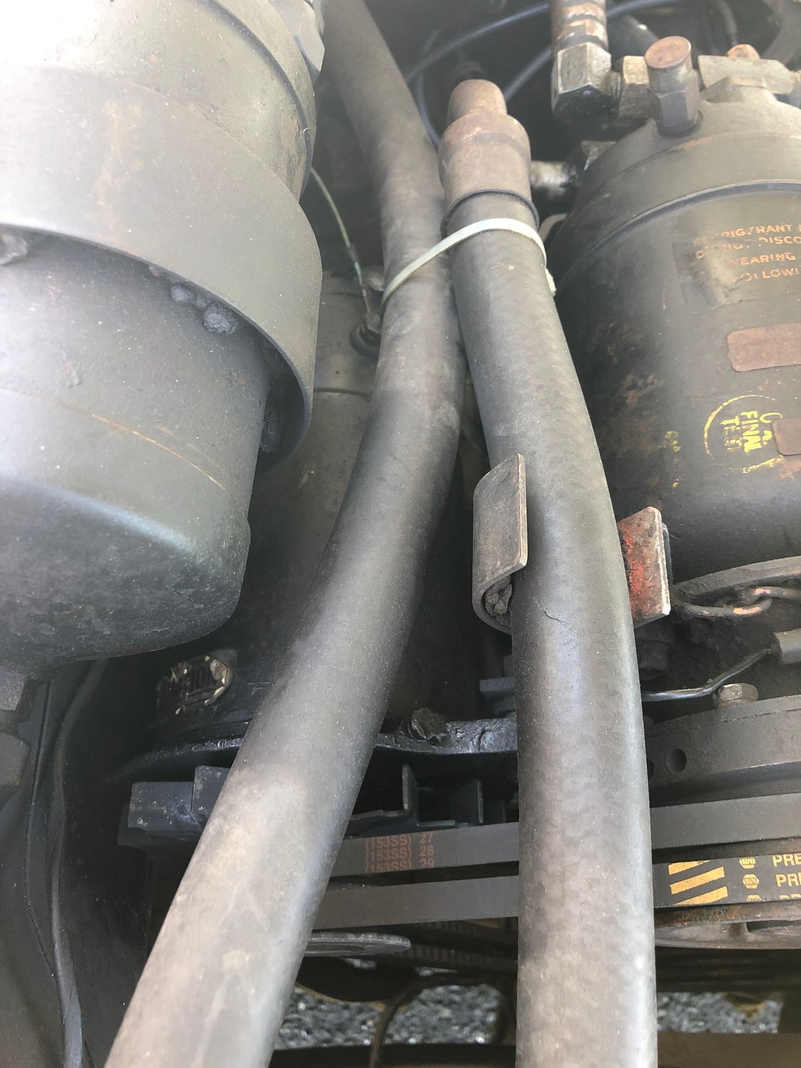

Hey guys,
I'm brand new to the Oldsmobile world. My dad recently purchased a 1960 Oldsmobile Super 88 with the rocket 394. I have to say I love the vehicle, but she's old and smoky so I've been trying to fix small things here and there to get her running smooth. I am relatively new to restoring vehicles, but I have been tinkering with my 68 F100 for about a year now so I'm getting better each day.
I recently took the car out for a drive at night and noticed that when I got to my destination the GEN light was lit up constantly when I turned my vehicle off. I have quite a bit of blow by and I saw small smoke fumes coming from my hood so I wasn't really alarmed, but I figured I'd take a look anyway. I popped the hood and saw that the alternator was smoking and it smelt quite bad. I also noticed some shiny black residue on the bracket near the belt (belt was fine). There was no residue anywhere else. No oil leaks nothing. I didn't want the battery to die with the light on so I took off my ground. As I put my ground back on it sparked against the terminal and it left quite a burn mark. I've seen small sparks and they are fine, but this seemed quite excessive. I started the car after about an hour, started without any issues drove her home and whenever I put my foot down on the accelerator the light faded on again. Got home light was on disconnected the battery and called it a night.
I am no sure what kind of alternator it is but it looks similar to those big powermaster powergen alternators (its black).
I'm quite new to all of this and still searching through the forum posts for alternator issues, but if anyone know what is going on here any info would greatly be appreciated! All I could find online was maybe something was shorting out.

Without involving a great deal of detail & additional troubleshooting I'd initially be suspicious the alternator diode(s) is/are bad. Stop by an AutoZone or O'Reilly's auto store, etc. - they'll bring out a tester to check your alternator diode(s) for free and let you know the state of your alternator. Takes about 5-10 minutes.
1. Make sure you have an alternator. Since its "black", I am wondering if in fact its a generator and NOT an alternator. I don't recall what year Oldsmobile changed from generators to alternators. A pic would be nice. Charlie Jones or one of the knowledgeable folks will chime in.

I'm shooting from the hip here, but it's possible a brush or both brushes (I believe there are x2) are going bad or have gone bad. Electrical devices (such as a gen/alt) can intermittently operate when the brushes start going bad. I keep a stock of new spare brushes for various devices (Hitachi Paint Shaver, starters, generators, etc.). The brushes are easy to replace and brushes most certainly do go bad on generators/alternators - it's something you could easily perform yourself.
Here is the listing for the brushes for your 1960 gen/alt on RockAuto.
https://www.rockauto.com/en/catalog/...tor+brush,2424
Here is a super easy to follow diagram of demonstrating the basics of an automobile generator/alternator. The brushes ride over the commutator and are held in via a light gauge spring.
http://www.secondchancegarage.com/public/91.cfm
You can often get to a point where the gen/alt sometimes functions, other times doesn't function, or quits all together. An often tell-tale sign of brushes going bad is when they wear, if they don't wear evenly (lop-sided wear), the spring puts too much pressure on one side of the brush, and the brush is only 1/2 in place, 1/4 in place, the brush is completely worn down, broken, or even the wire itself which commutes the amperage/voltage gets fried. But, changing out brushes is so simple and so inexpensive I'd suggest you simply open up the brush ports, review the brushes for integrity and see if they need replacement.

That's a generator. Check its connections. Could be ready for a rebuild. Could be bad bearings if it's charging ok. Probably has never been oiled. See the oiler caps.
Pull the belts and spin it. Feel the bearings. Should spin easy and smooth.
The gen light indicates energy is going to ground somewhere in the charging system. The bulb wont light if both sides of it are equal. By measuring either side of the feed to the bulb you can figure out which direction to look.
CLEAN ALL GROUNDS...Grounds Grounds Grounds. Every one you can get your hands on. 60 year old the grounds are likely not great, resto or not.
Battery neg should be clean and tight on both ends. same for the positive. If the batt cables OHM out ok and look OK use them otherwise replace with the same size. Don't buy chineasium cheapos! Fusick might have them.
Shouldn't have any sparking going on like that. My guess is the bridge diode is shorted going to ground(don't assume have it tested). Look for a starter generator alternator rebuild house that knows the old stuff. Same deal with the voltage regulator. FInd a solid state unit if they exist? At min send the reg out with the gen so they can be calibrated together.

I definitely need to run through all the wires and clean them up. They are caked with grime. Do you guys recommend just upgrading to a modern alternator. If so which one? I don't mind spending a little money to make sure the car runs smooth. I'm going to be upgrading the brakes, want to see if I can get some stock AC parts to get that up and running plus I'm going to replacing the water pump, thermostat and the intake. I have quite a bit of smoke and a bad smell whenever I initially accelerate.
2. I think the generator will work fine, unless you add things. Some on here have converted from generators to alternators. I'll let them give you pro's and cons.

^^x2^^ on generator bearings/bushings & brushes. Those old generators are heavy duty units which can take a beating & there's good reason they sell bushings & brushes for them since those are considered maintenance items. I'll add that once you (at a minimum) remove the covers to R&R the brushes, spray the entire inside of the generator w/ lots of compressed air - do it outdoors, wear a light general mask. The brushes are nothing more than carbon & the worn brushes leave behind carbon filings which get everywhere inside the generator, coating the commutator, armature, copper windings (field) & the diode(s). Or, if you also elect to replace the bearings/bushings, spray the entire inside w/ compressed air. These old gens are so well built, generally the windings, commutator &/or armature don't fail - they're pretty heavy duty. And, of course, as has already been mentioned clean up the wires leading to/from the generator.
Not unusual for the generator light to come on at idle, should go off when applying throttle. Might pull generator and take it to a shop that repairs them, as mentioned there tough units and do generate a lot of heat.
