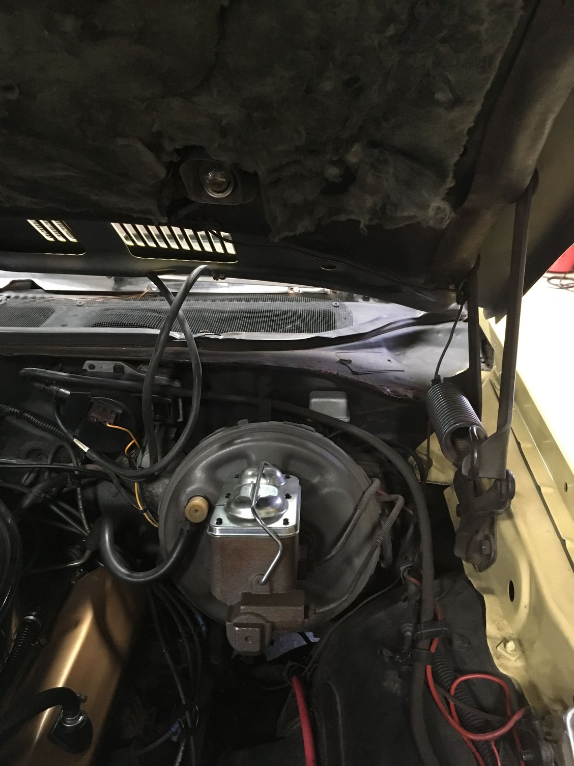

Oh yeah, I forgot to mention. The under hood light is powered by a brown wire from the wiring harness - at least on the '71 series vehicles. In the mean time, you might check for a random brown wire floating/lurking about which isn't attached to anything under your hood emanating from your wiring harness. "If" yours was located on the LH drivers side, it would be located in that general vicinity.

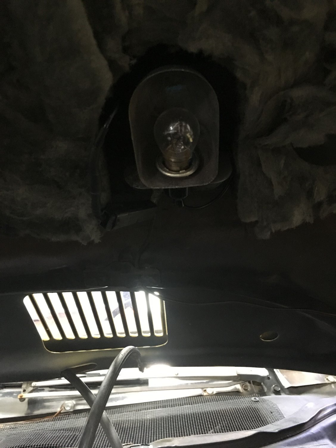

The OEM under hood lamp holder. I ripped out the OEM socket & replaced it with a new modern socket. Honestly, I can't recall if I replaced it w/ a 1156 or a 1157 bulb. I think it was a 1156 - I only see one filament in my photo/image. I'll do more checking on images.

Identified below (blue circle) is the small OEM clip (wire socket holder) which is used to attach the wire socket holder. The complete assembly achieves its ground via attachment to the metal hood. Indeed, I replaced the OEM hood socket w/ a single contact (single filament) 1156 lamp receptacle/bulb. You can find these OEM under hood bulb assemblies on eBay and other sites, as well.
