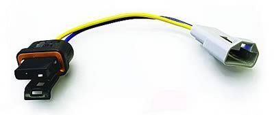

The OP has a 1980 Delta, so he already has a 12SI. The CS130 is a bolt-in, especially with the adapter harness.
would we happen to have a part number for this adapter!? JUST got the alternator, aaaaaaaaaand no adapter.

Type 12si cs130 adapter into Google...
https://www.summitracing.com/search/...iring-adapters
Amazon Amazon
https://www.qualitypowerauto.com/ite...-Harnesses.htm
https://www.ebay.com/itm/W1204-Alter...-/162516936440
https://swperformanceparts.com/ES1005W/

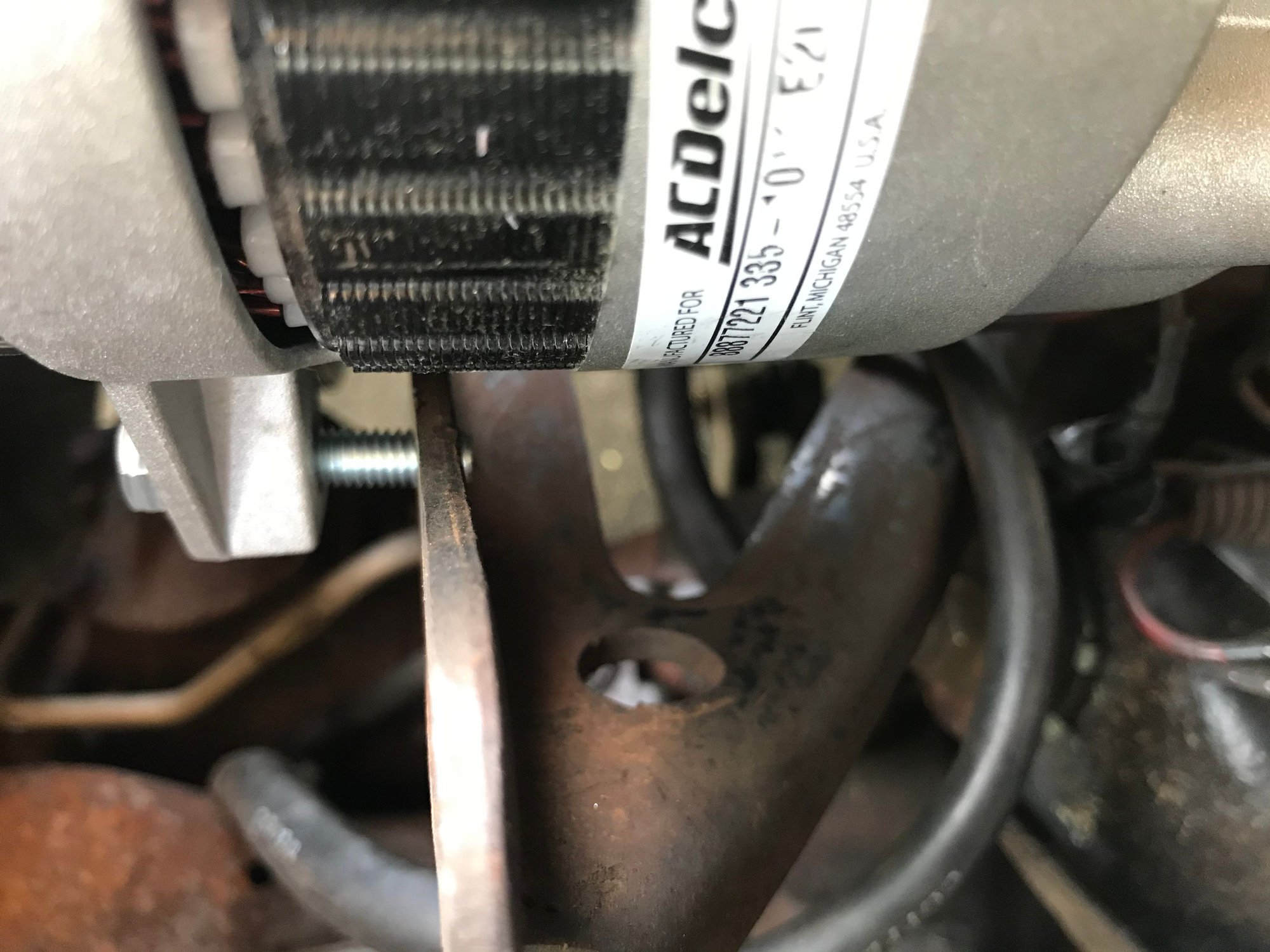

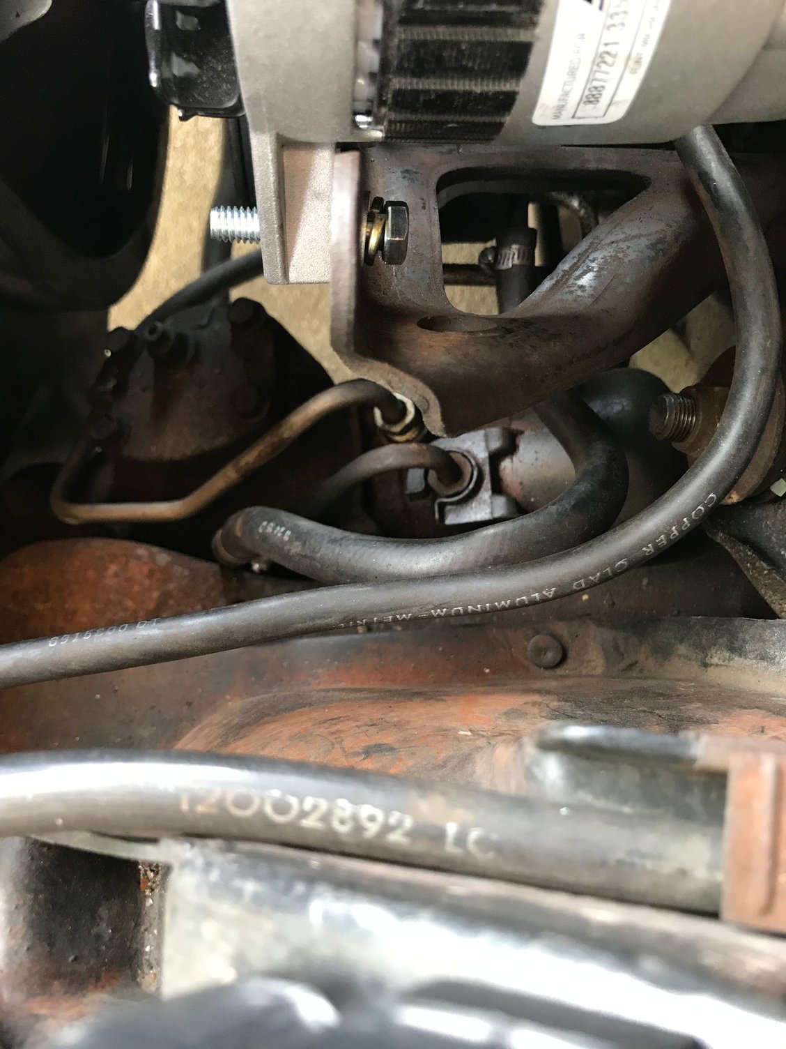

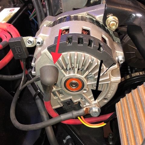

​​​​​​@joe_padavano ; any ideas !? Coming up short on the lower bracket and the B+ battery cable is too long for the rear bracket to fit..
Old May 21, 2020 | 11:39 AM
Posts: 50,539
Loosen the bolts holding the other ends of those brackets, start the bolts, then tighten the fasteners.
Old May 21, 2020 | 11:40 AM
Posts: 50,539
The strut on the back isn't mandatory. You can remove it.

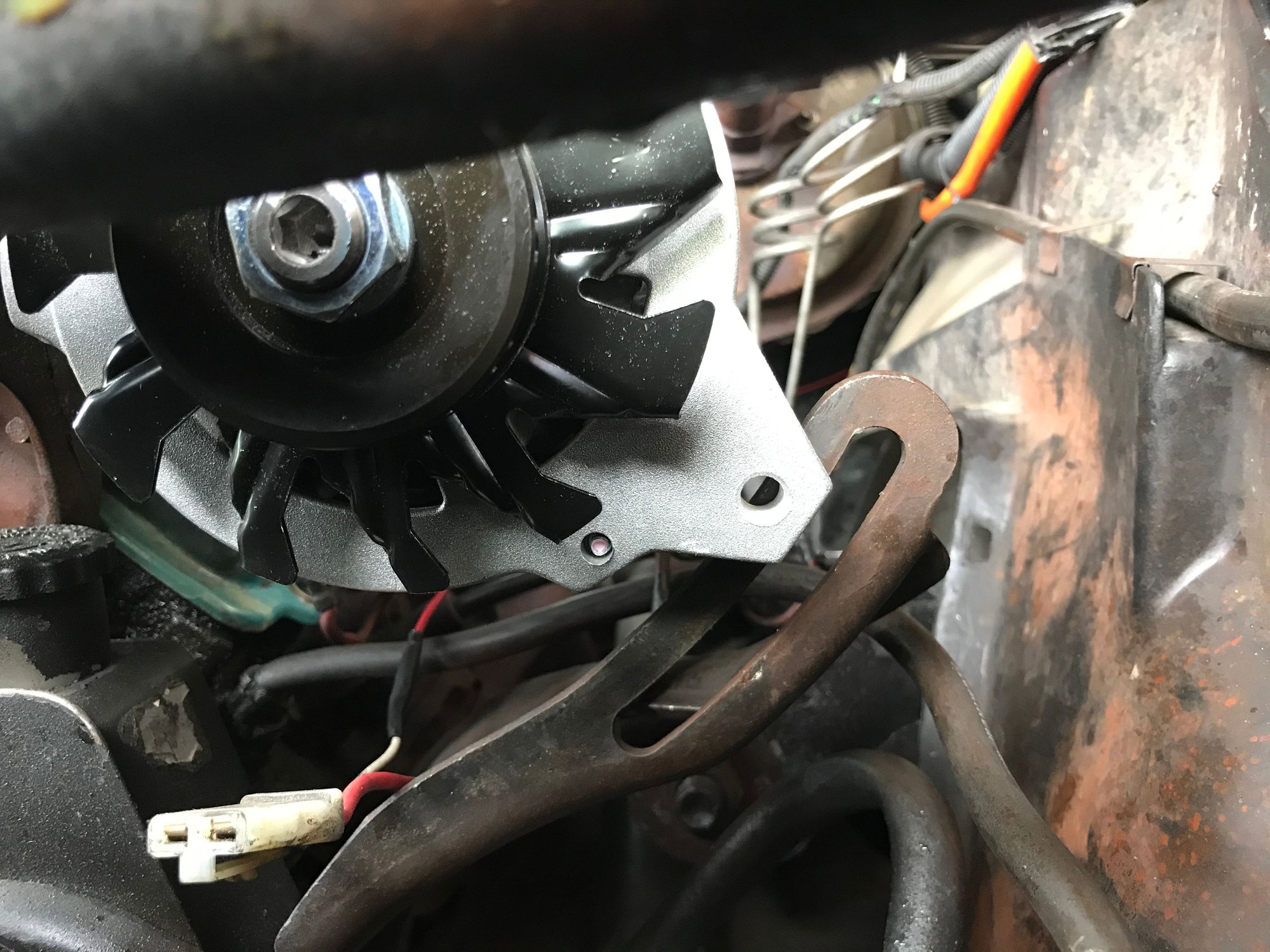

What gauge wire, and ground from the strut block side, to what? Not trying to be a butthole, just never heard of that. Unless you mean the 12g wire that goes to the back of the alternator ? Keep in mind I had to run to my job to order the adapter harness, so I havent hooked anything up; merely mounted and got it ready. Also have to pick up a battery..

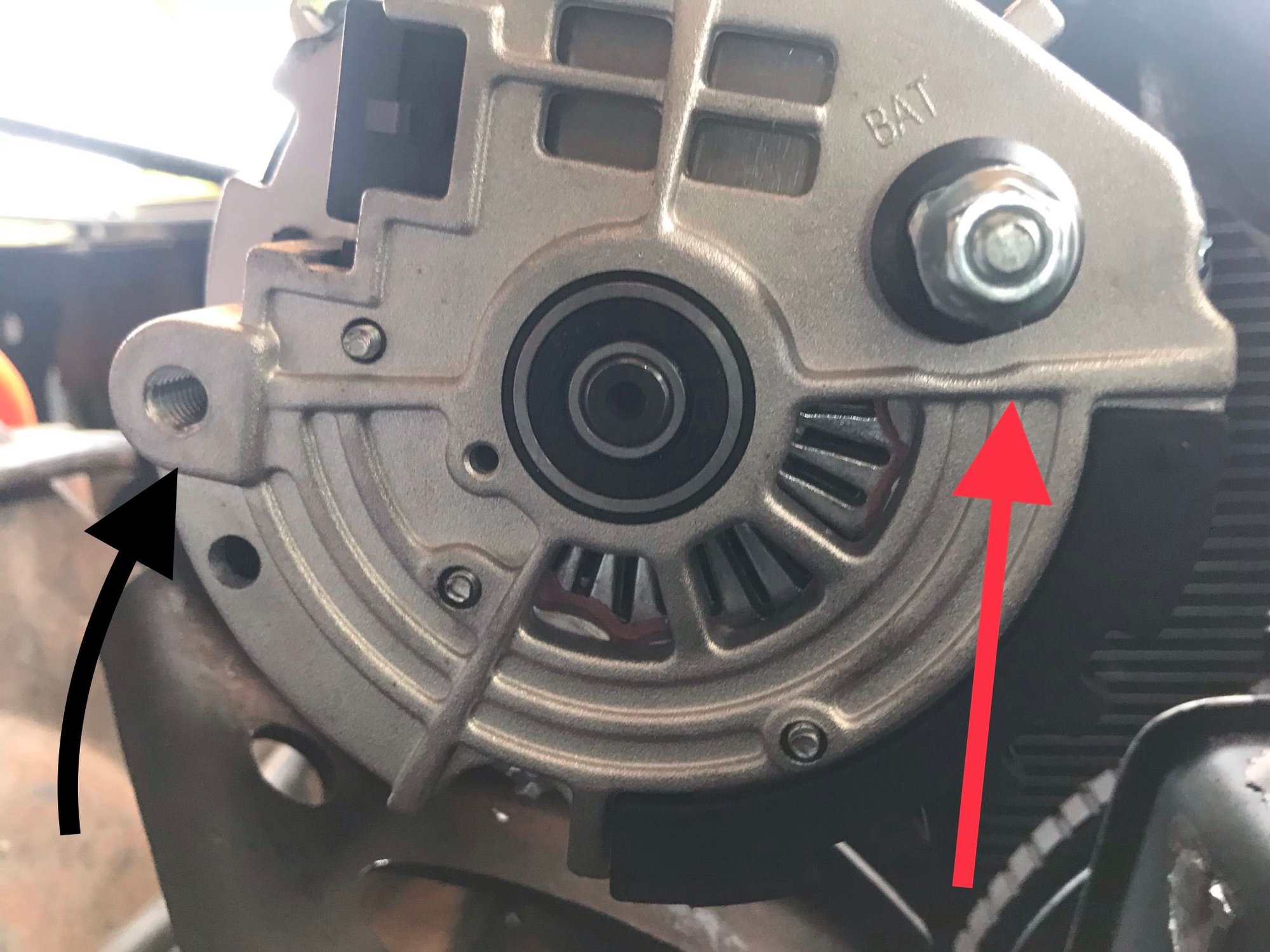

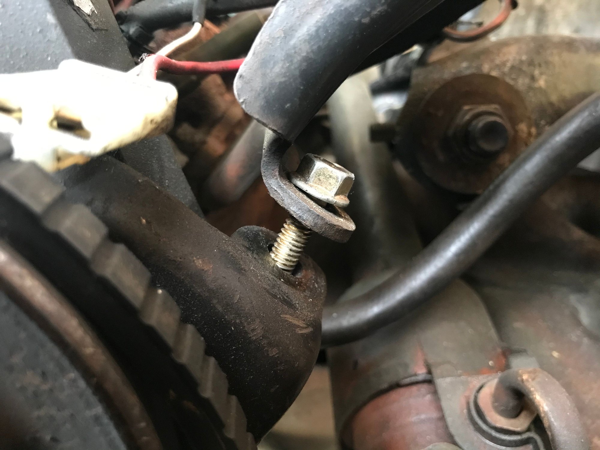

Also, now that I’m trying to put everything together the lower mounting spot isnt threaded like the old one; where it goes through the bracket. So should I just nut and bolt it ? Or is there a better attachment method
Old May 22, 2020 | 10:13 AM
Posts: 50,539
Yes, a nut and bolt works fine. It's just slightly more of a pain in the butt when adjusting the belt, as you need three hands.

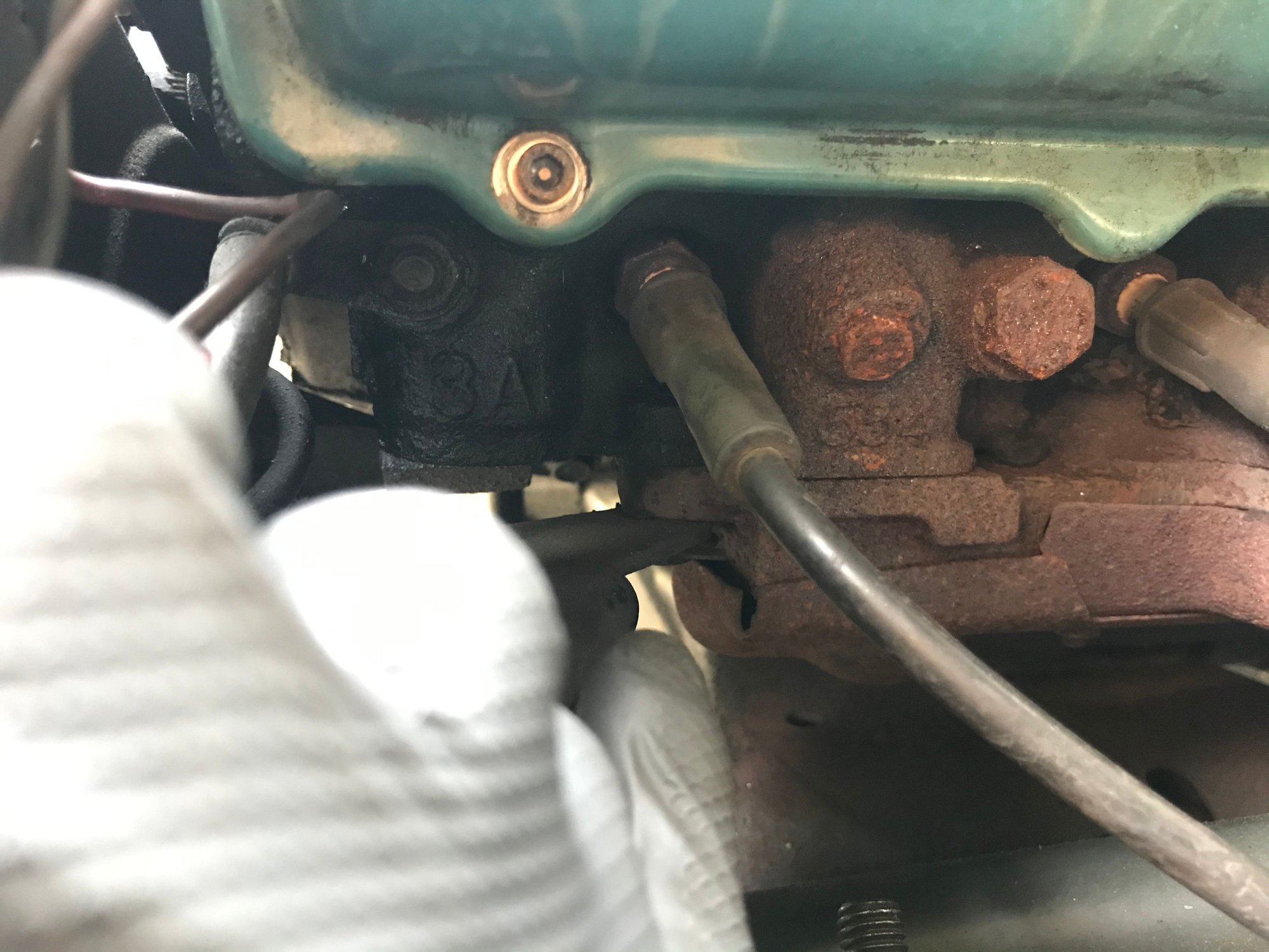

@joe_padavano noted. Now more questions..
can i run the alternator without the lower bracket bolt ? My problem is the bolt to hold the alrernator and p/s bracket goes in crooked with the alternator bolted on. The alternator is also tight where it adjusts, not as free moving as the OE (i understand the size differences). Itd be no problem to just shave the bracket down, but there is a bolt o the underside of it that attaches it to the block, which i have NO access to. I have included photos as well..

The CS130 is smaller and lighter than the original 12SI, so the vibration isn't such a big deal. You should run a ground strap in place of that strut, however, just to protect the electronics in the alternator.
Eso:
Definitely run a dedicated ground from the alternator to the engine block or run it back to the battery negative post. With that much current flowing, you don't want to chance a bad ground connection from the alt case, through the brackets, to the block, through the block ground, etc. That's alot of "connections" that can fail. A single heavy gauge wire is more dependable: under 100A run a 6 awg wire, 100-200A run a 4 awg wire. You should also "upgrade" the charge wire as well.

@cdrod noted, thank you! So just a small 4g wire from the back of the alternator bracket, to the back of the alternator? I do have a threaded port, and with the rear strut gone i can threat it to it. ...in other words, I can run my 10g battery positive to the red, and 8g negative from the bracket bolt to the black; yes ? Sorry, i do better with visuals ..

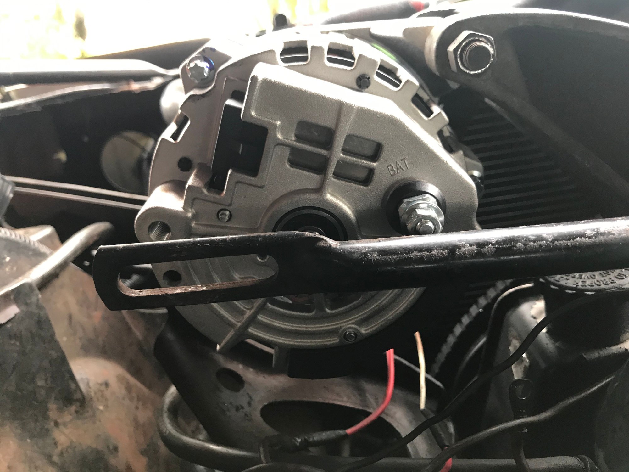

figure this oughta work? Proobably oughta get a bigger lock washer though..Getting ready to make my ground strap. Thank you for the hel gentlemen !

Eso:
You really need a larger charge wire!! If your alternator is putting out 100A, a 10 ga wire is not gonna handle that much current. 6 ga minimum 4 ga if your alternator puts out more than 100A. I have a 170A Tuff Stuff alternator and my charge and ground wires are both 4 ga. A 4 gauge wire can carry a lot of current so I have a 175A fuse between the alternator and the battery for protection. Here's some pics of my set-up. My alternator is clocked 180 degrees from yours so the Bat and ground lugs are in different locations from yours.

Rodney
@cdrod I definitely understand now. Only thing is I haven’t chased down the wire to see WHERE it goes. I can only assume the starter, but again im not sure ?
