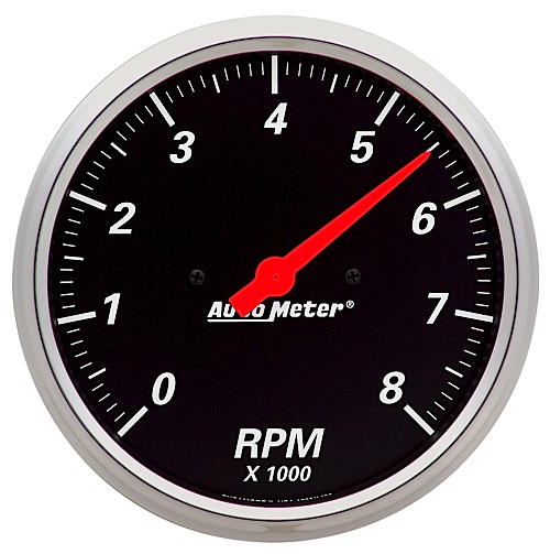

There are a couple nice looking tachs from several manufacturers that I like. There is also this company but they look expensive http://www.redlinegaugeworks.com/default.asp. I actually stuck a Monster tach into the face of a 1970 cluster. The back end fits right in just need to pad it out a bit and secure it from the back. Big radiator clamp worked for me.
File Type: jpg
File Type: jpg
