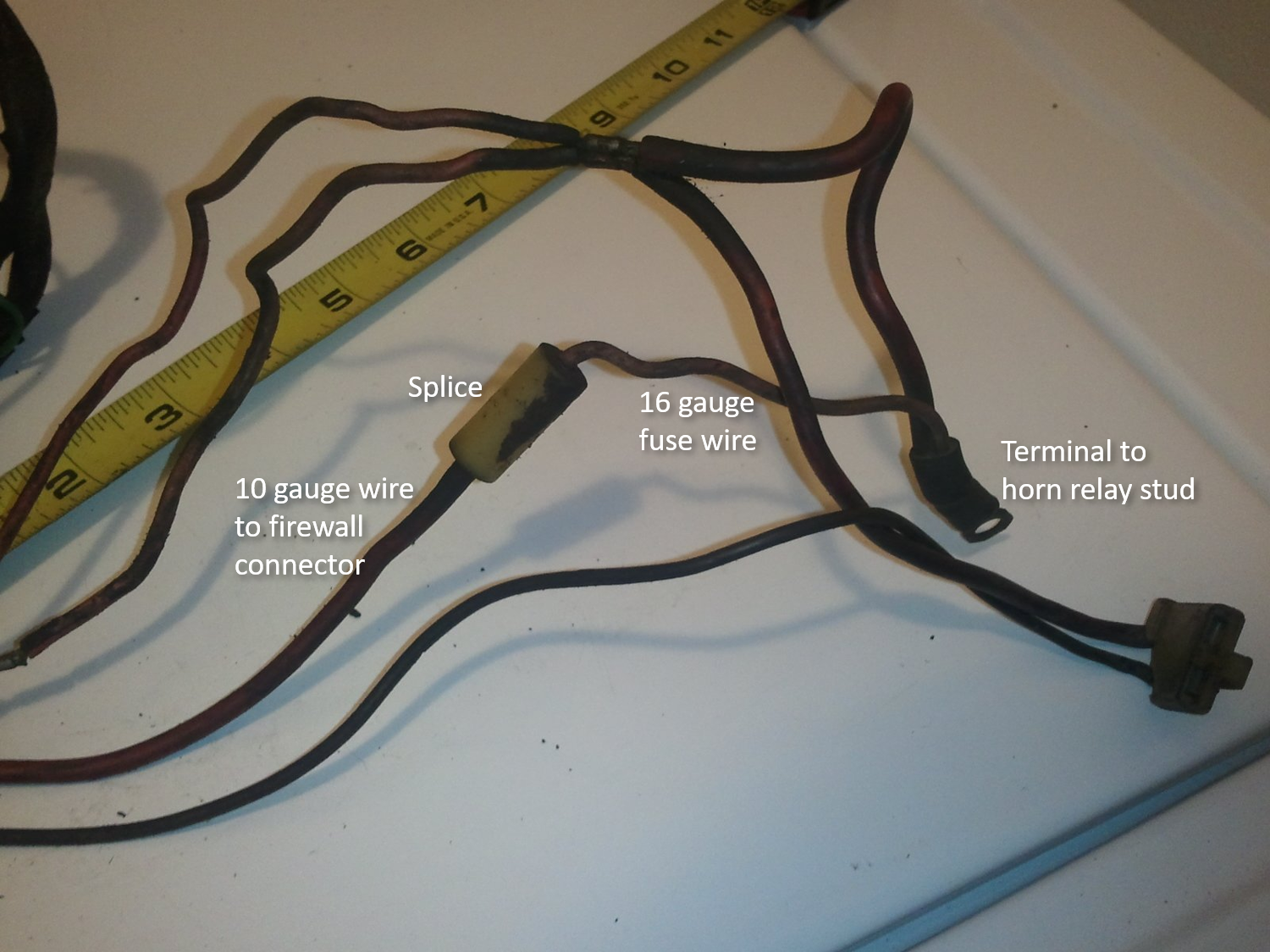

The fusible link should be in the wire that runs from the threaded stud on the horn relay to the fuse panel. The fusible part should be 16 gauge black wire for a couple of inches out from the stud, then at the cylindrical splice it is connected to the 10 gauge red wire that runs to the firewall connector. This 10 gauge wire also branches out under the dash and feeds the ignition switch and the headlight switch. Test for power on the STOP and TAIL fuses. If you find none, the fuse link is the problem. Note that this photo is representative and not from a 1973 Delta.
