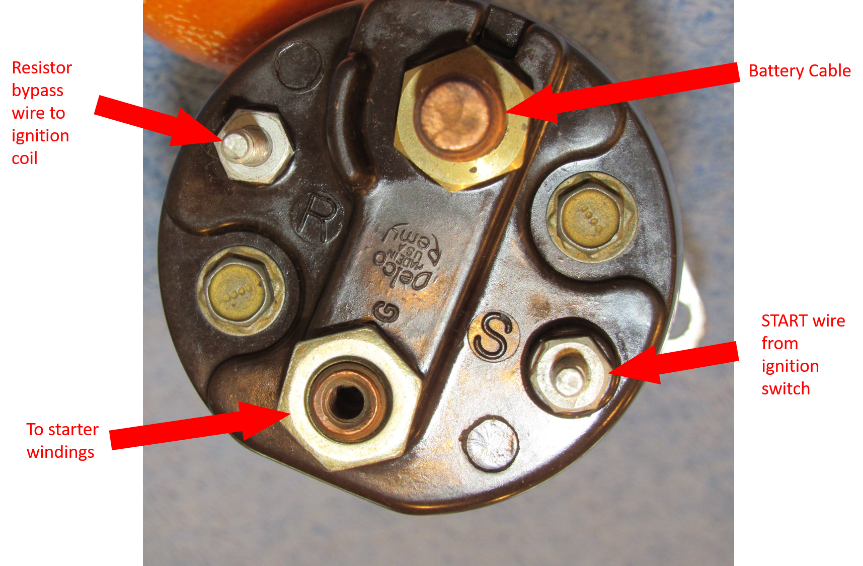

I'm building a wire harness in a 72 Olds jet boat. Open engine compartment, so it looks like an auto starter. The starter has no markings on the solenoid posts. I'm guessing the outside post is the crank/start post, the inner one is the ballast resistor bypass. Can anyone confirm?

The “S” terminal is the start wire. The other one is “R” , it supplies battery voltage to the coil, bypassing the resistance wire or ballast resistor. If your using electronic ignition, the S terminal is all you need for the starter to crank.

Thanks, that's what mine looks like, just no markings. Probably Chinese aftermarket.
