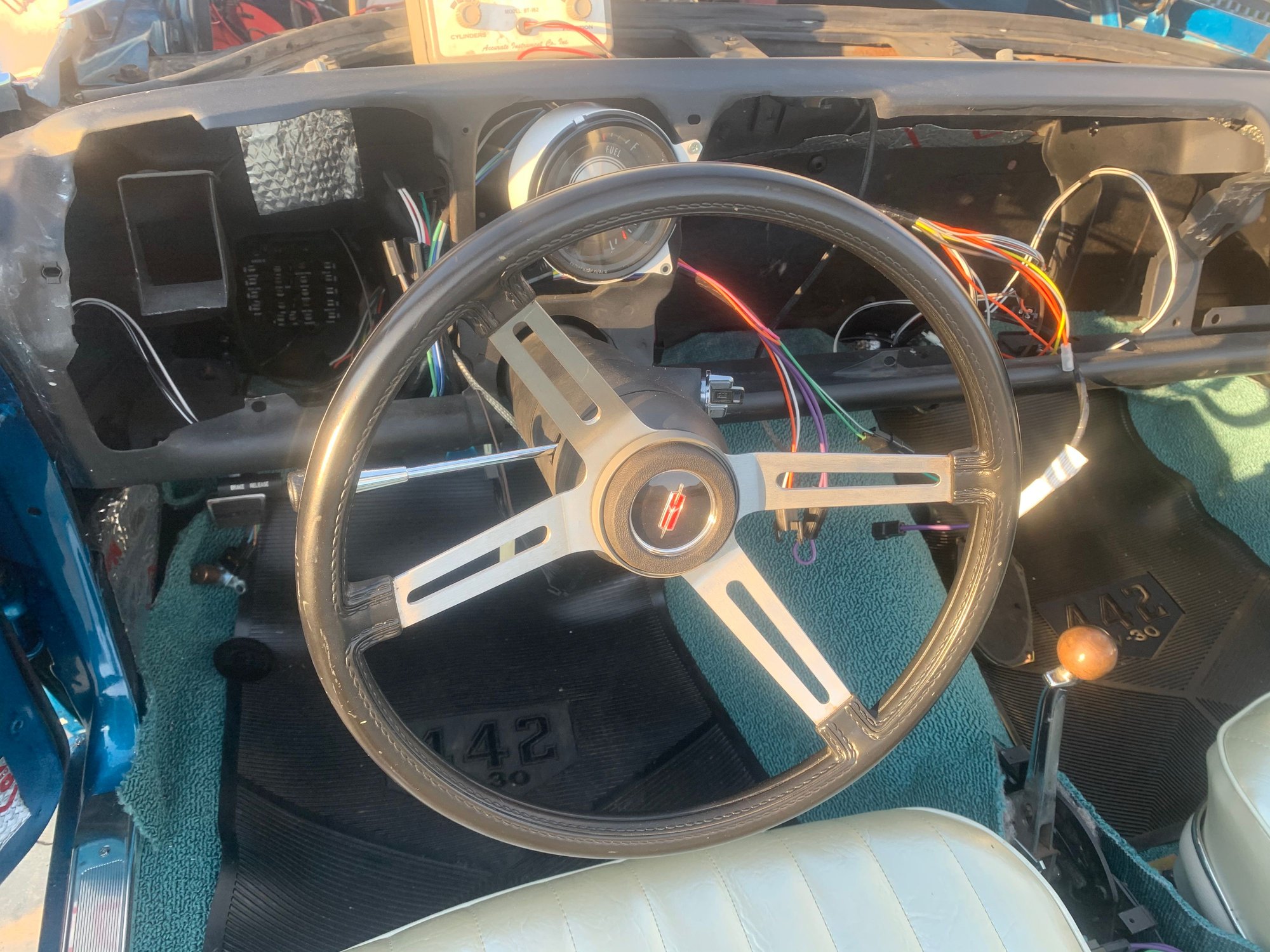

I just finished wiring the new motor compartment. Stock 455 1970 setup. New wiring harness. New everything. Set top dead center. Dropped the distributor in. Correct firing order. No spark! Yellow wire to R on starter. Purple to S. It turns over fine. Cranks and cranks. I have fuel.
is there anything INSIDE the car besides the Starter switch that needs connected? I looked at diagram and do not see a Ignition fuse or relay. The ignition switch is connected and the FAT purple wire to the neutral safe switch has a jumper across it to close it.

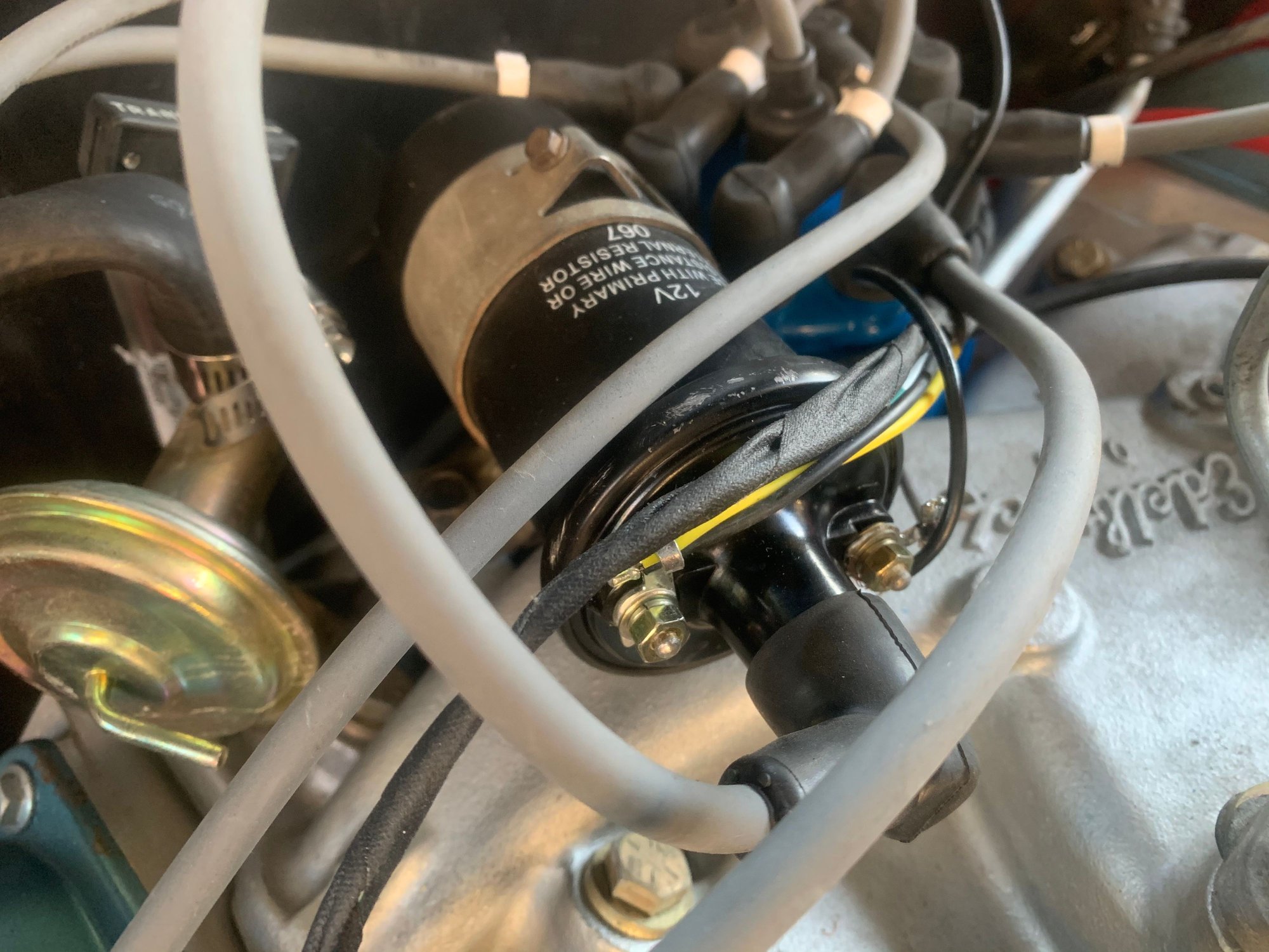

Do you have the wire connected from the firewall to the coil terminal where the yellow wire from the starter is also attached?

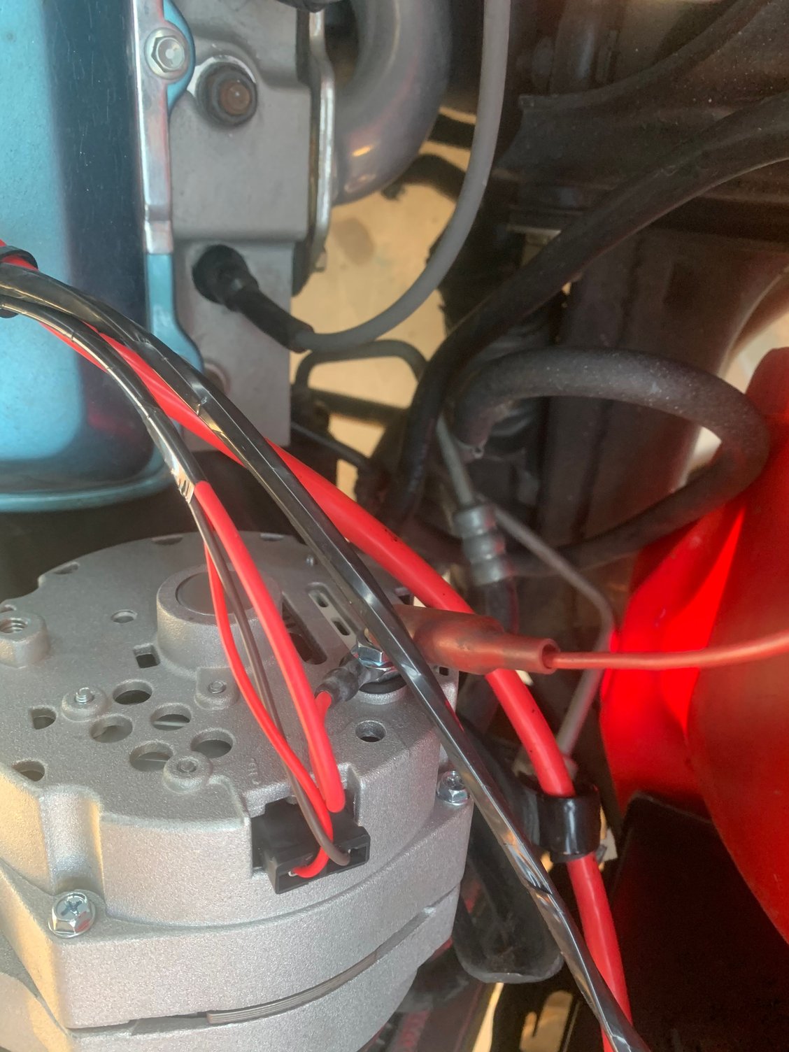

Horn relay is wired correct. Red wire from relay to breaker is run, nothing is plugged into breaker though. Alternator is wired right.
I have a Tach clipped to positive post on Alternator and neg side if Coil
is that this? If
so then yes

Try disconnecting the tach. There have been several threads in the past year where the tach caused a no-spark issue.

is there anything that needs grounded on the wire harness Inside the the car? When i connect the Battery negative I hear a clicking noise come from the horn relay. This is my first car with a horn relay and i am not sure if it is supposed to click when grounding the battery?

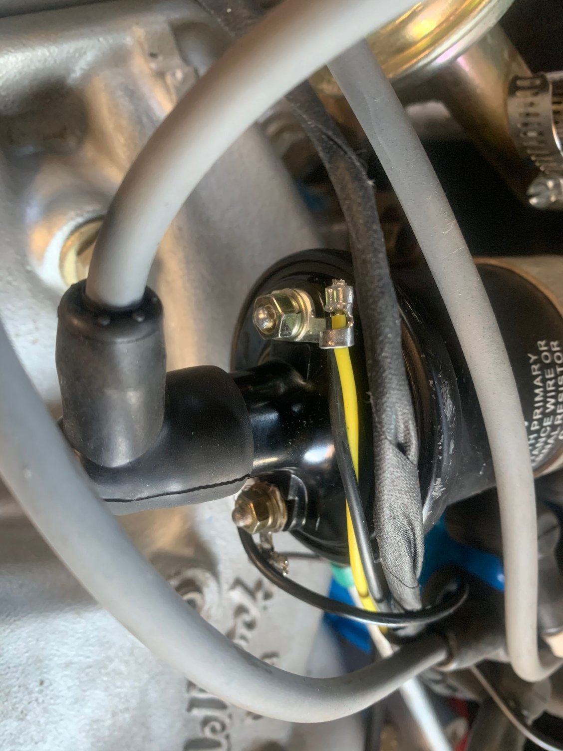

The coil- terminal is not ground per say, its the trigger fed by the distributor. Connect the red terminal of your meter to the coil+ and the black to the engine block. There is a resistance wire that runs from the ignition switch to the coil+ terminal. As stated above, disconnect the tach from the coil- terminal and with the key in the on position you should see voltage on the coil+ terminal.
Note if you just want to start and run the engine, connect a temporary jumper from the battery + to the coil+ and crank with the key. To turn the engine off remove the temporary jumper.

The black bulge is the fusible link you were asking about. Make sure the connection at the horn relay is good as well.
OH! Ok. What about the breaker on the firewall? Does that need to have anything attached? I think it is just for power windows/locks/seats etc.
can I check the continuity of the Yellow wire attaching ohm meter to both ends? It is not switched anywhere? The switching happens inside the starter it seems looking at the schematic.

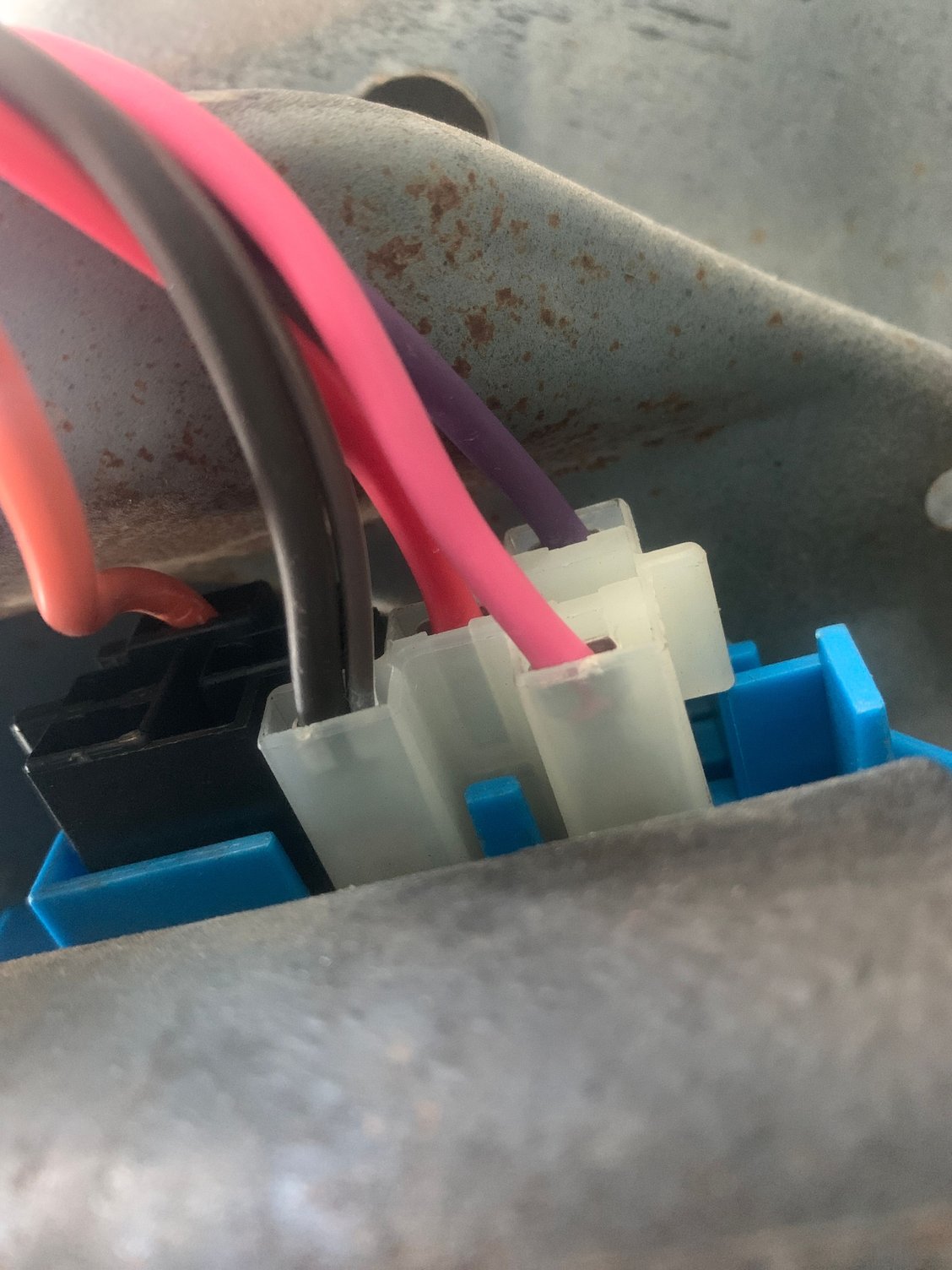

See if you have power at the pink wire of the ignition switch, make sure the key is in the “run” position. If so, at least you know for sure the ignition switch is able to power the ignition. You should have power on the brown wire with the key in the “run” and “acc” positions.
Next, se if you have power at the fuses. Some fuses will show power at all times (lighter, courtesy lamps, etc) others only with the key in run or accessory. The accessory powered fuses will shut down with the key in the start position. The fuse labeled “lamps” shows power only with the headlights on, and will vary voltage depending on the position of the dimmer switch.
If you have no power at the pink wire, it’s time to check things like fusible links.
going to check the pink wire. But what brown wire are you talking about? I do not see a brown wire on my igition switch. I see black? Is that dark dark brown?

Put volt meter into the starter ignition switch. There are volts on the Pink, purple, red, and the black and brown wires.
in Run i have 10 volts at the Coil positive.
i have 12 volts at the horn relay post

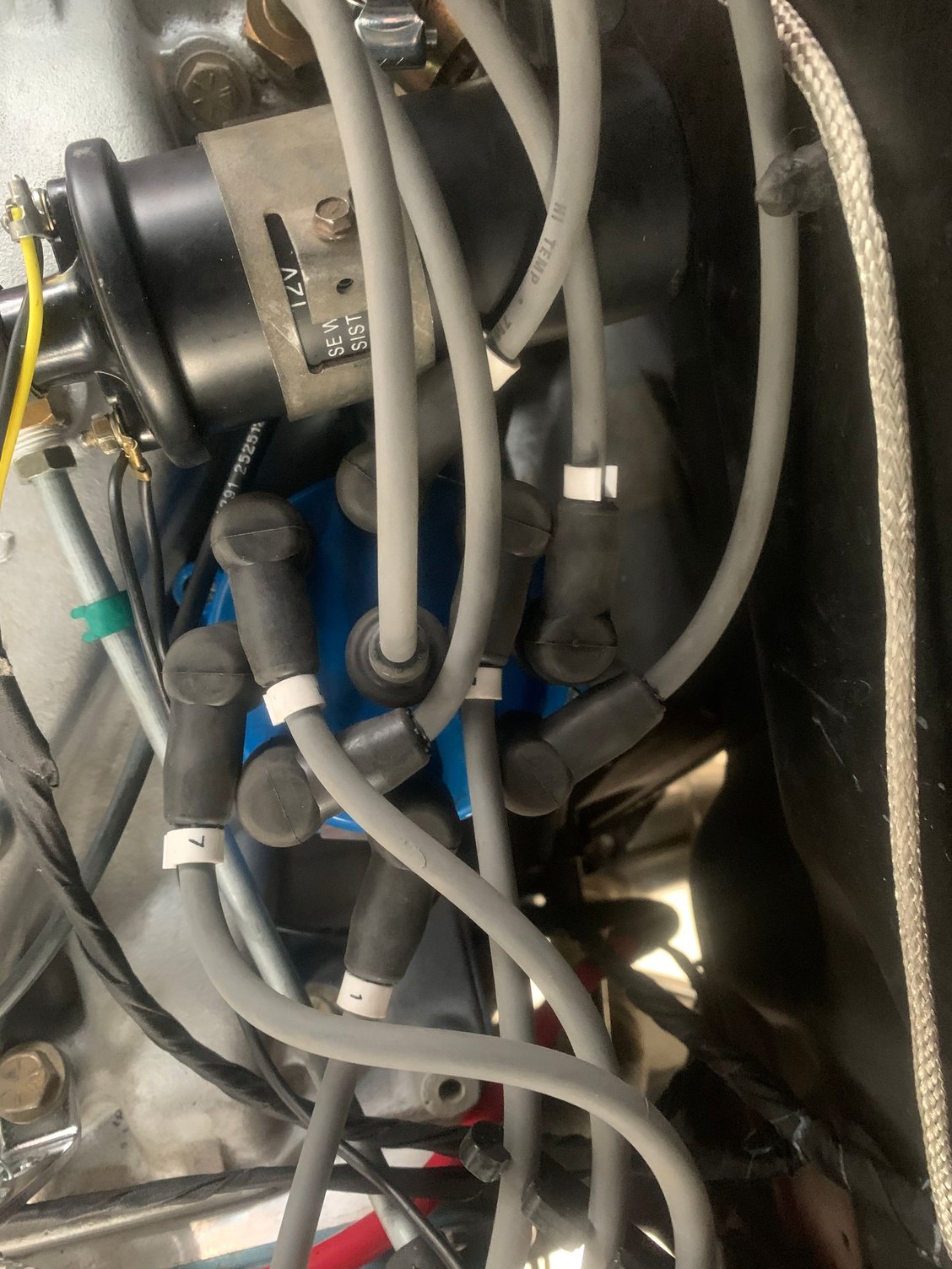

Recharged battery an hour. Tried cranking. Nothing. BUT while I was waiting I bought this at harbor fright. I am now getting spark! Maybe swapping the coil earlier?!
but still not starting. I have pulled the distributor five times. I even put in a OLD oem one just to see if the new Orielly one was bad. I am now convinced the problem now is my points or I am not setting TDC right last time I pulled the dist. just how sensitive are these skinny non-HEI distributors to not being RIGHT on the rotor? The vaccum canister and my edelbrock O4B are not letting me rotate the distributor very much at all. I tried flipping the whole distributor the other way but then the Screw cap hold downs hit the manifold runners. I know that the O4b never worked with HEI distributors but I am wondering if i have to install a Vaccum advance delete distributor now. :-/
Old Dec 29, 2019 | 02:01 PM
Posts: 42,497
You have to find #1tdc and install the distributor so that the rotor is pointing to the #1 post and you still have room to turn the distributor without the vacuum adv. cannister hitting the manifold or the firewall to adjust the timing.

yes that is what I was thinking. But if that doesnt work would it be ok to get everything up and running with a vacuum can delete distributor? I plan to upgrade to a HEI with Holley EFI later down the road so the Points distributor is only temp.

Spark plug type does not matter its for radio interference. Setting your distributor as above will work, there is no if. Whether a distributor that has no vacuum advance will work is dependent on which one your talking about. If its a small cap electronic it may require full battery voltage. Note for future ref. an HEI conversion requires full battery voltage and the removal of the resistance wire.

This only orientation that allows ANY movement
Old Dec 29, 2019 | 03:40 PM
  #36
Posts: 42,497
The last picture is correct.

I took out all the spark plugs. Then took out the fan. I changed the orientation of the distributor to have 1 pointed more at the booster than the front of the engine. Dropped the distributor cap right on top while at TDC. Went to start it and cranked. I heard what sounded like a it wanted to start but then didnt. I smell gas so maybe it is flooded. Anyhow the battery died again. NEW battery, was charging a hour or so. Must really be drained. Gonna let it be on charger and try again later.
