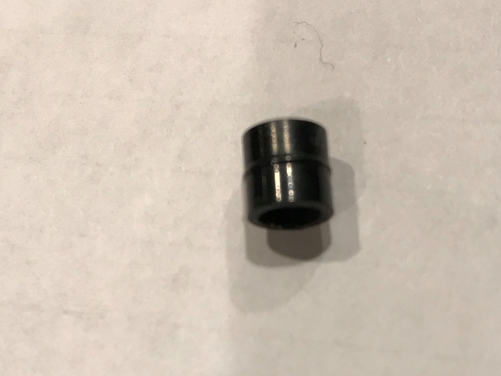

Does this small black piece go in the hole where the wires inserts or does it go on the end of the wire inside the spring?
Thank You!

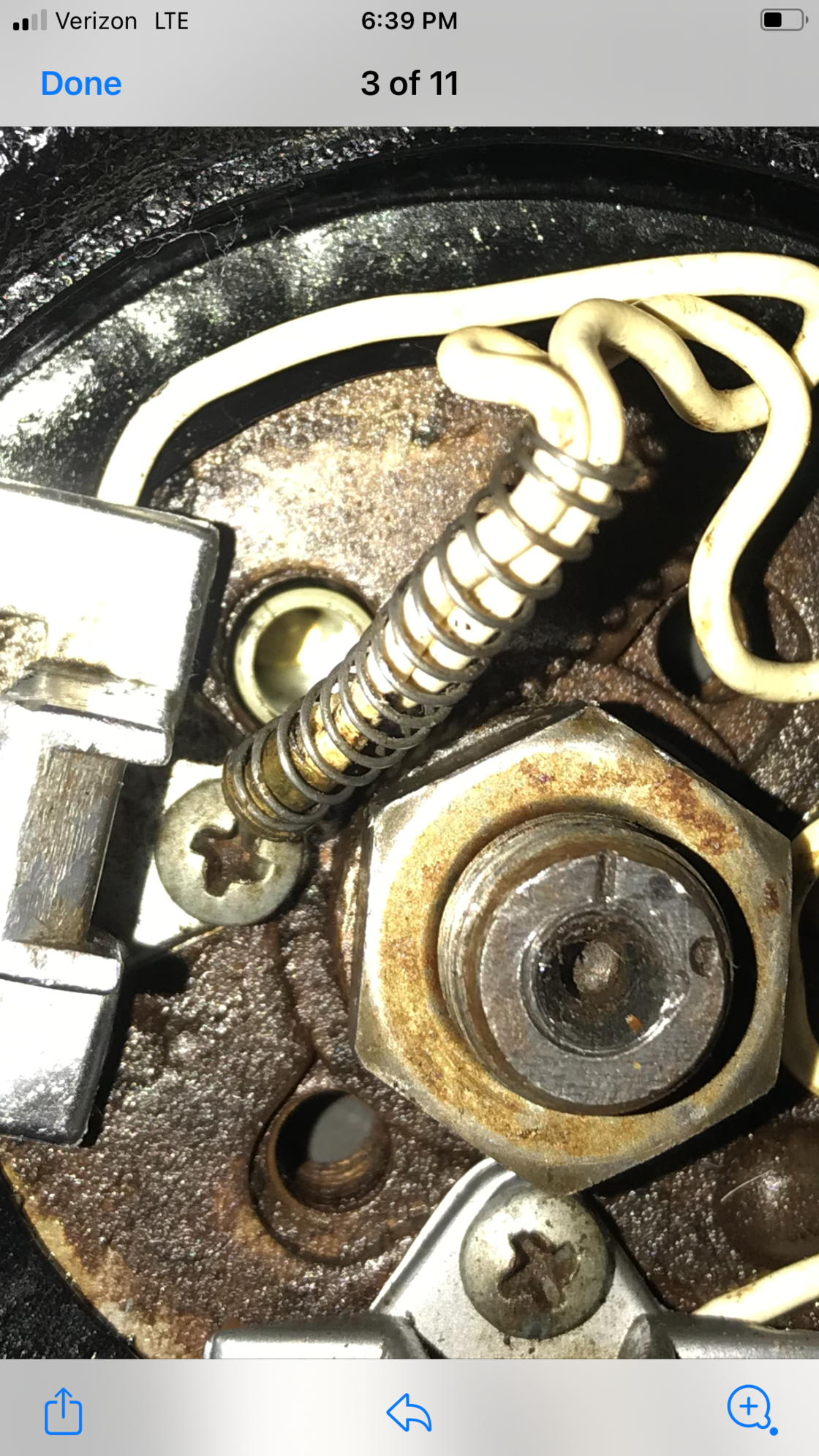

This goes above the spring....
Hope this photo helps...

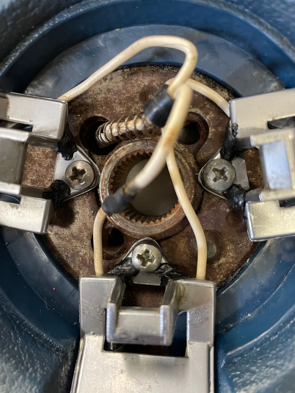

Once you push the spring and contact down into the hole in the cancel cam, that ring is a friction fit into the plastic tube to hold them in place.
