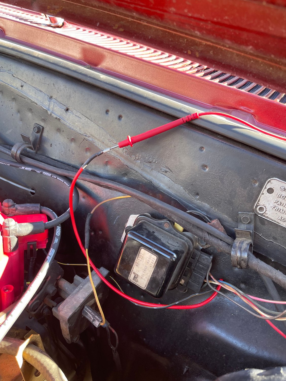

So I went ahead and tied into the pink ign wire from the back of ignition . 12awg wire is hot at 12v with key on .
soon as it cranks voltage drops to 8 so not getting enough for spark

I can't tell from those photos where you ran that wire from, but if you are only getting 8 volts, there's something wrong.

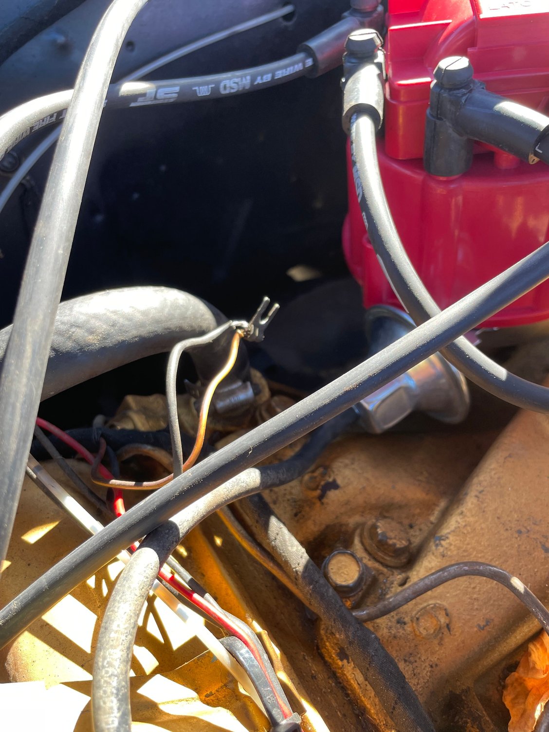

I soldered the 12awg into the pink ignition wire just before the ignition plug

At the ignition switch? That's the wire that feeds the resistor wire. By leaving the resistor wire in place, you may have an unintended loop that keeps the resistor in the circuit. Are the old coil wires connected to anything? Unless you care about not cutting the original harness, you should separate the pink and black/yellow wires at that horseshoe connector and insulate both of them.

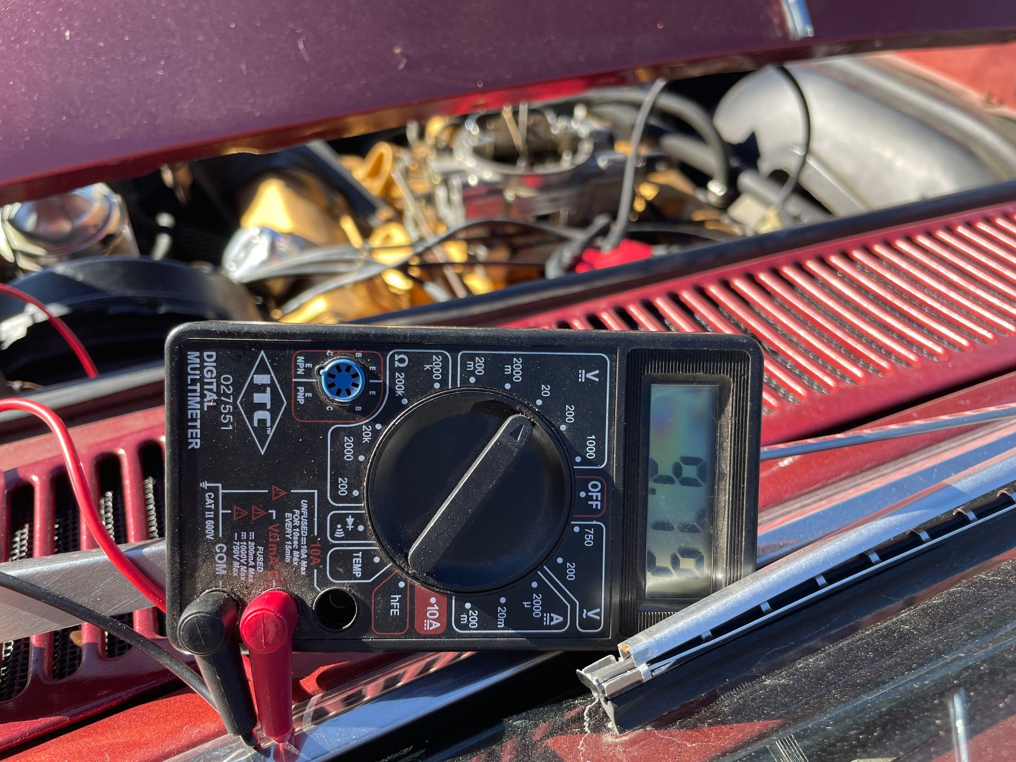

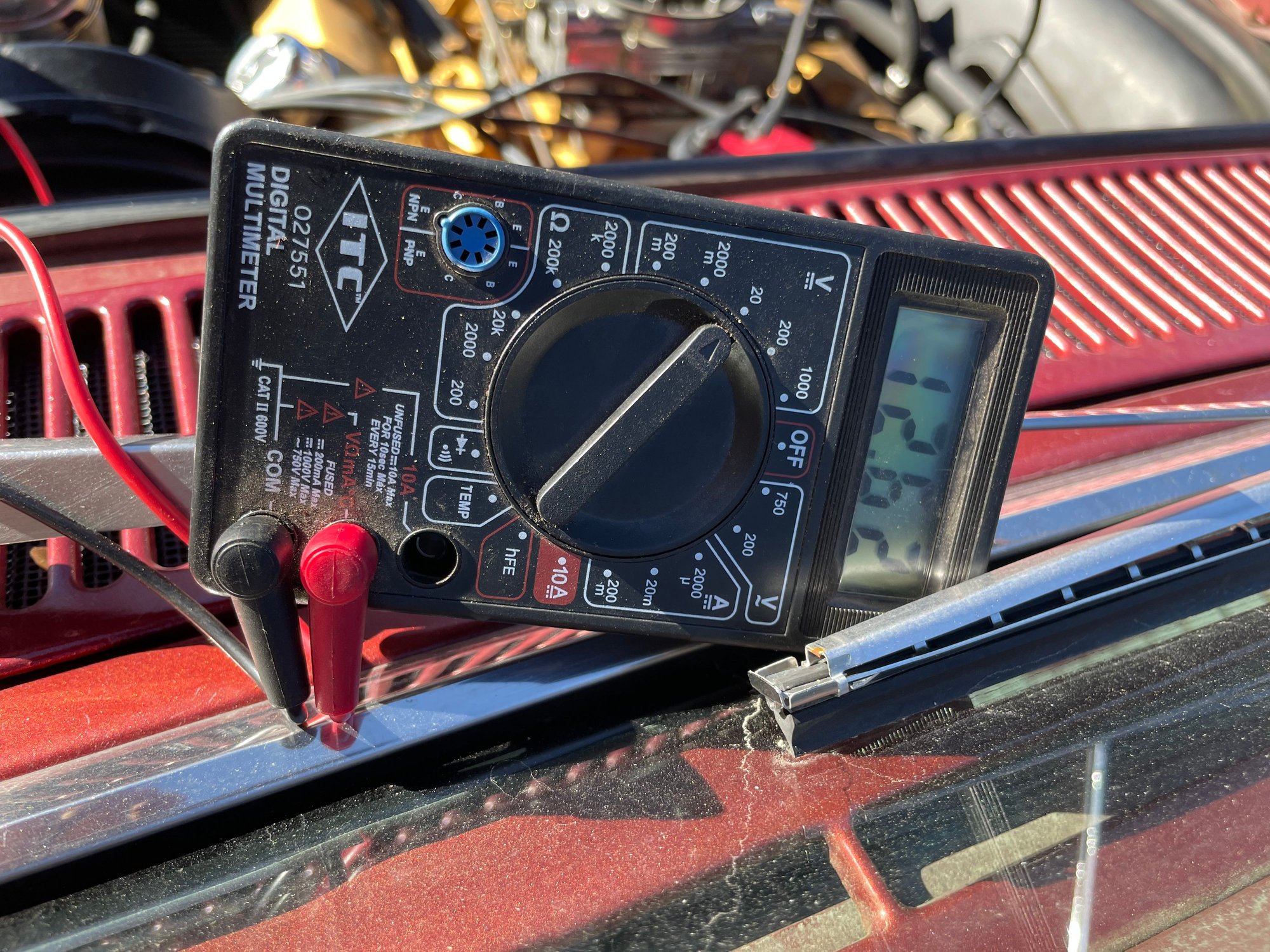

Old Sep 25, 2022 | 02:04 PM
Ranzan's Avatar
Getting There
Joined: Jul 2006
Posts: 1,147
From: Regina S.K. Canada
Video was to big to load so a couple of pictures
Cranking
Key on
appreciate the help on this Joe … I’m stumped

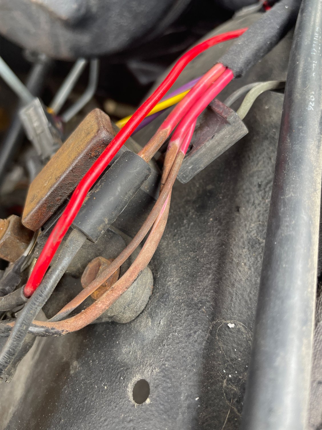

That's a completely different problem. ASSUMING your battery is good, go clean every connection. Pay attention to the wires on the stud at the horn relay. I've had a problem there in the past.

Cleaned all power wires cables battery grounds and straps .. still no difference ..
there is a power wire from body harness to the horn relaywith a factory looking fusible link could that be the problem ?
