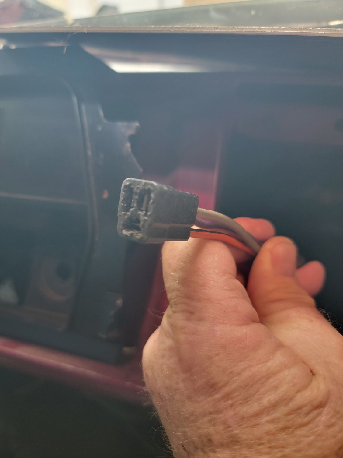

This is what the connector on the switch should look like. This one is obviously dirty, but you get the idea.

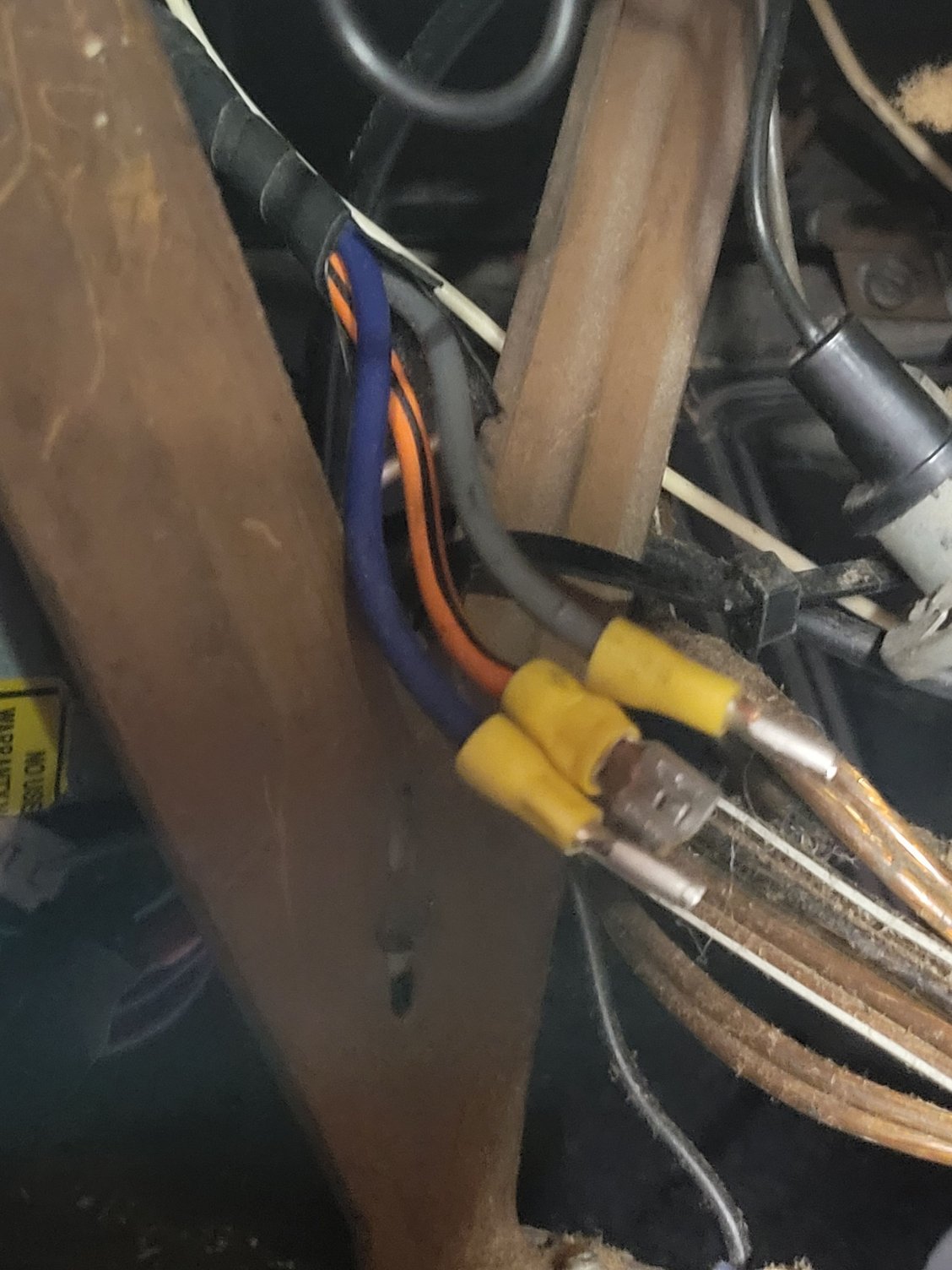

Thank you for uploading the image of your wiring harness. Here is what I have on mine. Appears at some point somebody replaced the end receptacle piece you have with the terminal end clips. I got the new switch in and was able to swap the wires around to get the top working so pressing up is up and down is down. Getting it back in was a slight PIA reaching my right hand back through the glove box insert cavity but all is back together and working well now.

Glad the top switch is fixed!
Just so you know, GM in those years used a system called Packard 56 for its electrical terminals and their plastic shells. Many of these are still available.
I think I generally get mine from clips & fasteners.com, but dig around the web and you may be able to find the correct plastic shell. You can easily find the male and female connector spades in quantity for not much $$.
If the previous owner changed out this connector, it likely there are other modifications / hacks you might want to repair.

Like Cfair said though, the crimps on those connectors look a bit sketchy so you might look into putting the correct connectors on with the correct crimpers.
I understand that it is working, so don't stress on it. But if you run out of projects, you might revisit this one. 👍

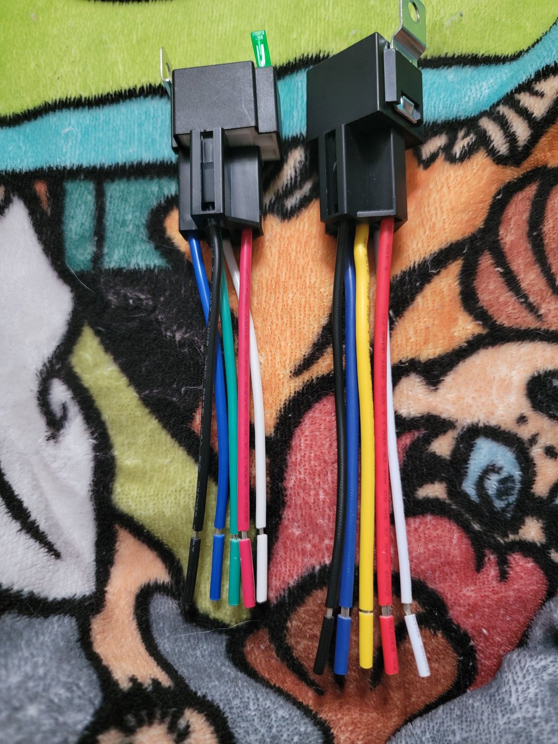

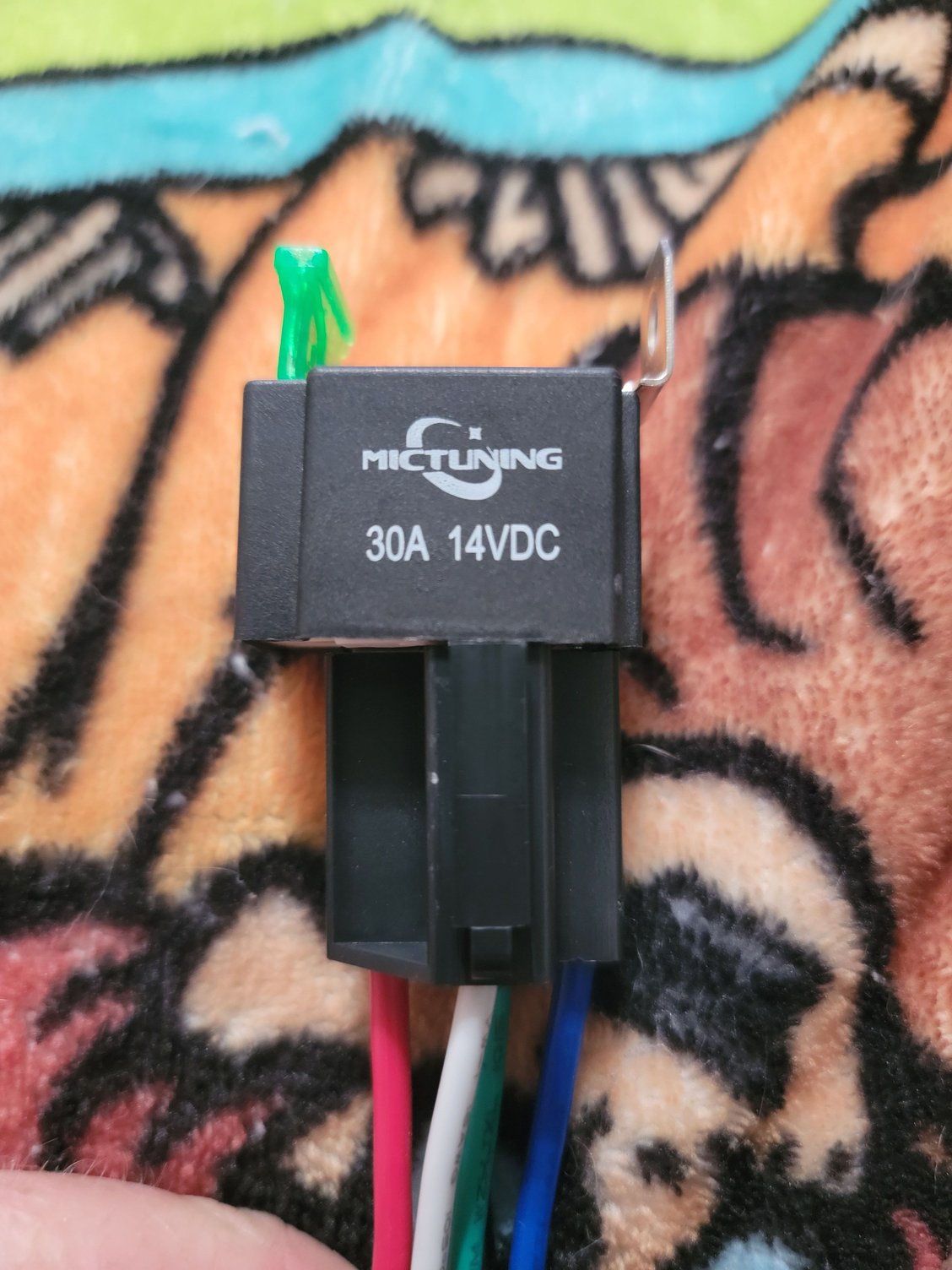

You won't find a 40 amp source through the fuse panel so the easiest thing to do is use the power and feed wires you already have. The easiest way I have found to wire up relays is to get pre-wired sockets for them. Make sure you get what you need for your relays as well. The pics below show the difference between 30 amp and 60 amp, fused and non-fused, 4 connector and 5 connector relays. Also the difference in wiring size for the heavy vs. light duty relays. You should use 4 connector, non-fused, 60 amp relays, but the 5 connector is easier to find. Linked below. The "normally off with ground trigger" wiring is the easiest for this application as well. Use the dash switch to trigger the relays with ground. The sockets can be linked together for ease of mounting.
irhapsody 80/60Amp 12v 5-pin Relay Kit, spdt 12-Volt Automotive Relay with Heavy-Duty Pigtail, 6-Pack https://a.co/d/eikVLid
