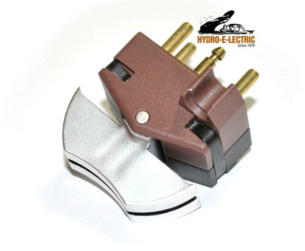

Here's the part number for the switch....
https://www.ebay.com/itm/114222714705

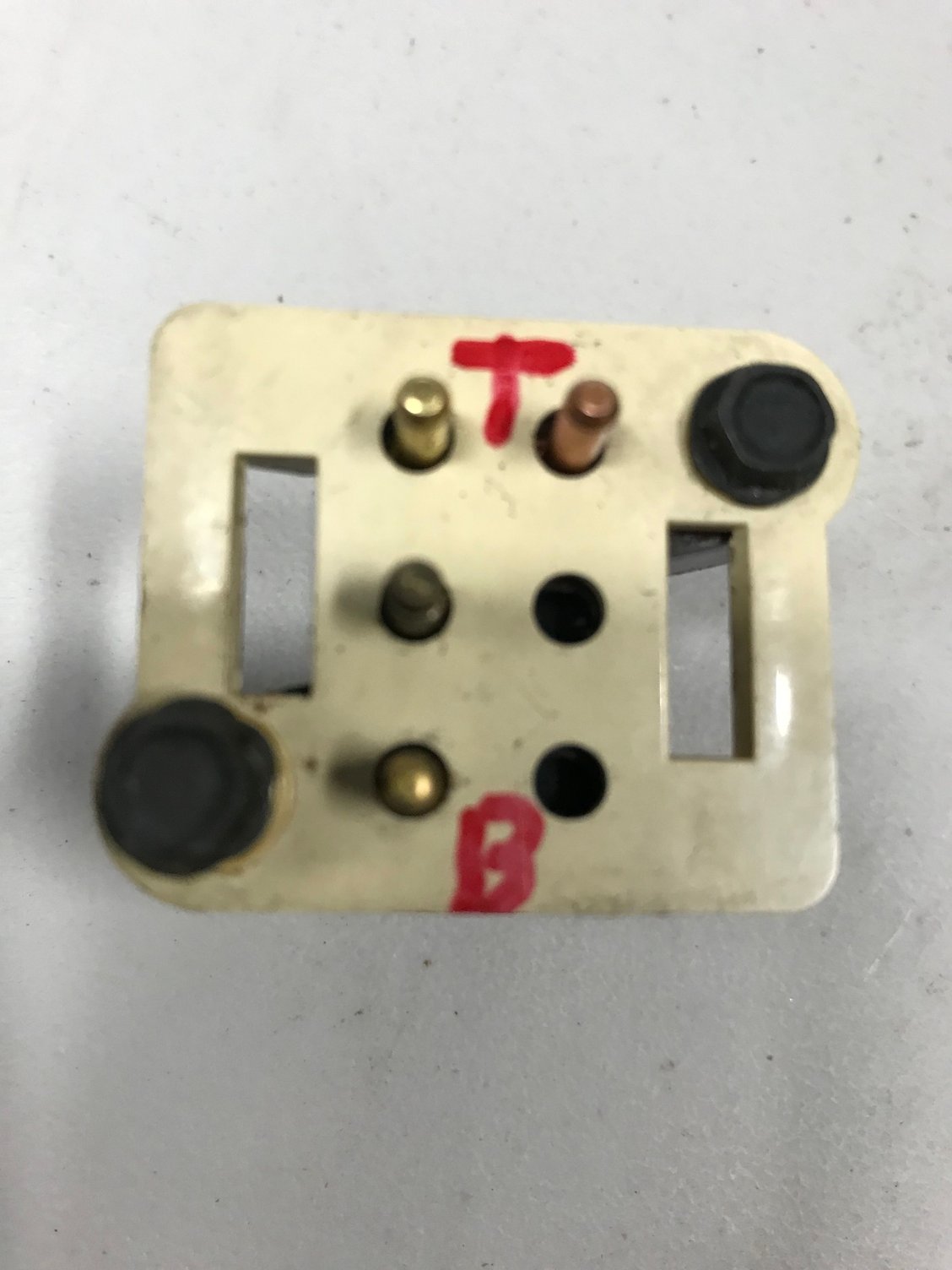

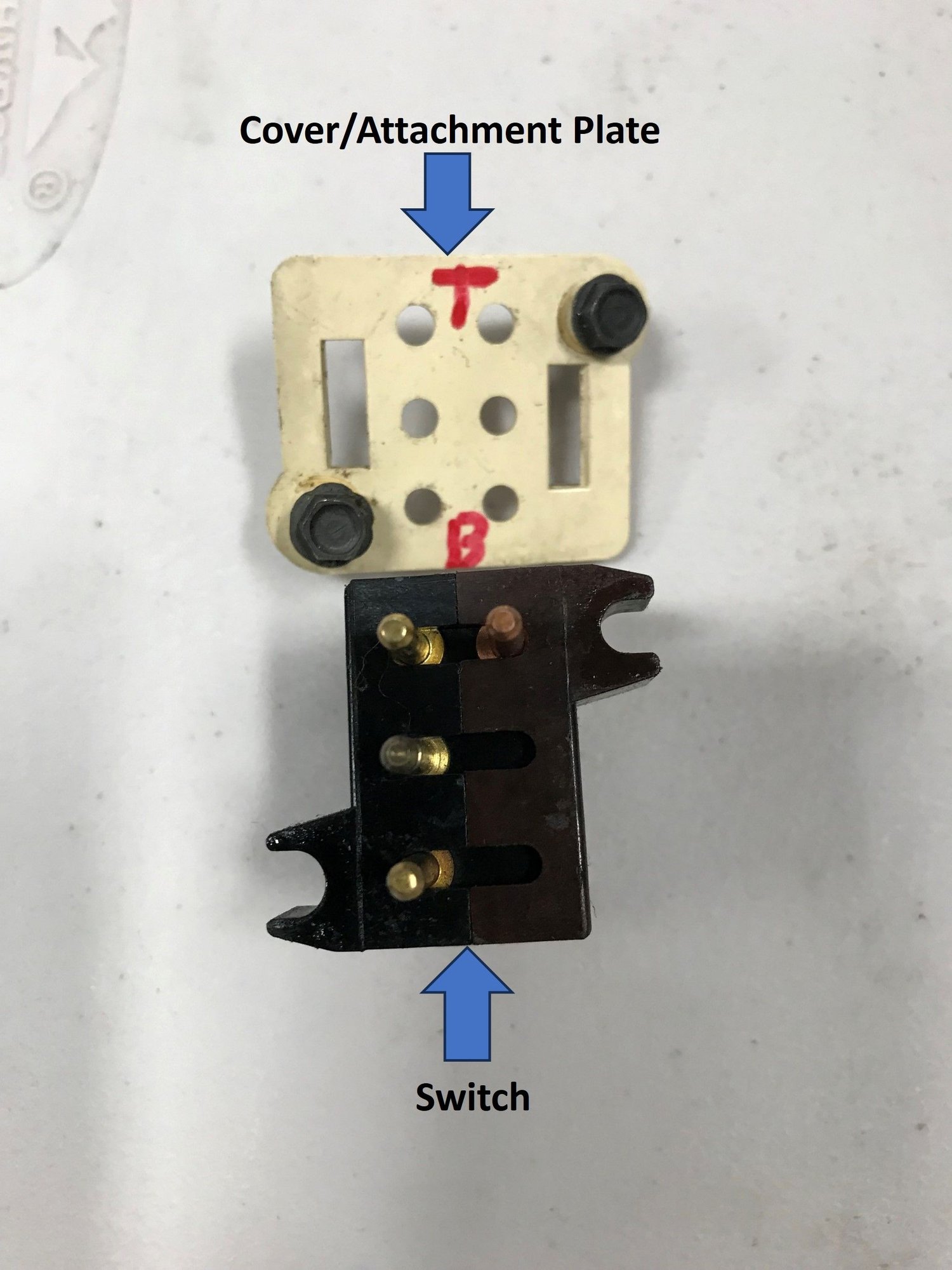

Here are several images I took after removal of the toggle switch demonstrating the backside business end of the switch which should help you to orient your view from the back.
NOTE: I labeled "T" (Top) & "B" (Bottom). Wish I could find my post instead of reinventing the wheel.

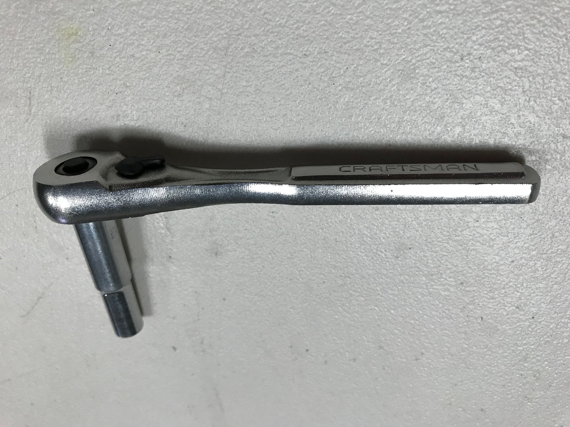

I used a 1/4" drive socket to remove the small bolts/screws holding the switch to the dash. My socket drive is about 5" - 6" long & slid in there rather nicely.
This visual aid is extremely helpful. I appreciate your help. Thank you.
Thanks again. Very helpful. One picture=1000 words.

Remove the wire harness connector first as you'll want as much leverage as possible pulling the connector away from the toggle switch. You're going to find the Top screw is easier to remove than the Bottom screw & part of this is visualizing the bottom screw as it sits nearly flush against the wall of the dash - still, you'll get it. So, remove the top screw before the bottom screw.

Note the white piece is a Top/Cover Plate which goes over the top of the switch in its mounted position. Therefore, you'll be saving the white Top/Cover Plate. The Top/Cover Plate holds the switch into position & secures the switch to the backside of the dash.
