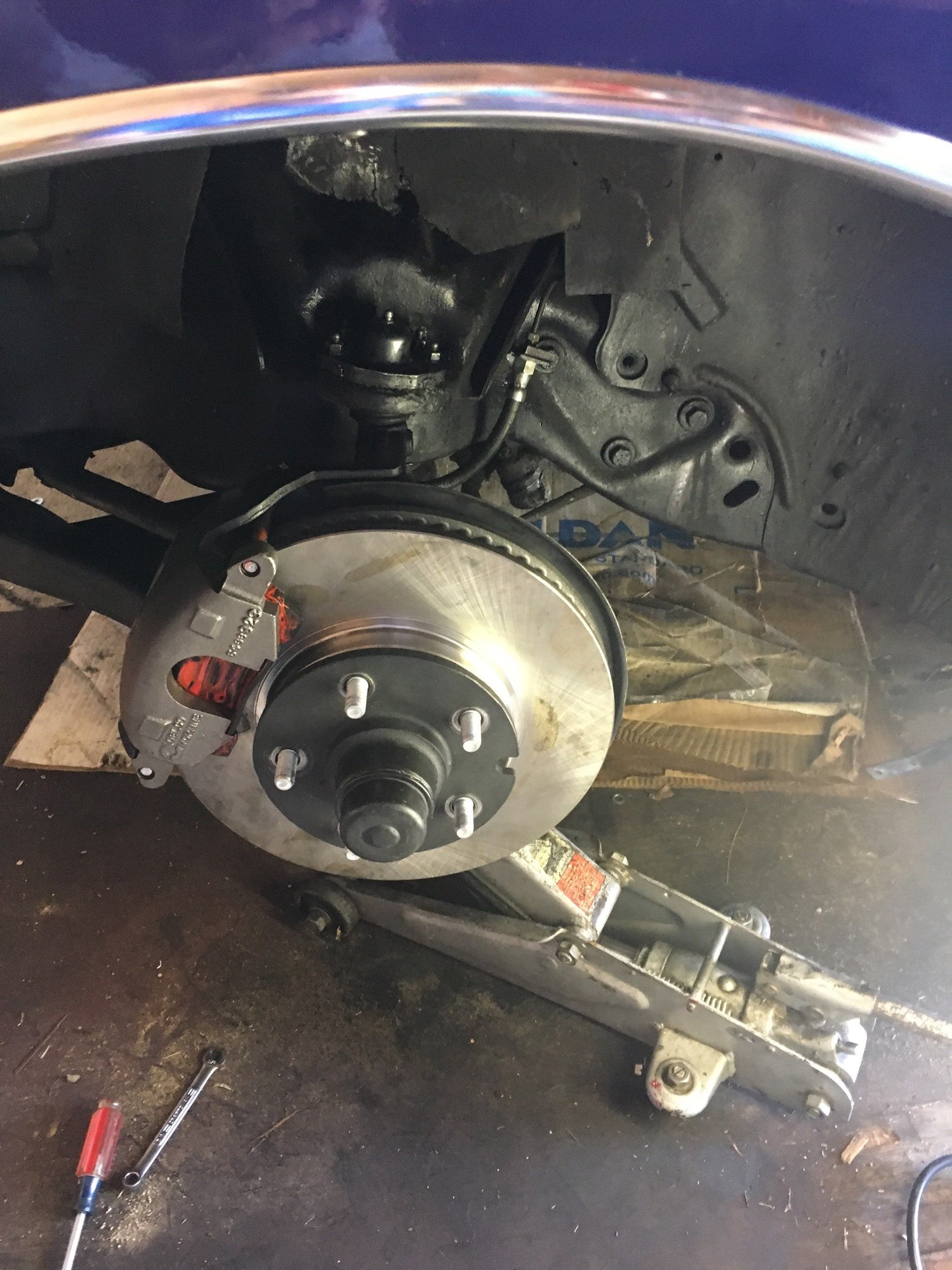

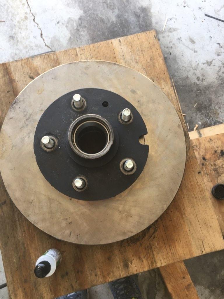

My friend Kevin is finishing my project. 2000 camaro rotors, machined to fit.

A little reverse order never hurt anyone.

I don't have the rotors any longer. I do know that the OD of the rotor is 11-7/8", and the rotor thickness is 1.25". The dimensions of the 69 rotor match the dimensions of the 2000 camaro, with exception to hub bore and bolt pattern.

The rotors for a 2003-2006 Cadillac CTS with base suspension are actually closer to the OEM 69-70 rotors. The Camaro rotors have a different offset than the OEM rotors, whereas the CTS rotors are the same within a a few thousandths of an inch. I've had a pair of the CTS rotors machined to fit - which simply requires drilling new lug holes and opening up the center bore. They work fine. The Camaro rotors are a better match to the 67-68 full size rotors that use the four piston calipers.

Ok, so when I looked the 2000 camaro rotor, it was so damn close to 69, all be that probably 6 years ago when I looked. I recall it being within 1/16 on hub height. With a floating caliper, it'll compensate. Here's some more progression.

The Delmont is back in service. My friend reports he took her out last night and pounded on the brakes, and has never felt such good brake pedal response. He also used a 71-76 booster and dimpled the fender well for the lines.

Correct, they are 11-7/8 diameter. Also, the rotors that were used in the swap that I have documented are for 2000 Camaro. The finished product has been in service two years now.

This build used '69 Delta 88 spindles and caliper brackets with the 2000 camaro rotors.
