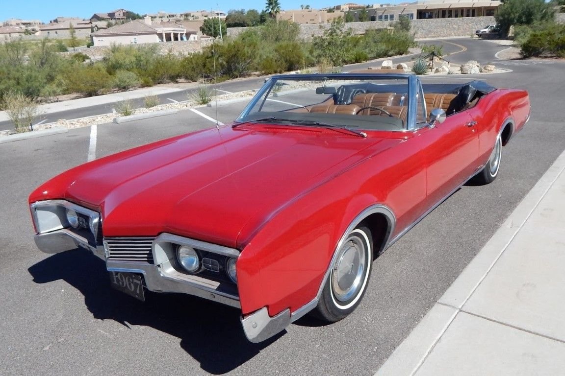

Of course it is. This is one of the reasons power windows were invented. But it's not the point. The point is, no matter how comfortable is to be able to move all the windows up and down from the driver's seat, the fact is that finding a power window setup that you can transfer to your car is likely to be difficult if you want something from another '65 Olds (or any '60s Olds) because power windows were the exception, not the norm, in those days.
You'd have other issues, too. Cars with roll-up windows have a crank handle and a hole in the door panel for the crank shaft to pass through. Cars with power windows didn't have this. So if you mount power windows, you'll be removing the manual crank, but you'll still have that hole in the door panel, which would have to patched or filled in in some not-awful-looking way.
Thirdly, you'll be running lots of electrical wire as wires need to be routed from the fuse panel to each door. Where you take power off the fuse box is also an issue. I'm guessing that all cars got the same fuse box regardless of whether or not power windows were actually on that car, and that cars without power windows just had an empty fuse slot where the power window fuse would be. But there may not be any metal connectors for the fuse to be pressed into. So you might have to do some modification of the fuse box if you want to wire it up like the factory would have. You could, of course, take power from another source, but you'll want to make sure that everything is properly fused.
I've got a '67 Delta 88 convertible without power window. Yes, I have to go around and lower all the windows by hand when I lower the top or whatever, but I don't do this every day. And I DO like the fact that I don't have to worry about power window motors failing, electrical issues, or anything like that. Just need good old human effort to move the windows up and down.
If I were to remove the crank shown, how would I repair the hole left behind? After locating the power window switch, I would probably have to have the entire side panel reupholstered. That would be true for all four window locations, which means reupholstering both front door interior panels.
To me, there is something very classic and very '60s with the roll-up window look.
Your car was born without power windows. I'd leave it that way.
