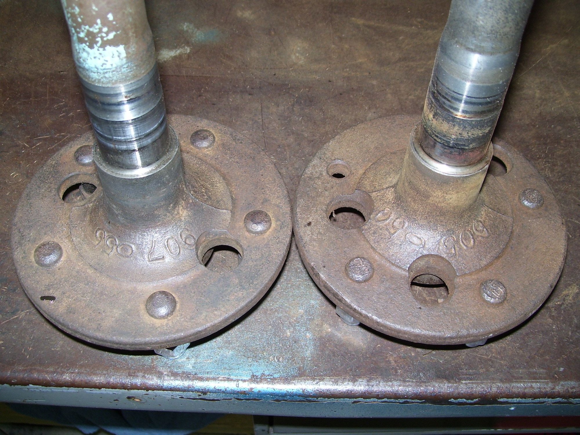

Hi, ive been trying to identify the 2 axles that came out of a 1969 olds 442 391 12 bolt posi, cant really find anything, is there a site i can go to that will tell me what these are, i put some pics here so you guys can see them, there both 28 spline but the numbers are different ?? one is 907 o55 with the letters AD the other is 605 o50 with the letter H ?? thanks for looking and thanks for those who respond !! john...

If they came out of a type O rear end than their Oldsmobile axles. Olds is the only one who used the Type O rear ends. I don't know why they have different numbers, but if they're both 28 spline they must be from a 1969 or 1970. The 1967 and 68 3.91 gears used 31 spline axles. If this doesn't answer your question then please add more to your post so we know exactly what your looking for. John

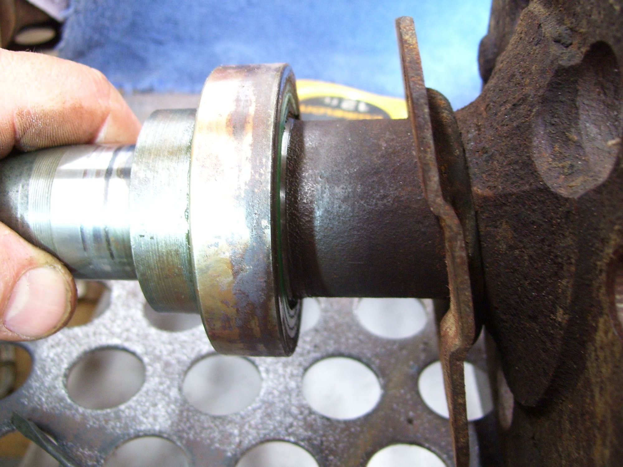

The O axle used two different bearings and seals through its short run, And I think the vista wagons had an even larger axle shaft diameter and thus different bearing ID. If they were my axles, I would want to measure the axle surface where it rides on the bearing...and see if that dimension leads to possible answers.
Are the old bearings and seals laying around near by....?
Yes, the 67-69 rears used sealed bearings with an oil seal pressed into the end of the axle tube. The 1970 version used an open taper bearing with the oil seal sandwiched between the bearing and the axle retainer flange, same as the 71-up corporate 10 bolt rears.

i talked with Greg at super cars, with my casting number's on the differential which is 402227 and my axle bearings he sold me i have the 28 spline 1967-69 12 bolt o type, these bearings were cut off so i can put the new ones on he sold me..

Yep, that is the early style (67-69) sealed bearing.

12 Bolt O Axle CARRIER CASTING NUMBERS (O.E. ANTI-SPIN CARRIERS) Casting Number Year Ratio (673 1970 2.56-2.78 28 spline axles) (671 1970 3.08-3.23 28 spline axles) (588 1967-1970 3.42-5.00 28 spline axles) (672 1967-1968 3.42-5.00 31 spline axles) i got this from supercars site hopefully this will help, john...

OK gang, i got the scoop on the axle # numbers, i called Greg from supercars unlimited, he told me those numbers are just foundry # numbers like where they were made etc etc, even day shift or evening shift, he said as long as they measure correctly and have the correct number of splines your in business, even though mine or 2 different numbers he said that still could happen but it is a 50 year old rear end and somebody along the line could have changed one, so that's the scoop !! john....
