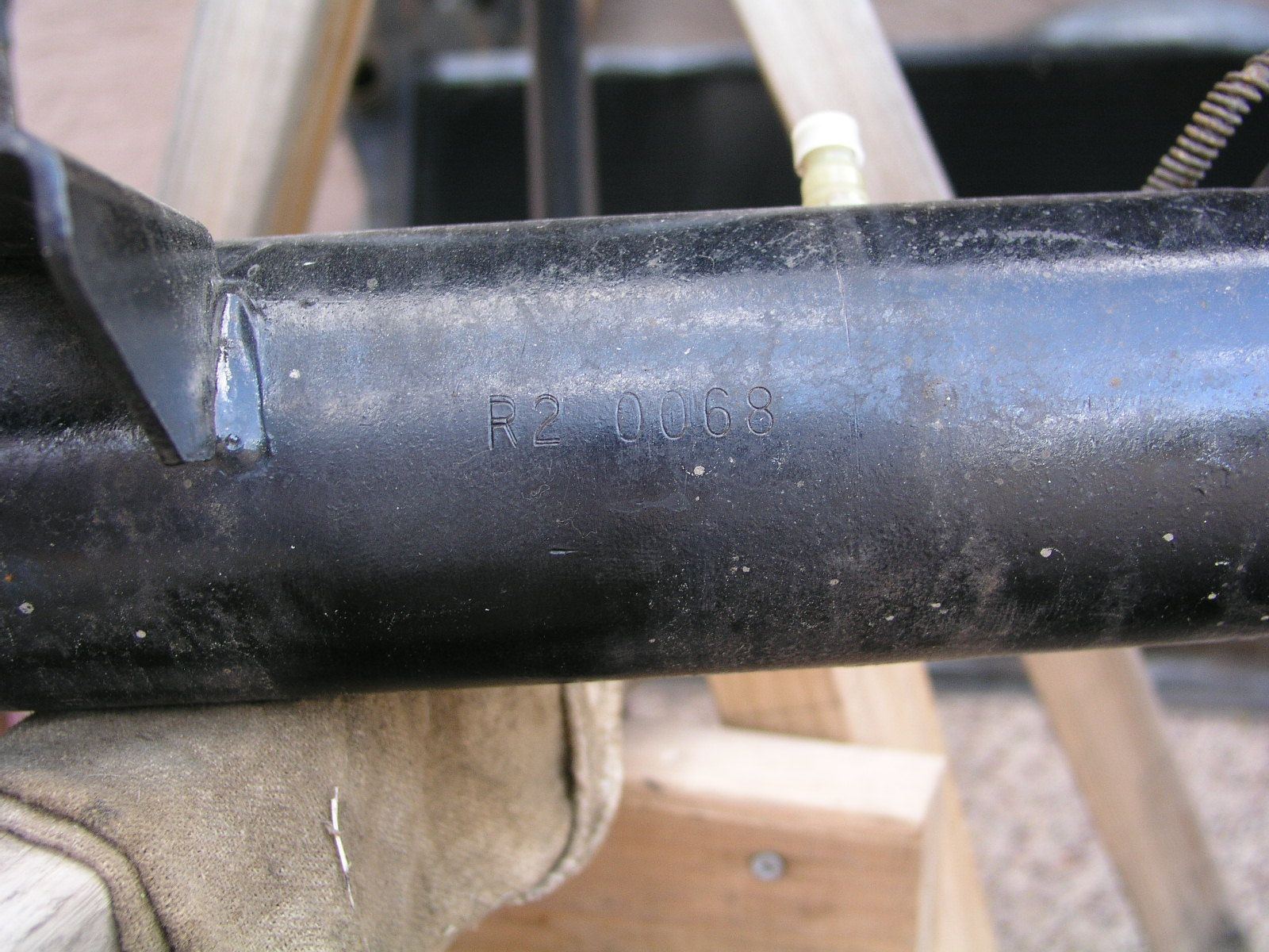

You can crawl under the car and find the differential code letters stamped on the right front inboard side of the axle housing tube. The first two letters designate the ratio code. The letters are ~1/4" high. You may have to wire brush the axle tube to remove the grime. Picture below is of mine. R2 = 2:56
I don't know the answer to your question regarding the standard or most common; but, I suspect a standard or most common gear ratio would be of the particular "SERIES" of vehicle. Once you find the differential code letters, post them and we can provide the differential gear ratio.
Mine is a 1971 CS Convertible sbo.

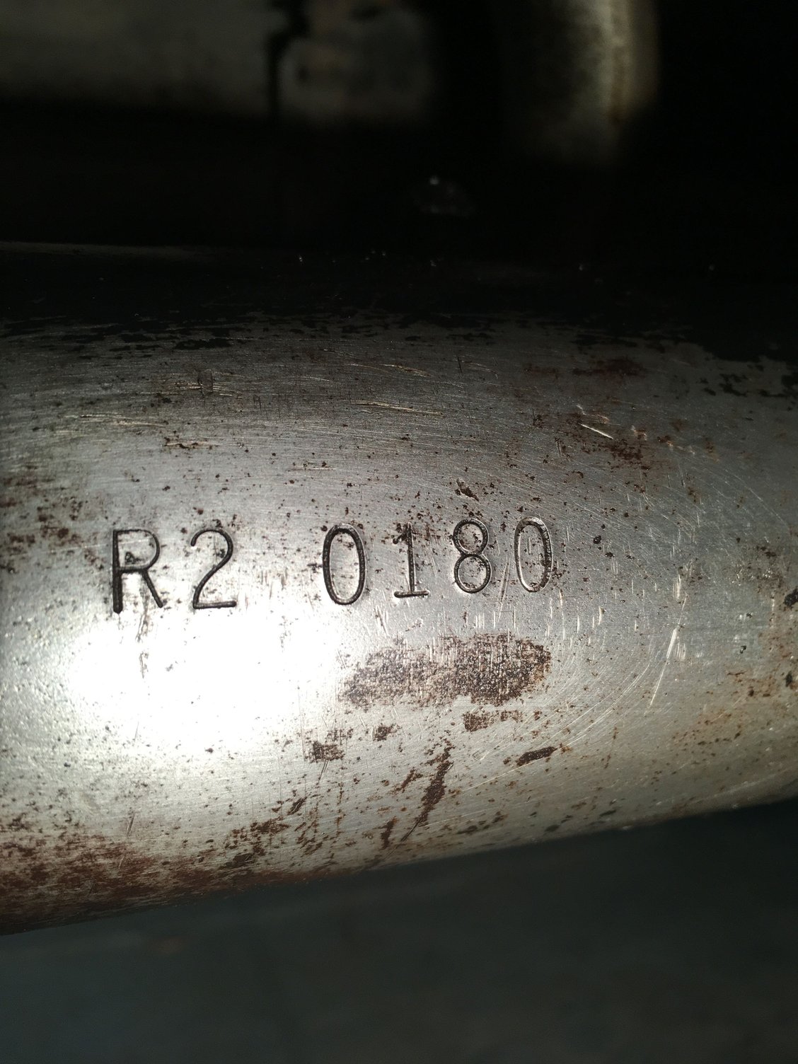

FYI, this is the code on my 1971 rear with 2.56 gears. Note that this rear has been wire brushed to remove rust, dirt, crud and has been painted. The stamping is difficult to see on a rear that hasn't been cleaned up.
