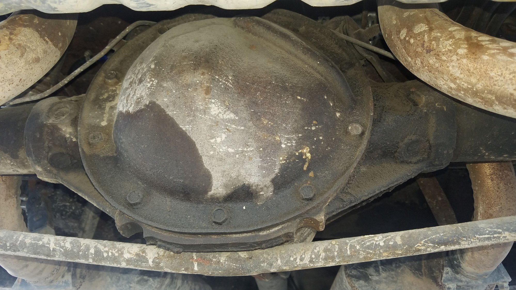

I found this number on it 407299 if that helps to know what carrier I have.
Old May 18, 2020 | 08:33 AM
monzaz's Avatar
Joined: Jul 2006
Posts: 1,826
From: Richfield, Oh
numbers
CArrier?
That is the casting number of the housing? Y/N?
It will not tell you which carrier you have? 2 or 3 series posi or non posi etc.
or
Am I missing something?
we IDed the rear as a 8.5 GM
Old May 18, 2020 | 09:48 AM
delta254's Avatar
Joined: Mar 2011
Posts: 221
Casting
Originally Posted by monzaz
CArrier?
or
Yes sorry that's the housing #..Both tires turned the same direction so I'm sure that's POSI but I could not calculate my gear ratio I came up with 3 or so..I do know my RPM stay pretty Low on the hiway.
