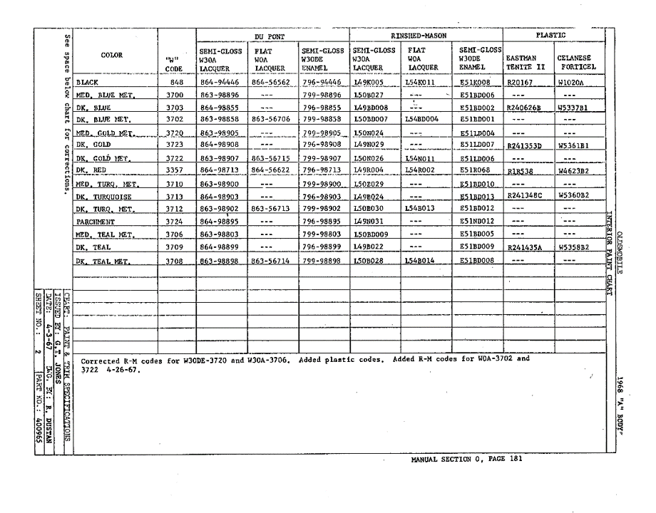

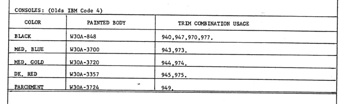

Looking for advice on what type of paint to redo my center console on my 68 Cutlass conv. And also the metal dash? I have a black interior car.
Thanks in advance

The metal dash is painted just like the outside of the car. The formulas/color codes are in the Product Information Manual. The plastic console either needs plastic paint or an adhesion promoter prior to using other types of paint. Typically you'll want to use enamel on the plastic.

SEM brand landeau black is a good choice for the console

If you have the paint code, any automotive paint supplier should be able to mix paint in the correct formula for both metal and plastic.
