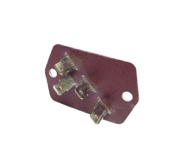

Second, my fan only runs on high. The car came w/ a/c but is has been removed. I read something about this repair before but could not find again. Need to install something, I think a resistor or something. Any ideas?
Motor fan speed is controlled with by a selectable resistor network that's bolted into the HVAC box on the firewall. If the resistor isn't present or isn't hooked up, you'll only get high.

On the fan speed, what resistor do I need and where does it go?
The resistor is bolted into the HVAC box on the firewall. The airflow from the blower motor helps keep the resistor cool.

I added an a/c delete box from American Graffitti so the fan will push air into the car.
Since the fan resistor is mounted to the evaporator box that was replaced by the delete box you installed, that might be part of the reason the lower fan speeds don't work.
