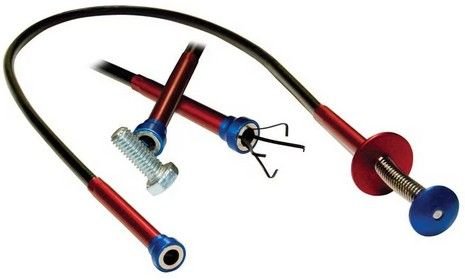

I had a grabber tool for many years but it's been AWOL quite some time. Not certain I could/can get hold of the glow plug, but likely a try might be worth the effort. They make a variety of sizes/styles/shapes. Think I'll head to Ace & a parts store around noon tomorrow. I really, really, really don't want to pull the valve cover & likely the fuel injector oil rail stand pipe to fish this bastard out. The tip of each glow plug is centered at the top of each cyl. in the intake manifold in what would be nearly directly in the center of the moving piston. The immediate amperage draw from the battery makes each glow plug 'glow' (heat up) very quickly. You can't start a diesel w/o a glow plug. Glow plugs shut down (no longer heat-up/draw amperage) once engine is started as they are no longer needed (in most diesel engines). The high compression along w/ diesel fuel in each cylinder fires each cylinder as opposed to a low compression gasoline engine which requires spark plug(s).
EDIT: With a couple images this time.

(3) Ray - I tried the vacuum I really thought it might work - had a great fit to the GP hole & I thought it might have a chance. No luck - thus far. There still 'might' remain a possibility based on what I found (next, below).
(4) I need 1/2 dozen arms & hands to maneuver in position(s) and it's literally impossible to visualize where the GP is located. My only attempts to visualize require both a directed light source from a pen-light & a small articulating mirror. Well, I'll be damned I was looking at what I 'thought' was the tip of the GP but it is not the tip of the GP. Hell, may even be a chance it's like a ball between a rocker arm & push rod - who knows; but, it damn sure isn't the lost GP. Turning my arms, legs, neck into a better position w/ both pen-light & mirror I have now unmistakably found the GP. Not where I suspected. Still in the void area, but certainly not where I was attempting to retrieve it. With better visualization I can now see nearly the entire top 1/4 of the 5" long GP. I could stick my pinky finger in there and actually feel it quite well. This has me quite relieved, since;
(5) I purchased a new flexible clamp grabber this morning at Ace Hardware. I haven't tried to grab the top of the glow plug, yet; since I'm taking relief from these bodily contortions. I'd say my optimism of retrieving this GP has 'soared' from 4% or 5% to a whopping 25% - that's significant. I'm looking forward to getting back at it and have my fingers crossed. If the grabber isn't working I might still have a chance with a smaller vacuum nozzle now that I know where it is located and can visualize it.

I removed the GP w/ a ($5.99) Grabber Pick-Up Clamp Tool I bought @ Ace Hardware this morning to replace the one which went AWOL many years ago.
