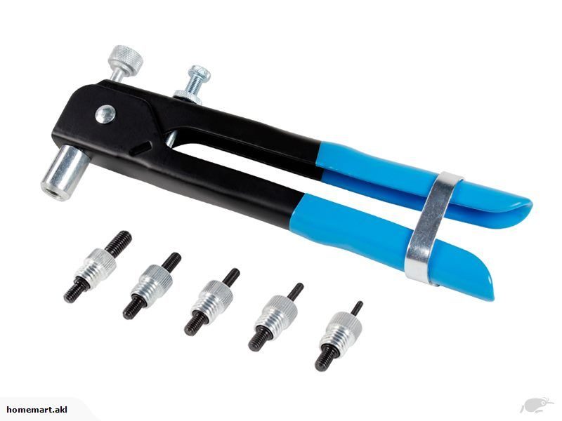

You need a nutsert (also called Riv-Nut). Basically it's a large pop rivet with internal threads. Requires a special installation tool, like a big pop riveter.
