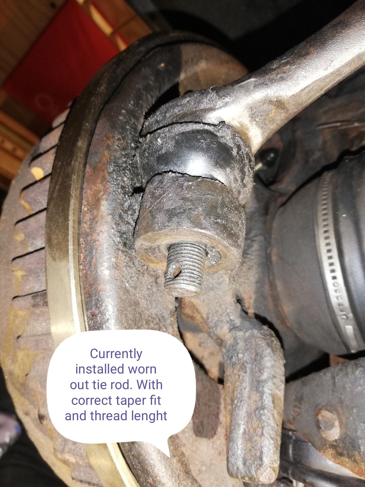

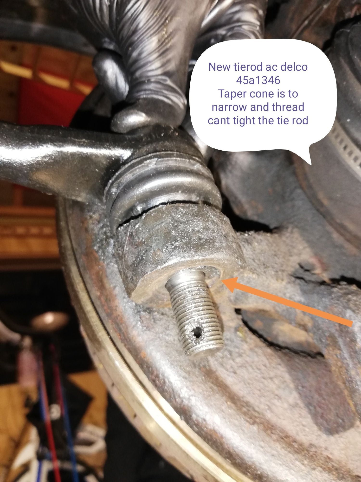

I found out that the new tie rod has a different taper fit. the taper is smaller on the bottom which allows the tie rod to slightly deeper down and due to that, there isn't enough thread to fully tight the castle nut.
I added a few washers to solve the problem.

You have the wrong taper tie rod. Doing it the way in the picture may cause the shaft to pull out of the socket.

I wouldn't drive my car like that! Worn tire rods are preferable to tie rods with the incorrect taper. You should be able to get generic tie rod boots for your old tie rods (not sure if these are the correct size though).
Amazon Amazon
If you don't want to order another part from the US then find some tie rods at your local auto parts store and take the boots off of them for your old tie rods. BTW, did the local inspector pass your car with the washers on the tie rod? If so, then...
Ultimately, you need to remove those tie rods and get RockAuto to refund your money. Good luck!

66-72 use the same steering components. 73-78 are different. RA shipped you the later style tierod end. People converting earlier Toronado to later style disc brakes run into this all the time.

I just recieved a NOS tie rod from Ebay and it fits perfectly.
it was produced by Perfect Circle chassis parts under nr 269-2179

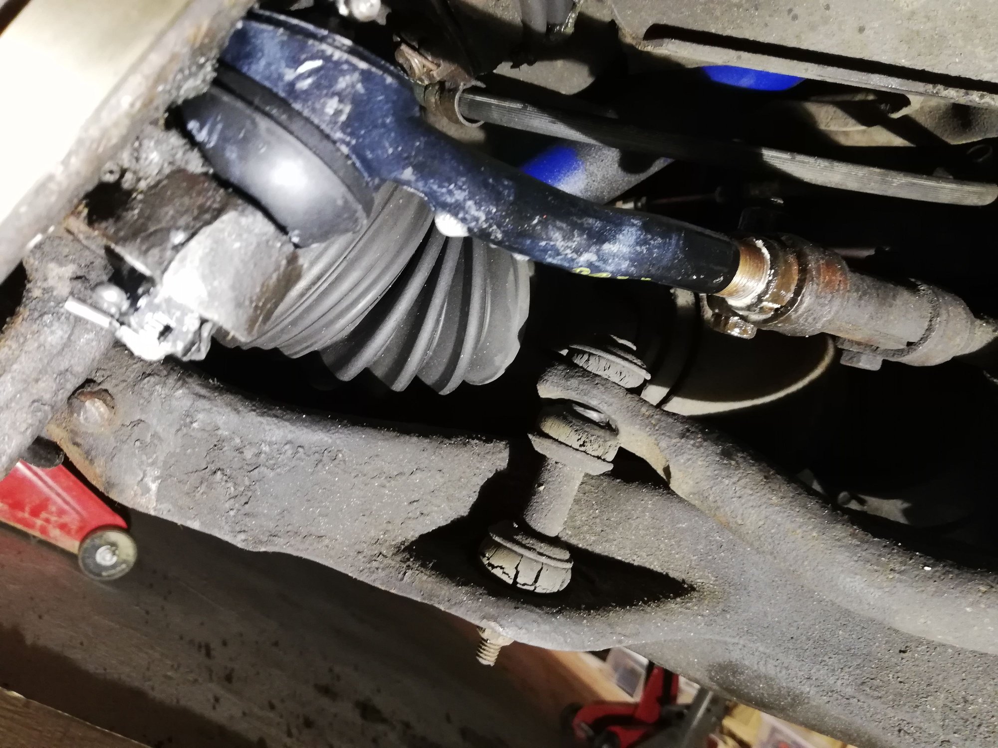

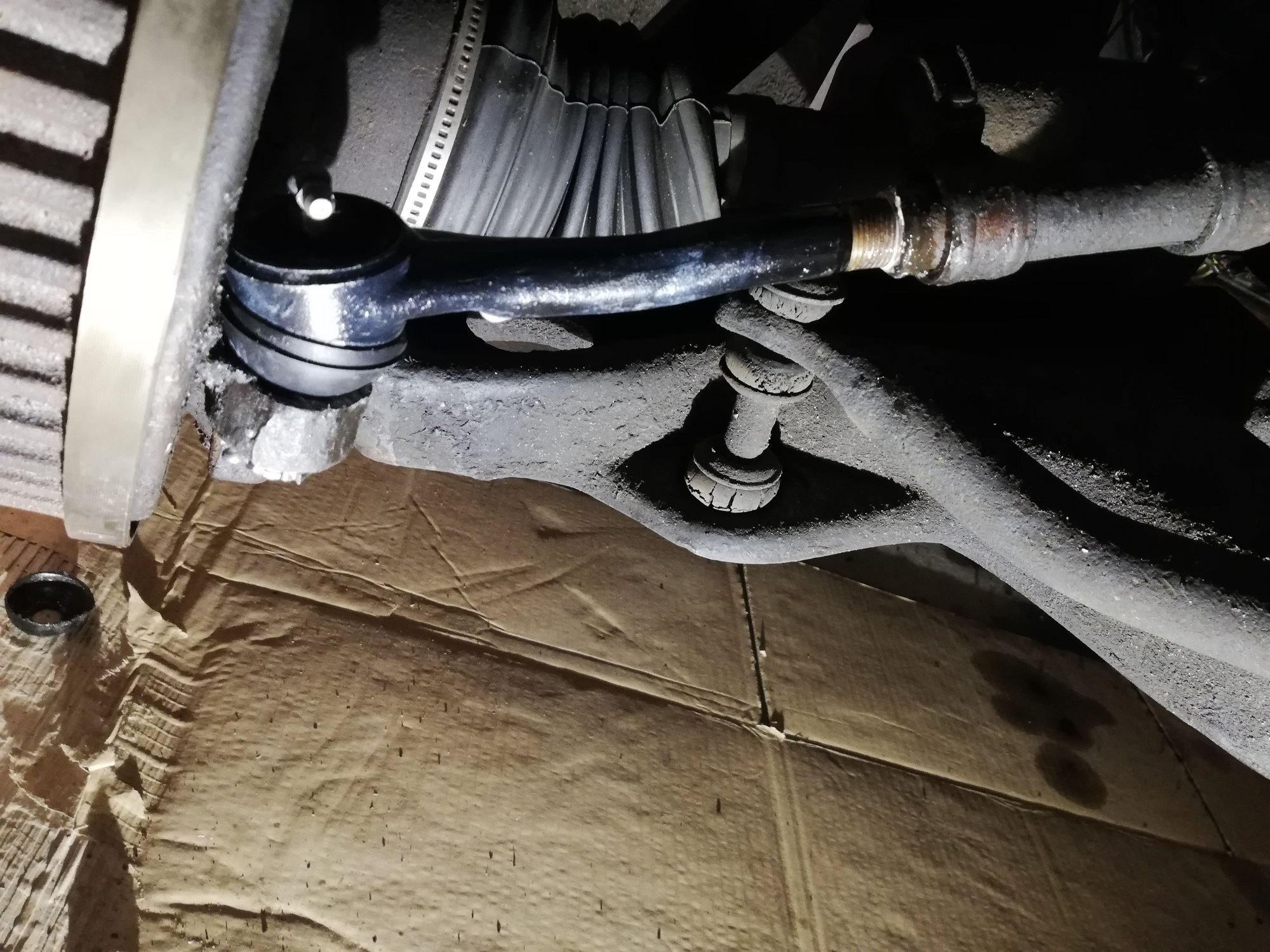

Glad you got the right one. Looking at your sway bar bushings, you may want to inspect/replace all the rubber bushings in your front end.

^^x2^^ Those front sway bar end links are toast. Order/Install new front sway bar end links. Order up a new set of front sway bar mount bushings, as well.
