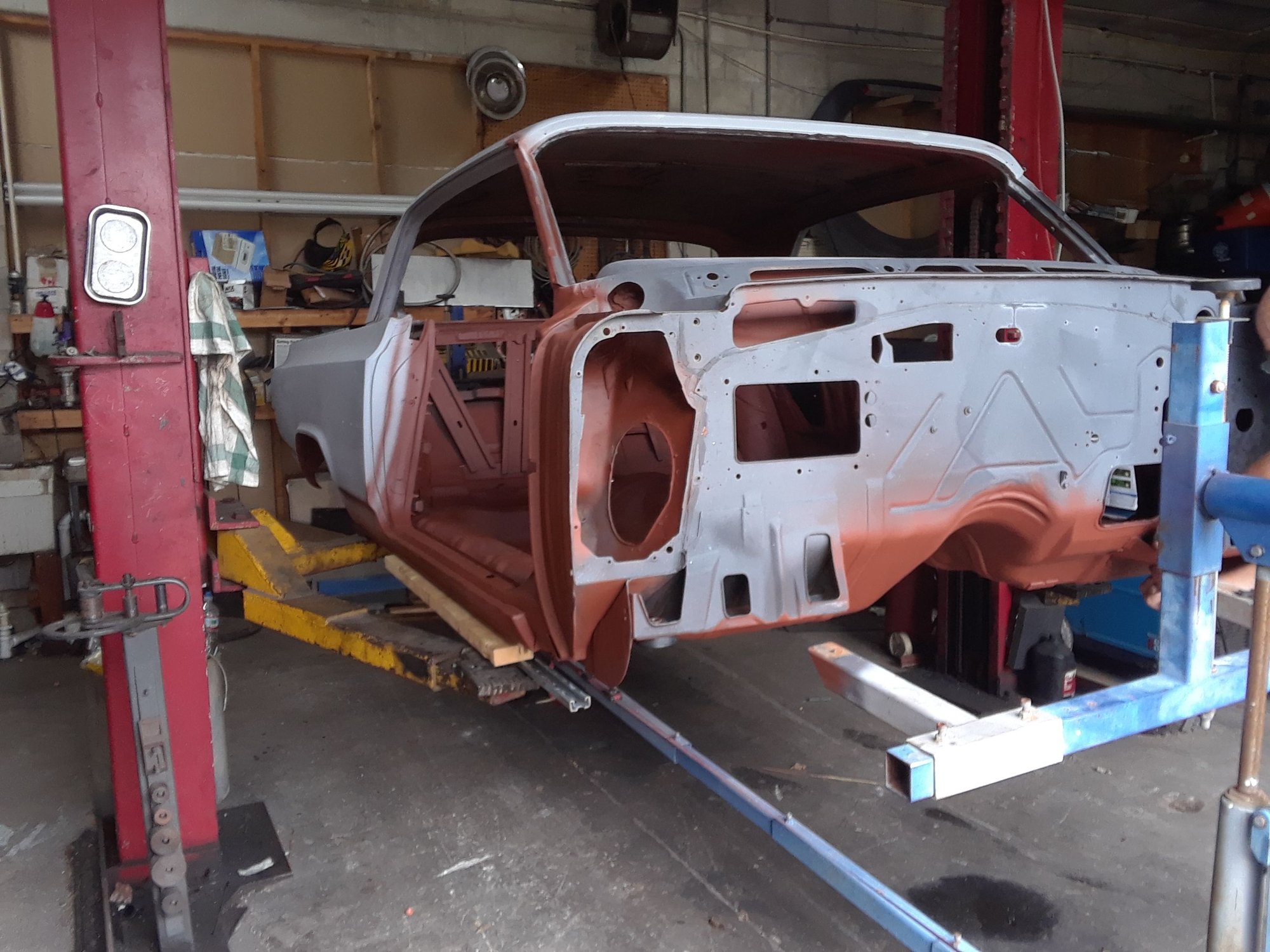

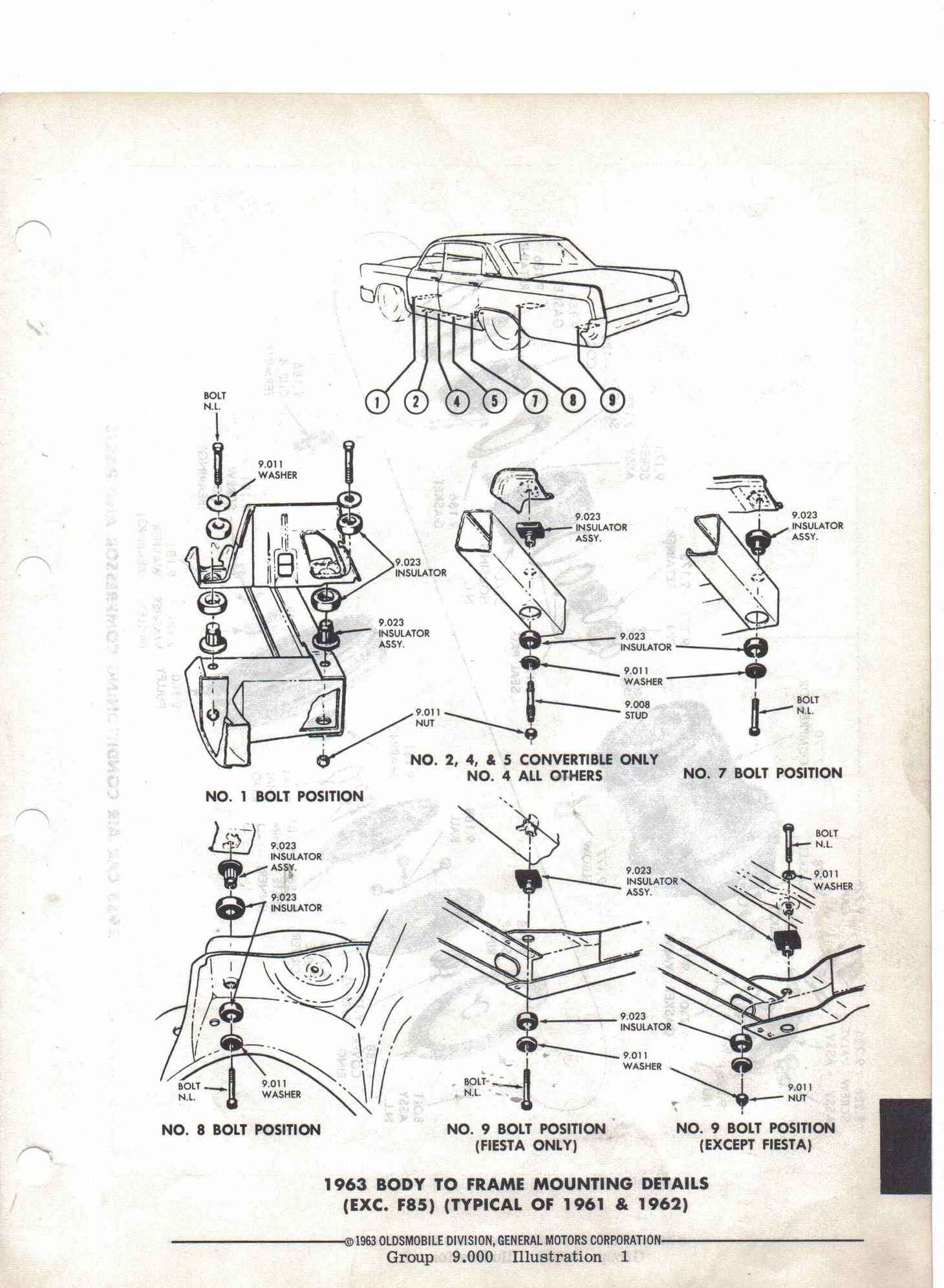

You will probably have to remove the rear bumper also .
The radiator support must be un bolted from the chassis , also all hoses and wires that go to the engine .
The body should be lifted under the rocker panels .
I used a 2X4 and slit it about 1/8 in wide and 3/4 deep so the slit accepted the rocker pinchweld .
Here's a pic of
the body mount locations and a couple of pics of my '63 Dynamic going back together

Thumbs up for the diagram and your pictures.
