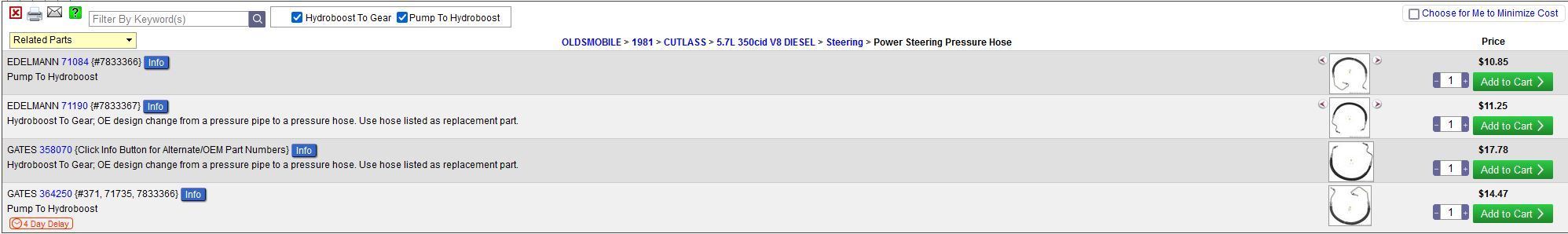

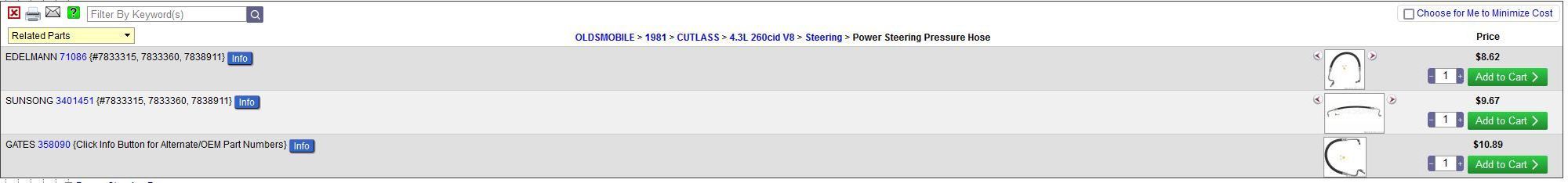

How hard did you look? Rockauto shows availability of power steering pressure hoses for all of the various flavors of '81 Cutlasses. You don't way what engine is in the car, but here's their listing for the 260 V-8.
I'll be if you went to your local O'Reilly's, Autozone, or NAPA, they could get you one as well.

I need one that’ll work with a 5.7 olds diesel that’s what the car originally had in it and that’s what the pump is for I work at Napa and I looked on our parts system and we couldn’t get one without custom ordering it and as far as I know rock auto didn’t show me anything for that

Rockauto shows availability of the pressure hose for a Cutlass diesel as well.
