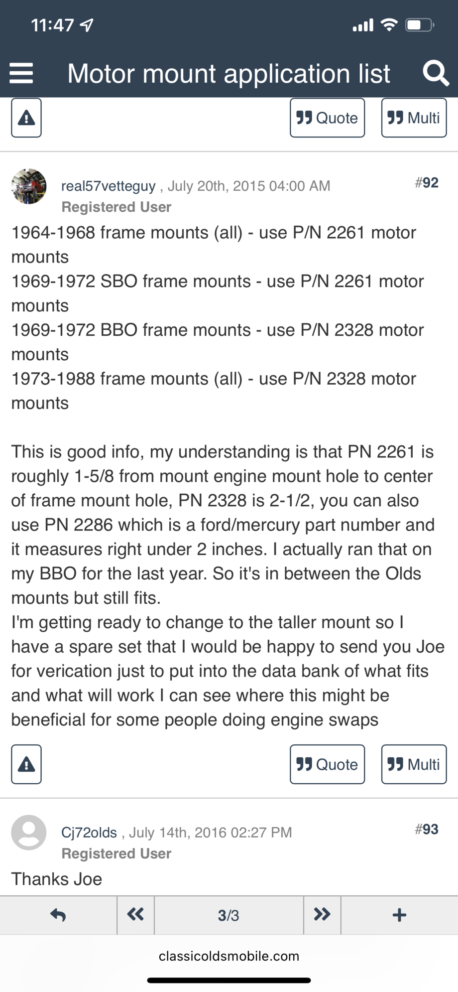

Yes they are brand new anchor 2261 mounts. Interestingly what I took off the old motor were worn out 2286 which were ford parts but cited as something slightly taller then the 2261’s by a member on this board.
First I've ever heard of this

Joe it actually came from your motor mount application thread. I read it there before my motor swap and was surprised that was the mount on my 330 I removed.
