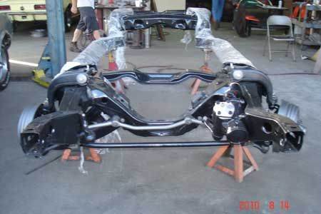

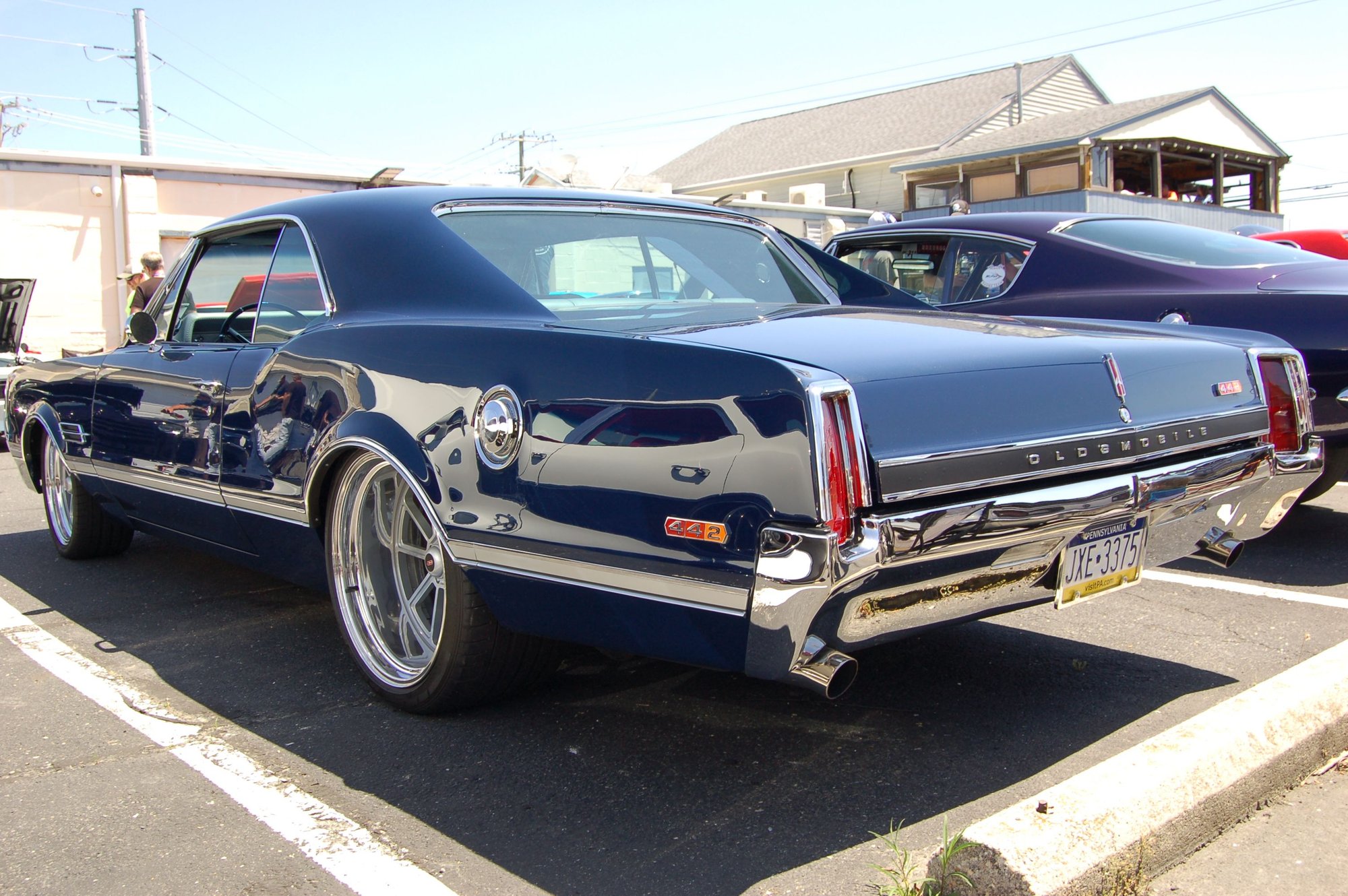

The front frame horns are straight on a Chevelle and offset out on a cutlass. The Chevelle hardtop/ convertible frames are also about 3" shorter in the rear along the gas tank under the trunk. I am pretty sure this 66 cutlass has a Roadster Shop frame under it. You might to reach out to them. They make an awesome product.

Here you can see the front frame horn difference which is the biggest change between the chevelle and cutlass.
Chevelle:
442/ cutlass frame:
Buick, Pontiac, and Chevy A-bodies all used the straight front frame horns from 64 to 67. Olds, Buick, and Pontiac were all about 3" longer than chevy in the straight section of the rear frame rail along the gas tank area. This makes the Olds (and Chevy) frame unique. The rear frame length differences get a little more complicated when talking about wagons and ElCaminos as the chevelle wagon and ElCamino rear frame rail length is the same as the Buick, Olds, and Pontiac 2 door rear frame rail length.

Obviously these frames/complete chassis are not cheap, so finding one for a ‘66 Cutlass/442 and having the company do all the modifications before delivery would be ideal. Roadster Shop looks like a reputable company that does nice work. Tom do you know if that blue 442 had the complete chassis setup (tubular suspension/coil over rear) or just the frame ? Did t you get to talk to the owner about how she rides/handles ?

The owner said it drove and handled like a modern sports car. it had full tubular suspension with coilovers, power rack and pinion steering, and large baer brakes all around. The Roadster shop does a lot of their own full custom builds in addition to just building frames. My brother and I went to the Columbus Goodguys show in 2021 and I think Roadster shop had like 12 of their cars at the stand. They seemed like very nice guys. They were one of the shops selecting the top ten builders choice awards and I got to talk to them for awhile when they were looking at my wagon (no award though). If you are considering buying a frame from them, it may be worth asking about getting a ride in a car with one of their frames. Even if you do not live close to their shop they may be bringing cars to a show in driving range, or know someone near you with a car you could ride in.
