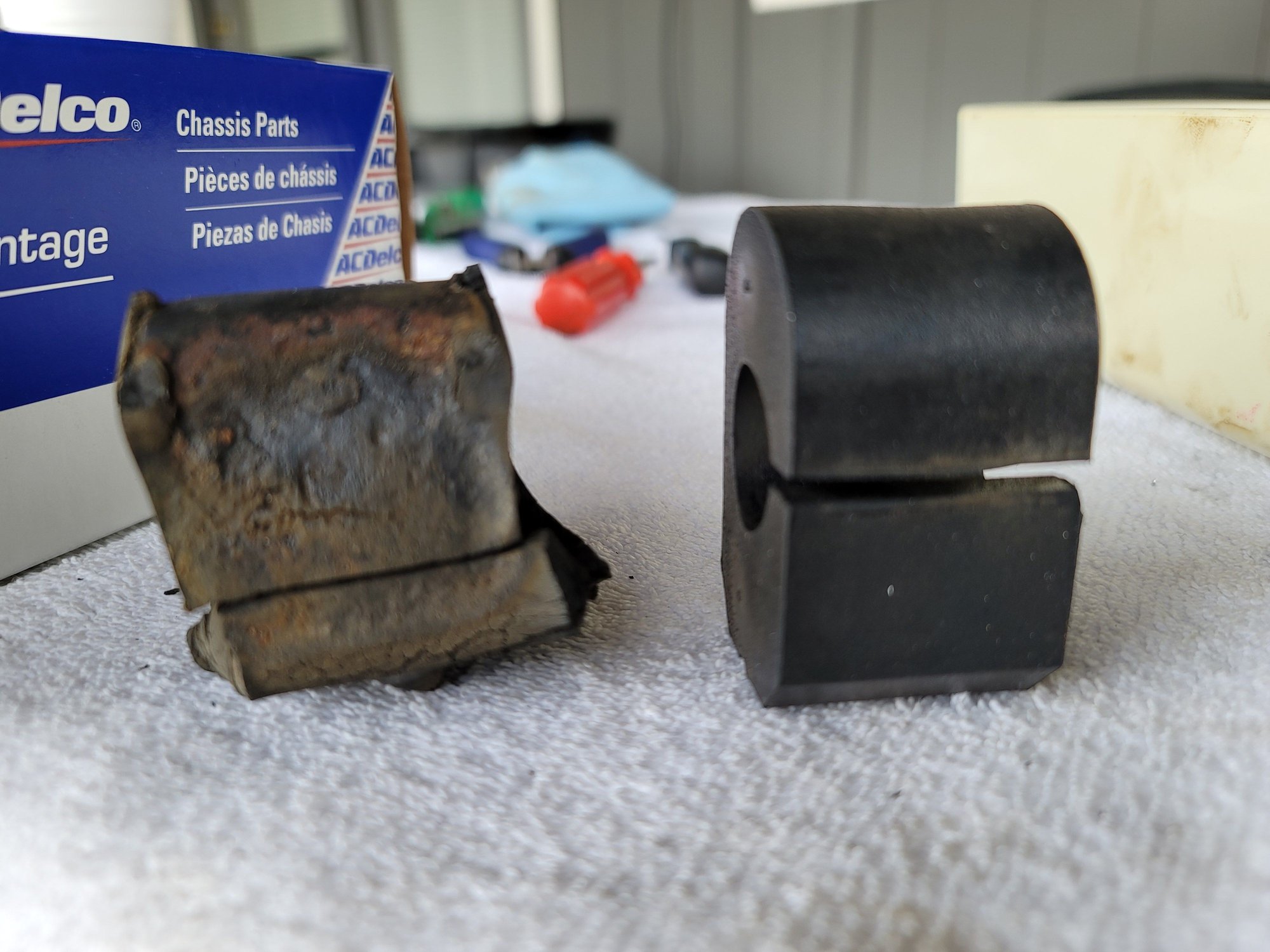

Bushing photos
Guachobyte, did you find a resolution for this? I'm having the same issue. All bushings showing up via Rock Auto and Summit seem to be the tall version. I got the AC Delco bushings via Rock Auto and they absolutely don't fit.
Joe, the Moog part you listed looks just like the bushings I got. Are they not as tall?
Thanks for any help!

the moog ones are to tall also, I got ones that work from inline tube.
INL13145 for a 15/16 bar. only ones I could find that would work.
Jeremx: not sure they are the correct ones but I finally managed to compress them so the bracket reaches the chassis, but forget about the CSM torque specs. Best.
Based on your handle, I'm guessing you're referencing a 1966 but I wanted to be sure. What model did you end up putting these on? And any chance you have photos of them on?
