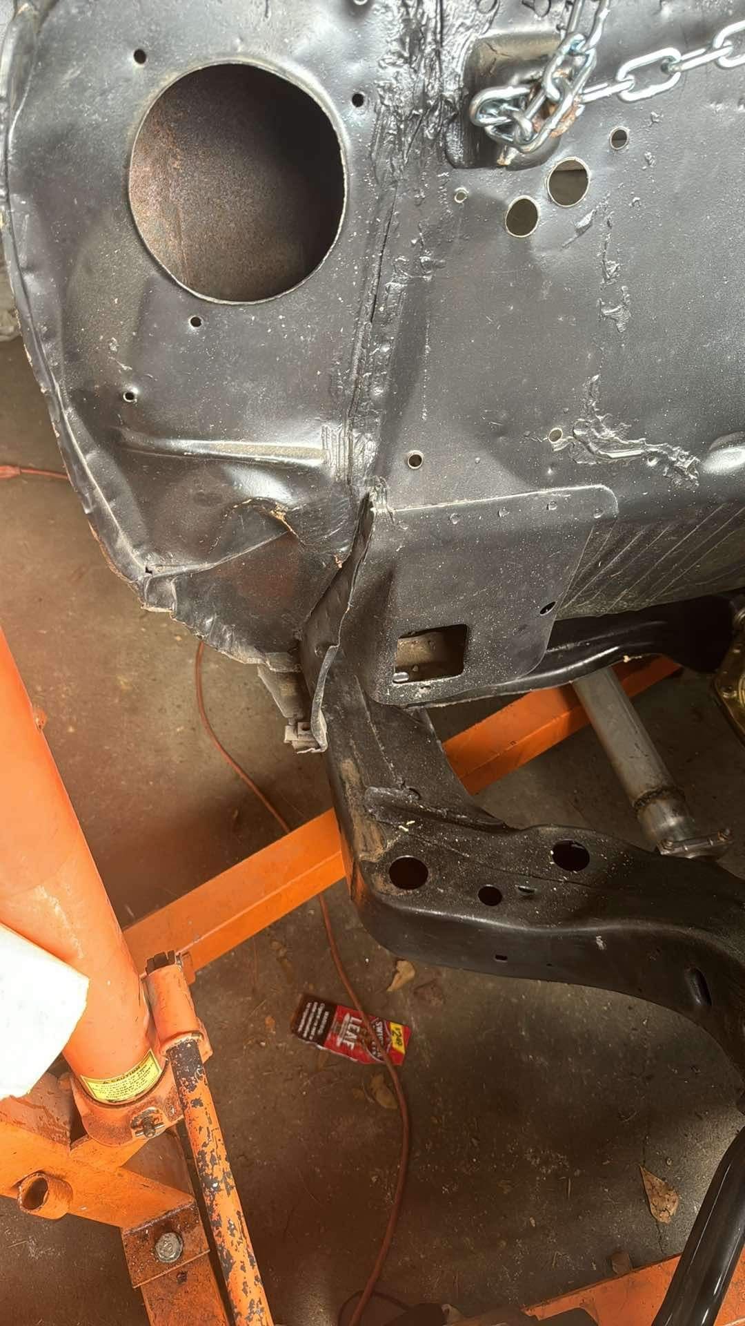

The front of El Camino doesn’t line up with 1970
cutlass supreme body after this shortening c section; like body mounts are off and front steering is a couple inches off of connecting to steering rod and steering rod attachment(s).

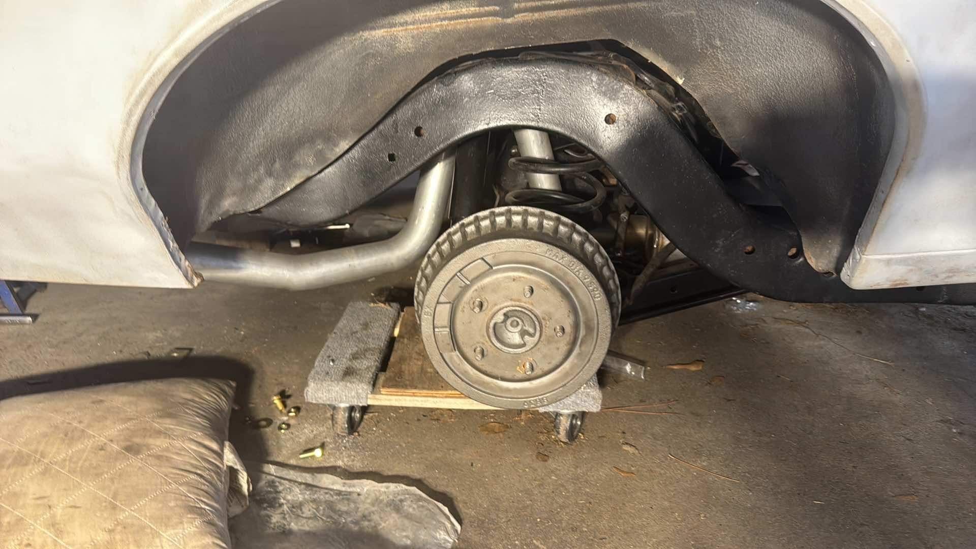

El Camino body is not interchangeable with 1979 cutlass not chevelle body style
Well im currently working on this frame for a 1970 cutlass supreme. When i originally received it i was told it fit by seller despite my doubts at first i worked on it for severals months only to find out it seems like doesn’t fit.
The seller would be wrong. It APPEARS that the ElCo frame was shortened to the 116" wheelbase of the four door cars and not the 112" wheelbase of the two doors.
