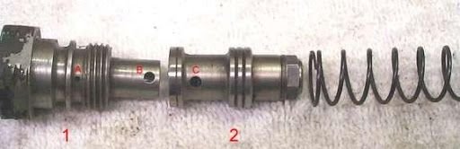

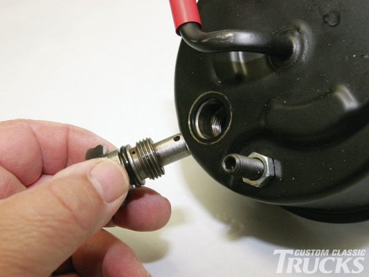

While this may or may not be the issue, I've had a loose flow control valve cause this problem. The flow control valve is underneath the outlet fitting on the back of the pump. The adjusting nut can come loose, causing low pressure.
