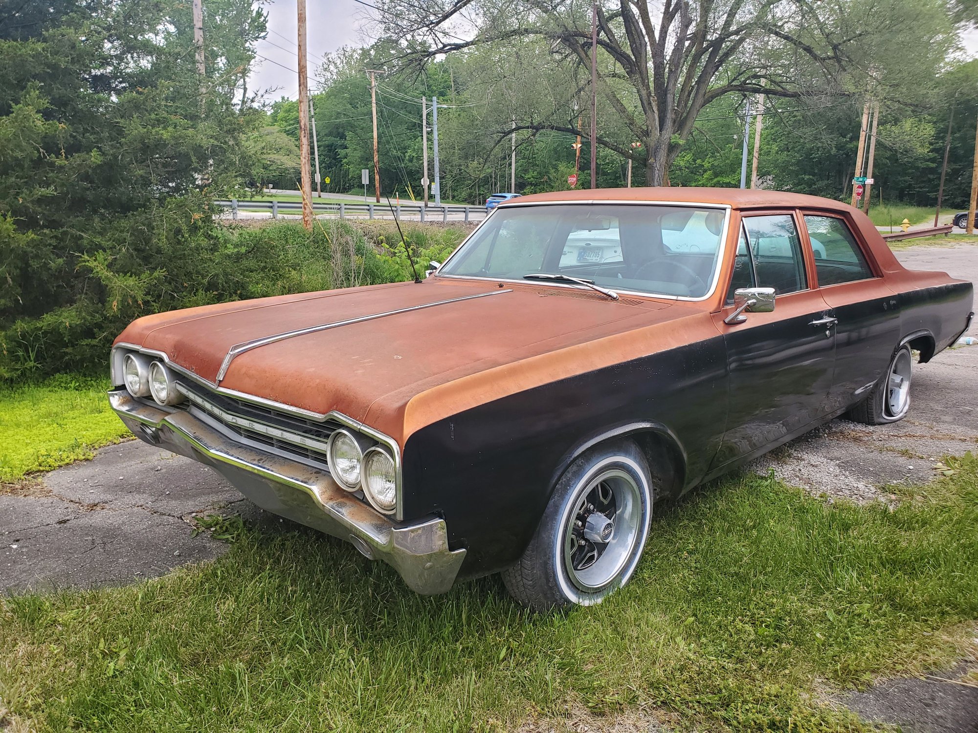

I am the proud new owner of a '65 F-85, and naturally it has drum brakes all the way around. Disk brakes are better, or at least widely accepted to be, especially now that ABS is a thing. Some people are telling me that I should convert the drum breaks on my F-85 to disk brakes. Is it worth it?
