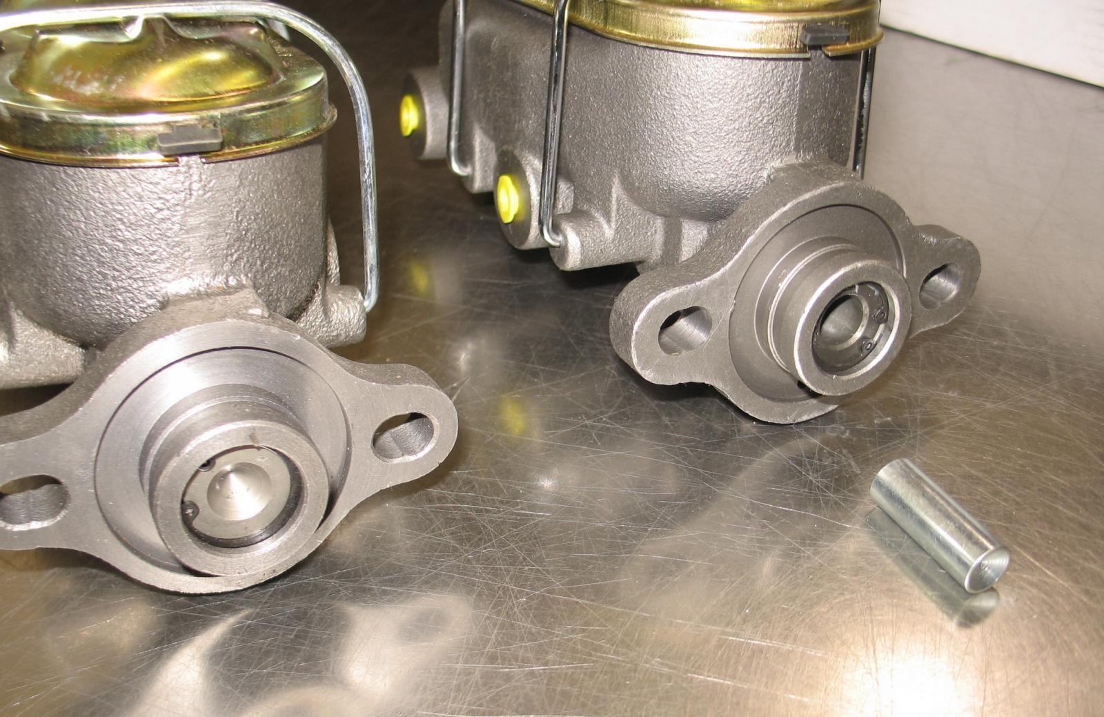

and source the heavy parts (rotors, calipers, and M/C) locally. Hoses are also available anywhere (use 1969-72 A-body). Your original power brake booster can be used, but you'll need a M/C with the deep hole in the piston. These are readily available from the aftermarket, as are the combo valves. Yes you can bend your own lines, but be aware that the ports in the M/C and combo valve use a variety of thread sizes to preclude misconnecting lines. You'll want the flare nut assortment that includes these.
