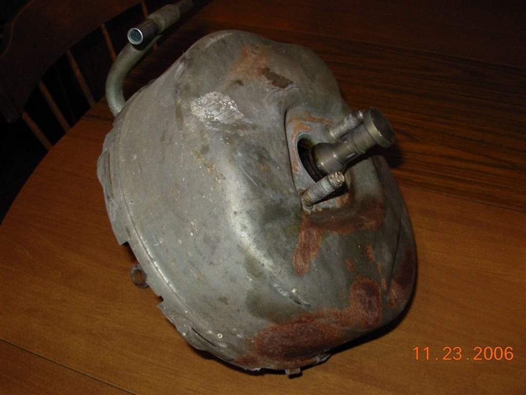

Here's a Bendix booster and M/C for comparison.

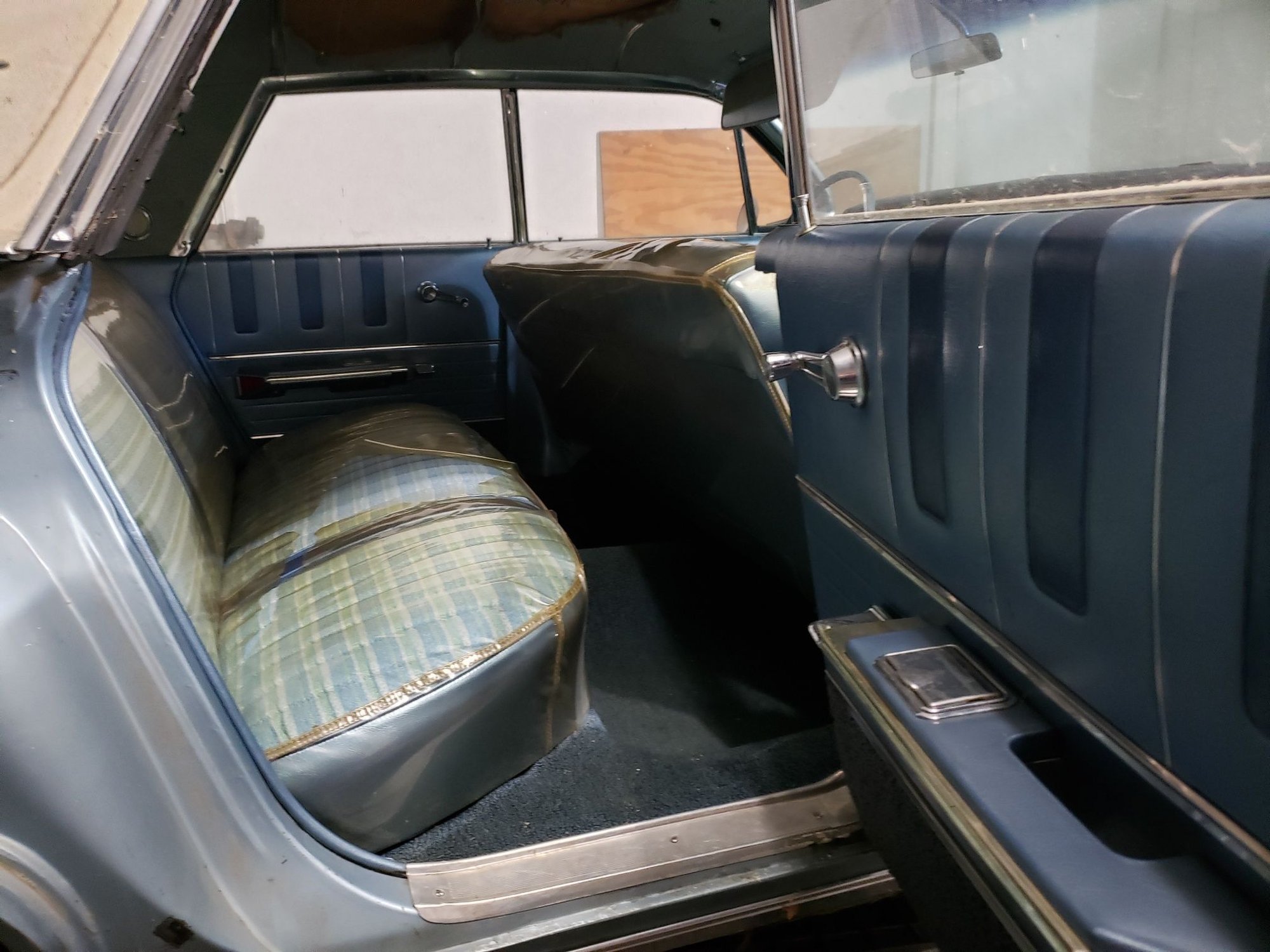

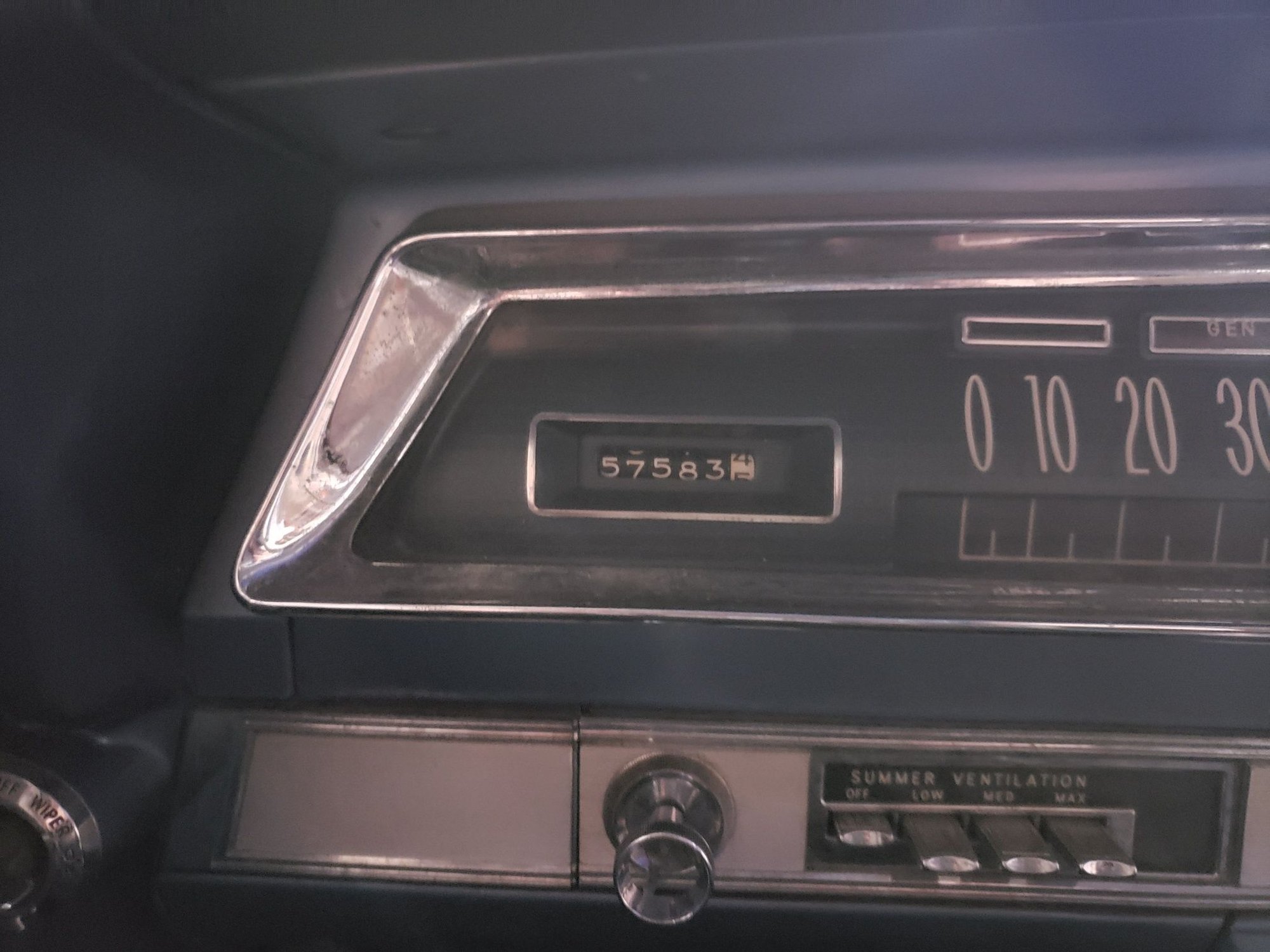

A few pictures
I got the master cylinder off with the help of a friend. It took two of us with screwdrivers prying on it and if finally "popped" and slid right off. The oil has been changed. The transmission fluid and filter have been changed. I will take some pictures of it in my shop and post in the next few days.
Here is the car the day I first saw it. It had been sitting here since 1968.
Odometer
Clear plastic seat covers so the seats are like brand new.

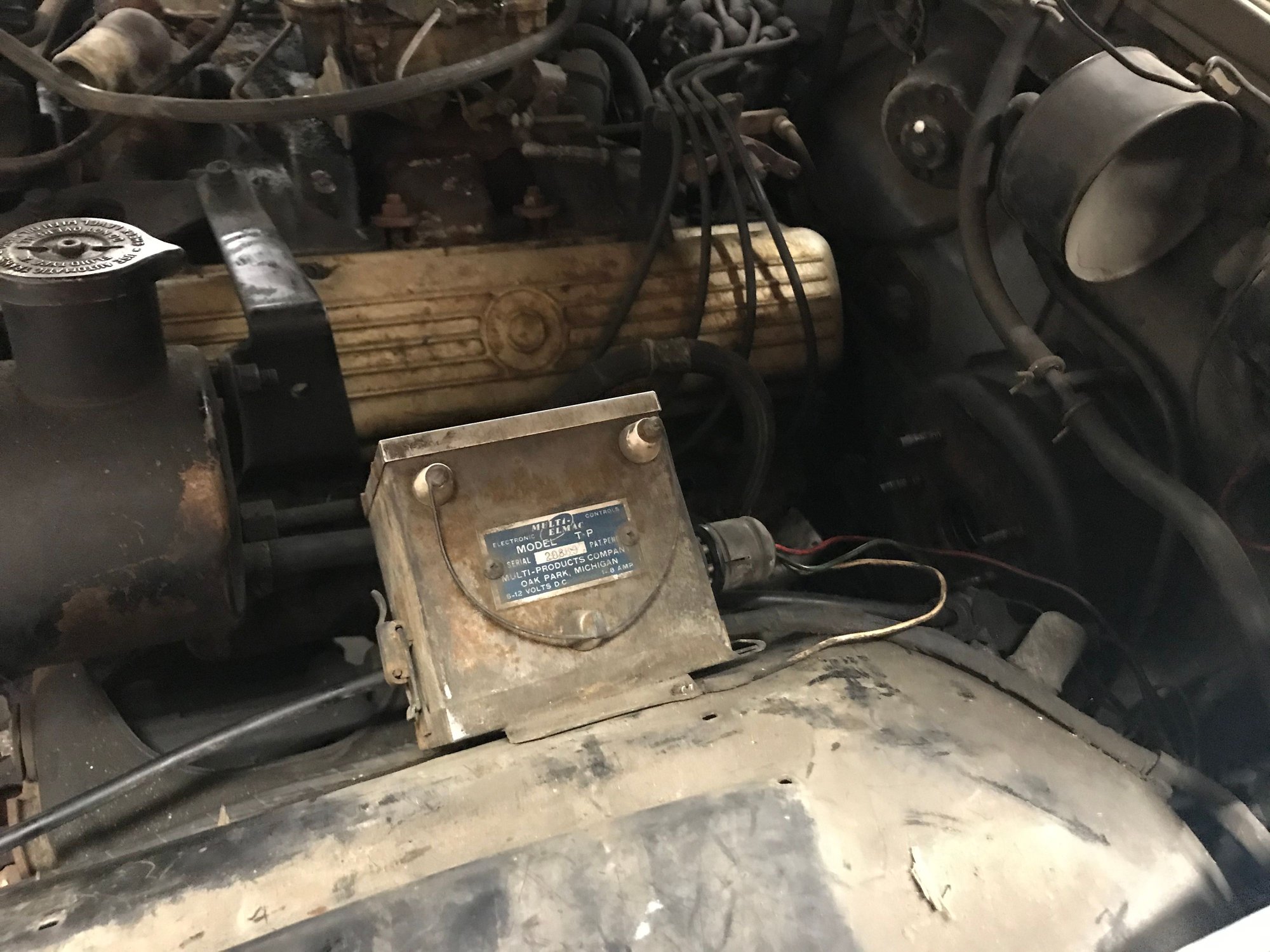

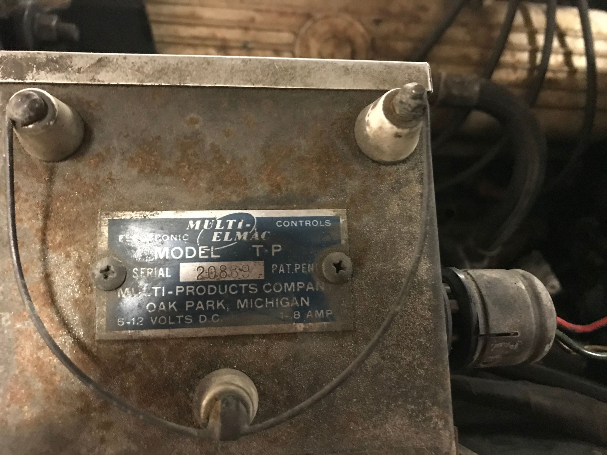

Here is something interesting. This is mounted to the front left inner fender well. The wires go through the firewall to a single momentary push button. I figured out what it is so let's see if any of you guys have ever seen one. I haven't until now. I would like to know if it is a dealer installed item or was done aftermarket?
Old Dec 28, 2020 | 04:38 PM
Posts: 50,770
OK, THAT'S cool. Yes, I Googled it.
Heckuva antenna!

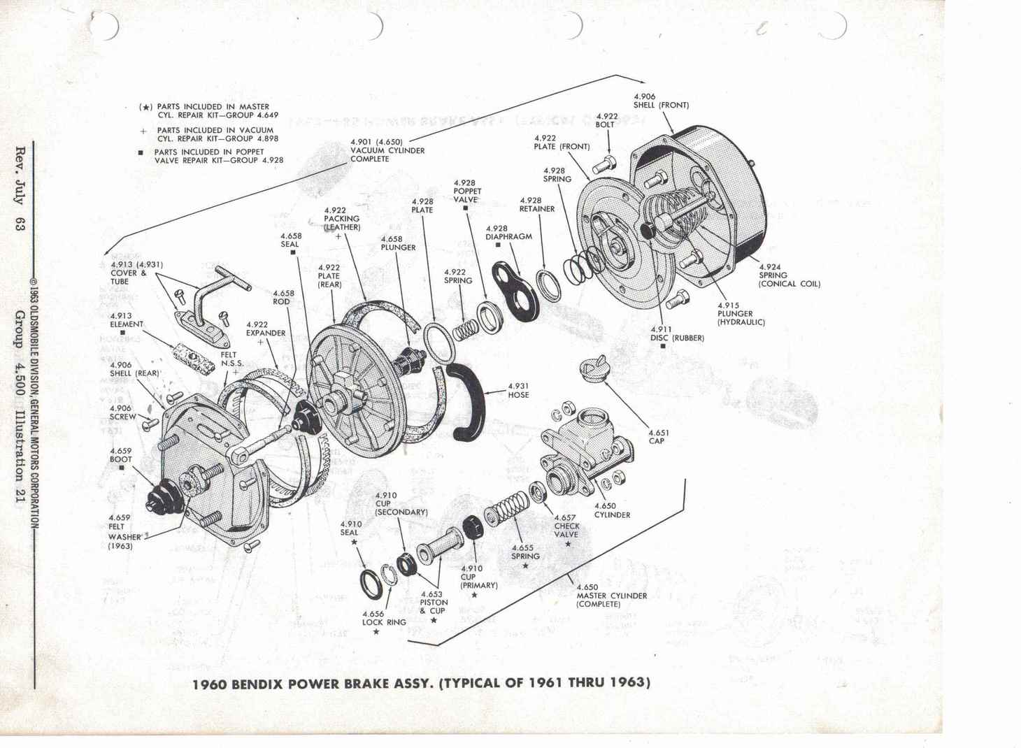

I bought a master cylinder rebuild kit from Fusick. I had a white poster board on the workbench and disassembled the master cylinder laying it out just as it came apart so I would know how to re-assemble it. You can start laughing now. Yes, the piece of poster board got caught on a piece of trim that I was polishing and the whole thing went to the floor. I think I remember how it goes but I want to make sure.
Does anyone have a diagram of a Bendix master cylinder? I've tried to find one online but so far no luck.
Old Jan 20, 2021 | 06:29 PM
Charlie Jones's Avatar
Phantom Phixer
Posts: 5,525
From: Apopka, FL
Here you are ;
Old Jan 20, 2021 | 06:38 PM
Phantom Phixer
Posts: 5,525
From: Apopka, FL
There's a whole book of these illustrations available for free download here ;
1963 Oldsmobile Parts and Accessories Catalog (Chassis Edition) - ClassicOldsmobile.com

That is perfect. Thank you.
