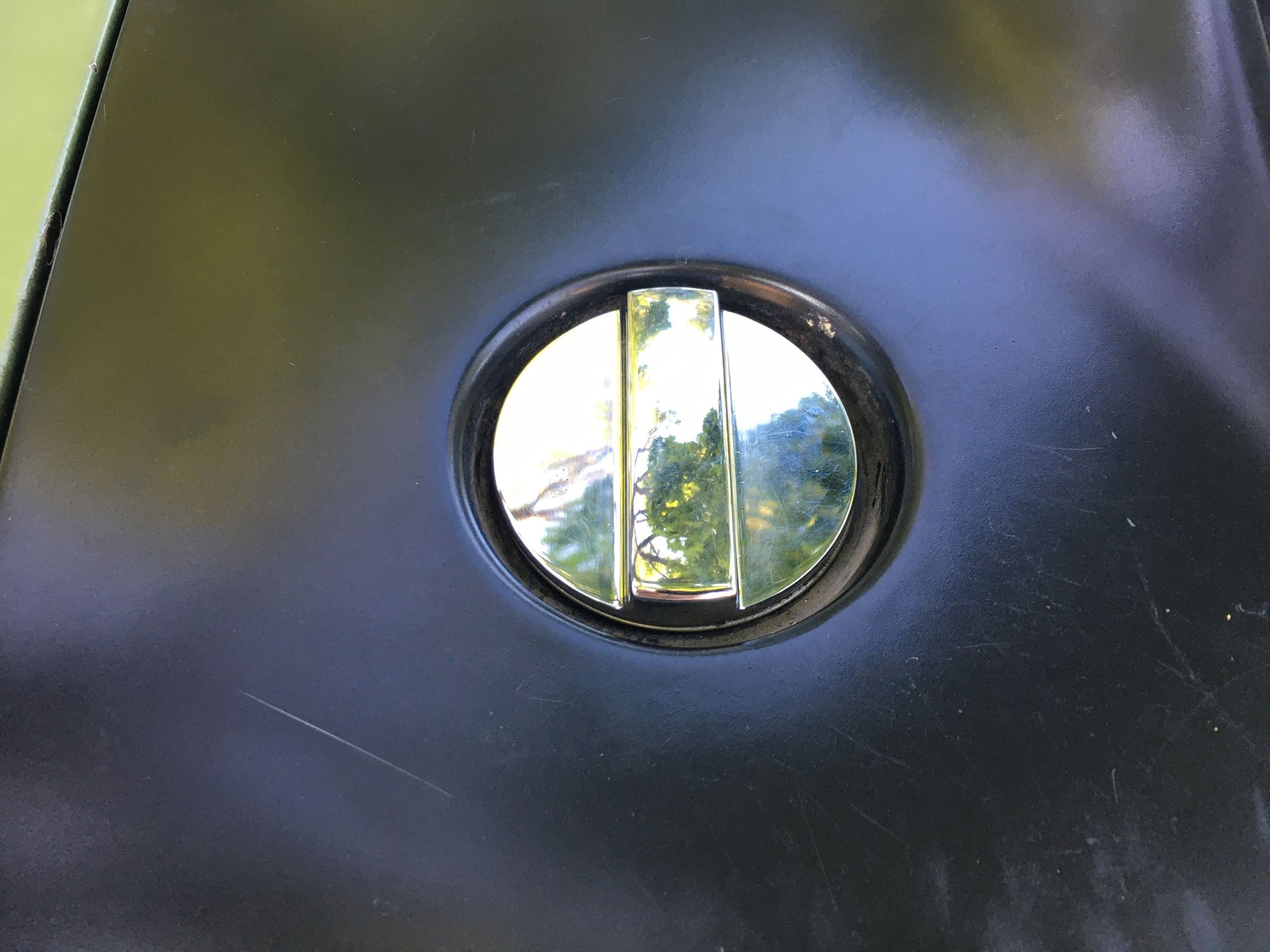

hi all - the passenger hold down on my w25 hood wont release - I believe the pin slid to one side and won’t allow it to release - someone mentioned that I should lock tight the pins to hold them in center position which I will do ... but first to get it open - anyone have any tricks or tips to getting this to release - Thanks in advance! ~ Joe R.

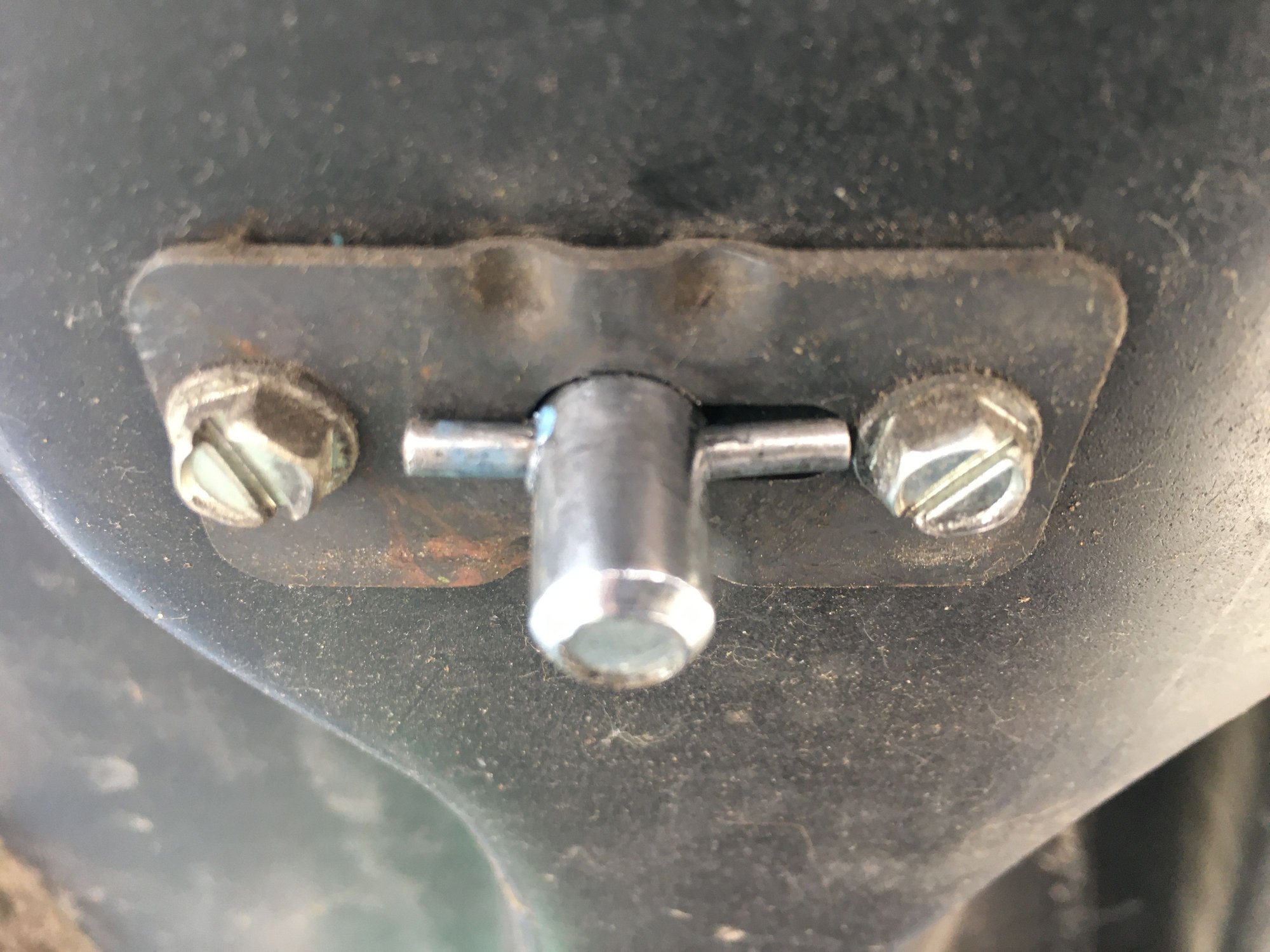

Thanks! That did the trick - light and needle nose did the trick - was close to losing that lock down 😳 - I used lock tight for now to help hold them but I am interested in your roll pin - drill - tap - Allen head idea - any pictures for reference? Thanks again!
Success! Hoods up - car used zero oil in almost 200 miles
Pins was a little bent - this is the same side I had an issue with before - I straightened it out and used lock tight to help hold it - will look into reinforcing the pin better when it’s cooler outside

the pins were bent originally a little and that held them kinda in place

Happy to take a pic or 2 if you PM me your email or # to send text as I am “challenged” posting photos (its a curse!). You can then post it up. A very knowledgeable Olds weenie would be the only person to spot this fix and even that would likely happen only by stumbling upon it.
If you look at the close up of the pin you’ll see it is appx 1/2” or so from the bottom of the **** “post” or extension. In the bottom of that post there is a recess/countersink on the end. I drilled up the post from that recess until intersecting the pin hole, tapped it and ran Allen head set screw up to secure the pin.
