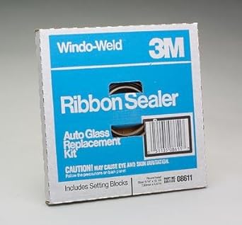

Where can I find the rear window glass seal or weather stripping? It's for my 71 supreme I've searched with no real leads. For all I know I'm not calling it by its right name.
Old Aug 23, 2013 | 05:23 PM
It takes a butyl strip seal.

So there's no fitted strip or is that the best for what it is

There is no "fitted strip" or molded gasket. The glass is simply glued to the pinchweld flange using the butyl tape shown above. That's how the cars were built at the factory.
By the way, if you are doing this to fix a leak, you most likely have the dreaded and all-too-common pinchweld rust.

Thanks guys I picked up the 3m ribbon strip we'll see how it goes tomorrow.
