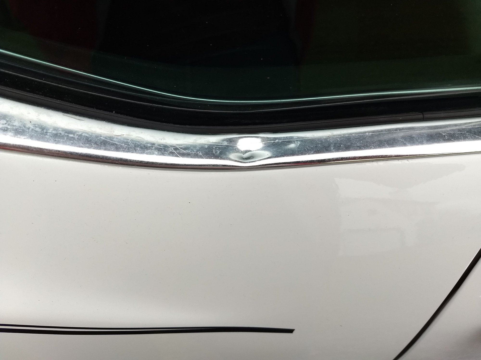

Now I have this to fix (these pics are of the trim that runs along the top of the driver side door and the passenger side rear quarter). Is there any way to fix this without complete dissasembly? Because (unless I'm wrong) the trim is held on by screws that can only be taken out after the glass is removed, and I really don't wanna go down that road.
Any advice is appreciated.

You MIGHT be able to just remove the lower stop and drop the glass down far enough to access the screws. Of course, the back seat and interior side panels need to come out first. That trim is anodized, so don't try to sand it or polish it.

I unbolted the stops and the glass went below the screws.
Gotcha...will I have to remove the rear glass?
Old Oct 27, 2018 | 02:37 PM
Posts: 50,768
The whole point of only removing the lower stop is that it allows the glass to be cranked down far enough to provide access to the screws without having to remove the glass.
Joe, refresh my memory if you could. On the rear quarter glass, can I just remove the stop, or does the whole regulator have to come apart? Also, I haven't been into the front window assembly, so would I just be able to remove the stops on the driver door glass as well?

Question...to get the door panel off, do I have to remove the pull strap, or will it come off with the door panel?

Pull strap will come off w the panel, once the door n window handles and three screws on the arm rest are removed the panel needs to be lifted up to remove.
