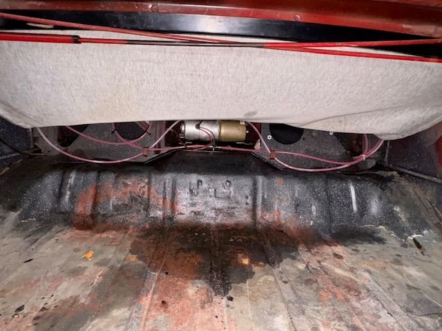

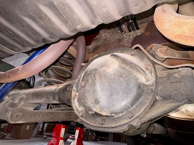

Open trunk and at forward end is the mirror image of your part. Now go below the car, in same place, and that is where your part will go. Just a little ahead of differential. Hard to photo since lots of stuff there.
Inside trunk.  Mine is a vert.  But the bulkhead is the jigsaw piece of yours.

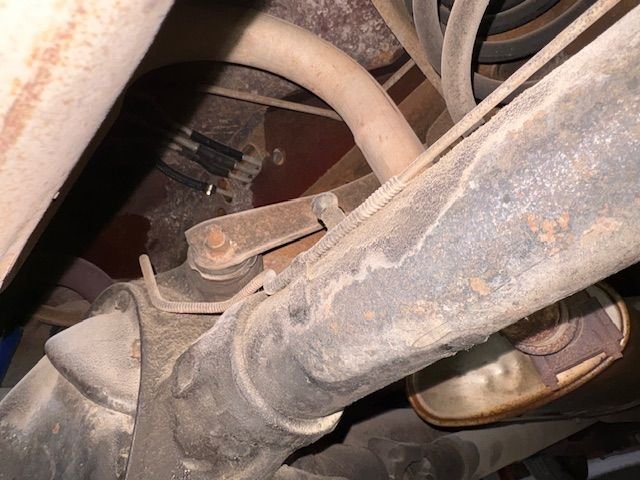

Below in same area.  Look for the fuel vapor lines that are routed through the smaller holes
Tough rea to see.
Tough area to see.
