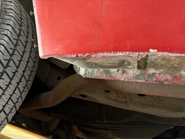

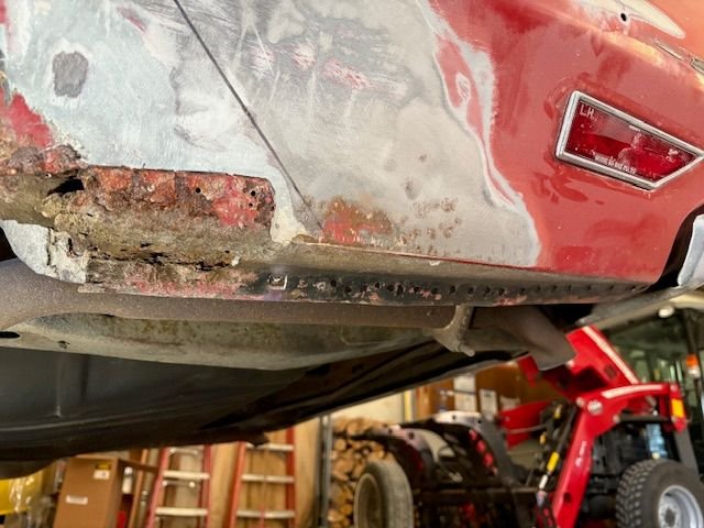

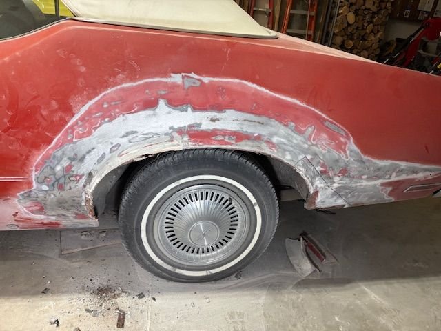

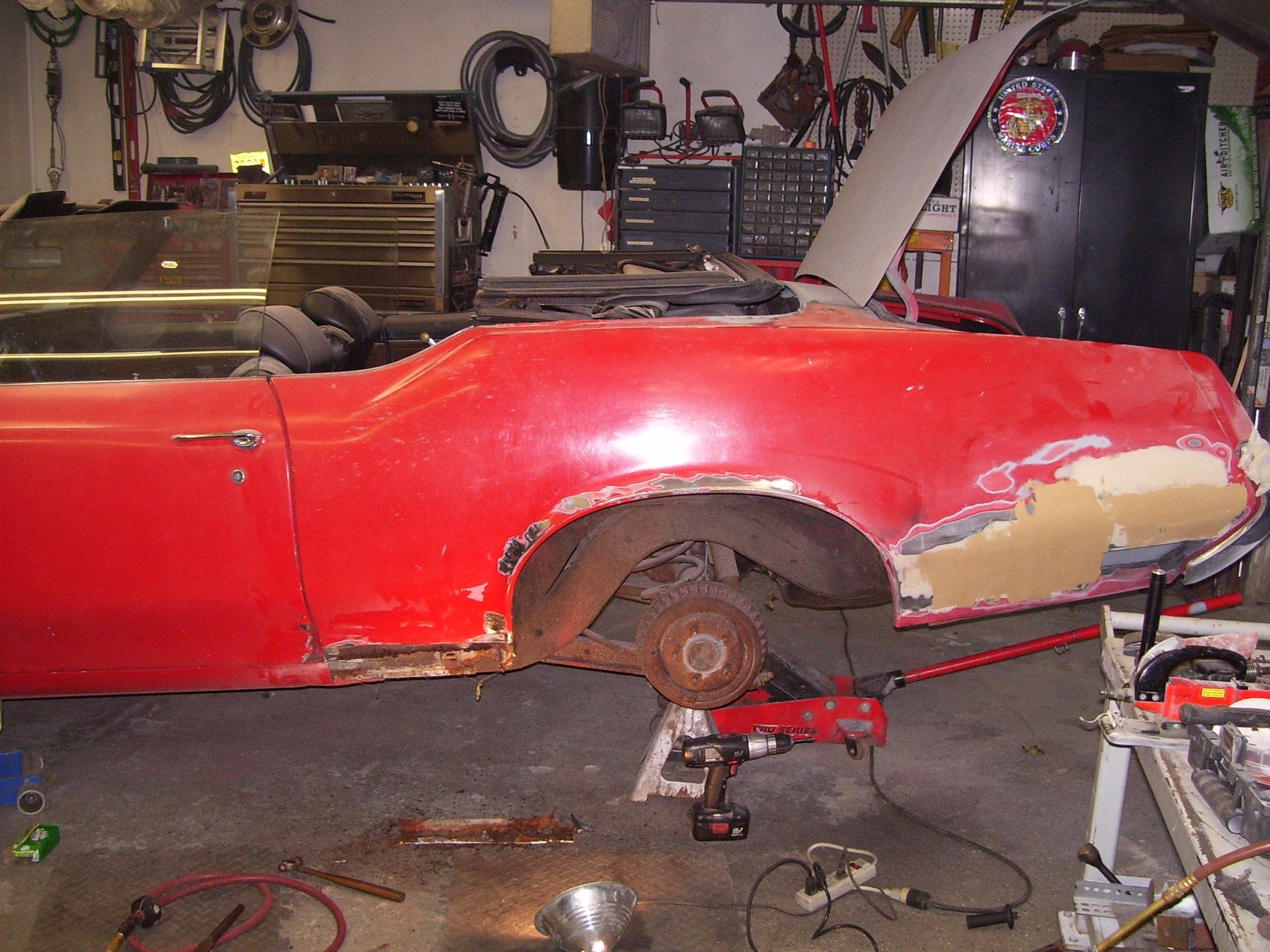

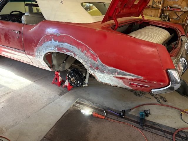

So I’m a relative newbie joined July 4 of this year I think it was. And I’ve had the car since about them. And noticed something on the left rear quarter panel that looks suspicious. So started digging into it today a little bit. Testing with a magnet, I could kind of map out the areas where it seemed like there was body filler. So I took a chisel. I am a carpenter and all ha ha an old junk chisel in fact, kind of semi sharp and started peeling away the Bondo. In the area that I was digging, which is kind of the center of the quarter above the wheel the steel all looks good. I’m a little bit mystified. What’s going on. I suspect I’m going to find a rust damaged area Kind of below the trunk area if that makes sense. And I’m kind of feeling my way through this thinking about what I’m gonna do. I suspect it’ll involve ordering some new skins left and right, cutting away some bad metal and welding in new. But I’d sure appreciate any guidance and direction out of this group of folks that’s been there before and repaired it.

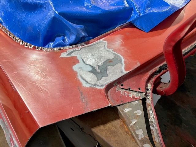

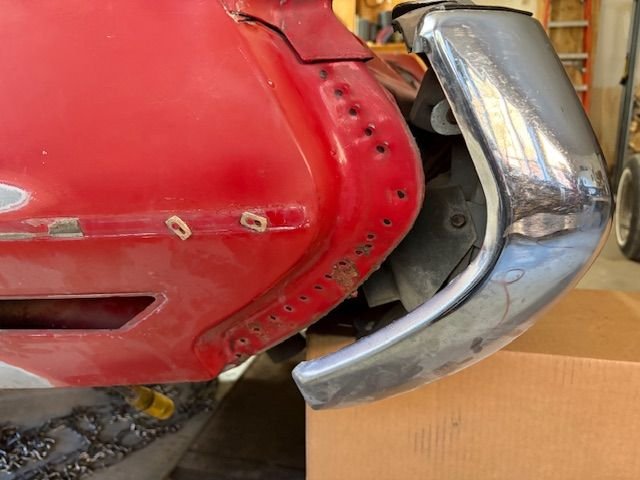

A few pics to start the adventure

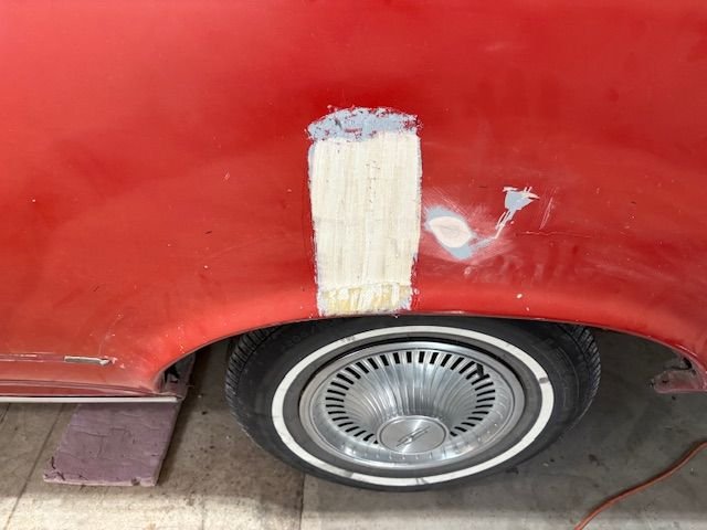

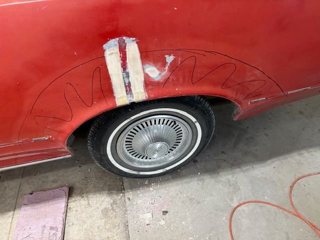

This is just behind the left rear wheel. Looks like somebody pop riveted a patch?
I noticed a crack in paint in this location, so started to peel out Bondo to try and figure out what’s going on?
Using a magnet, I have a rough idea of the Bondo applied area
Digging through it all, the steel looks good right at this point

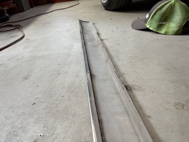

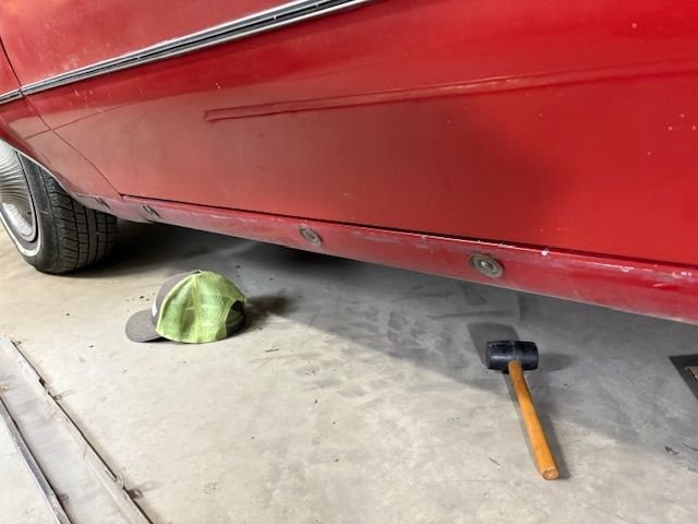

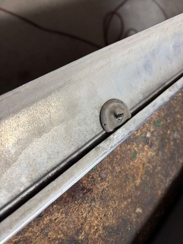

If anyone knows how to remove this bottom stainless strip without damaging it, I would appreciate the answer.
There should be phillips head screws along the bottom. Remove those, pull out the lower edge from the body, and lift the trim up off of the round clips that are underneath it.

So I took a second look. Had to get my head clear under the car. Then noticed the tabs at edge of molding, folded back into a recessed area of the frame. Tabs screwed to the frame with hex head Sheetmetal screws.
Thanks Joe!

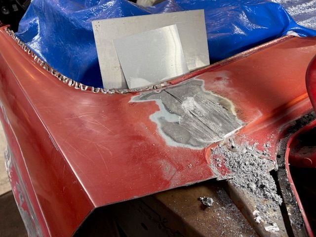

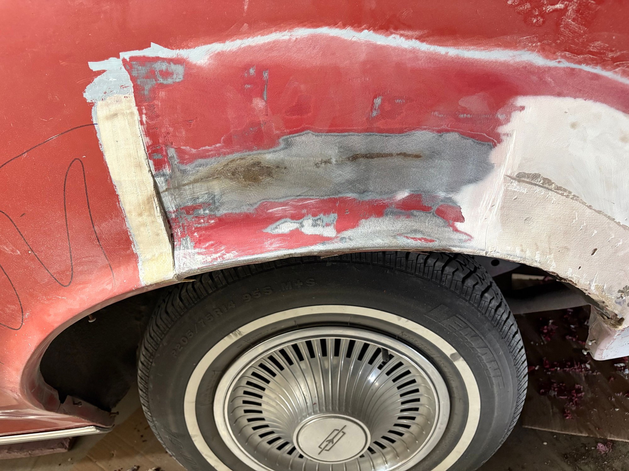

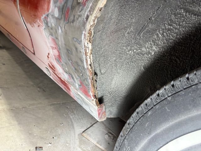

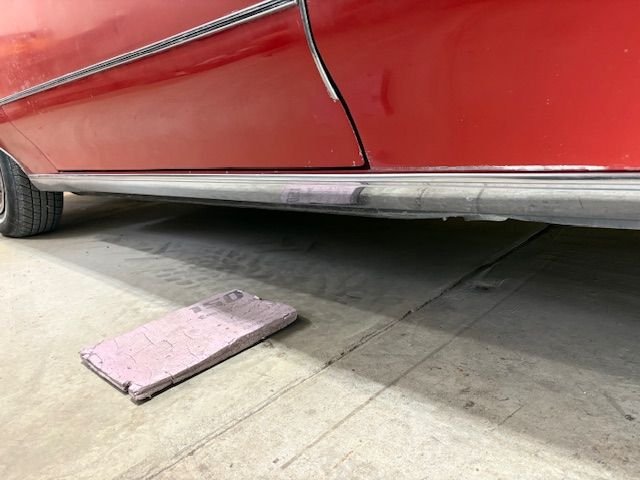

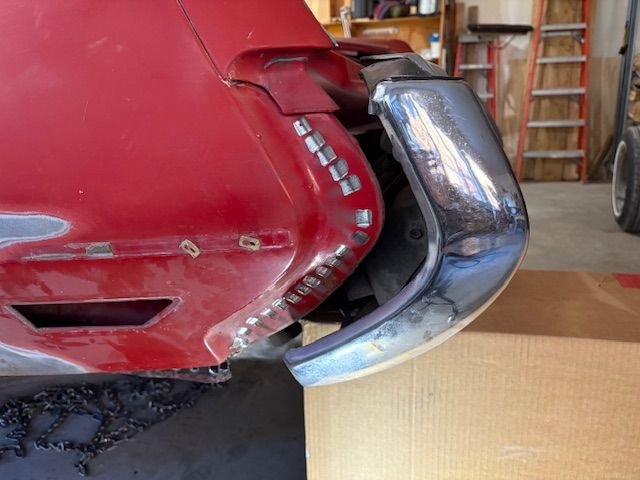

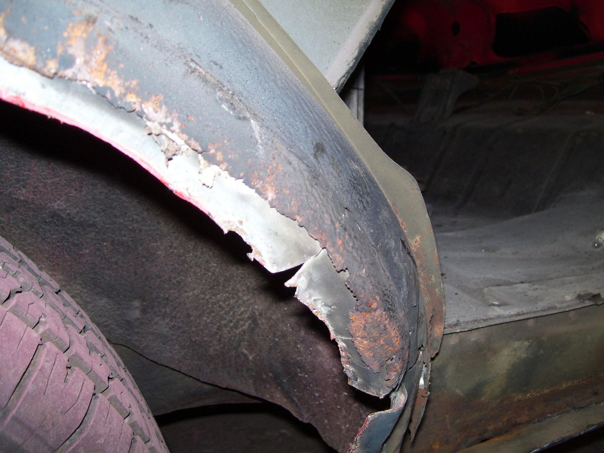

Had a chance today to continue to remove what appears to be an old Bondo and fiberglass tape rust repair. I plan to order rear quarter panel skins and do the job correctly. But want to verify whether or not I will need outer wheel buckets also. Since it is motor freight and expensive to ship, I want to get everything all at once.
The people that did this rust repair took a lot of time working the body filler. They did well, and it lasted many years. But it would not have cost a lot more to weld in new quarters instead of fiddling with all the filler material.
Old Dec 24, 2024 | 04:41 AM
Andy's Avatar
Joined: Jan 2020
Posts: 2,890
From: Sarasota Florida
Usually a fix like pictured will need the outer fender well replaced too. They aren’t very expensive. I would order both pieces. There are two schools of thought on quarter panel replacement. Some insist on using the whole quarter panel, others just use the metal needed, weld to original panel. I am a proponent of only replace the metal needed.
I think I am in agreement with your position. The complete panel would be great, but for me this will be the first time I’m doing Sheetmetal to this level. At this point, I think I am going to cut away the bad, and cut the needed portion off of a new skin. Carefully fit the new to the old, and butt weld the two together using TIG. From what I am reading in several places, using a lap piece makes the welding easier, but introduces other issues like unequal expansion and contraction stresses that may show through the new paint.

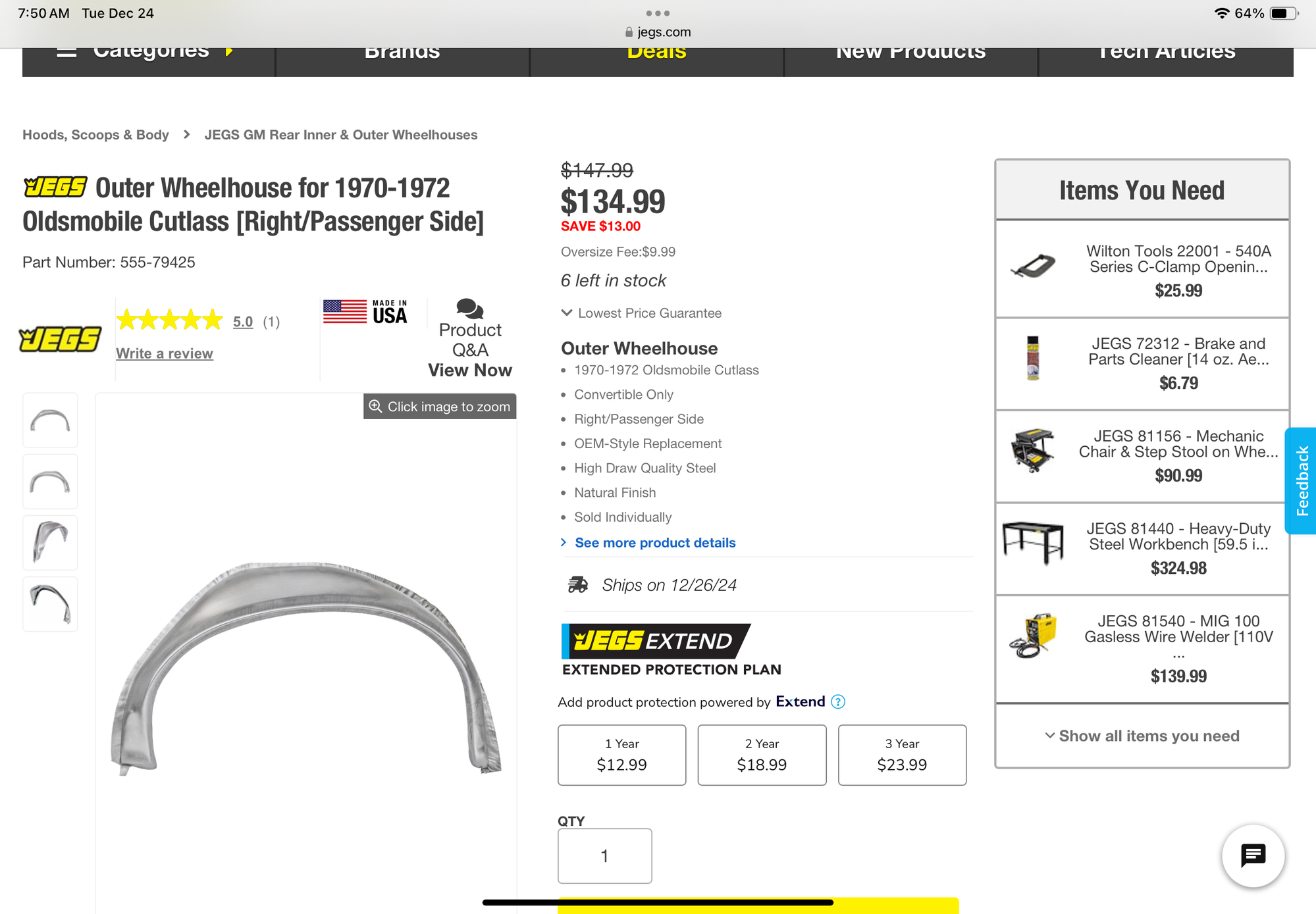

My immediate goal is to just identify what I need for new parts and get them ordered. Then I can return to the Interior restoration work that I already have parts in hand to work upon, while waiting for Sheetmetal to arrive.
Andy, is This is the part you are talking about

Yes thats it

WOW! thats a lot of mud

Maybe the guy doing the work was paid by the gallon I’m thinking about two gallons on the left side? I’m grinding it out with a 40 grit belt on a belt sander using a shop vac to try and contain dust as much as possible. Yet still, this is the pile of sanded away Bondo from half of the left quarter panel.

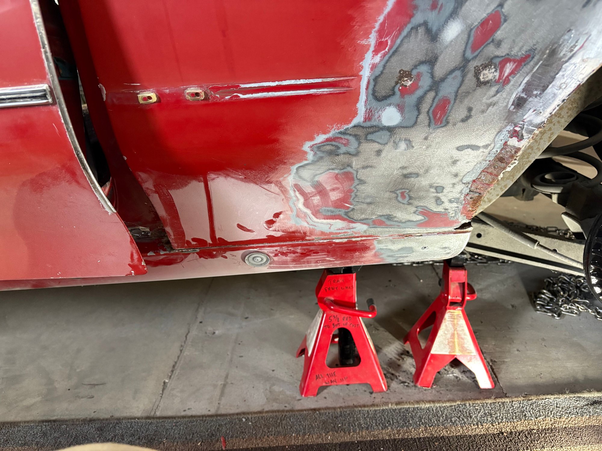

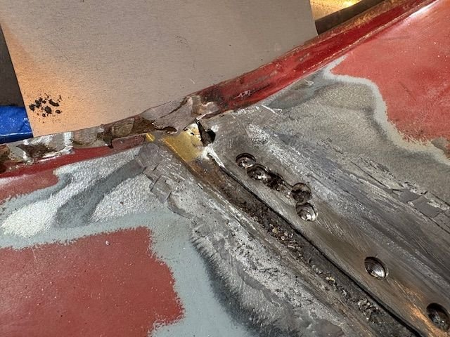

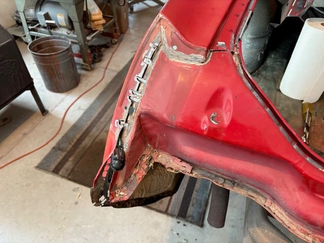

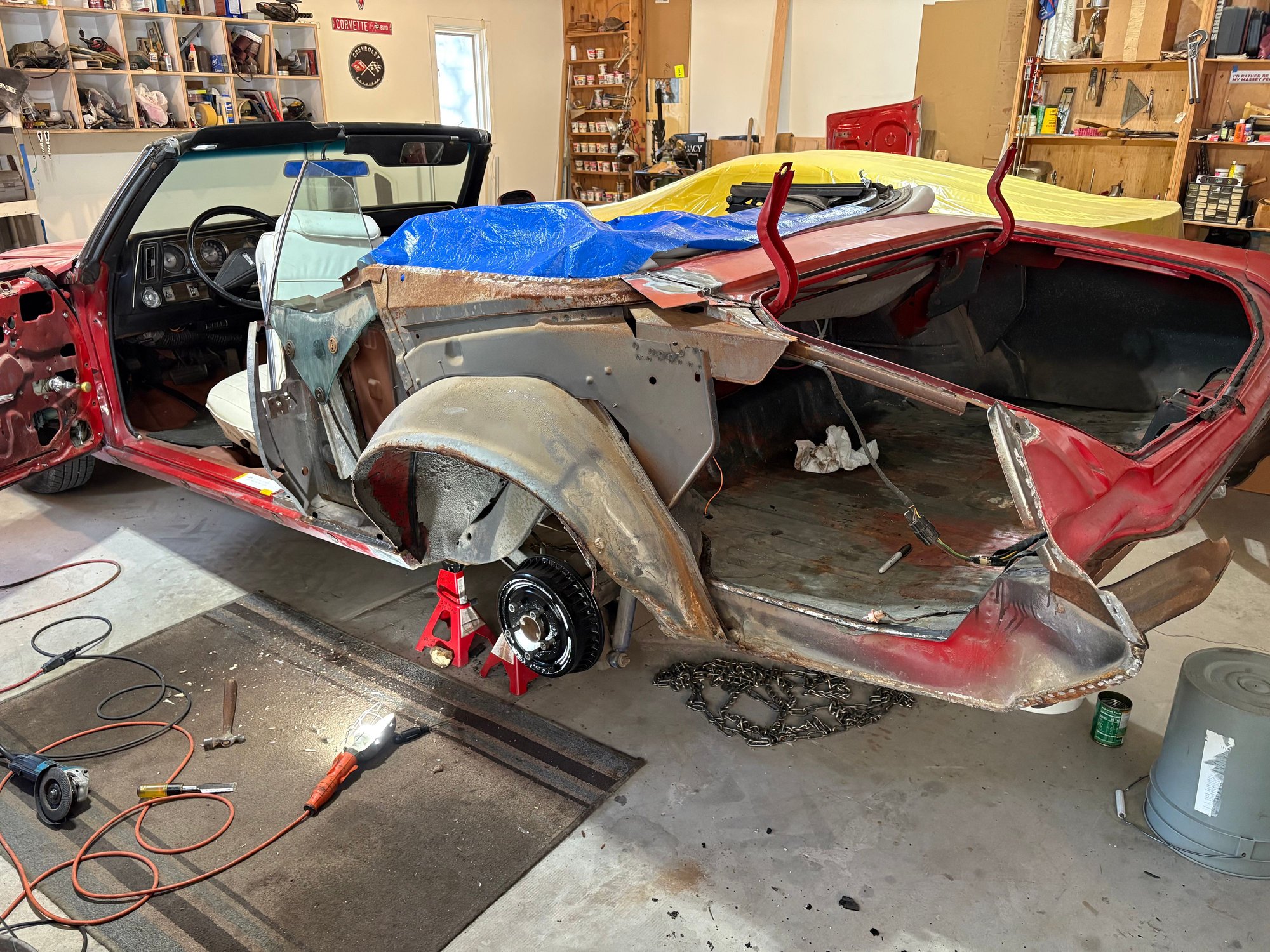

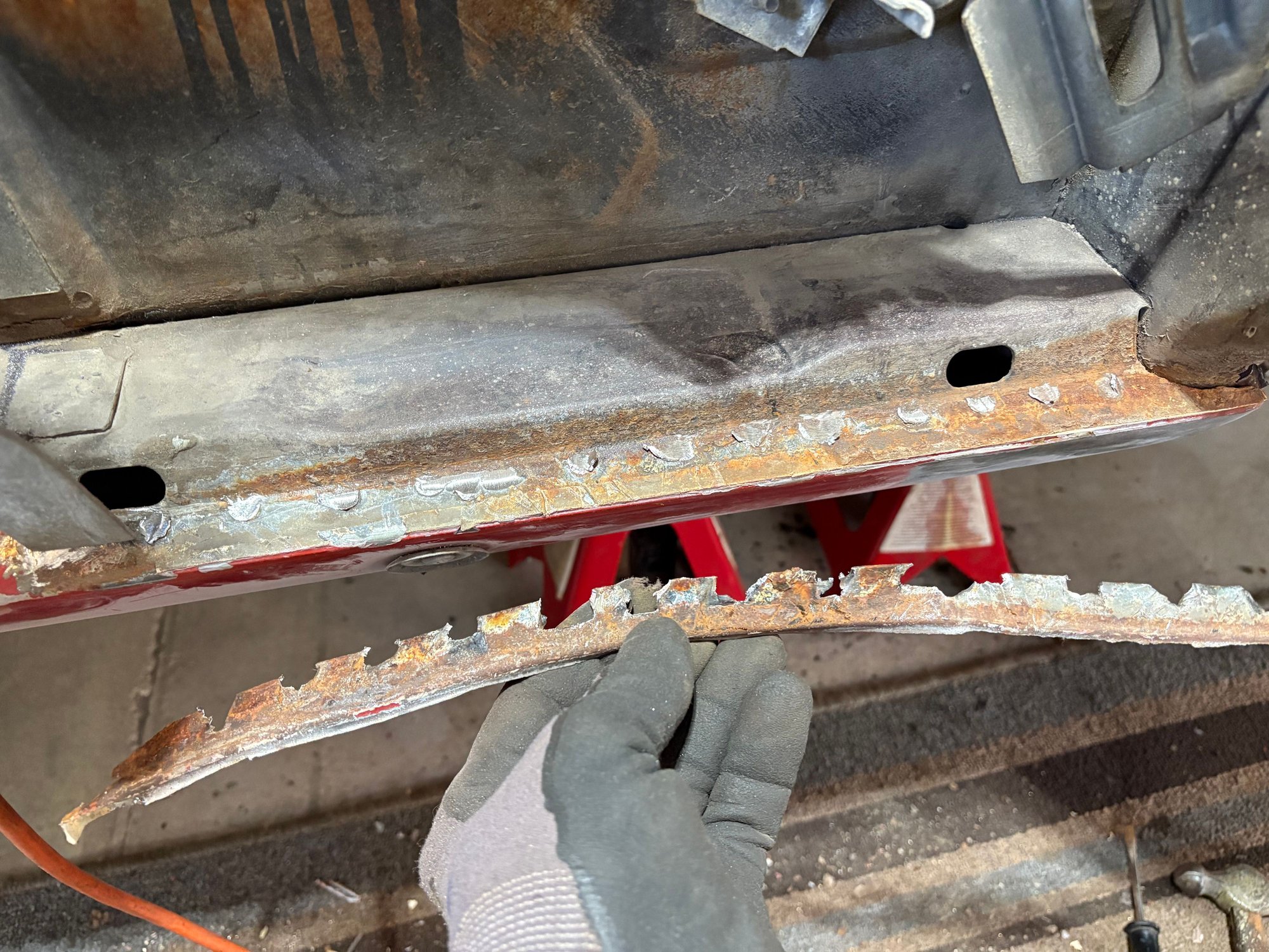

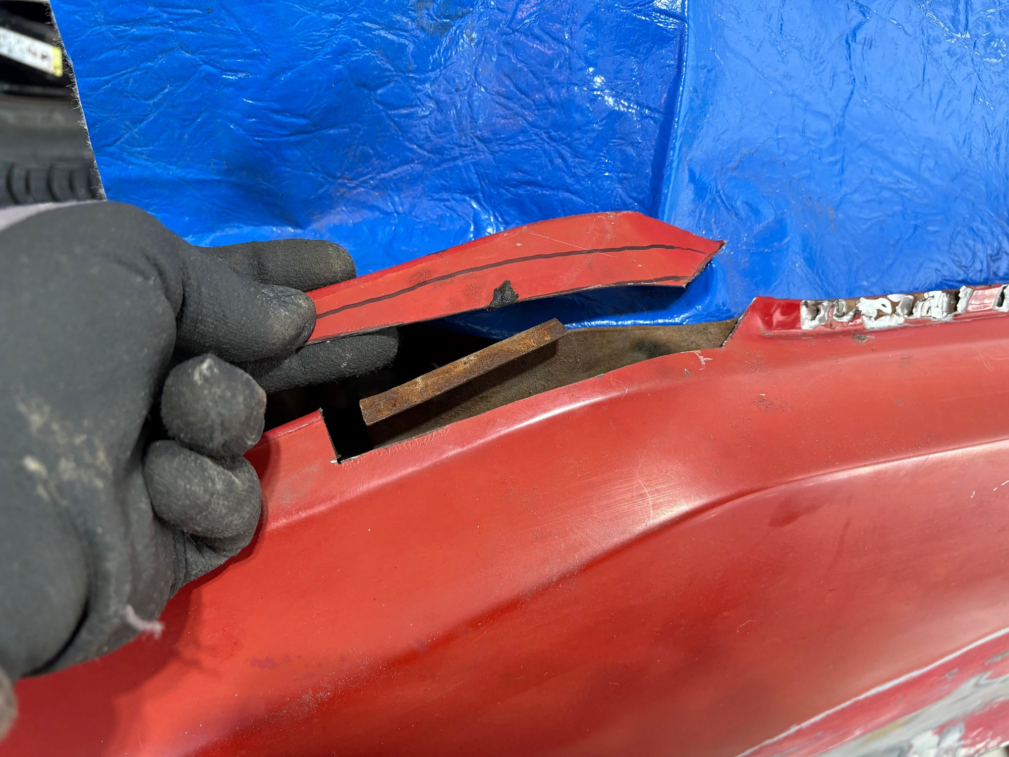

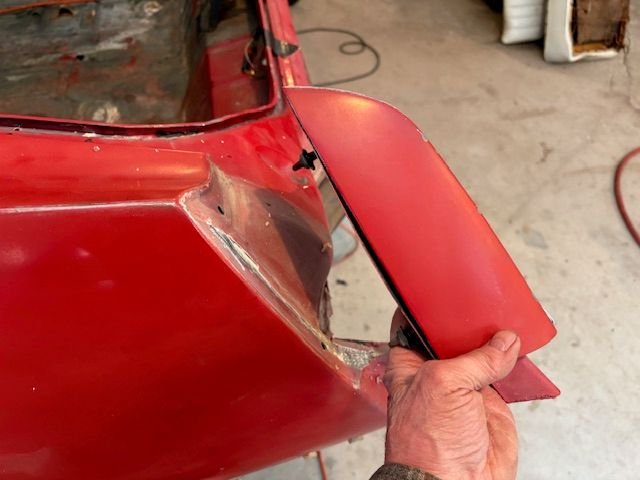

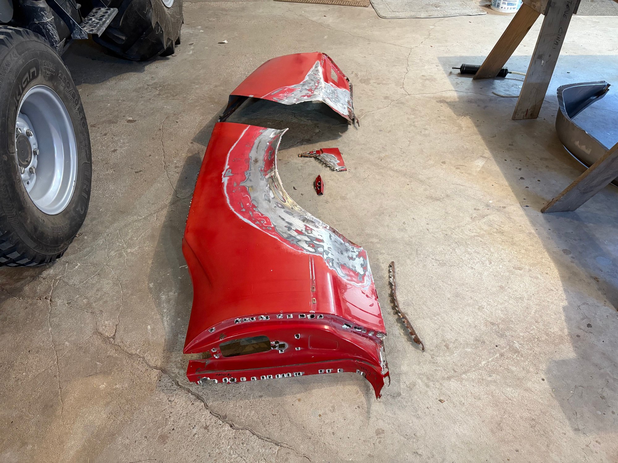

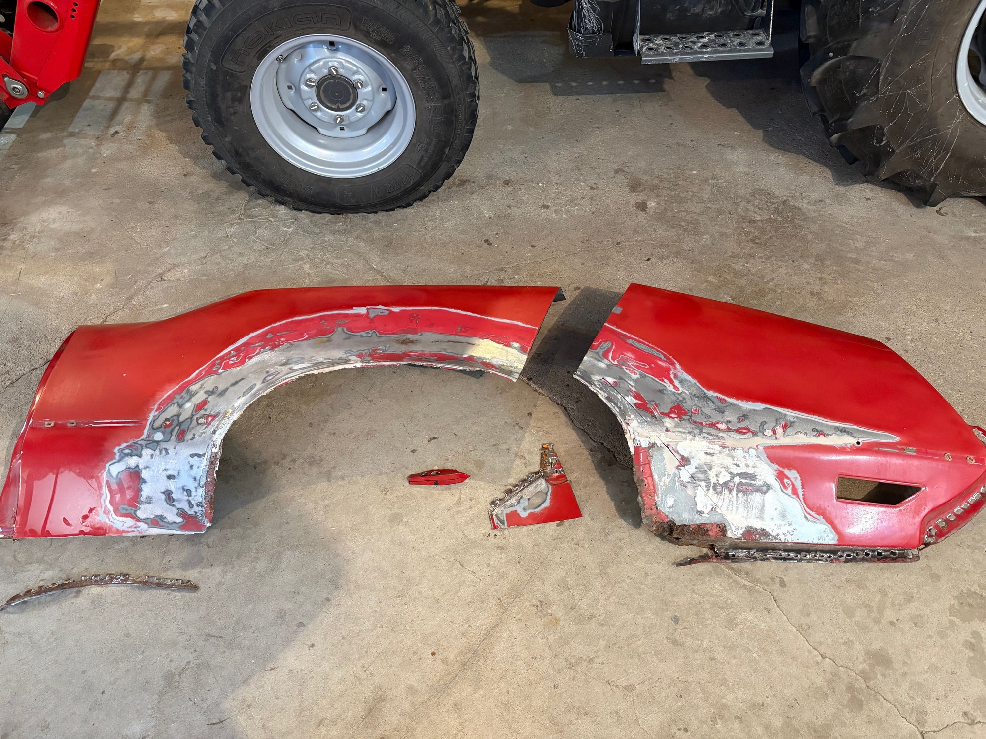

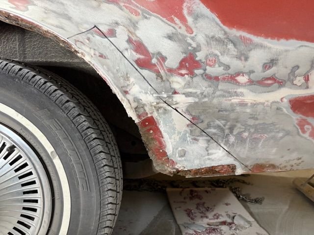

So this is where I am at as of Christmas Eve.

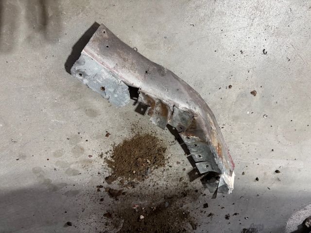

After sanding out the Bondo, I exposed a Sheetmetal patch used to provide a base for the body filler
Drilled out the pop rivets and this piece of art work fell off the car
I plan to cut the quarter panel on the black line to expose the outer wheel well and see what it looks like. Then continue sanding out Bondo toward the front, with hopes that there isn’t a bunch of rust under the door.
Old Dec 24, 2024 | 01:23 PM
Andy's Avatar
Joined: Jan 2020
Posts: 2,890
Damn that was some creative body work somebody did!! Earl Scheibs did better than this. Lol. 😂
Old Dec 26, 2024 | 04:05 PM
OLdGreenPaint's Avatar
Joined: Jul 2024
Posts: 318
From: Iowa!
Whomever did this repair spent a lot of time laying in the body filler and shaping it to match the contours. Looks to me like using a quarter skin would have been less work. Some people don’t have welding skills though. Would have been interesting being there when decision was made to repair with fillers and fiberglass tape. It wasn’t a bad repair really. It didn’t jump out at me as noticeable until I started taking a more critical look at the car.

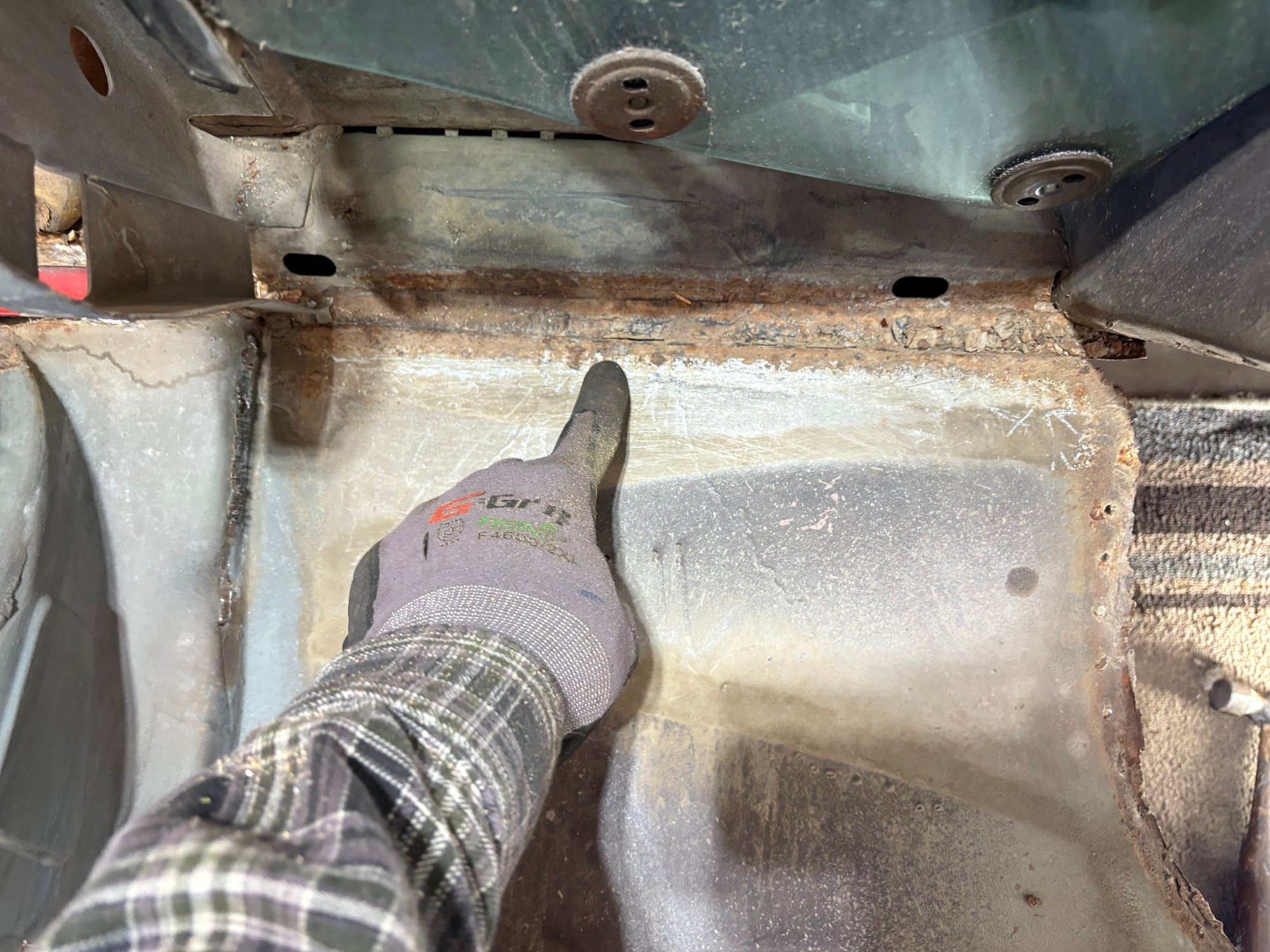

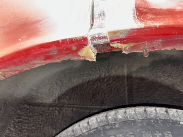

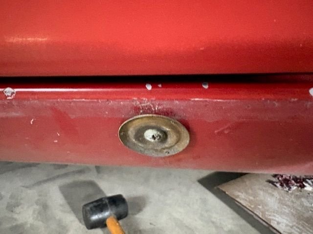

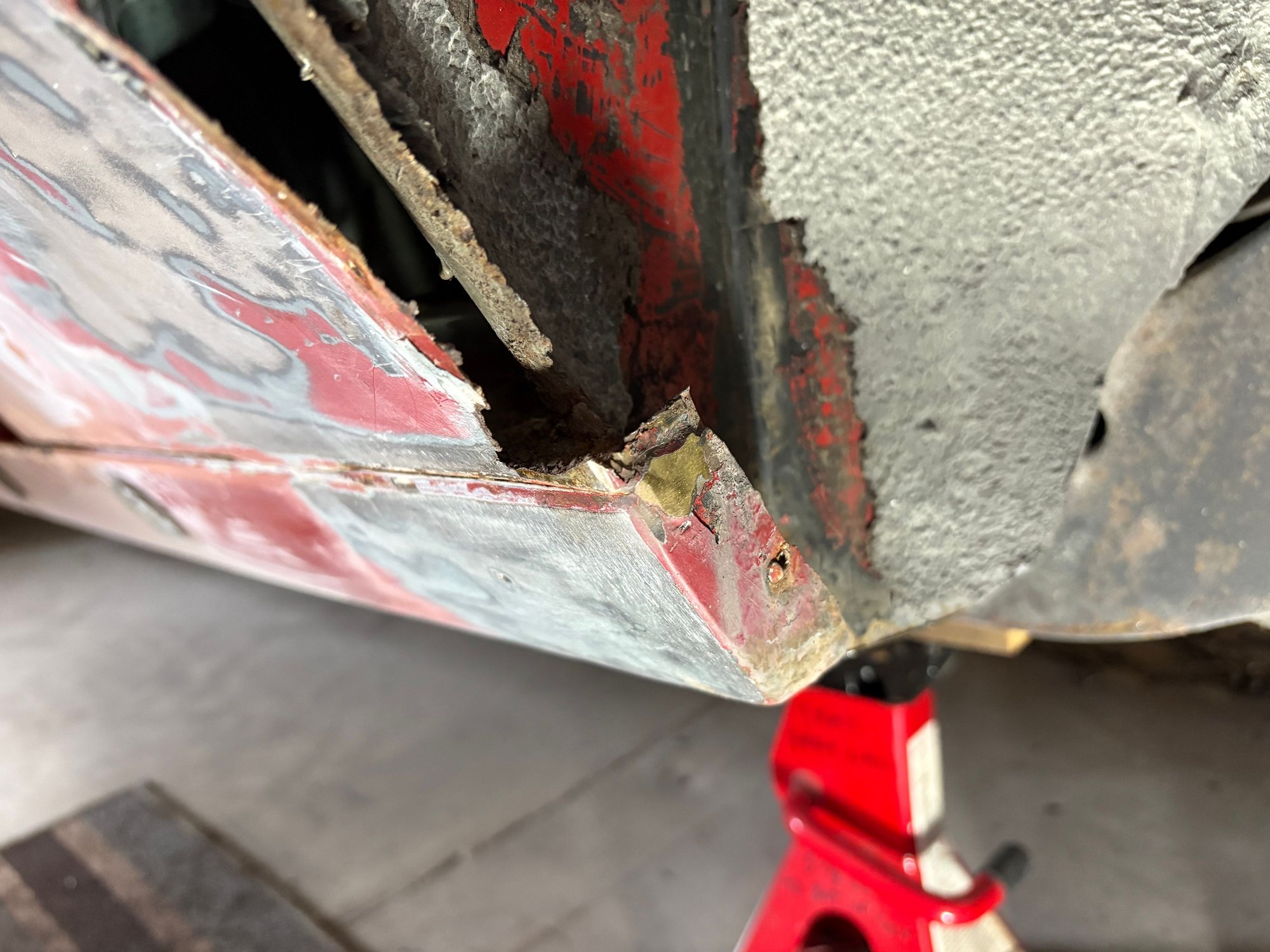

I took of the left side trim piece I mentioned in Post#1. Took out the Sheetmetal screws and then popped it upward using a rubber hammer.
Close up of the retaining washers that the trim piece hooks to
Trim piece has an open hem on it that allows it to hook on the washers
Backside of trim piece

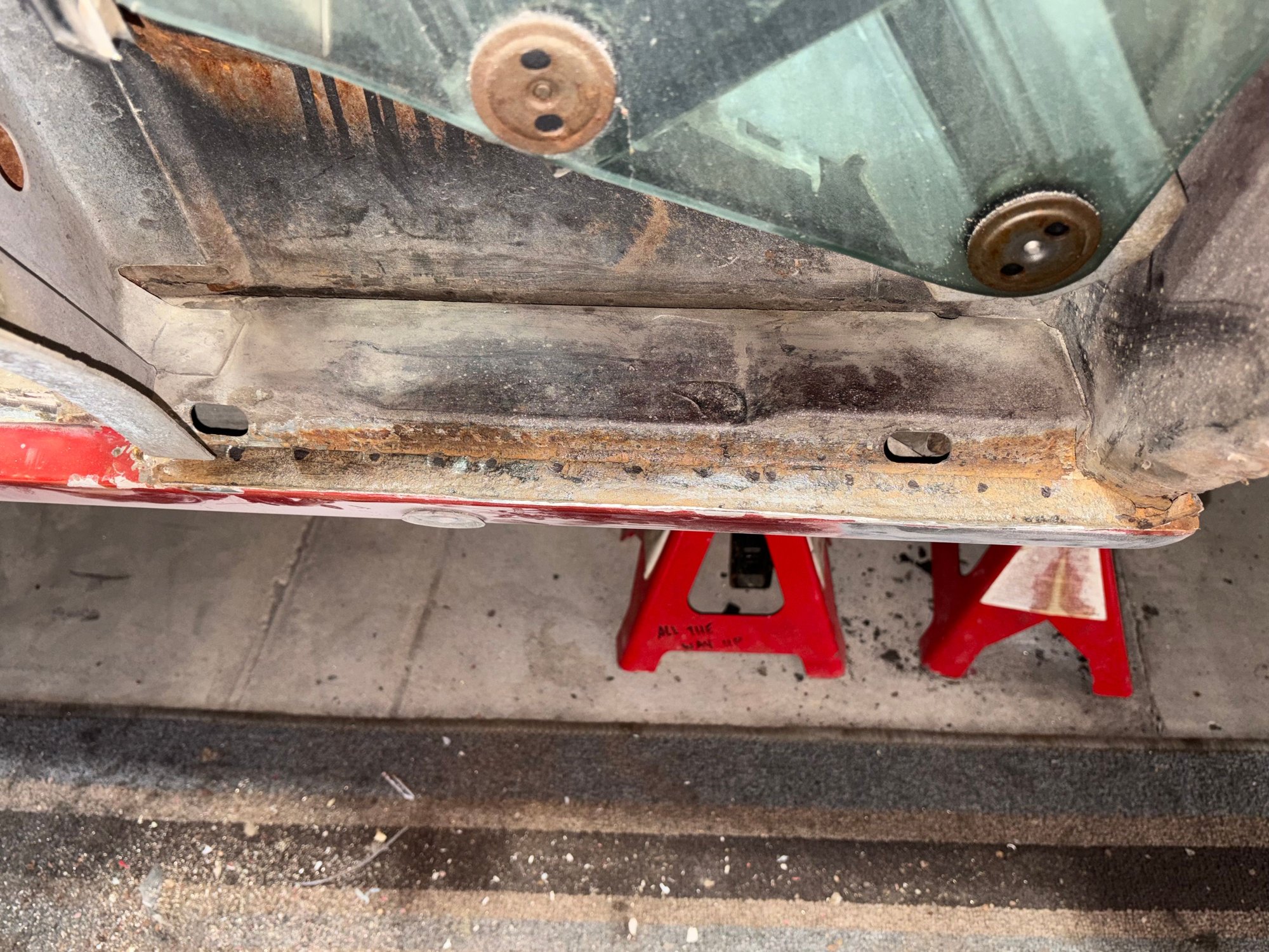

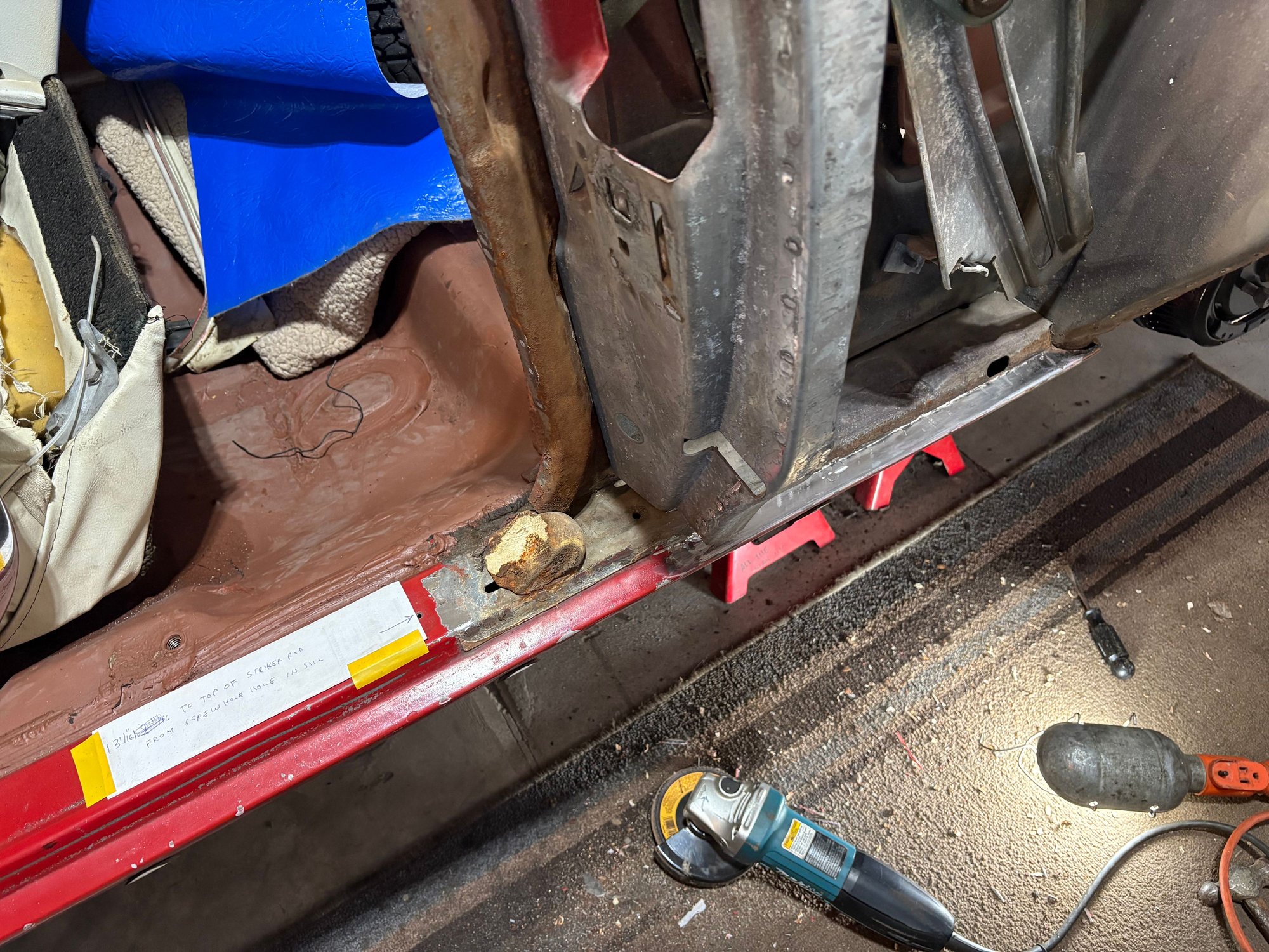

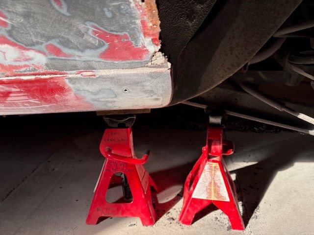

I then sanded out all the body filler to the steel sill piece that goes under the door. It appears to be in great shape, and I am very thankful for that.
I think I need a new quarter skin and also the outer wheel piece Andy mentioned.

For sure it could be way worse. This is the first thing I have found on this car that warrants serious work. I don’t have any donor Sheetmetal in my possession, so likely will buy two quarter skins and two outer wheelhouse skins. The edge of the wheel opening is bad just about all the way around, where the two pieces are joined. The perfect place for road salt and sand to sit and bake and eventually the steel is gone. It is the perfect chance to buy a new TIG setup that I have not been able to justify until now.

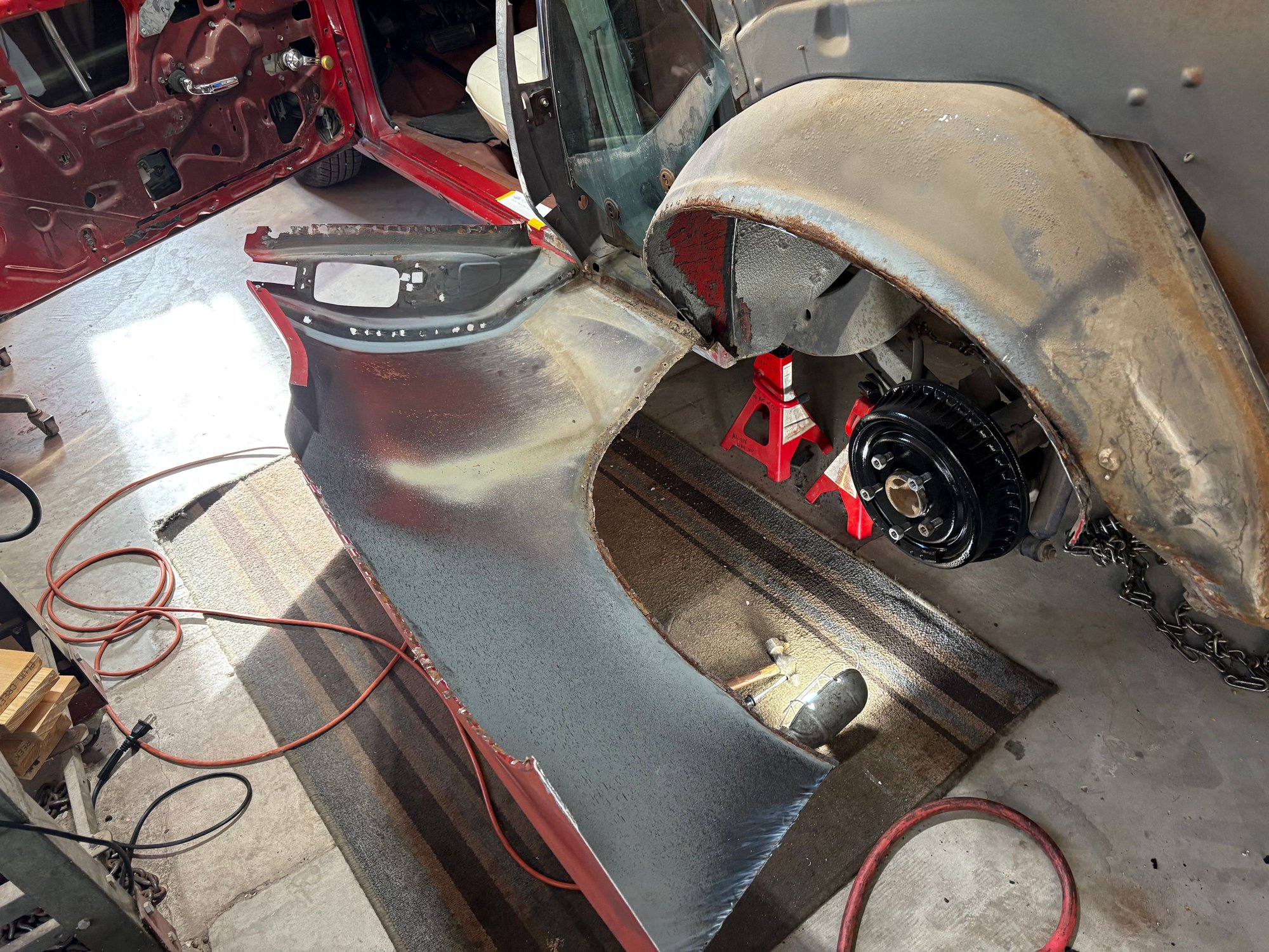

Blue scratch marks are the approx cut, remove, replace areas.

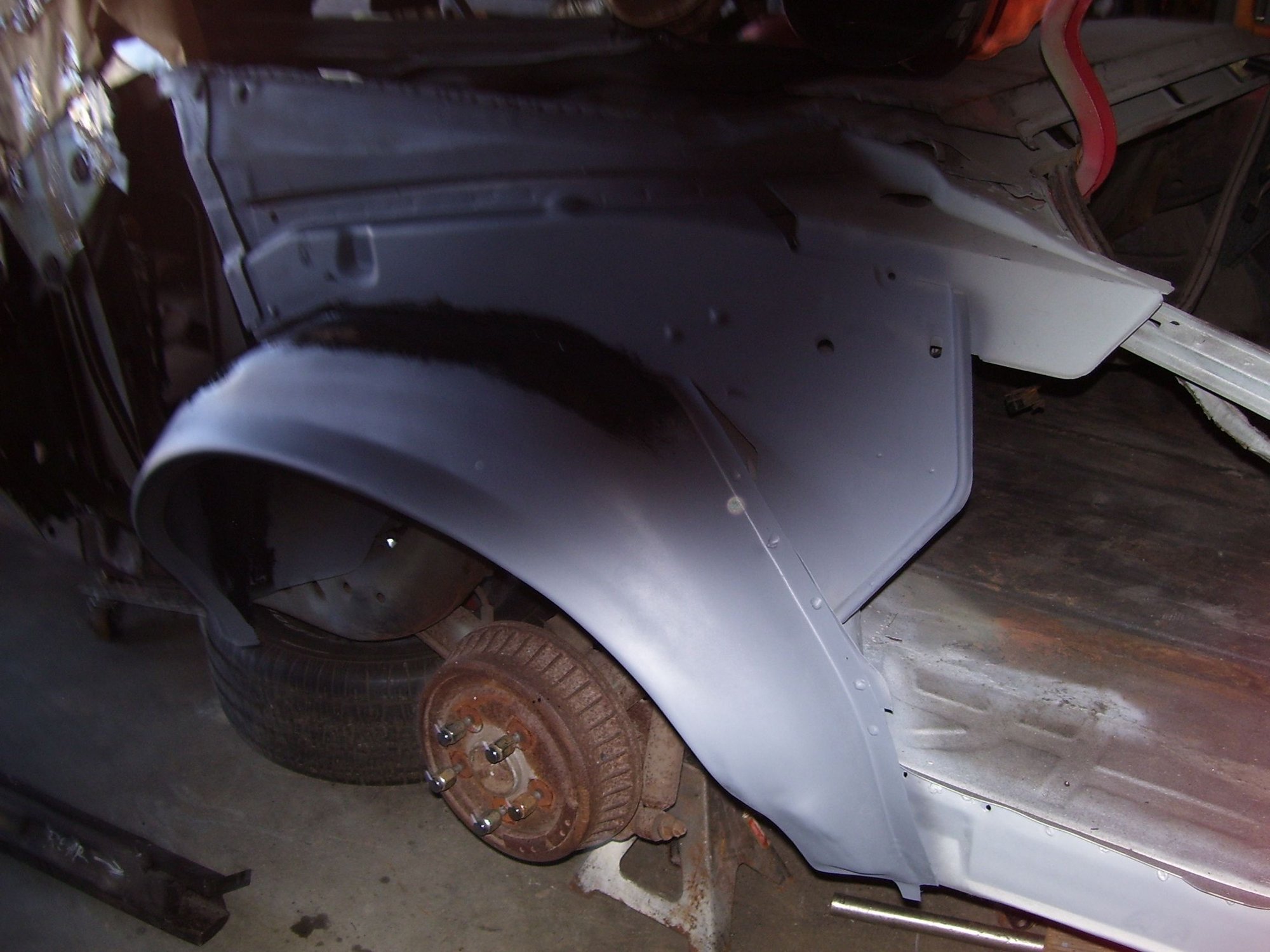

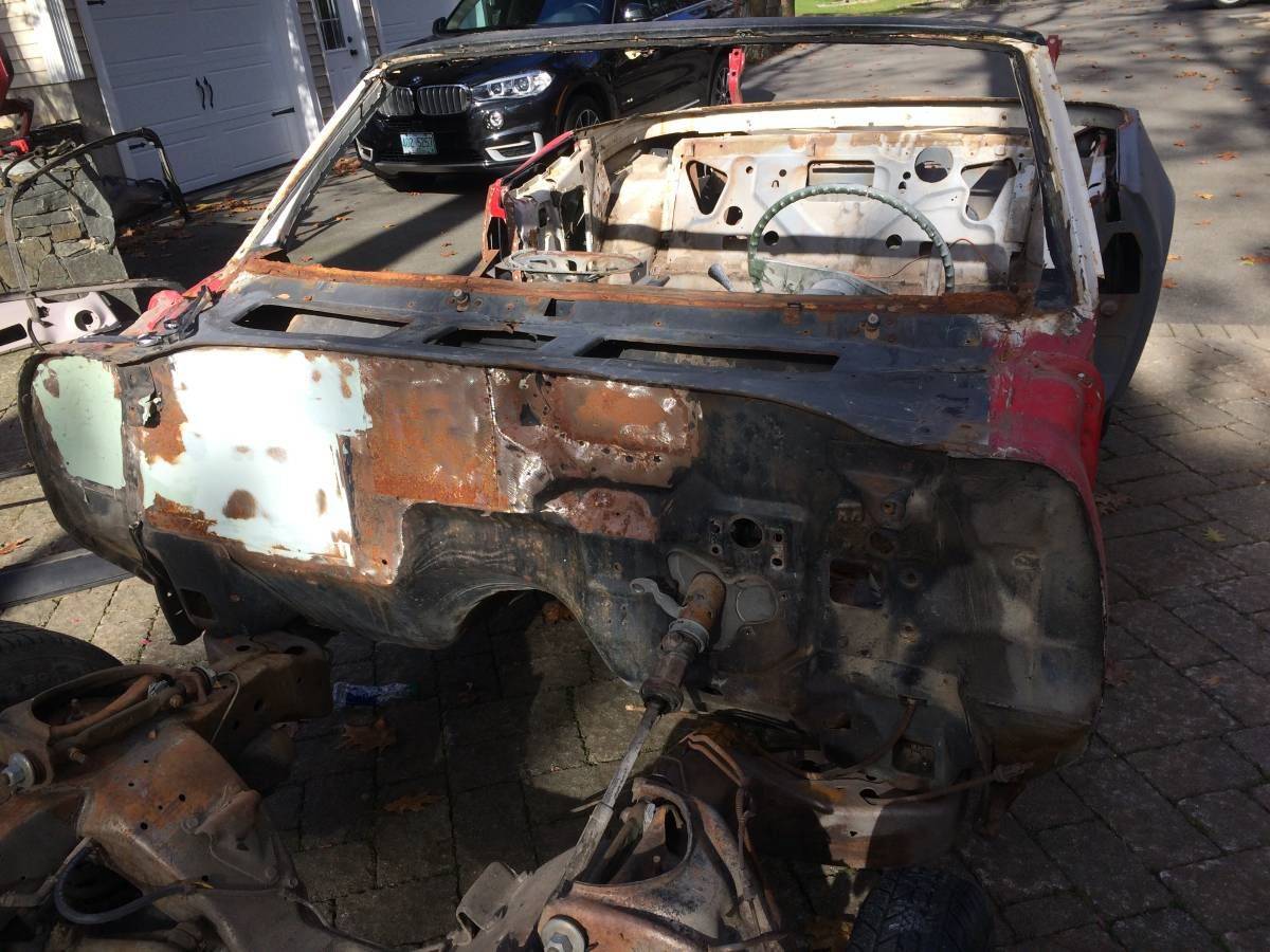

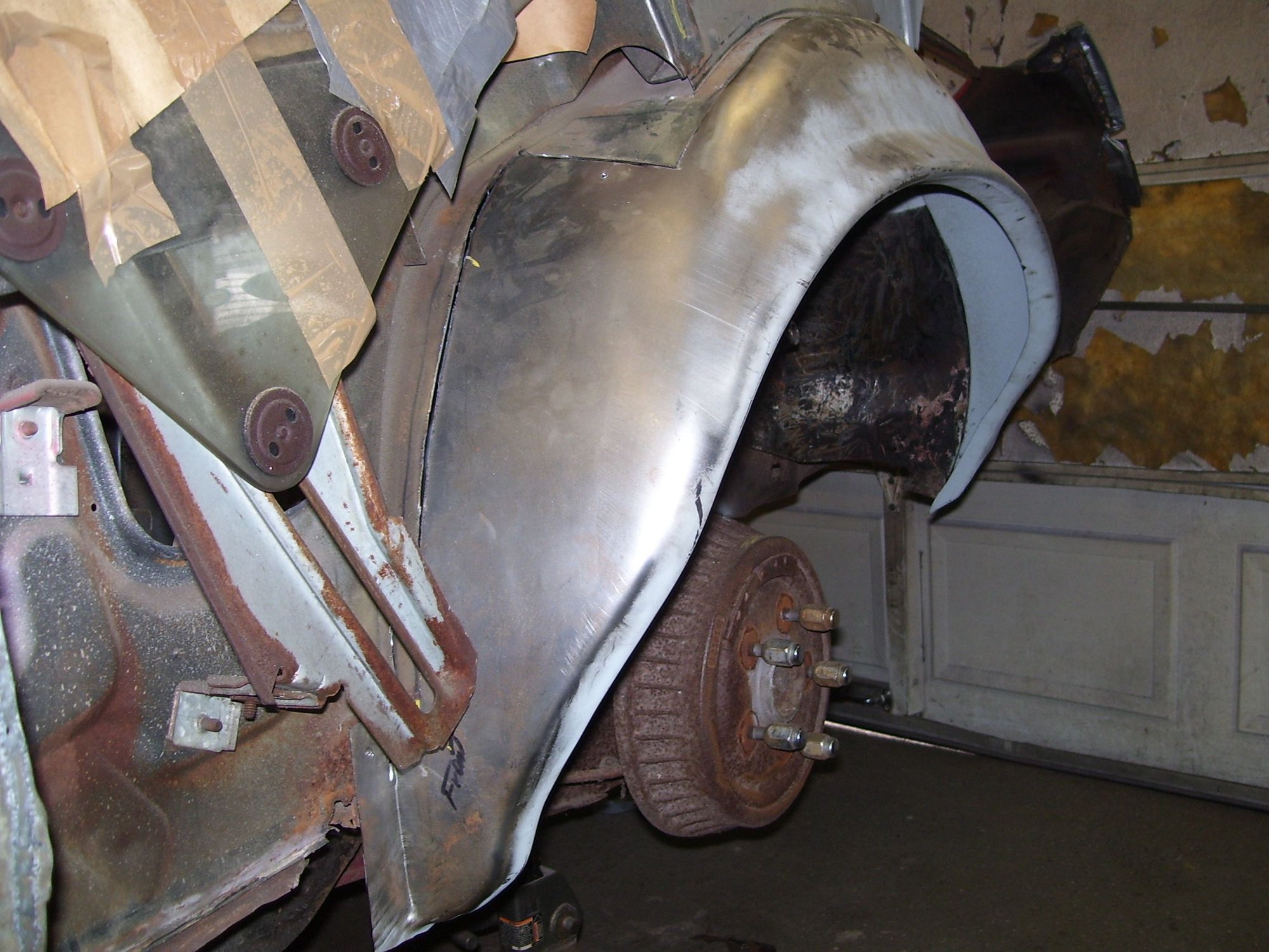

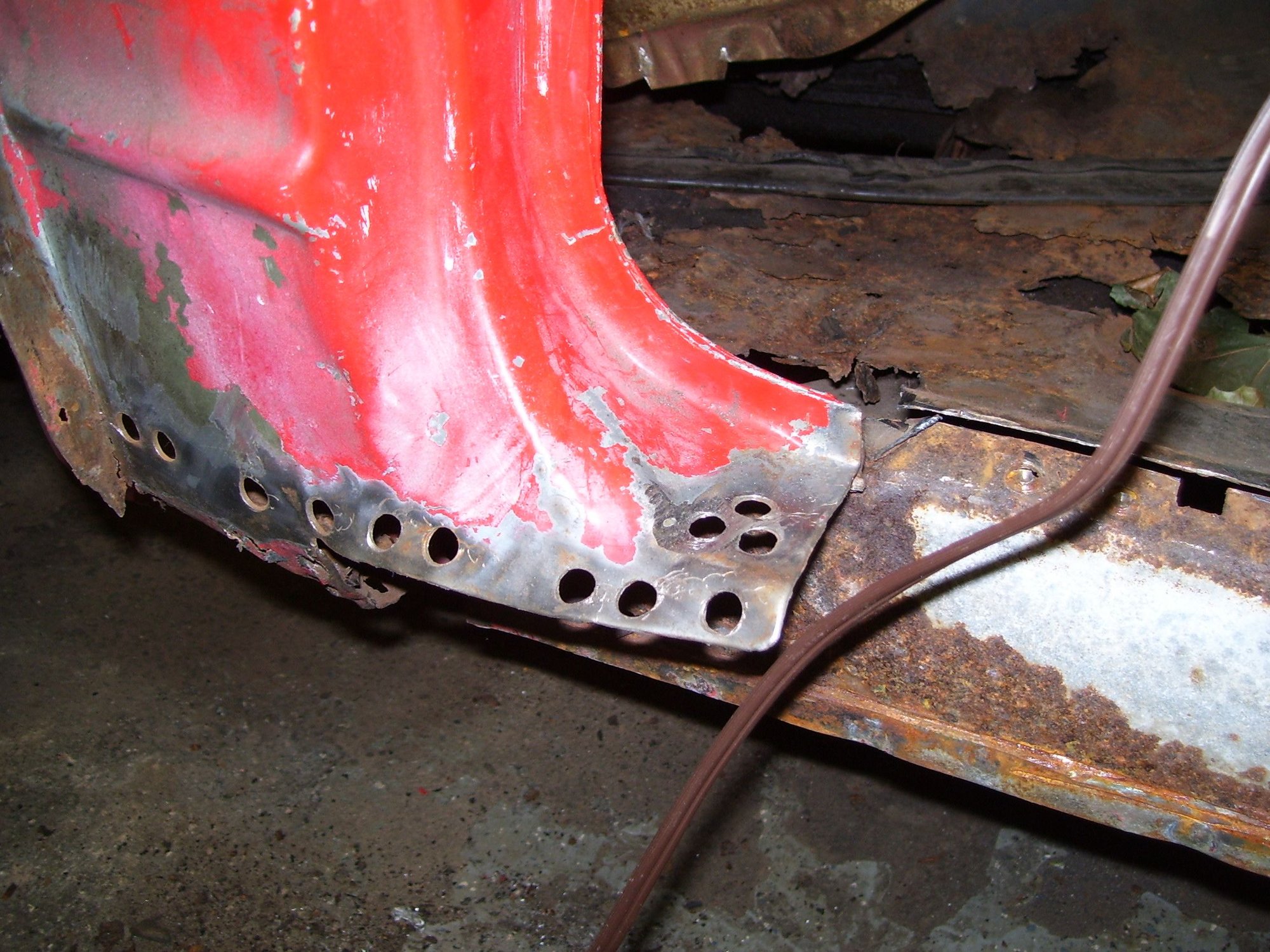

this is how mine started....doesnt look to bad...until...

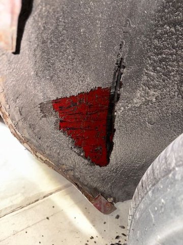

the more i cut away the more rot....inner well outer ,wheel lip, beleive me i can use the mud...and decided no way.... i havent sent pics in along time hope it got their....crankit.
Old Jan 4, 2025 | 08:04 AM

Yea, pic looks good…or bad😀. In this pic, looks like you have started to drill out QP spot welds? Looks like an old sill patch under the door?

rotten outer
rotten outer
i have no idea...something i was fixing..definetly not a cuttlass
much easier than cutting and weldng peices

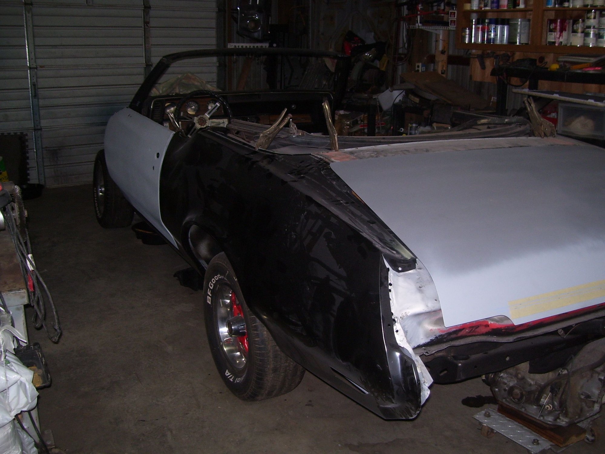

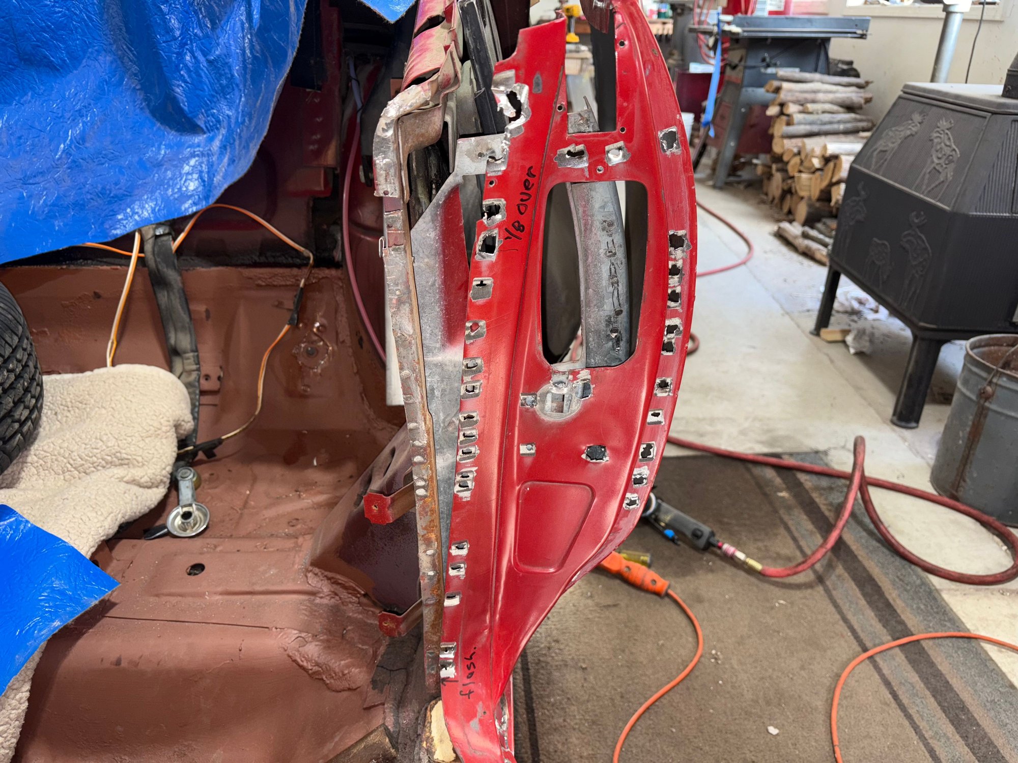

ready to put quarter on all weld thru primer
measuring oldsmobile letters on trunk not for 72 but i like it
quarter on and clecos to hold while its adjusted...and the best part no rot or bondo...nice straight when i go to paint

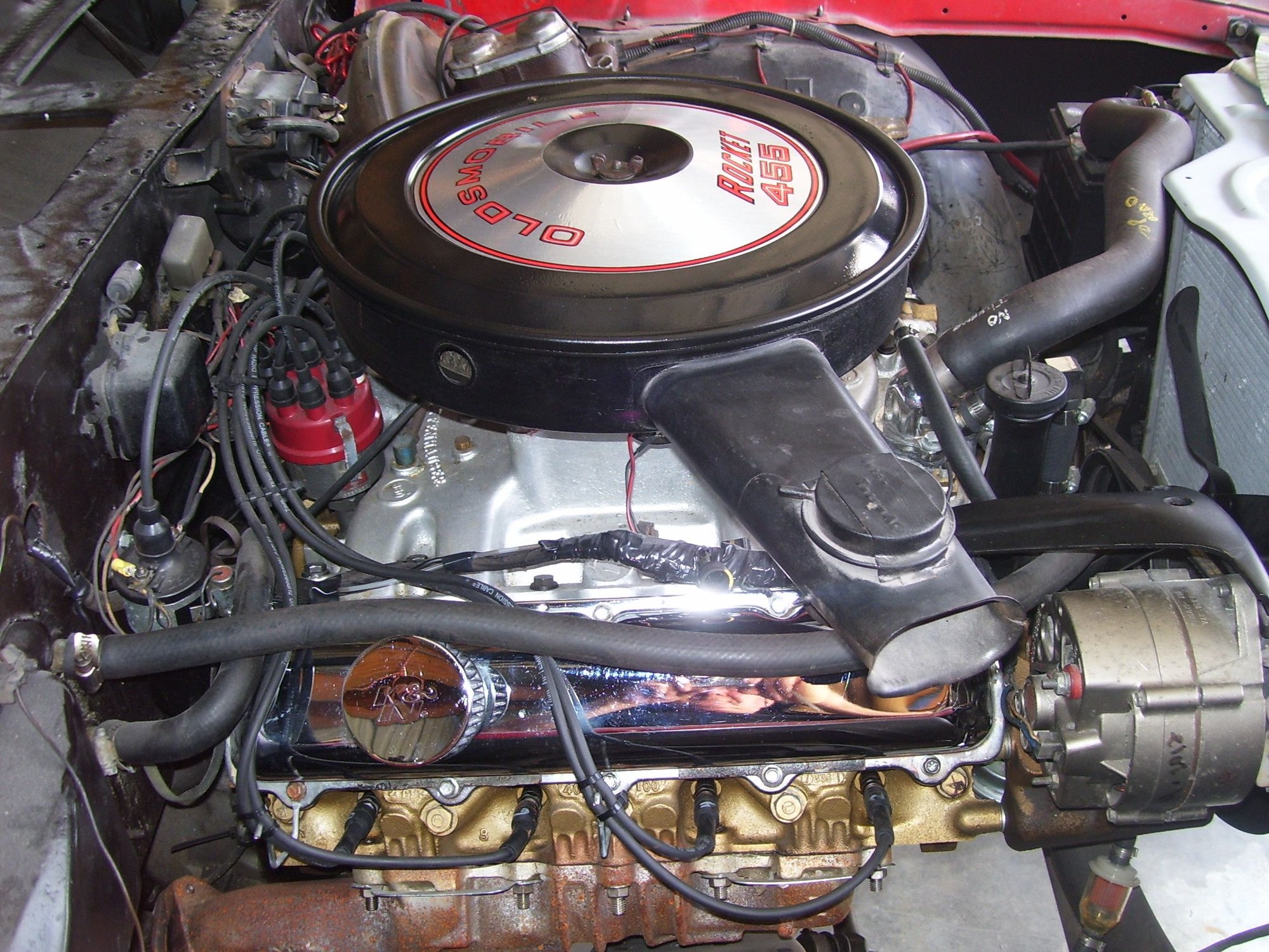

455 swap from 350....bonus pic LOL

Yes those are only a few spots inner outer rockers were done also...dont get me started I have thousands of pics...the admin will have to find more gigs!!! Let me know whether your gonna patch or replace...crankit

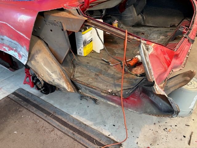

Definitly leaning to replacing the QP as of this moment. I think the time saved doing patch panel work will be eaten up with bondo and extra work to get it all looking good. However, I am good with body fillers.Used them lots on Corvettes, but would like to not mix it with steel unless I have to. If I go full QP I likely don’t need a new TIG welder, just a good little MIG, so that saves a few bucks.

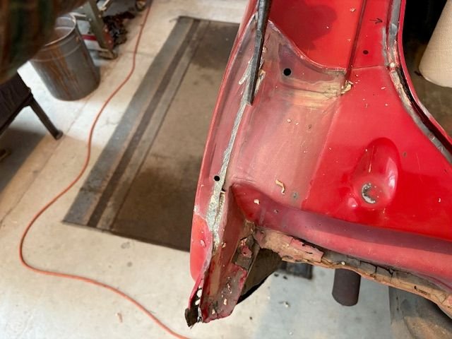

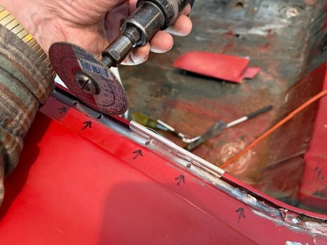

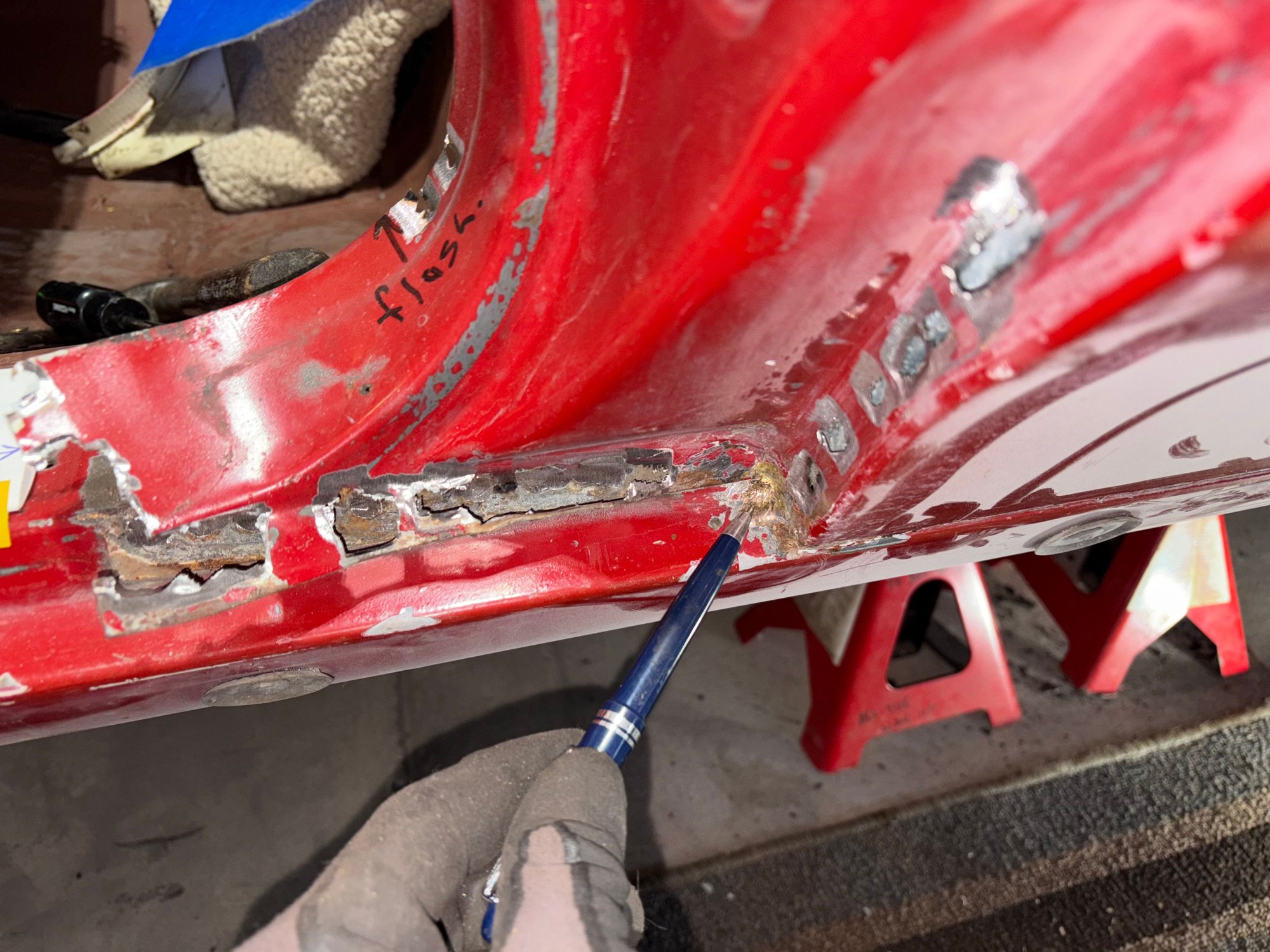

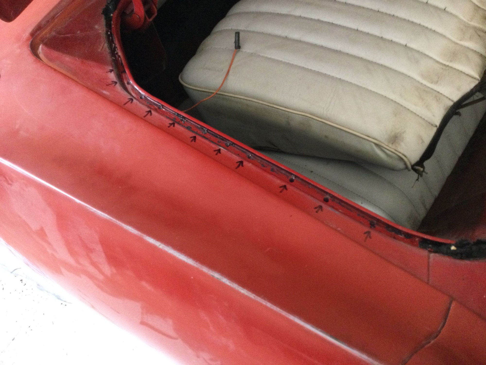

Im starting to dig into it a little. Removed the trunk weatherstripping and found the spot welds. Scraped out some undercoating on the outside wheelhouse and found the joint between inner and outer WH. Looks to me like I need to remove convertible top, SS trim piece, rear bumper, then start cutting out old QP. Then do the remove and replace of the outer WH followed by the new QP.
First, need to buy the parts, and that will take several weeks just to get them.

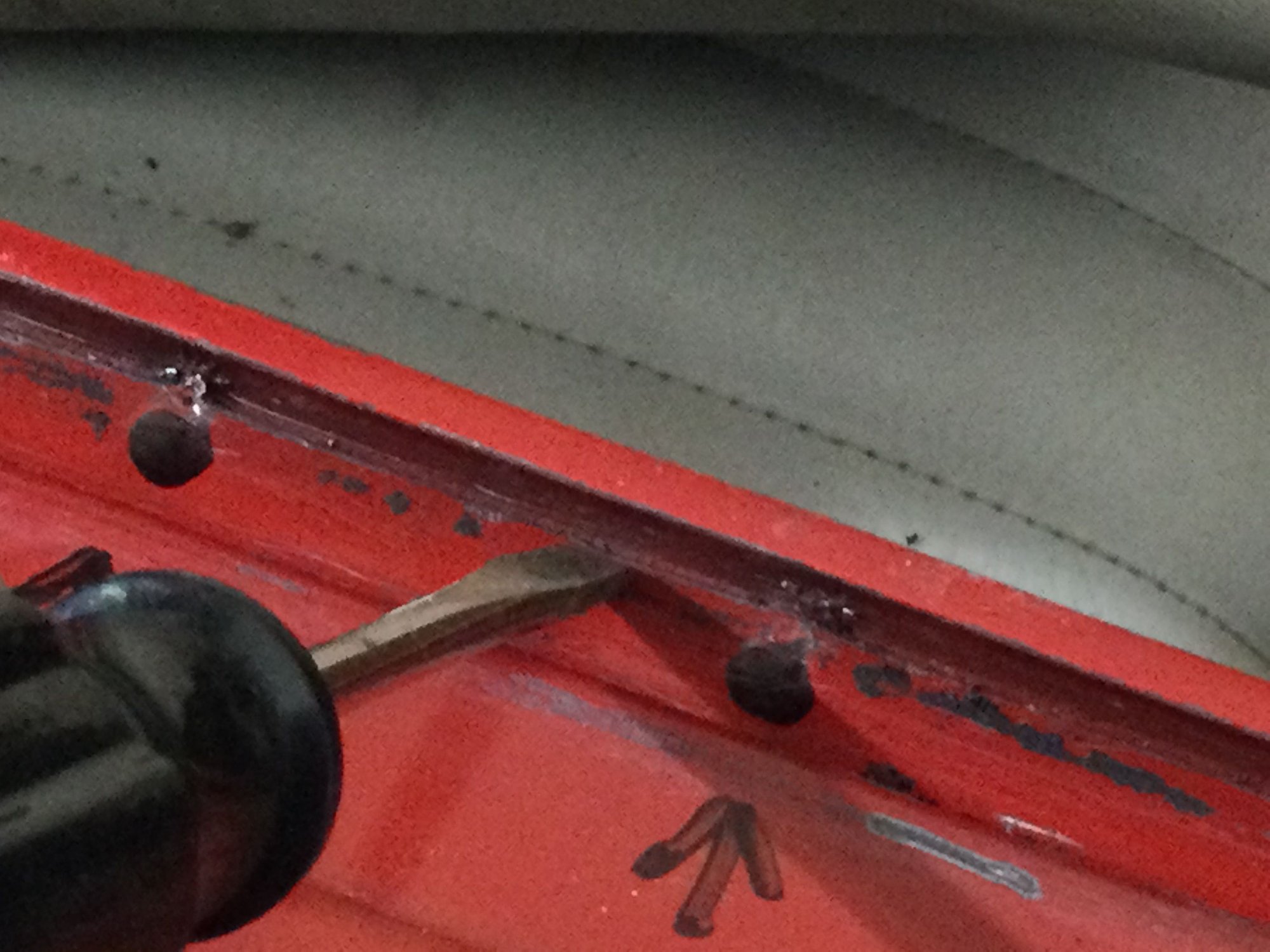

Left side of trunk. Found the spot welds under the weatherstripping. These attach QP to a thin frame for the trunk area.
Hard to see, but end of screwdriver is the edge of the QP. Arrows pointing to spot welds

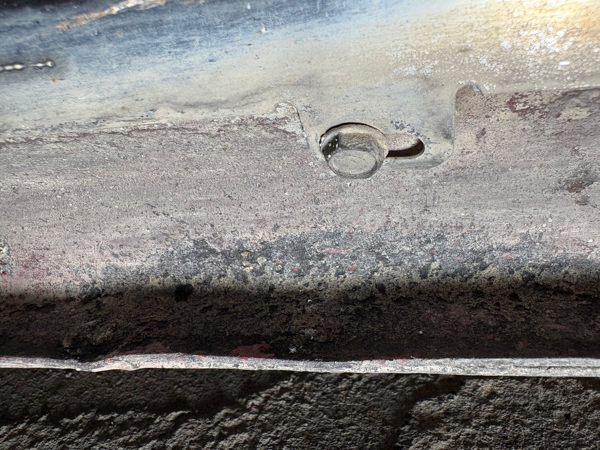

Front left side of outer wheelhouse which was coated at some time with undercoating. I am assuming that the Inner and Outer WH are spot welded together? And will be easier to remove and replace with QP gone and out of way?
Old Jan 4, 2025 | 03:05 PM
Crankit's Avatar
Joined: Sep 2003
Posts: 116
Excellent glad you chose to replace...the qp will also be spot welded to the trunk drop down (usually rotted also) look at my pics of the outer wheel house I cut the old out leaving the convert top attached and cut and welded the new wheel house in their fore never touching the convert top arm on outer well...you can still drill the spots on the top arm and remove entire outer wheel house if needed..crankit...
Old Jan 4, 2025 | 03:09 PM
Crankit's Avatar
Joined: Sep 2003
Posts: 116
Also be careful on the trunk were the qp welds to the trunk edge only remove the qp edge not the trunk frame

Yes I did not remove the whole outer wheel used the new outer to patch it in that way no messing with the top frame or separating the two wheel houses...the metal in thier was nice..really cover your top and well liner...mine is being replaced so a few weld burns in it didn't matter...I was at the same reasoning your at I just love driving it and didnt want to go as far as I did..but a wise old guy said well drive it like it is till the floors fall out or fix it and have it for many years to come...I did allot of work that people couldn't afford a ten thousand dollar price tag ...so little patch here and their ..filler...and medium priced paint...saved them thousands and I made a few bucks...and I have never had a bad customer complaint usually very happy...I think in the end you will have made the right choice and be happier than if you cheated...stay in touch if you get stuck or lose intrest which does happen in this game...crankit

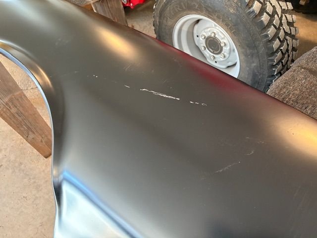

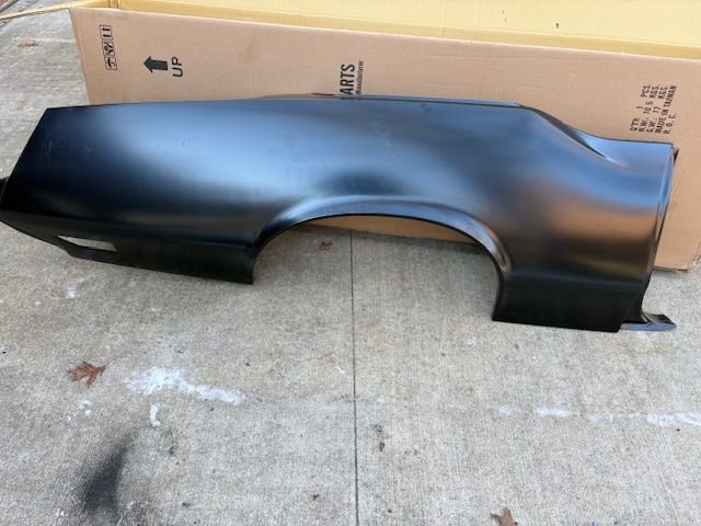

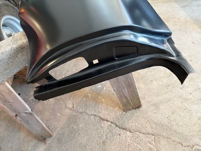

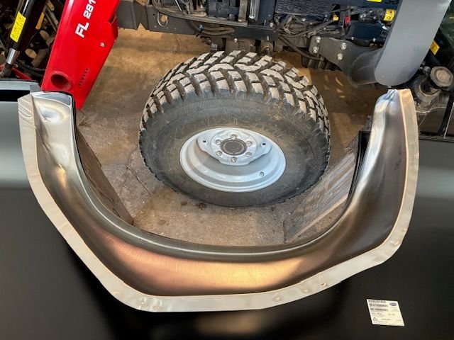

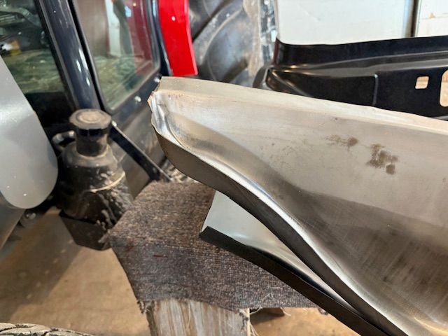

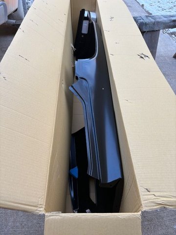

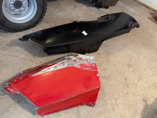

I now have all the new Sheetmetal to start the rear quarter panel remove and replace. Gonna be a new adventure for me. Done much Corvette glass work, but this is first big jump into steel. A few pics
Boxed up pretty well.  Shipping costs from JEGS was reasonable.  160 for both delivered motor freight to my door.
Right side panel looks great
Door jamb area
Door jamb area
Made in Taiwan. Do I wish it was USA?  Sure do, but I’m just happy that some company somewhere actually sees value in making and marketing them.  Hoping they fit well.  We shall see.
Left side panel had a little damage.  Just a surface scratch in the paint.
I laid the new outside wheelhouse next to rim edge and it looks like it nests reasonably well.
I thought that I had the wrong thing, because the wheelhouse looked long at the front
But then I remembered that the front of the quarter panel does not go all the way down to bottom of frame.  The sill piece under the door integrates with it.  I just don’t know how the connection is made?  I’ll discover that during disassembly

Got started on the left side quarter removal about noonish today. Bumper and trunk still on the car. Figure I’ll just remove parts as it becomes necessary. But they were both soon off the car.
The before removal picture.  No spot welds to remove at wheel rim areas.  All rusted away.
Grinding out spot welds behind the tire area.  Marked them with a black marker to make them easier to see
My prime tool for spot weld removal.  Ingersol Rand 1/2” wide by 18” long air belt file.  Nose is about 5/8” diameter or so.  I’m running an 80 grit belt.  This thing works awesome.  Takes about 5 seconds to grind through top layer.
Loosened bumper and pushed it back.  Should have just taken it off right away.  Spot welds marked
After grinding
After grinding
Using a stiff putty knife to separate the welds
So at this point I have the panel loose from front of wheel to the top of the bumper area. Next up is working across the trunk frame and separating the leaded joint by upper part of trunk.

Snow in Iowa, so shoveling slowed me down some.
The die cast end piece is attached with two stud anchors and speed nuts.  Came off easily
This area is a combination of seam sealer and spot welds
Quarter panel broke loose
Touch area, with spot welds very close to the trunk frame that Crankit mentioned.  Used. Piece of aluminum sheet bent up as a protector.  Used a die grinder and cut off disk to grind welds down to where I could work them loose
Touchy area, with spot welds very close to the trunk frame that Crankit mentioned in post 24. Used a piece of aluminum sheet bent up as a protector. Used a die grinder and cut off disk to grind welds down to where I could work them loose
As much as I wanted to remove the QP in one piece, I could see that it would make this touchy area go better if I hacked off the rear half of the panel, so I did so.
I checked steel thickness.  Both old and new were at .036 + or - depending on where I measured.  So at least the replacement panel is as thick.  Whether or not the steel spec is the same, I have not a clue.

Hope I’m not boring you all with this thread. Yesterday I worked on finding and disconnecting the QP panel joint just behind the left corner of the Convertible top. The joint is filled with about a quarter inch of lead. Best way I could find was to use a propane torch and as wire brush to remove the lead. Kind of scary because I’m torching just a few inches from the convertible top. So I used some aluminum plate shielding and some water to help protect it. Worked pretty well, as I was able to melt out the lead and find the spot welds pretty well. Also not a fan of grinding this out as lead dust is not a good thing to be breathing.
Sanded off the paint and I could then determine extent of leaded area.
This is when I am about half way melted out.  Going slowly and making sure Fire Dept was not going to be needed.
All melted out and spot welds drilled out.

So I think this will be my last post for this thread. I’ll start a new one for fitting up the new wheelhouse and QP. But to wrap up the removal, here is what I did.
Lots of spot welds in the door jamb area.  I missed several around the door strike stud, and had to go back and get them.
I knew I wanted to fold the panel down and out.  To,do,this just a small piece needed to be cut right where the top bump is.  It hooked and welded to the substructure.  Once removed this enabled the panel to move out and down
I knew I wanted to fold the panel down and out. To do this just a small piece needed to be cut right where the top bump is. It hooked and welded to the substructure. Once removed this enabled the panel to move out and down
Again I found two spots of brass.  One here in the corner of the door jamb, and another one a t end of rocker panel.
Now I could fold the panel down and figure out how the bottom forward of the wheel was attached.
This is where the QP meets the rocker panel.  I thought it was joined with seam sealant or another adhesive?  No way to get at it with a welder.  But indeed it was spot welded.  Most likely as an assembly and then dropped on to,the frame.  But as it now sits, there is no way to weld QP to rocker.
This is where the QP meets the rocker panel. I thought it was joined with seam sealant or another adhesive? No way to get at it with a welder. But indeed it was spot welded. Most likely as an assembly and then dropped on to the frame. But as it now sits, there is no way to weld QP to rocker.
Here is the other spot of brass.
So I cut the QP at the flange line where it joined the rocker
Marked out the spot welds and ground them out with the air file.
The last piece!
The last piece!
One little blob of foam where the curved jamb sat on the door sill. The door jamb substructure is galvanized
So,this is my car that looked OK and I was driving it just a month ago!
Came out in a total of 5 pieces.  Probably would have been easier if I had chopped it up into more pieces.
Anybody want to buy a used QP?
