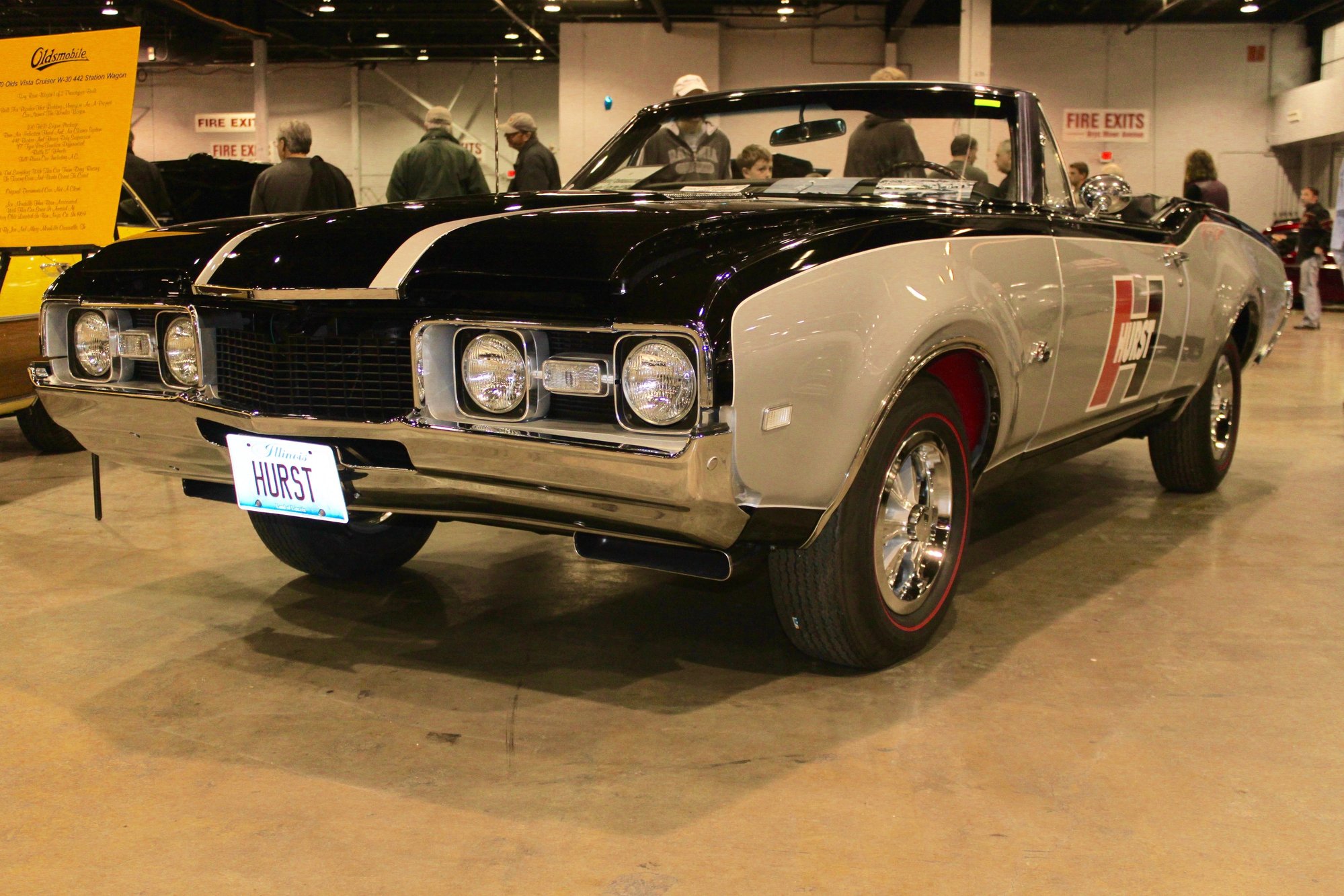

1968 442 double dash with a 2 at the end
Old Nov 20, 2023 | 05:14 PM
allyolds68's Avatar
Posts: 5,507
From: Seneca Falls, NY
Oshawa seemed to use whatever letter code GM used. This is a 68 with a non-Olds color Q-Q which was Verdoro Green.
Old Nov 20, 2023 | 05:31 PM
Posts: 50,802
Interesting. Usually there's only a single dash with the convertible top color.
