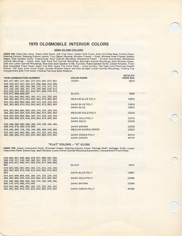

What's the proper color for the metal part of the dash upper and lower on the 1970 442. Looks to be some type of flat black originally thanks. Greg

Paint codes are right on the back of the color chip charts. A good paint shop can cross these numbers for modern formulas.

Thanks. Will check with paint shop --------
