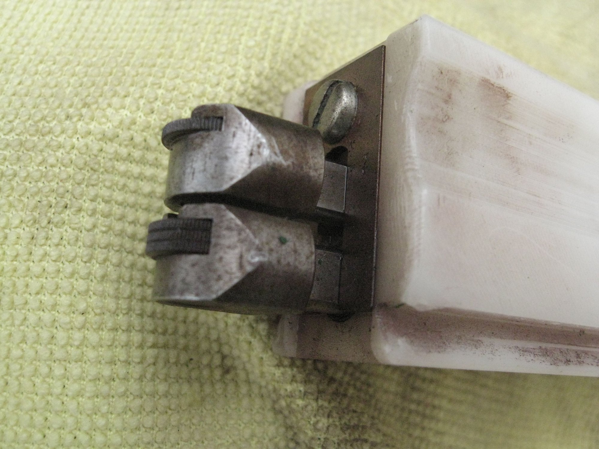

Dual Striper Tool used at the factory
This my friends is the tool they used to stripe [edit- was "strip"] your Olds at the Lansing factory. Shown in use in the 100th anniversary book.
Thick -n- Thin stripe wheels...

So, was this hand held?

Beugler offers a similar tool and may have made these. I know a couple people who bought them and got passable results for folks who didn't really know what they were doing.
I admire people who can lay down a pinstripe, either with this tool or with a brush. My hands aren't steady enough anymore.

I had one for years that you could put the single wheel on for single stripe, or double for two.Thanks for reminding me ,I loaned it to a friend ,and he has not brought it back. That gives me a good excuse to go see him tomorrow.
It was a chromed metal cylinder with a plunger at one end,and the wheel attachment on the other.The paint went in the cylinder,and when the wheel began to get low on paint, you just pushed on the plunger,slightly. Larry

It was absolutely a handheld tool + job. Thanks for posting the pic, it's neat to see the tool! Right...Beugler, it's probably one of those. I think you can buy a modern cheaper version from Eastwood now.

Thank you so much for posting this. I have never seen this before but knew they had to roll some of them somehow. I had a 72 W-30 with original stripes on the deck lid and you could see the little lines from the roller. Nobody believes me when I say that.

The cross hatch or knurl lines? Really? OK
I thought those were to give the wheels a grip and provide space for some paint during delivery to the car surface.
I figure these were hand held, see the 100 year book for a pic of it in action.
There is however a dovetail feature so I assume that some sort of guide was attached to maintain spacing to a handy nearby body line.
Please note that this dual roller unit is SPECIAL- it has a thin and a thick roller. I recall that my brother's '67 had differing width stripes on the fender, and my '68 442 dash stripes are not the same width either. Wondering how they brought the 2 stripes together at the end on the 67 front fender- twist the tool? brush by hand?

I knew a guy in Boaz ,Al. that used a roller tool like the one I mentioned, professionally and the new car dealers around there would order their inventory without stripes,and pay him to stripe them. He would run a line of quarter inch tape,as a guide,and place the wide stripe against the tape line and he could stripe each side in a minute or less.He would twist the tool to where only the wide stripe would touch the surface, about 4 inches before the end of the stripes,then go back and line the smaller wheel and finish to a narrowed end.
If anyone is interested look up Beugler striping tool on Beugler .com
The exact kit that I have is The Deluxe Kit (in red box ) that sells now for $113! He used "One Shot sign painters paint". Larry

I would assume this is correct. If you looked at my stripes close you could see the lines in the paint. I had talked to Level one about adding stripes to my 70 W-30 and asked them about it. They were the only ones I ever talked to that knew why it was this way. I had never see a roller to understand the lines but now I know.
