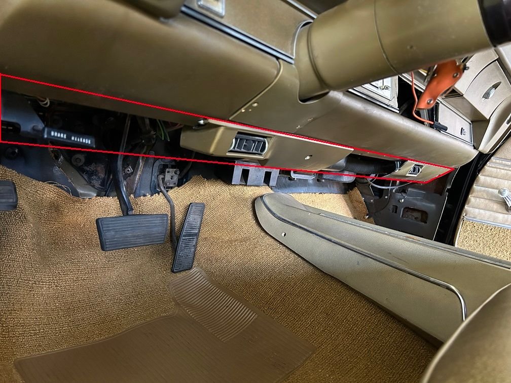

This is for the 1970 Cutlass S interior.
I need to get some interior paint to fix the dash pieces I acquired to replace the hackery. Also, The Parts Place only has the front kick panels in black so I would need to paint them gold too.
The question: what is the color name of my interior that is gold colored? Is it "gold" or "mustard gold" or?
I also need to replace the underdash piece that was chopped up to mount stuff by the previous owner.
Anyone have one of these?

I probably have that lower vent piece and also have a '70 gold interior paint I had mixed per the PPG interior color paint code.
If the pic you show is what you have now then you might want to remove the two "louvered" vents to transfer them over to whatever lower AC vent valance panel you get.
I'd have to have a complete address to get a good shipping quote.....would probably want to use a good reinforced box for shipping since that piece is long and not a real strong item. I could paint the piece with the goldl mix I have but no guarantee it'll match the rest of your dash since it appears various parts have faded and/or changed colors over the years.
I would need to double check my paint supply and make sure I actually have the extra vent valance panel.
