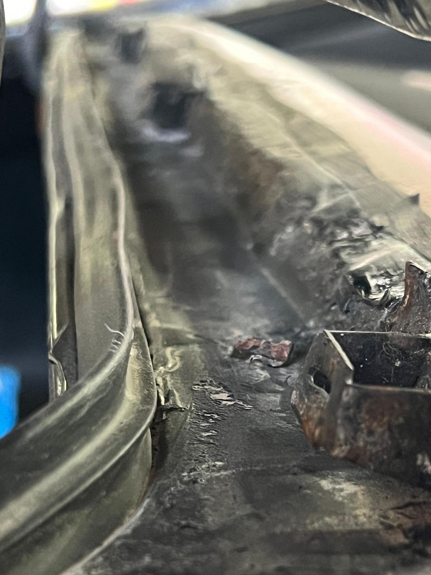

Hello guys, I'll tell you.
I am working on the car, I have removed the front and rear windshield and I have ventured to remove the upholstery, sand and paint the floor.
Everything was fine until I removed the rear trim and saw what I show you in photos.
I also have the problem that when I wash it, water gets in, and I'm afraid that it could get into that area.
The sheet metal that I have just below has 3 holes where if I put my hand to feel it seems that there is something that is not right, an area that is too rough which makes me understand that there may be some rust.
What do you think? Is this an "invention" that was made to cars to protect the area or is it really a botched job to mask some area with possible rust?
I'm going to take it to the body shop soon and it would be very helpful to know your opinion on whether it's worth cutting and repairing.
Thanks in advance.
Regards
Old Oct 20, 2024 | 11:42 AM
Posts: 50,799
Unfortunately rust there is all-too-common on these cars and no one makes a repro part.

Hi guys.
Well, I think I should clean up that area, there is something I don't see quite right and I think the problem must be there.
Also, the link that Hoffman shared makes it a little clearer to me, in that area they put a kind of protector to cover the area, but even so it seems that it is not waterproof and water enters through there, I understand that it is because underneath It is not in good condition.
We will have to cut to confirm.

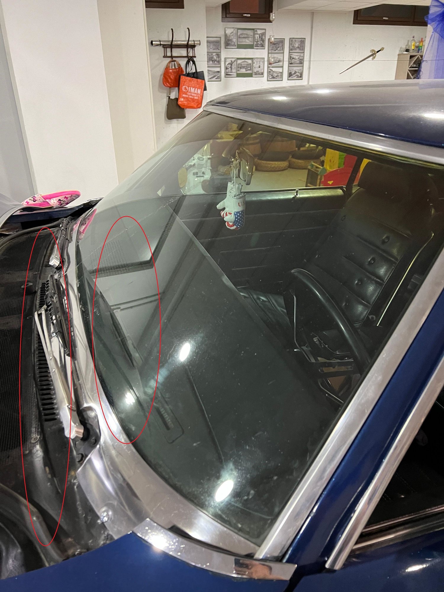

Looking at this photo, I would like to know if the area that I have marked in red is normally the same color as the body or is painted a different color.
The area that I have marked as blue I understand that it must be the same color as the body.
Thanks in advance.
Regards
Old Nov 22, 2024 | 03:26 PM
Loaded68W34's Avatar
Joined: Jul 2020
Posts: 1,942
From: Pennsylvania
The area in red should be the color of the interior, not the exterior paint color.

Hi guys.
I have already picked up the car from the body repairman, he has fixed that area for me. Indeed, there was some rust and they waterproofed it with that black paste that is in the previous photos.
I hope that after this arrangement, that area will last another 50 years.

Hello guys, a question.
Will the area where I point out (mini red line) be blue or will it be covered once I install the windshield and chrome trim?
Thanks.
Regards
Old Jan 9, 2025 | 12:45 PM
Posts: 50,799
Yes
