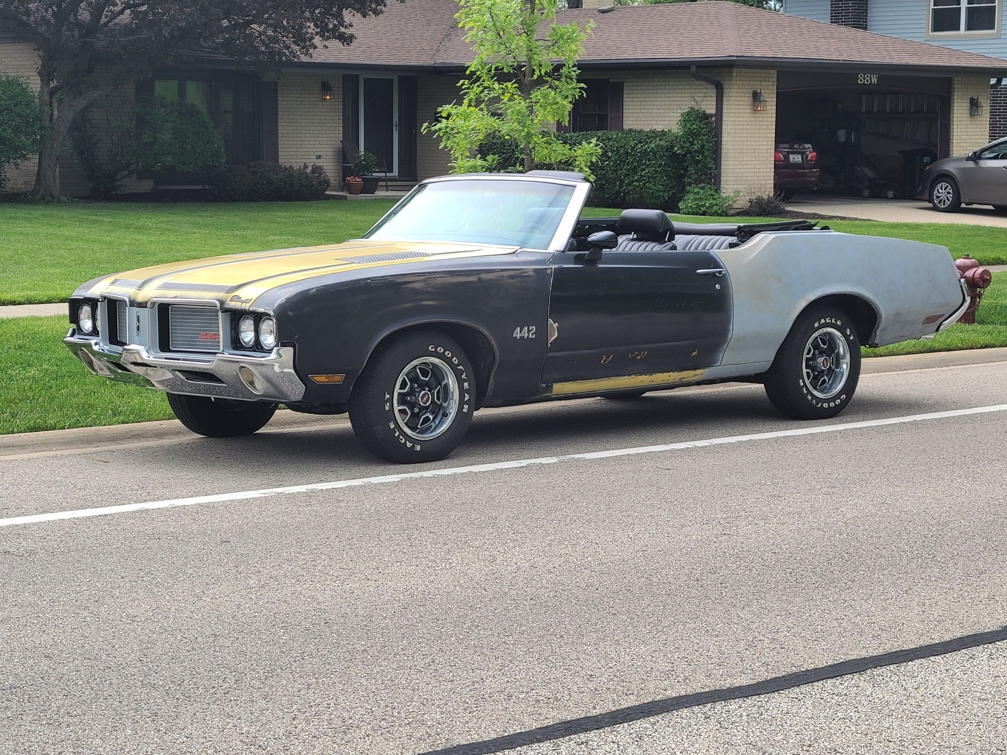

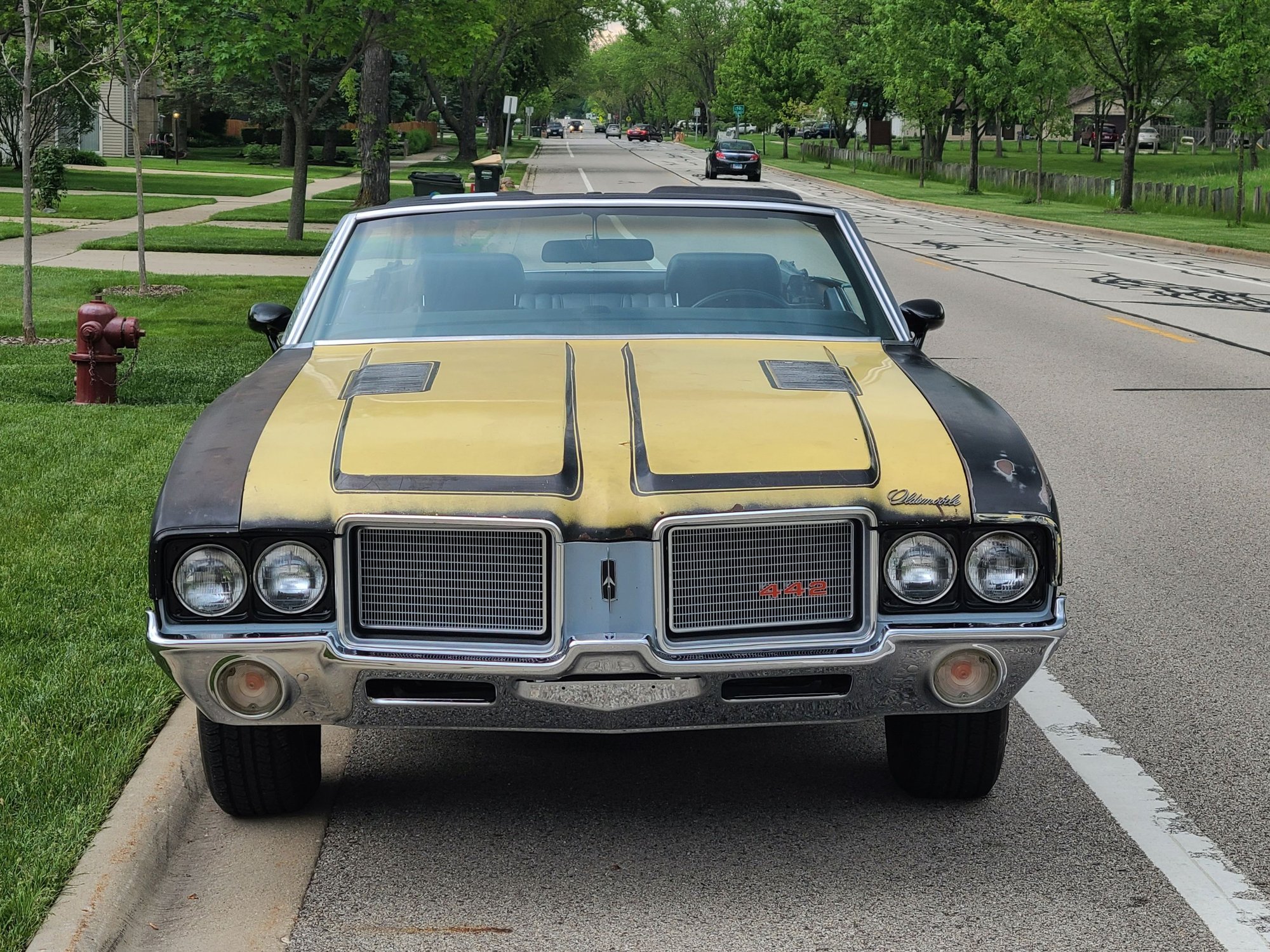

Back on the road again

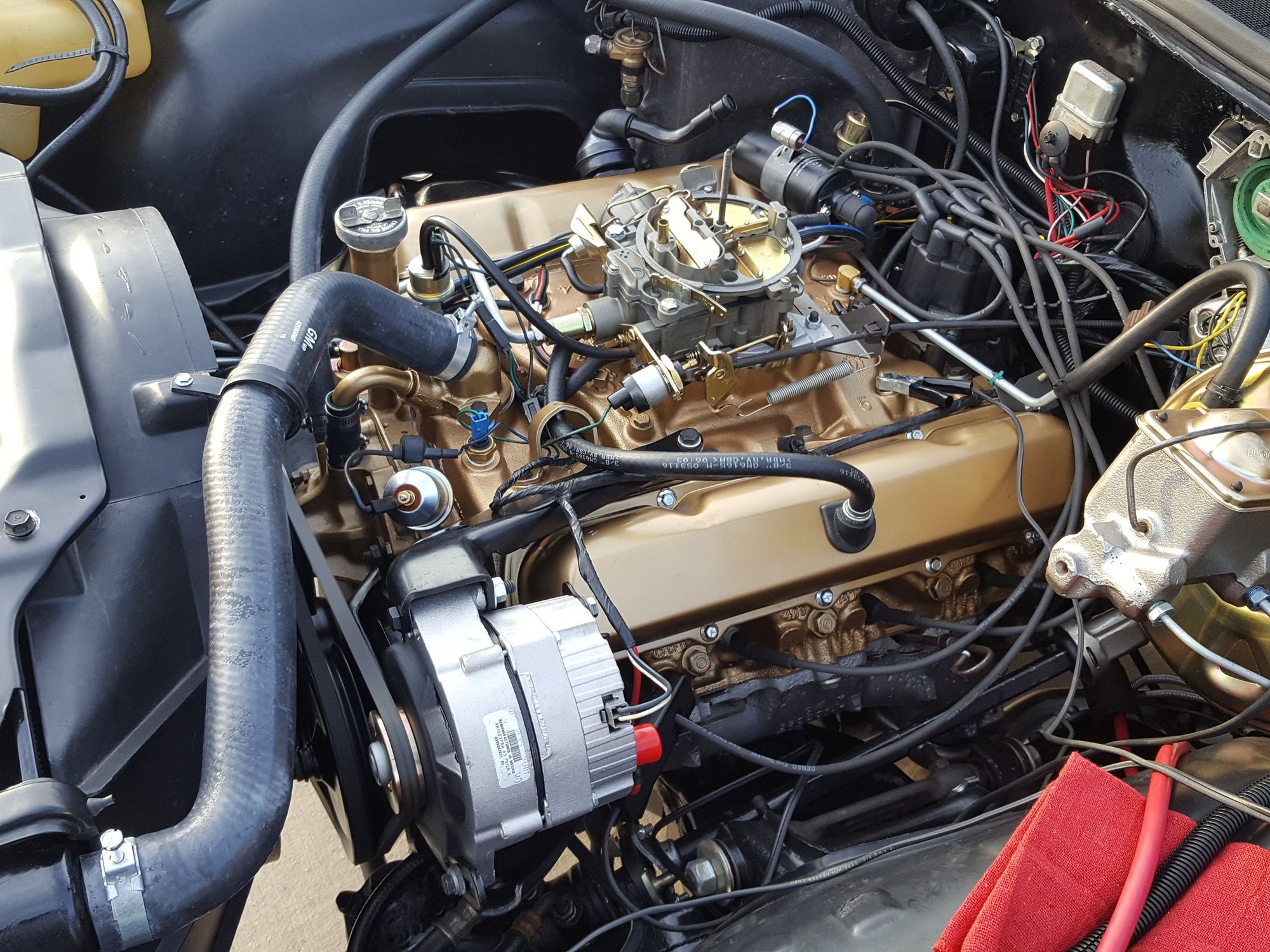

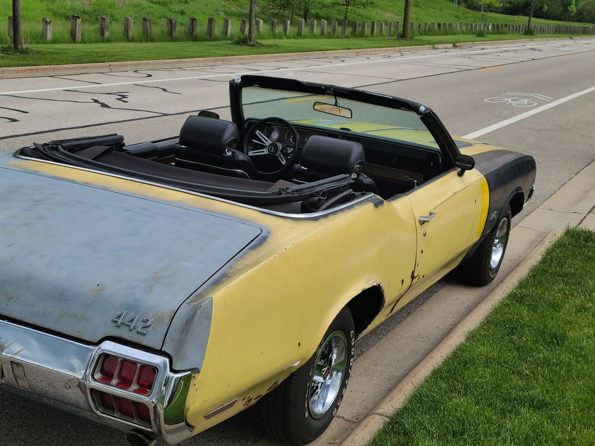

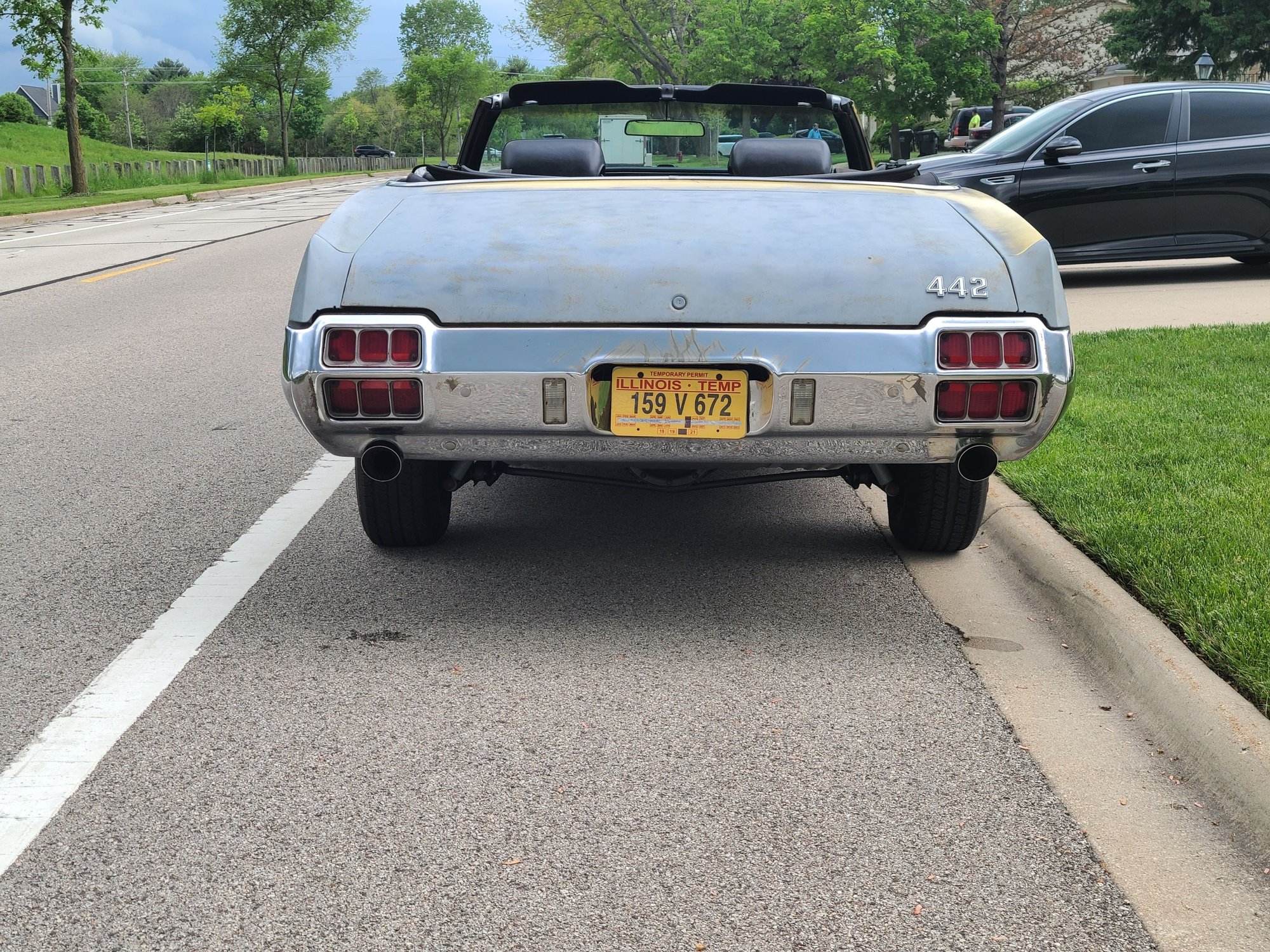

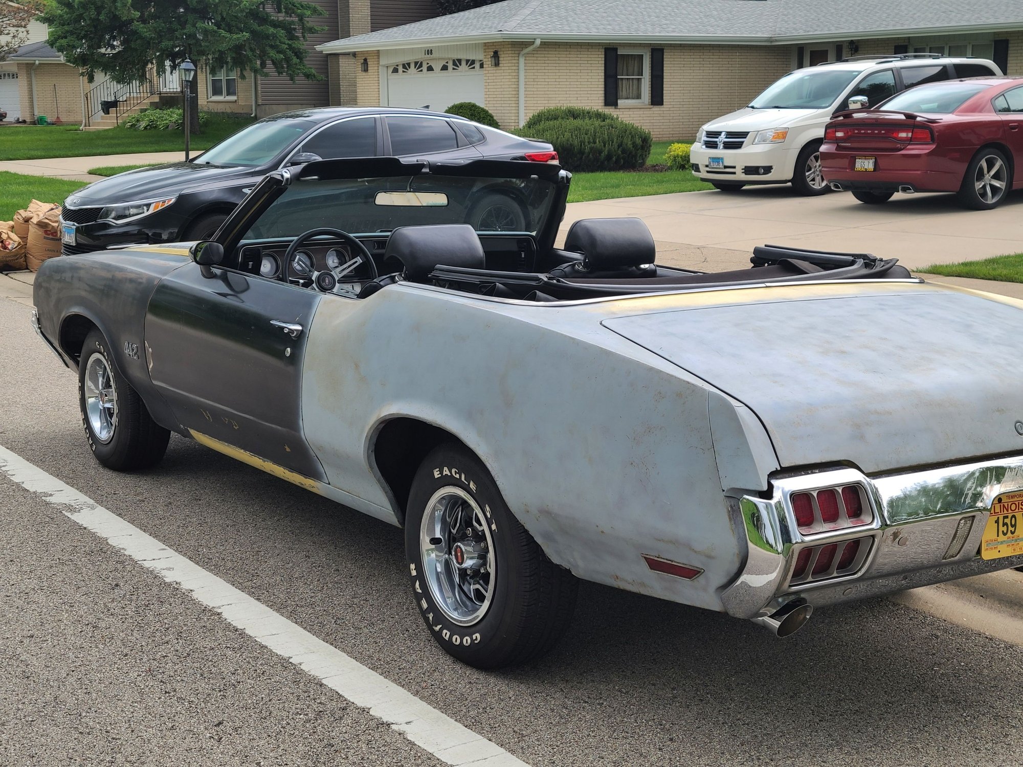

Here are some pictures of my 72 442 convertible I have owned this car since 1992
it had 38000 original miles when I got it,41000 now
I replaced the front fenders when I got it because the bottom behind the wheels were rusted.
the Trunk deck lid was replaced because of rust all along the lip.
Had I knew then what I know now I probably would have just repaired the originals, instead I bought NOS fenders along with a NOS Trunk Deck lid
I also got two rust free donor Doors. The Drivers side was changed, the Passenger side still needs to be done.
I have a right side NOS quarter and am sourcing other parts for the Quarter replacements.
You can see from the pictures what I have done just to get it back on the road so I can enjoy it.
All of the interior is original aside for the front buckets which I redid about 25 years ago
The car ran and was drivable until I started working on rust repair 15 years ago, core support under battery, Drivers front floor, Drivers Torque box, Right and left Trunk floor sections.
I had to repair most of the Frame Body Bushing holes also.
I have a video of the car running but can't upload it.
I have been a member of CO for many years and just thought it was time to post some pictures and tell my story
except for the Top which I hade replaced when I got the car and the Engine Heads I had redone just last fall I have done everything myself ( sometimes 3 and 4 times) LOL
Thank god for service and Assembly Manuals and the ever helpful Classic Oldsmobile Members.

Nice work. Good to see the car is retaining it's proper W29 442 hood and stripes. Not very many of them around any more. This appears to be a post January build as evidenced by the seat belt pod on the dash. And properly badged as Cutlass Supreme on the glove box lid.

The plan is to repaint it some day back to the original sunfire yellow
right now I just wanted to get it back together so I could drive it

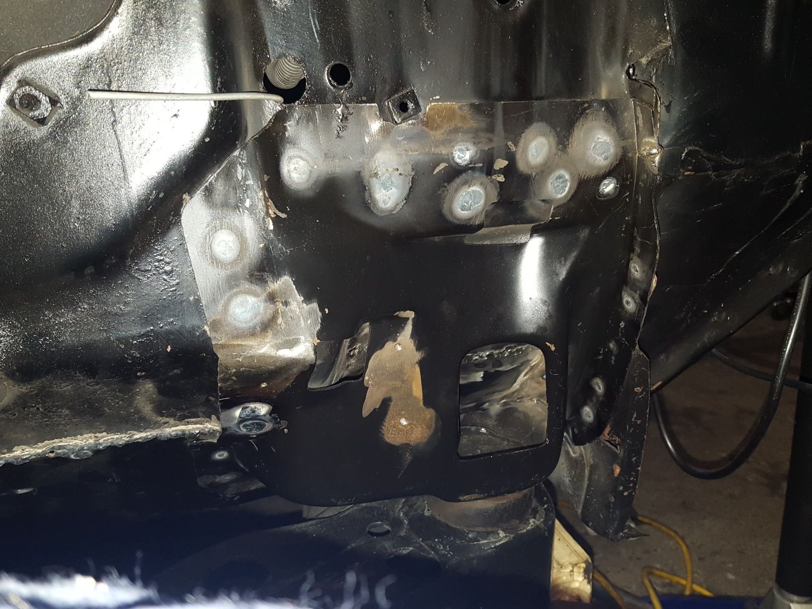

in the mean time here are some pictures of the Trunk repairs

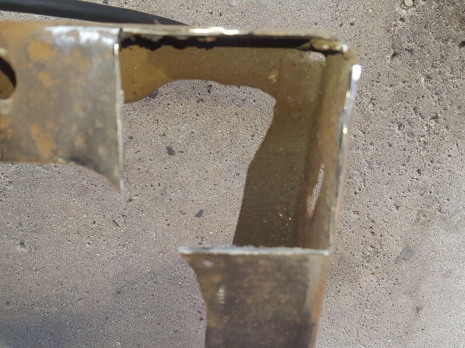

I had to replace the trunk floor braces because the Bushing mounts were rusted out along with some bad areas in the pan
the worst of the rust in the right trunk section
I had to piece in above the patch panel
Had to cut out all the way up to the trunk divider bracing
test fitting the panel
starting the tack welds
the million spot welds that needed to be drilled out
Stay tuned for some of the after shots

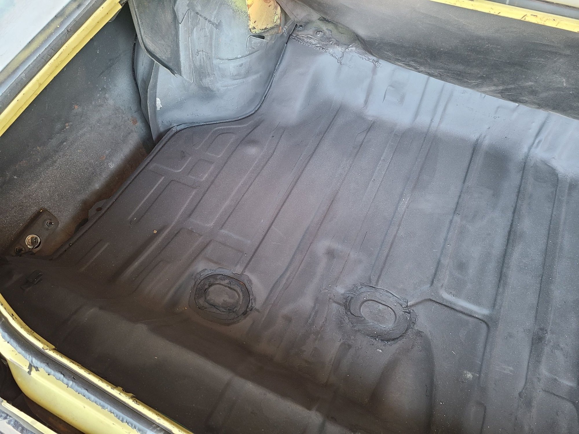

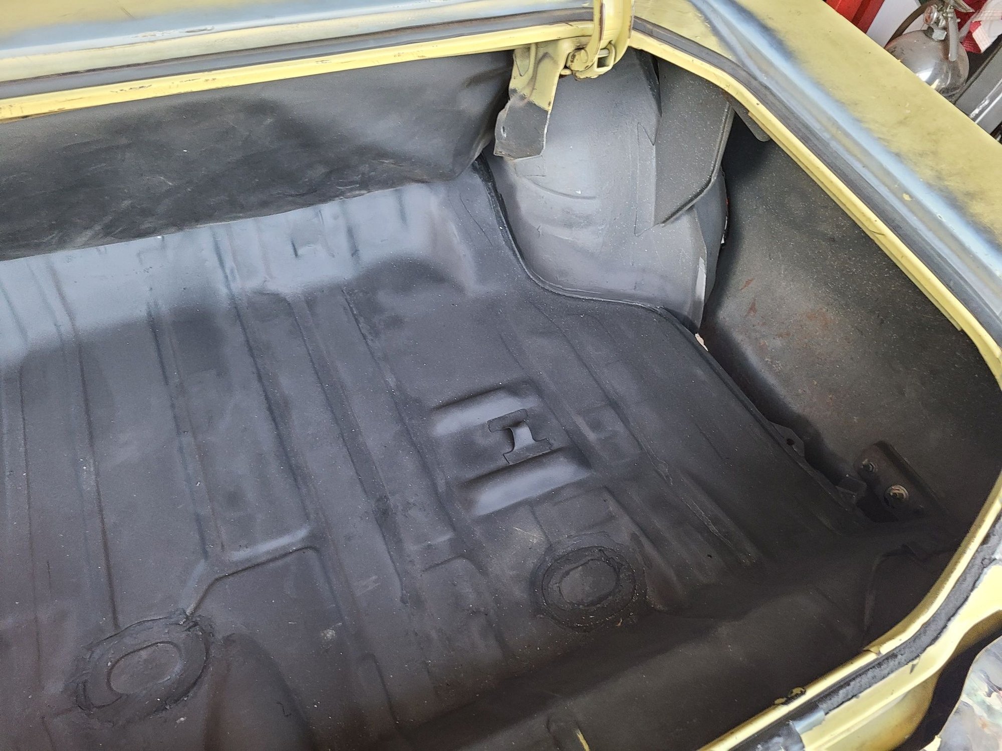

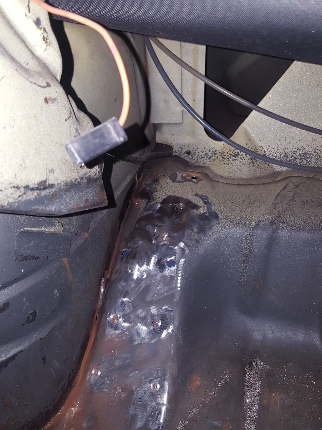

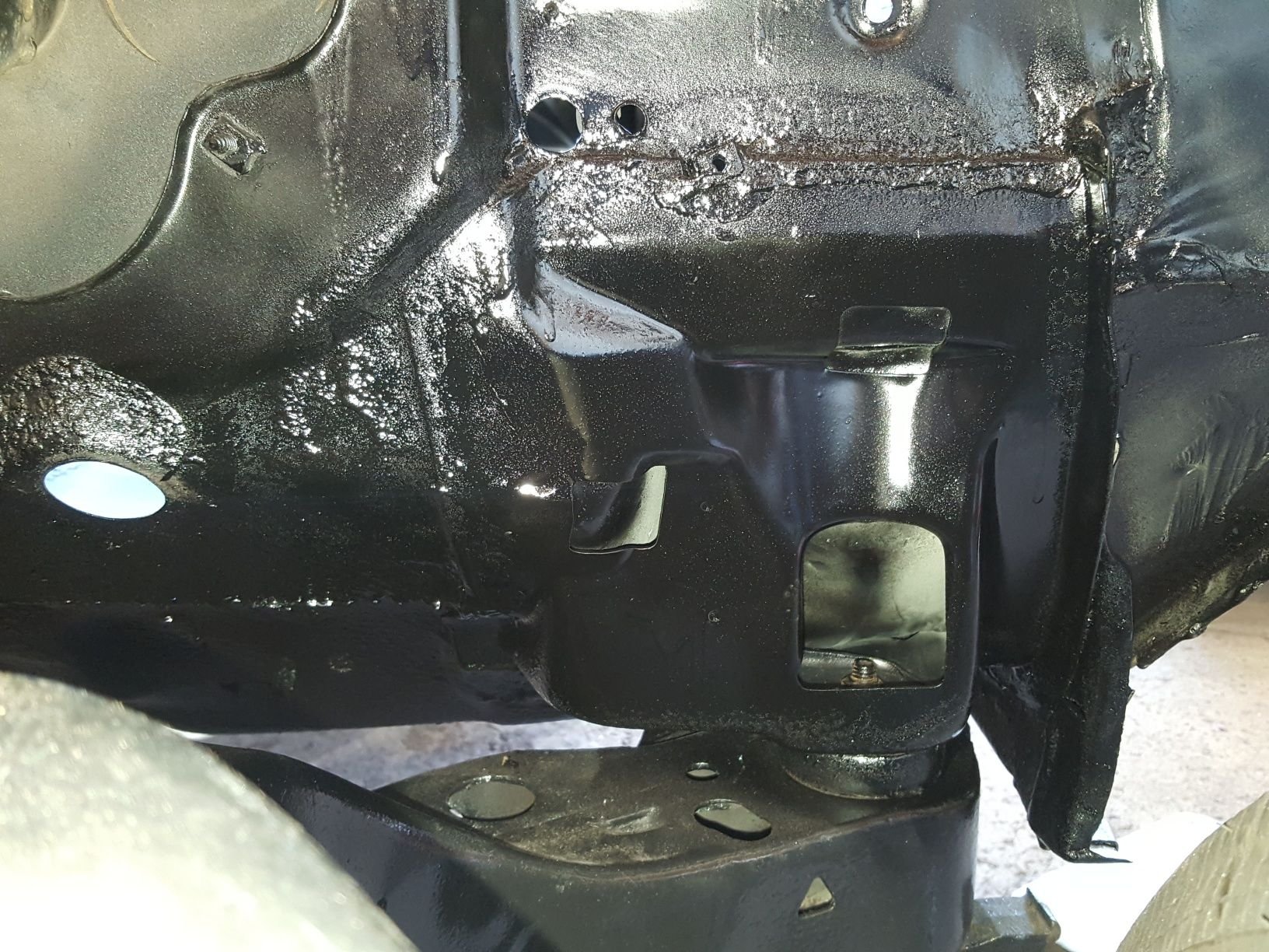

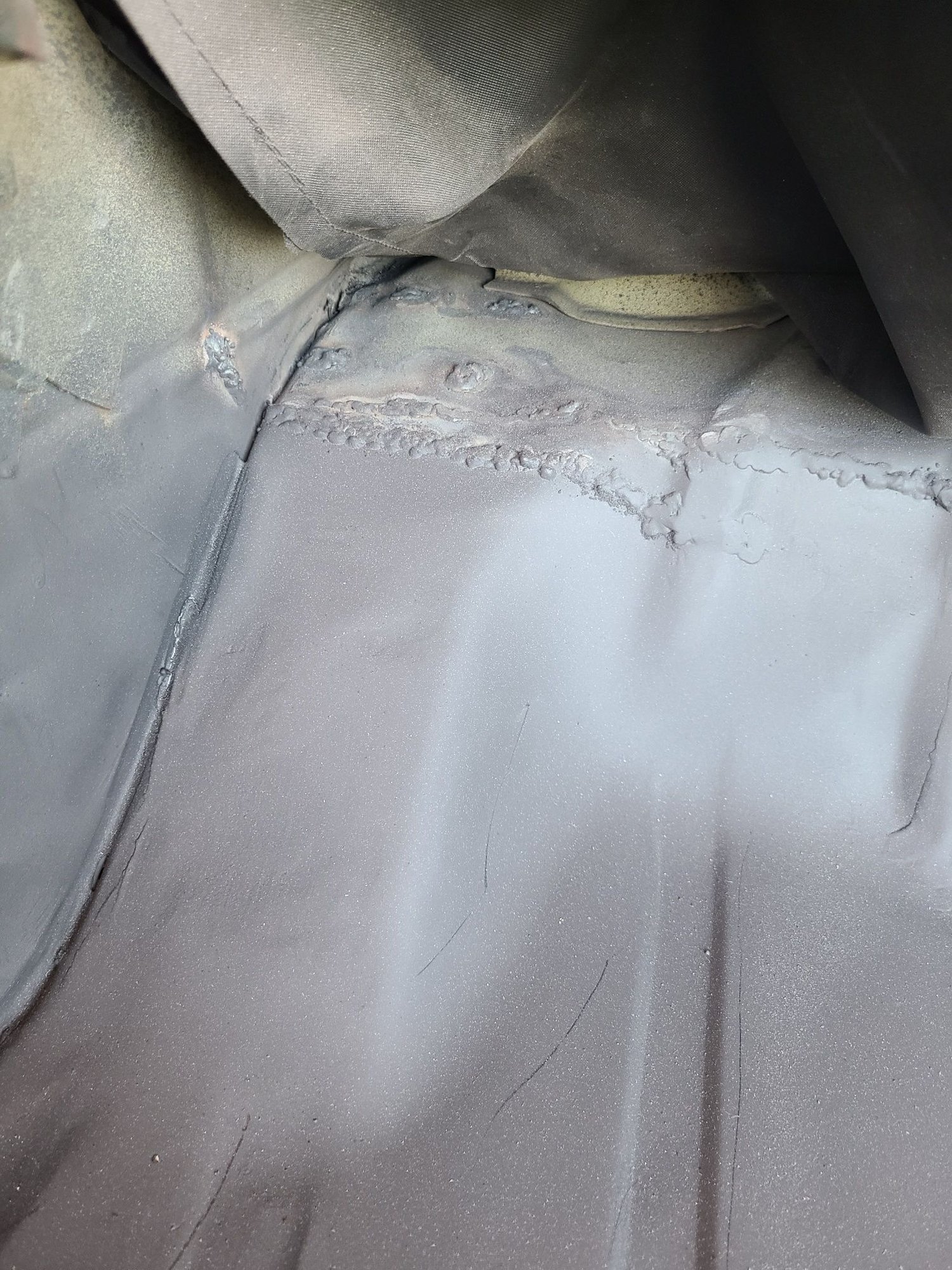

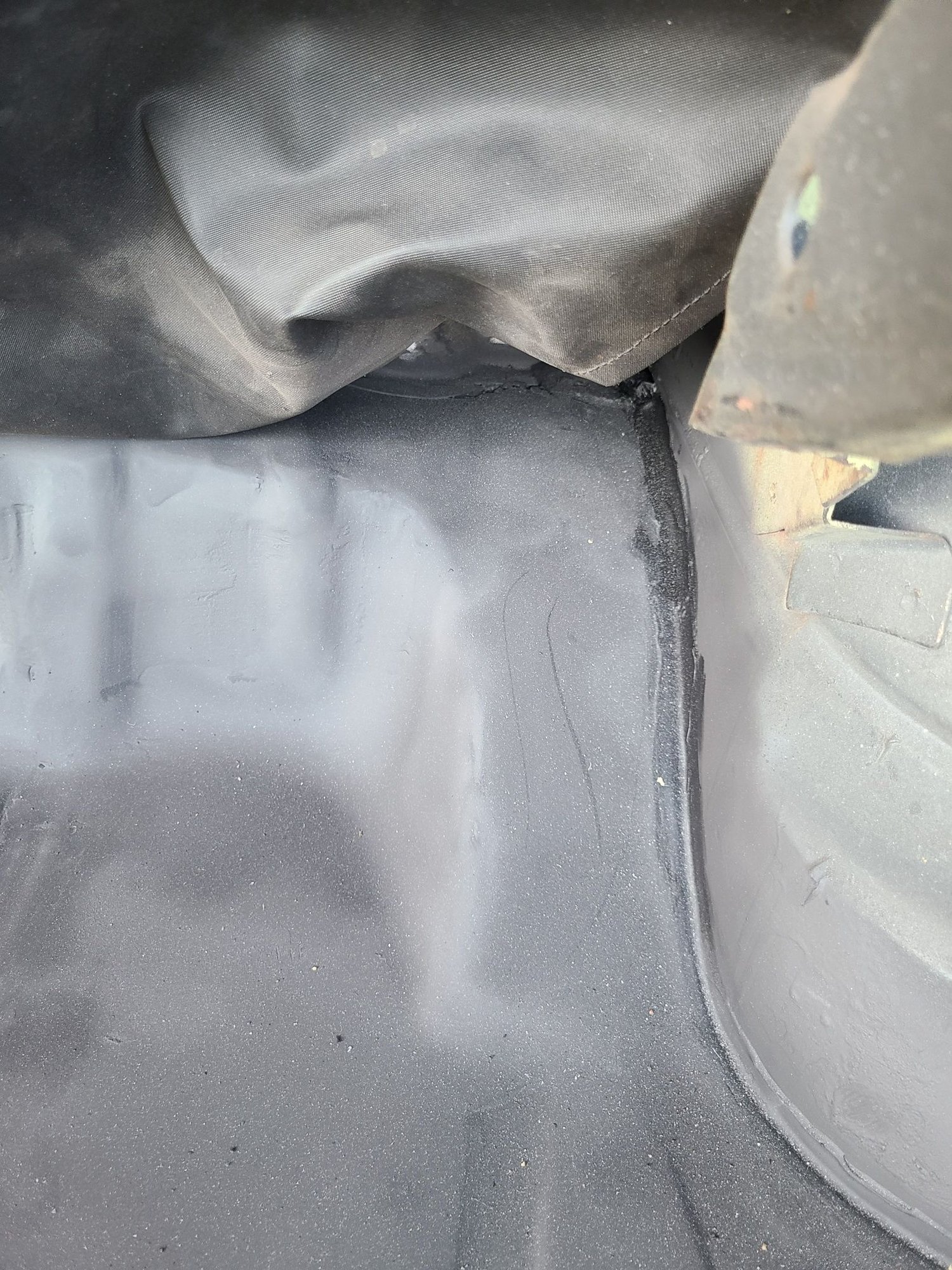

Here are some pictures of the after.
Ground down the welds and did a skim coat of All Metal .
I sanded it all down and used some rattle can Primer in the Trunk
the under side I painted and then sprayed a coat of Rubber Undercoating
still need to grind down these welds
Driver side, New Trunk Braces installed
Passenger side, Need some touch ups on the Frame
I Seamed the panels on the Gas Tank Braces

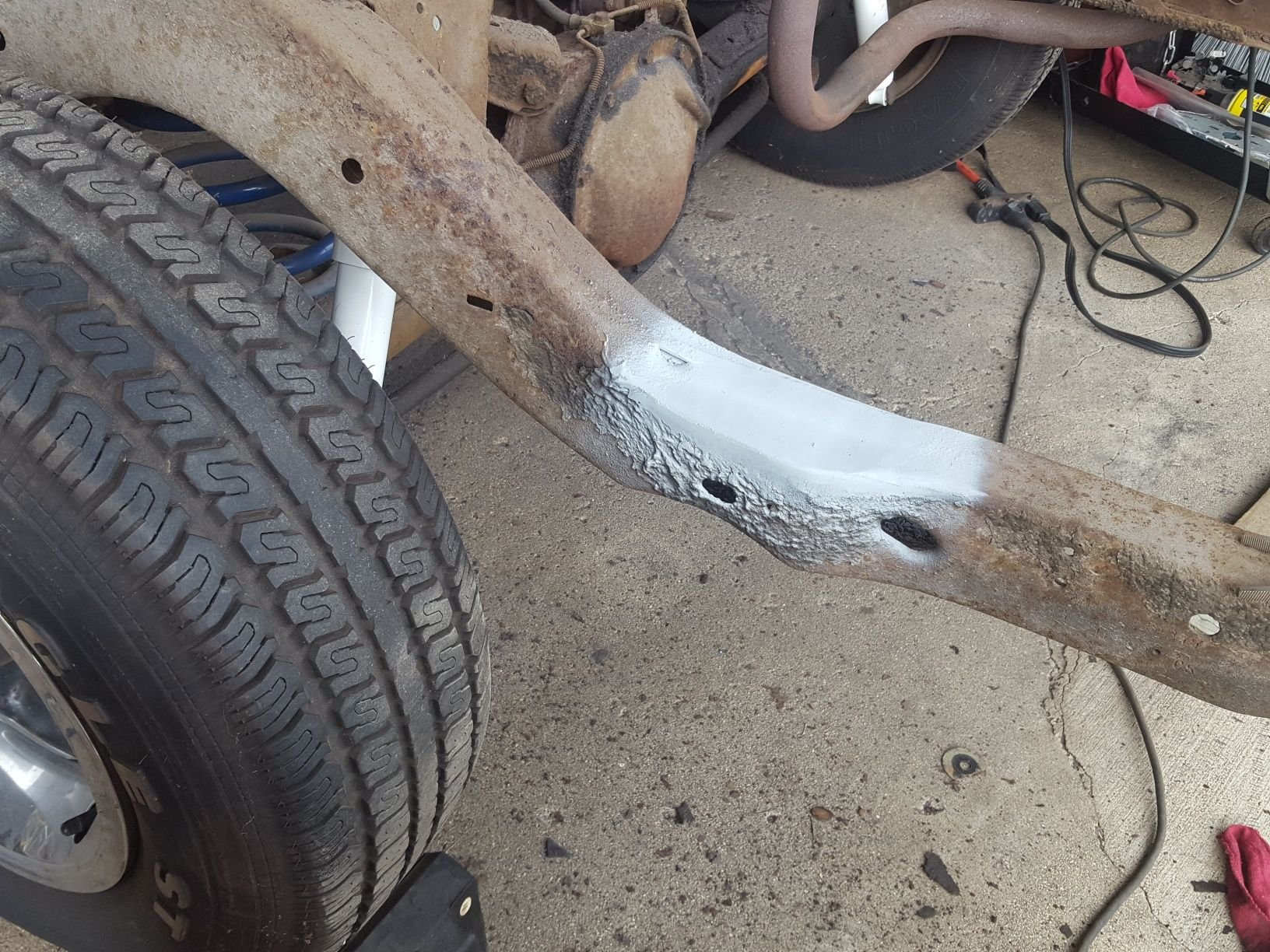

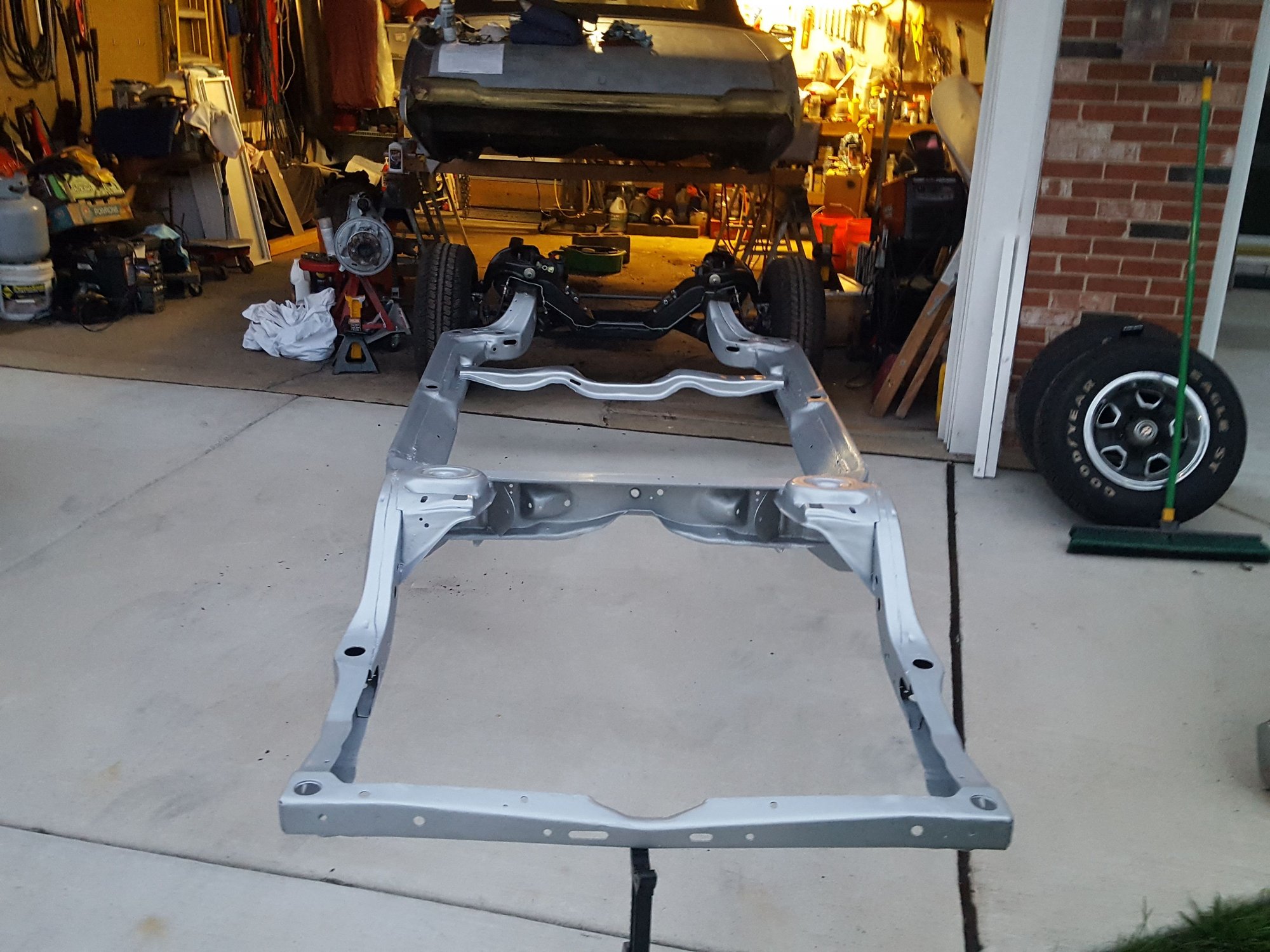

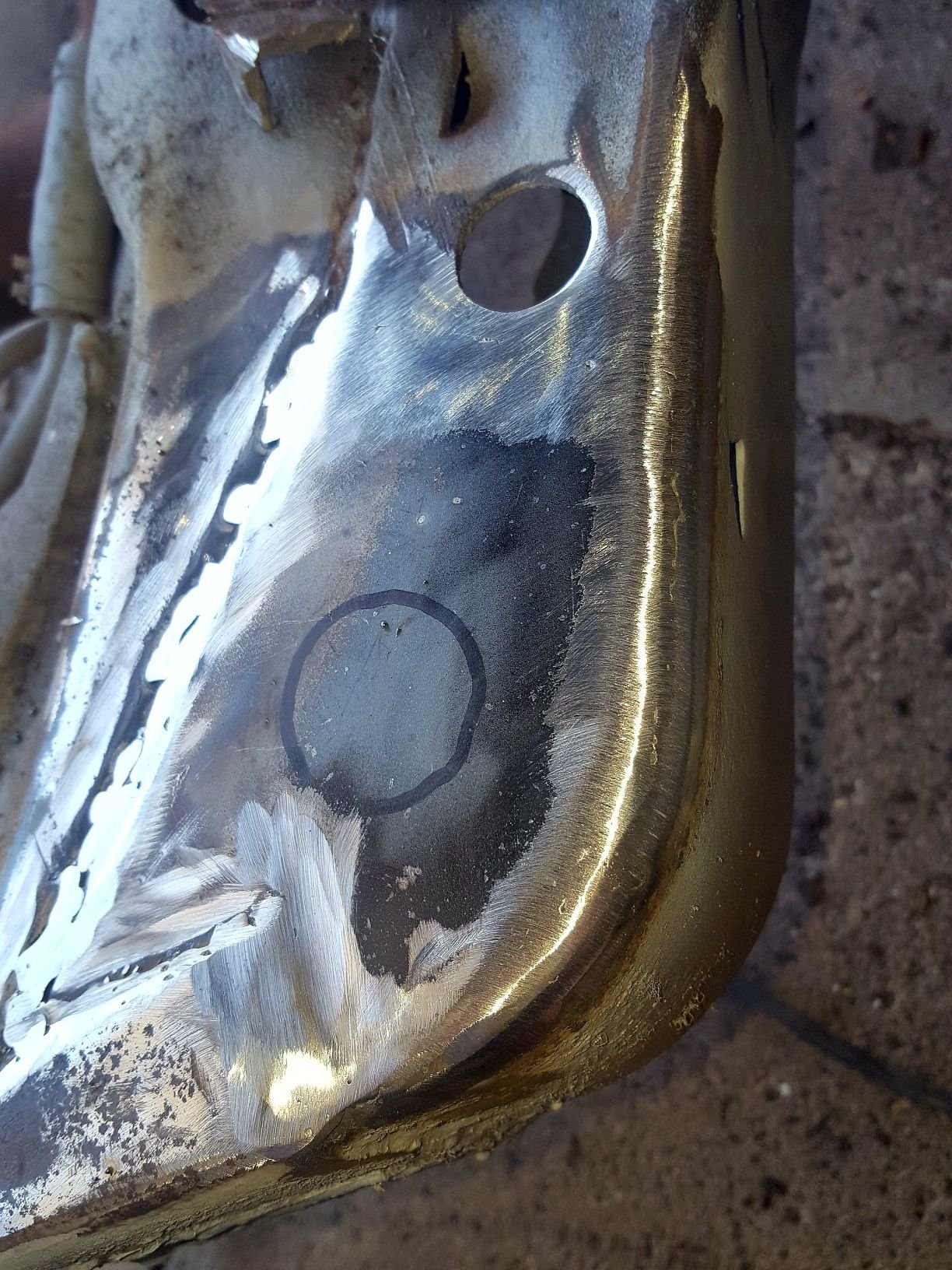

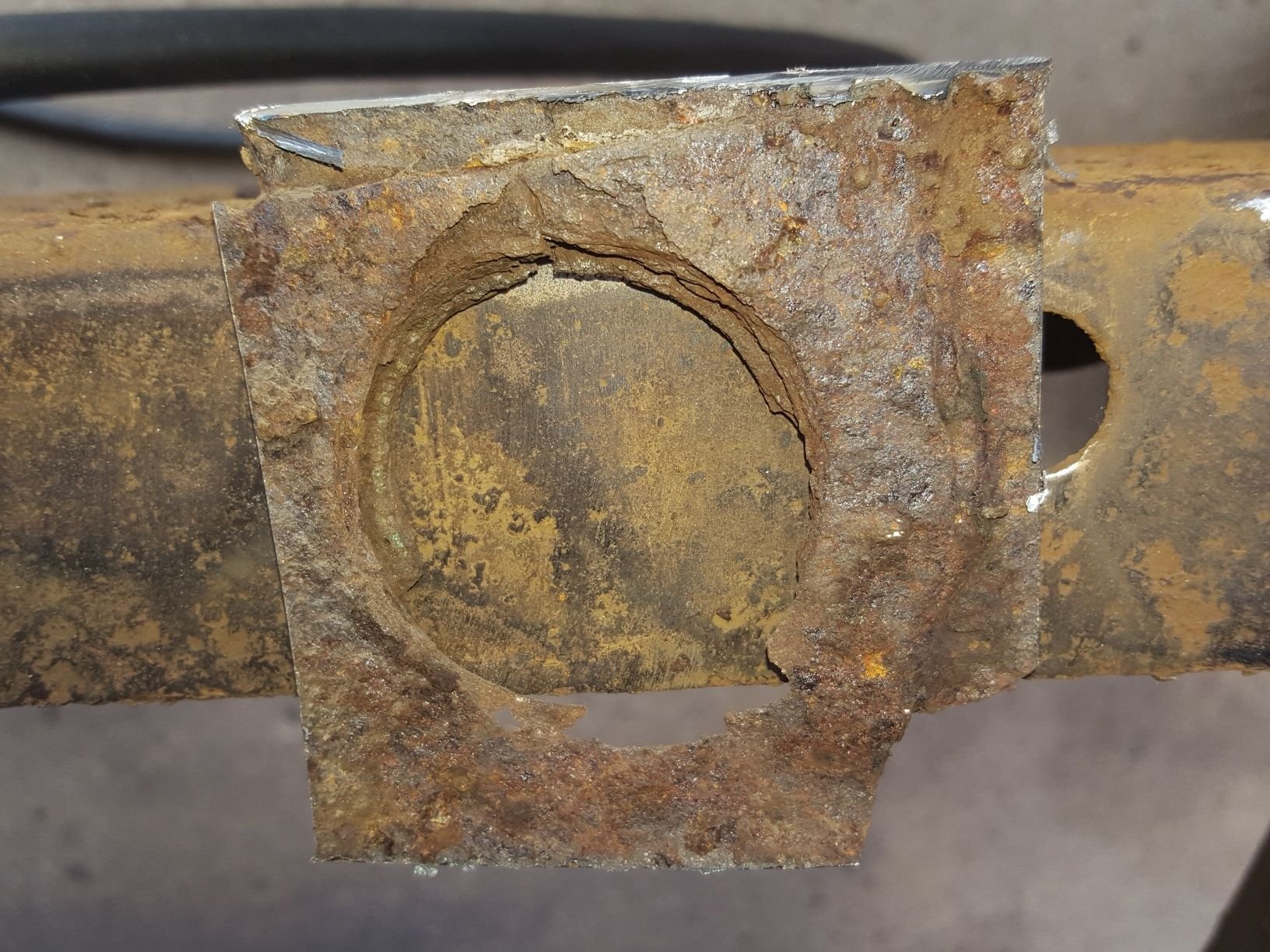

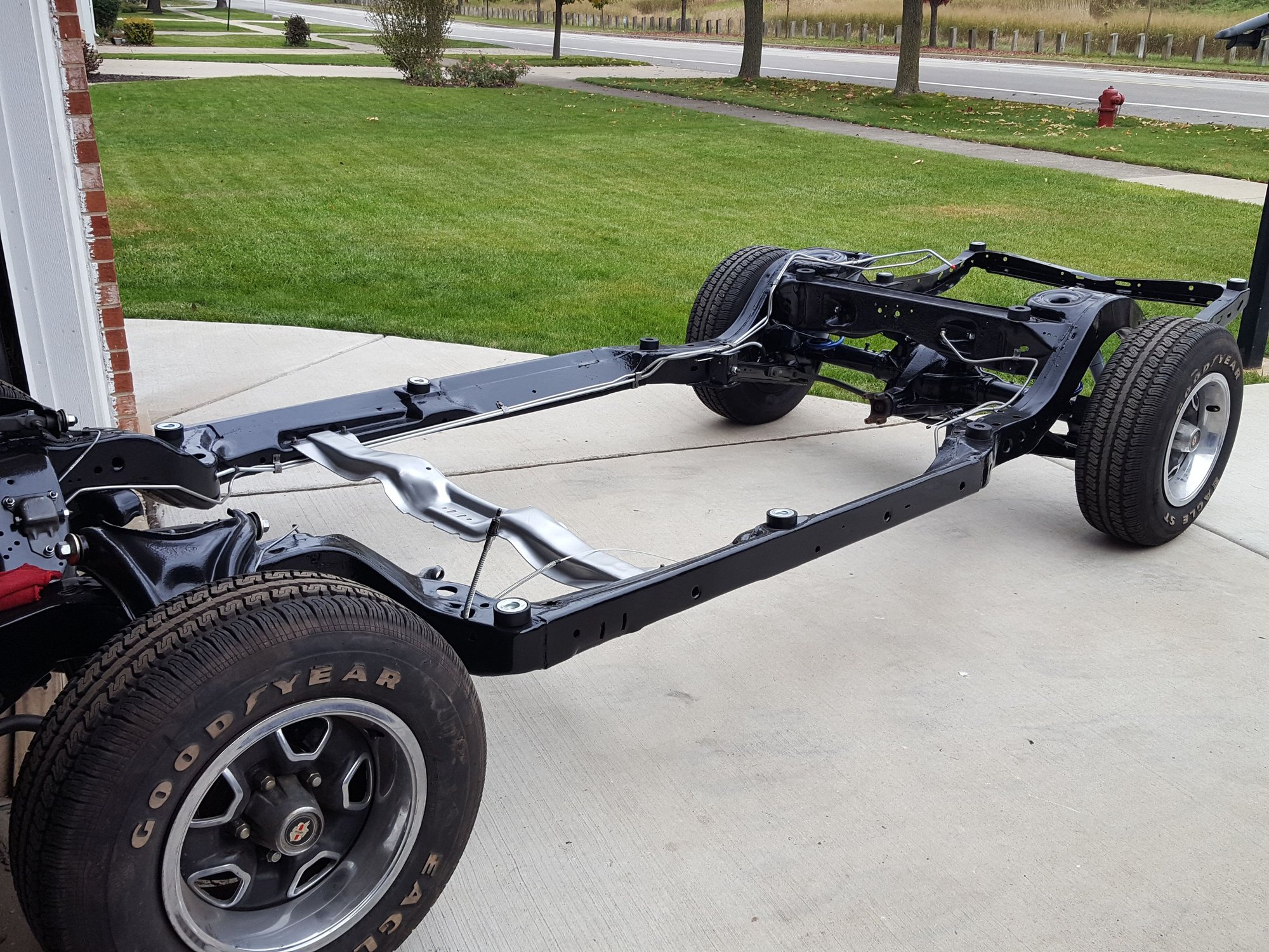

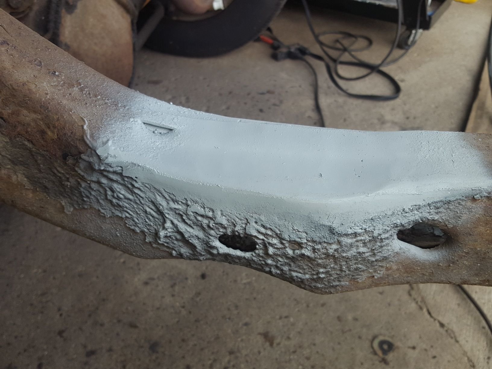

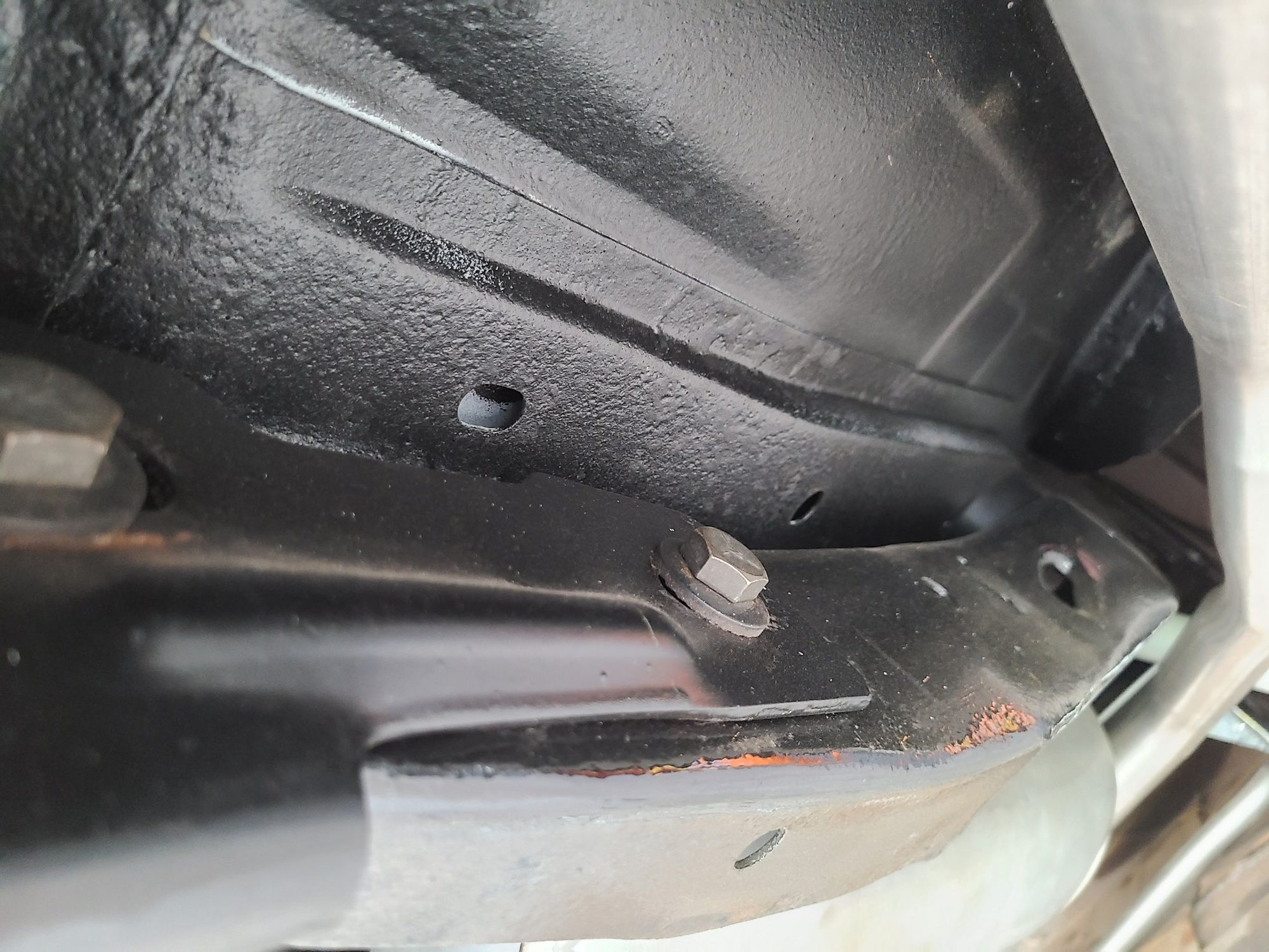

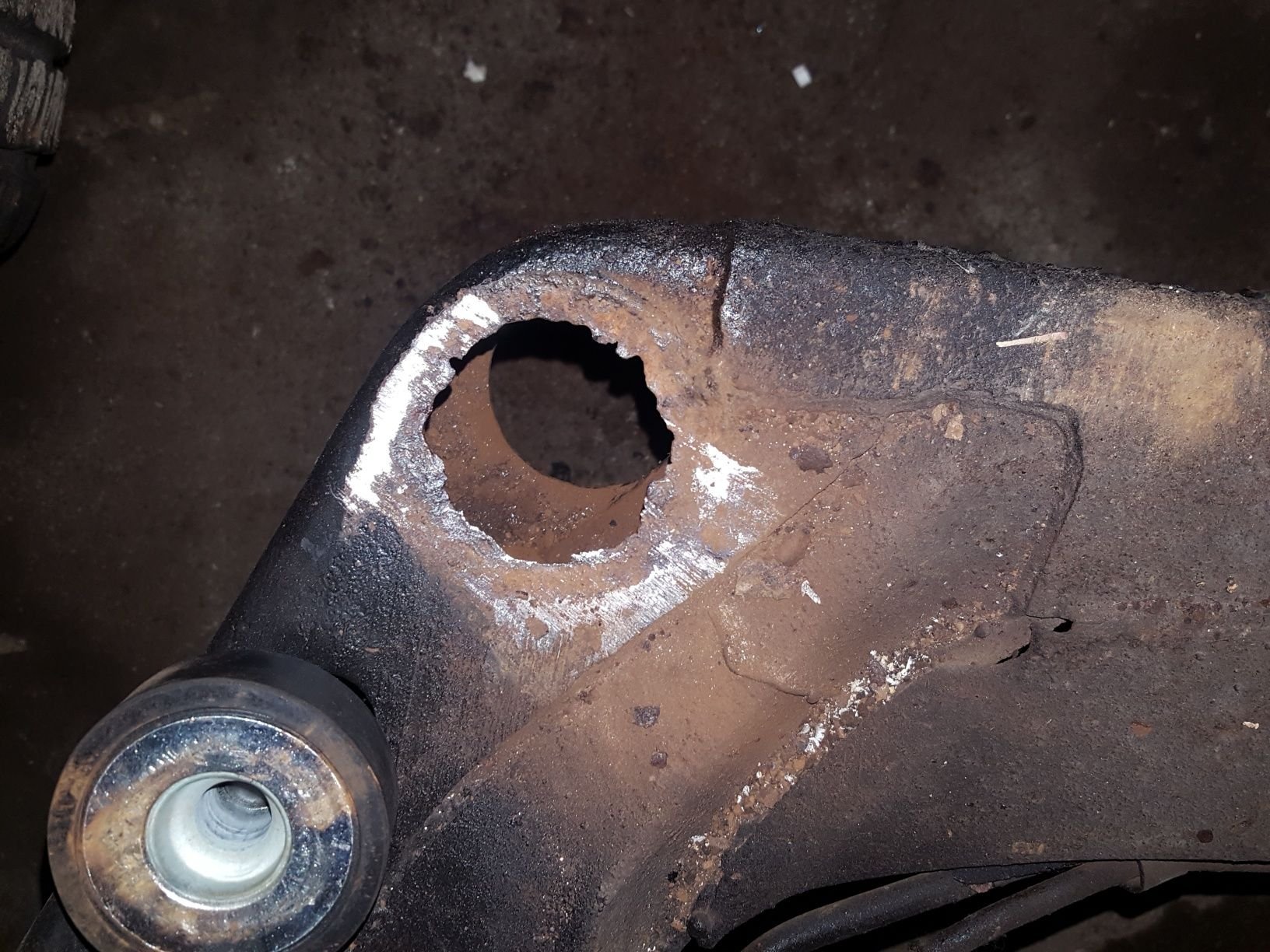

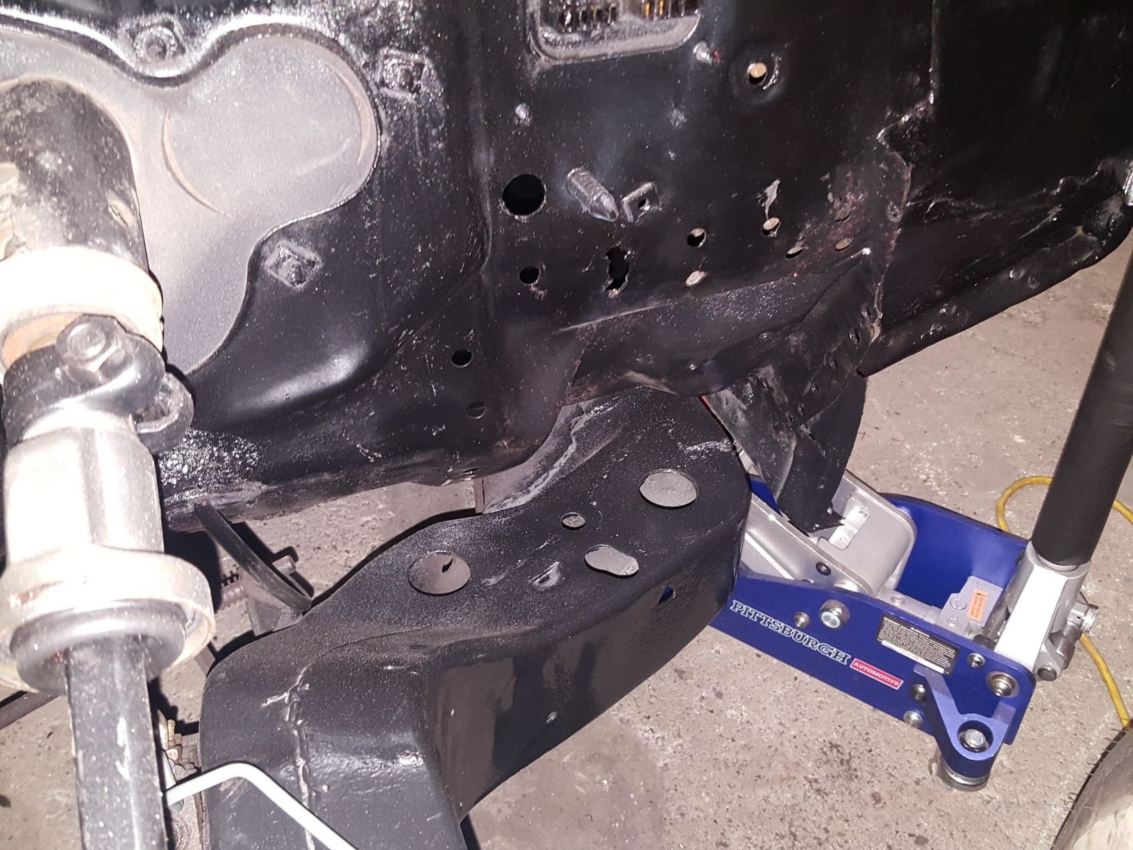

Frame Repair
I repaired 7 of the 12 bushing mount holes and then used a Frame diagram to measure and re-drill all of the holes

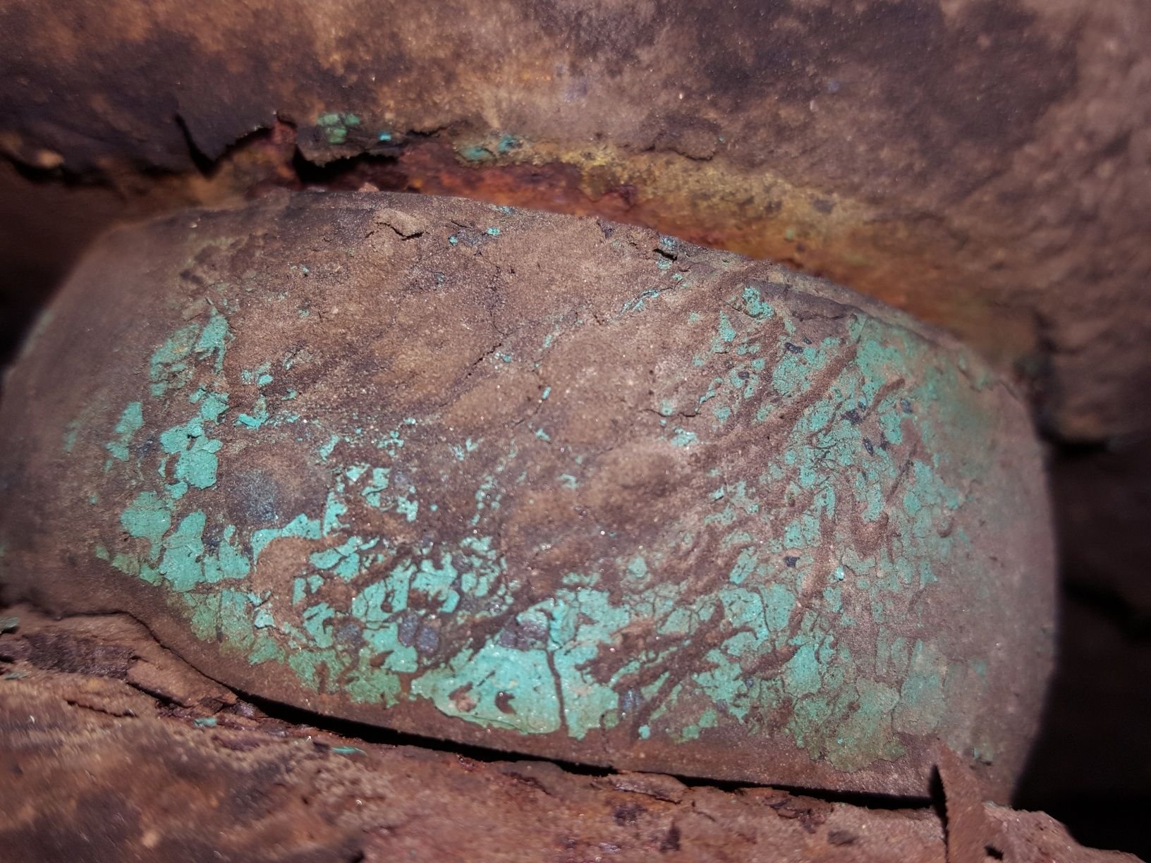

Crusty Bushings and frame
Drivers rear position #6 bushing, I ended having to replace the Body Cage Nut in this location also
Passenger side Position #1
Passenger side Position #1 after repair
Cut out rusted sections
Welded in new metal
ground down welds and primed
Drivers side position #5
Sanded down entire frame and painted with Chassis saver, first coat silver then a second coat of Black and a final coat of Eastwood Chassis Black while the Chassis saver was still tacky.
finished product

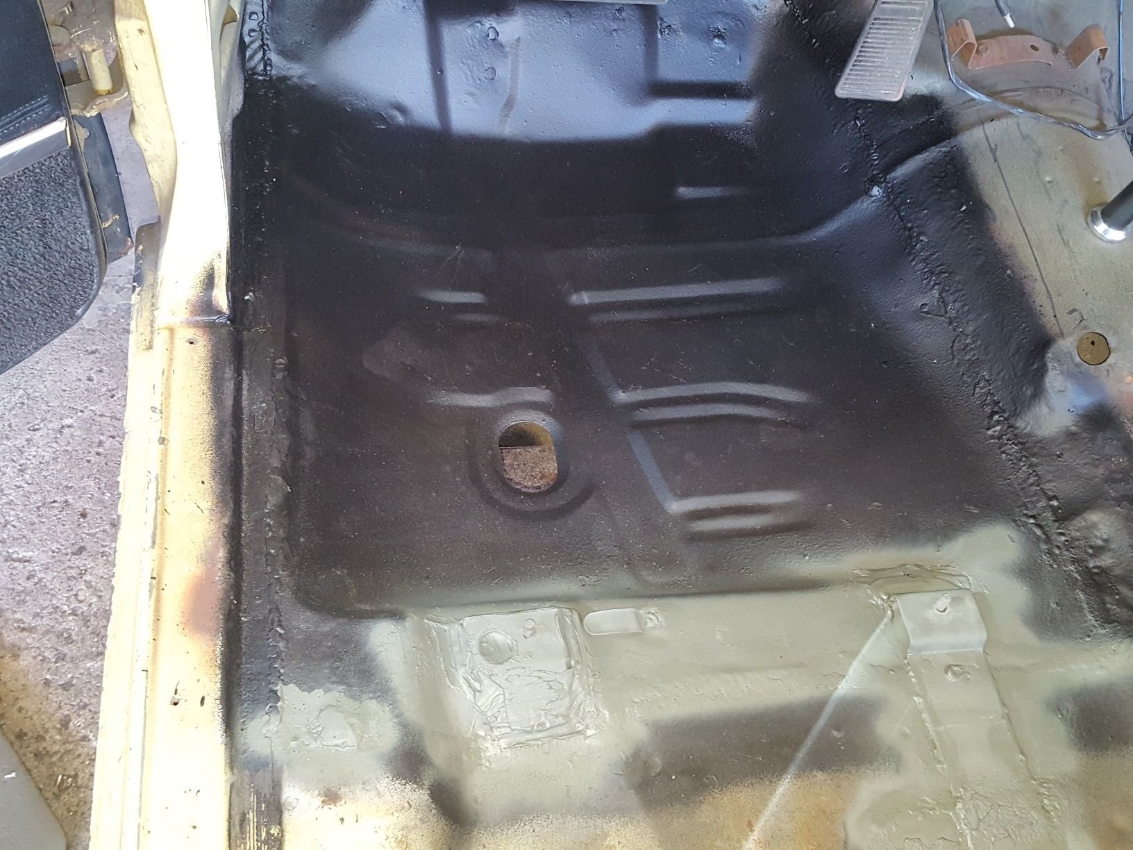

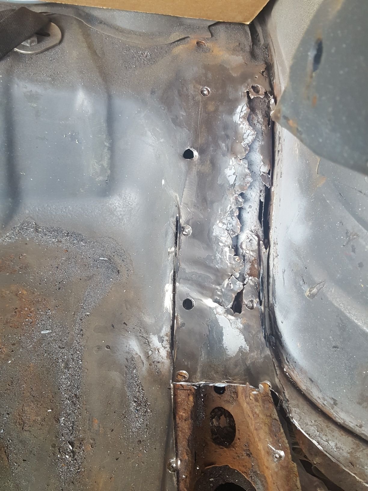

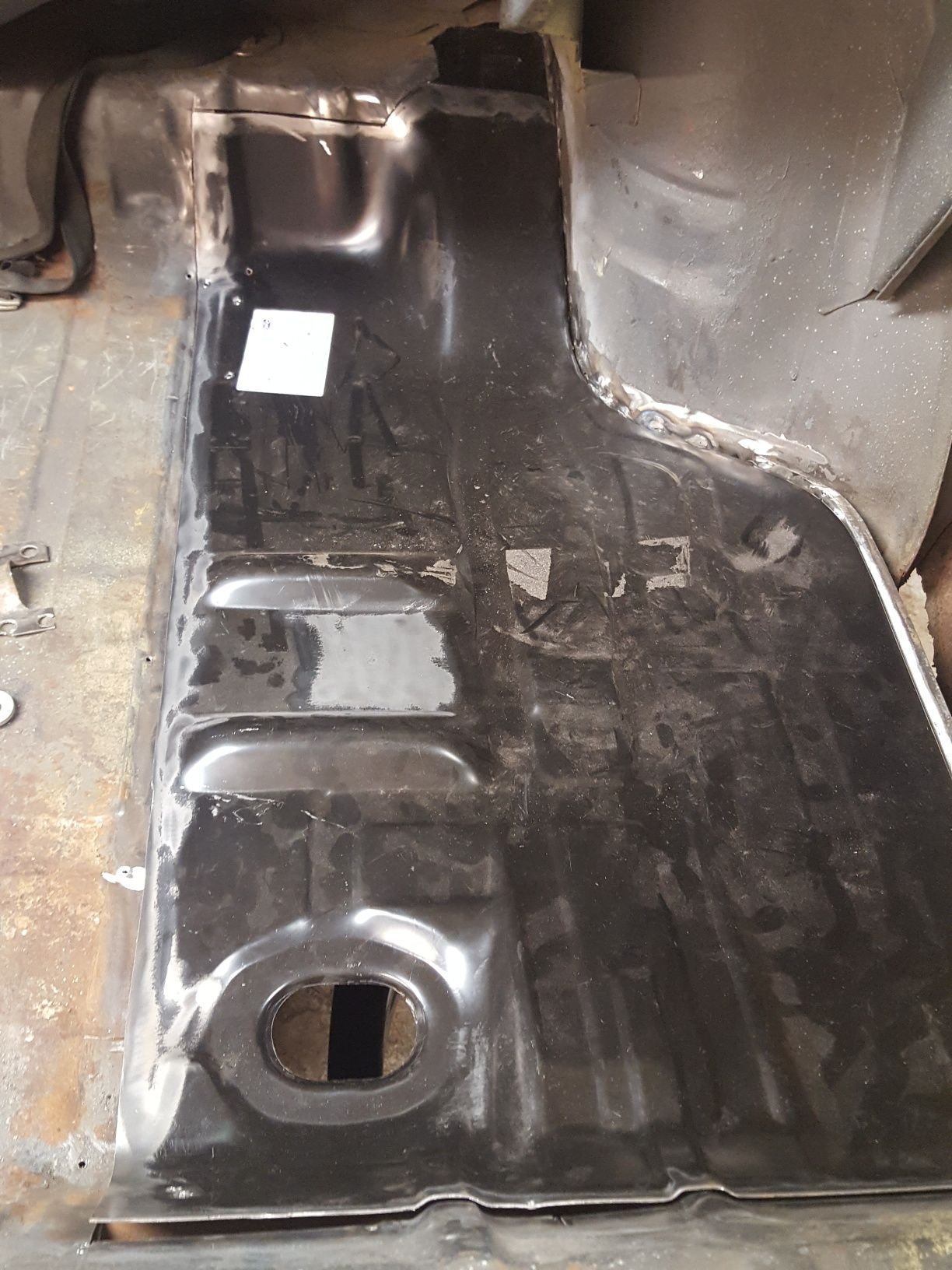

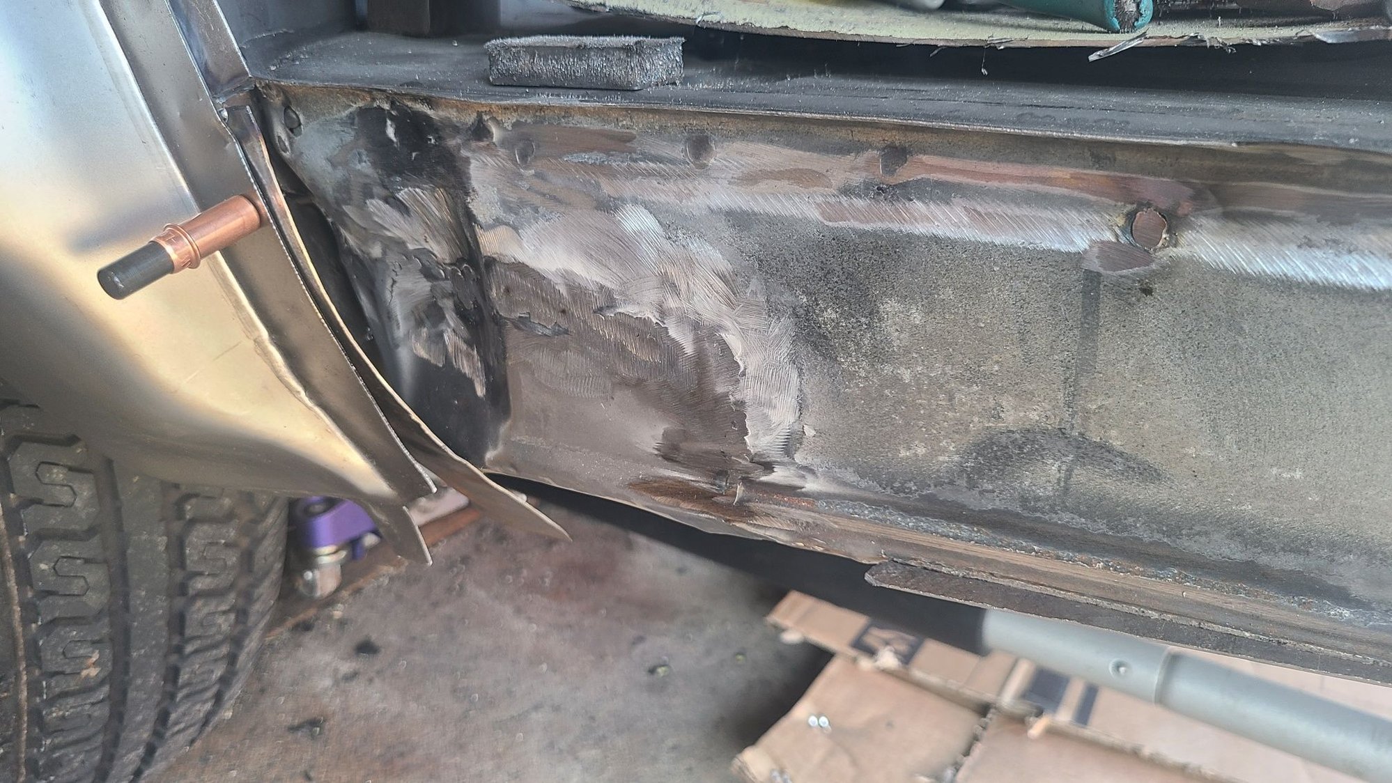

Drivers Floor repair.
cut out old floor section just past seat bolt brackets
I sealed the pan top and bottom with a rubberized sealer and eventually did the entire floor and underside
welded in new Drivers side Torque Box
seam sealed in and primed and painted. reinstalled original Body Bushing. the floor was patched while the Body was on the frame. I repaired the frame in this location while I was doing the floor repair. I ordered new bushings and this is where the MAW'S for the frame repair started.

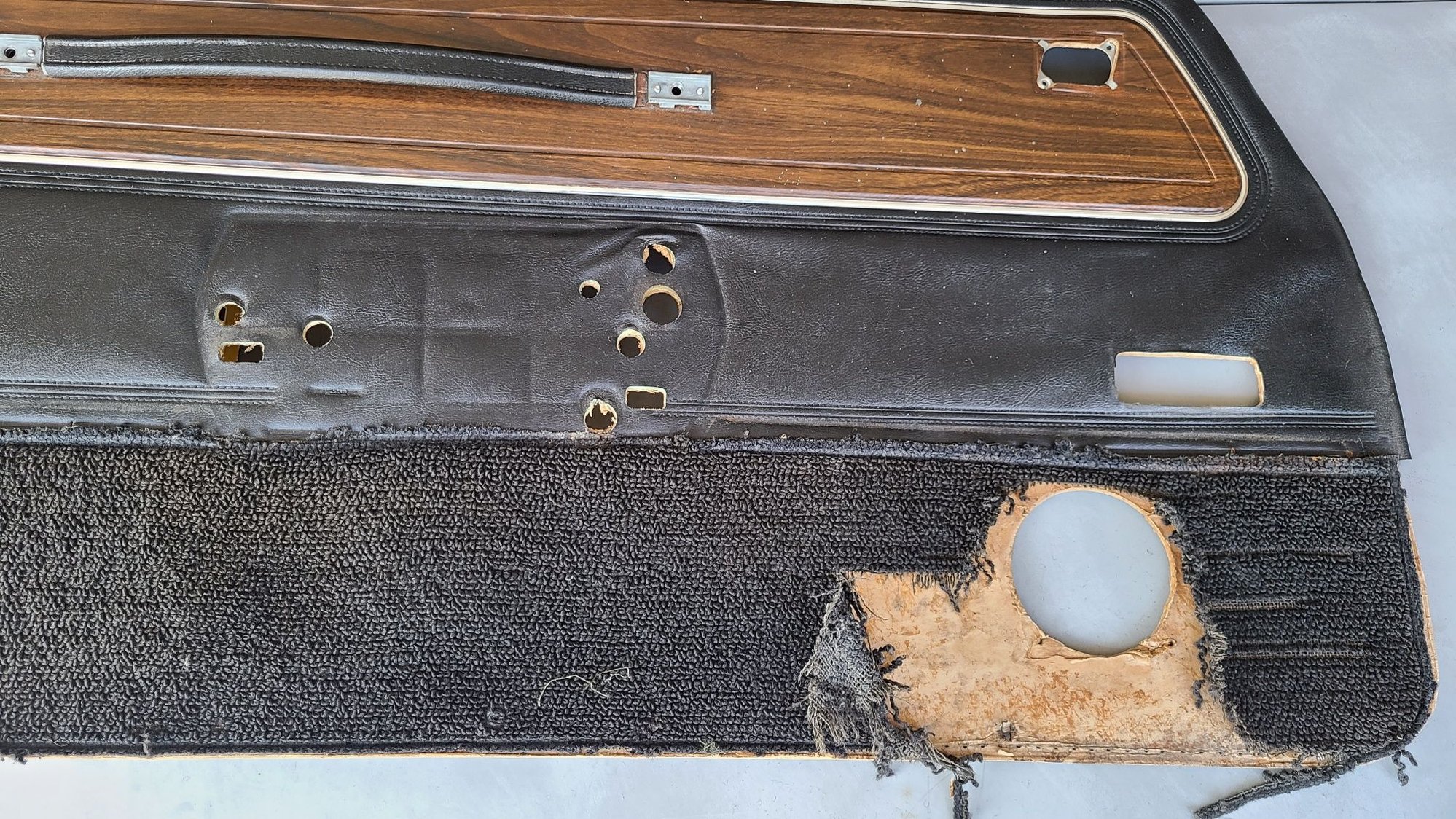

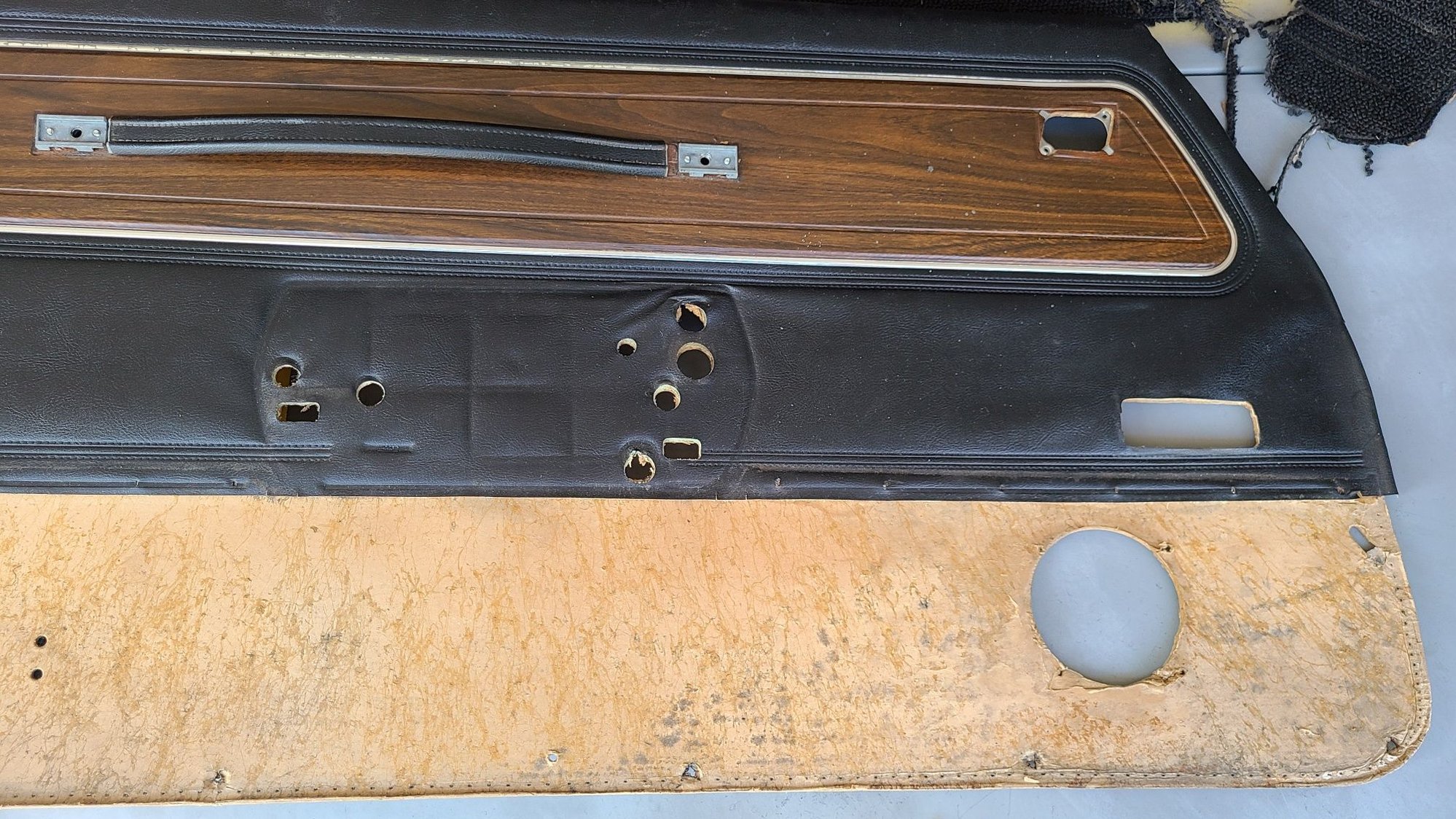

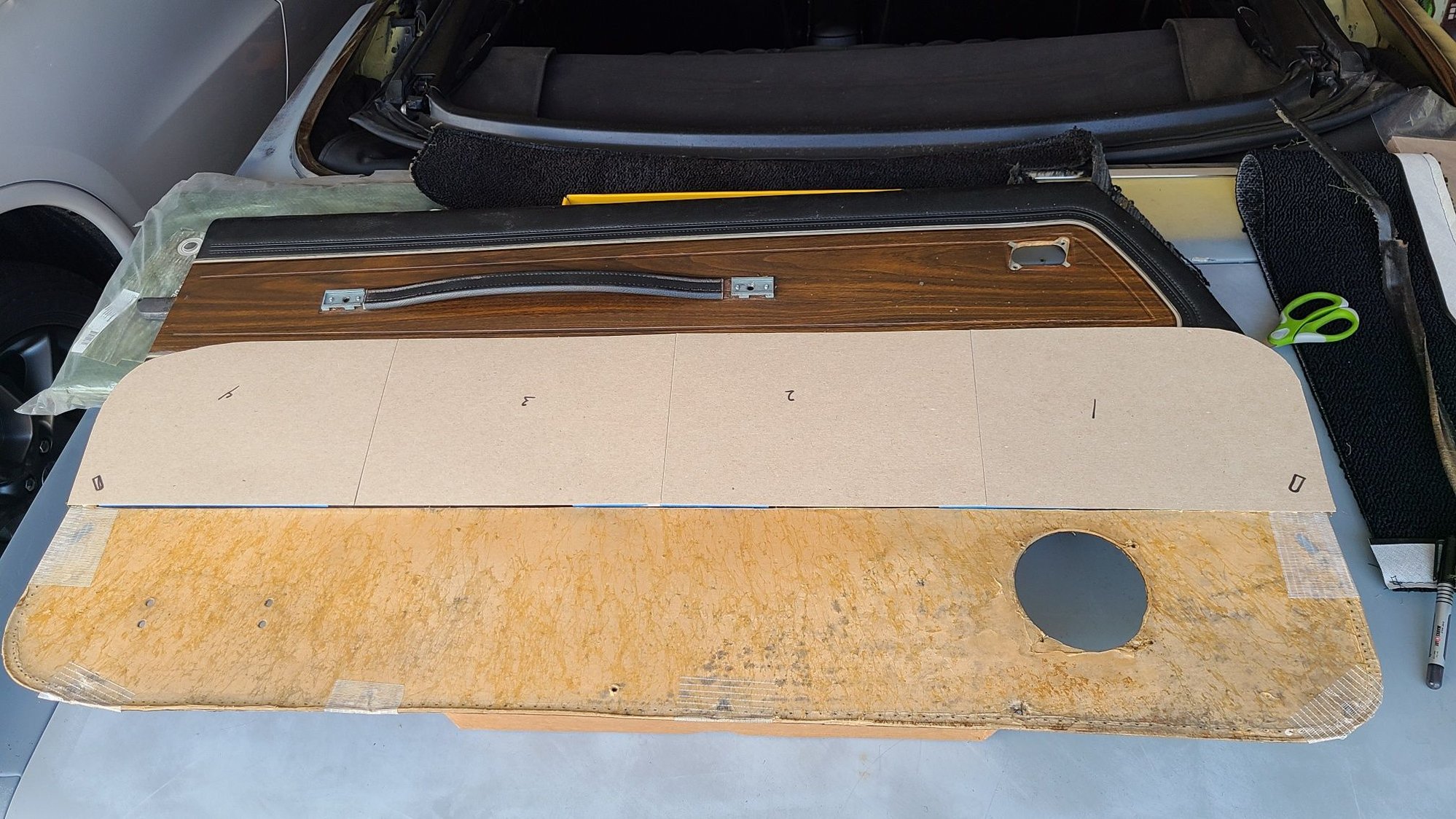

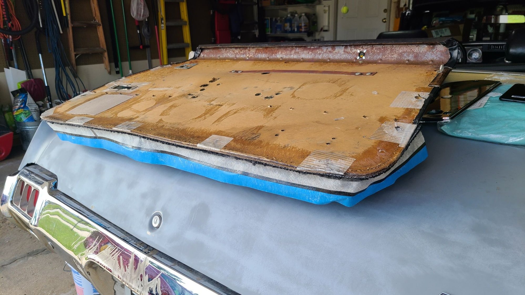

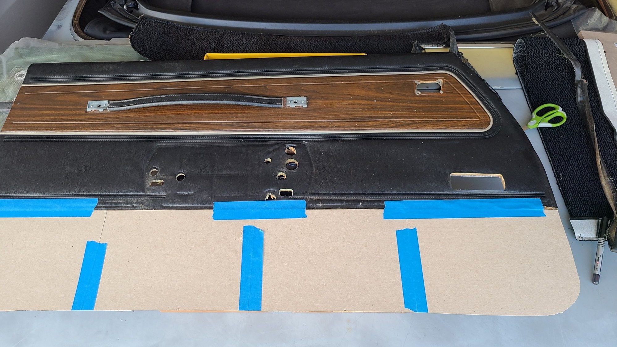

Door panel carpet replacement
Here are some pictures of my current Door Panel project

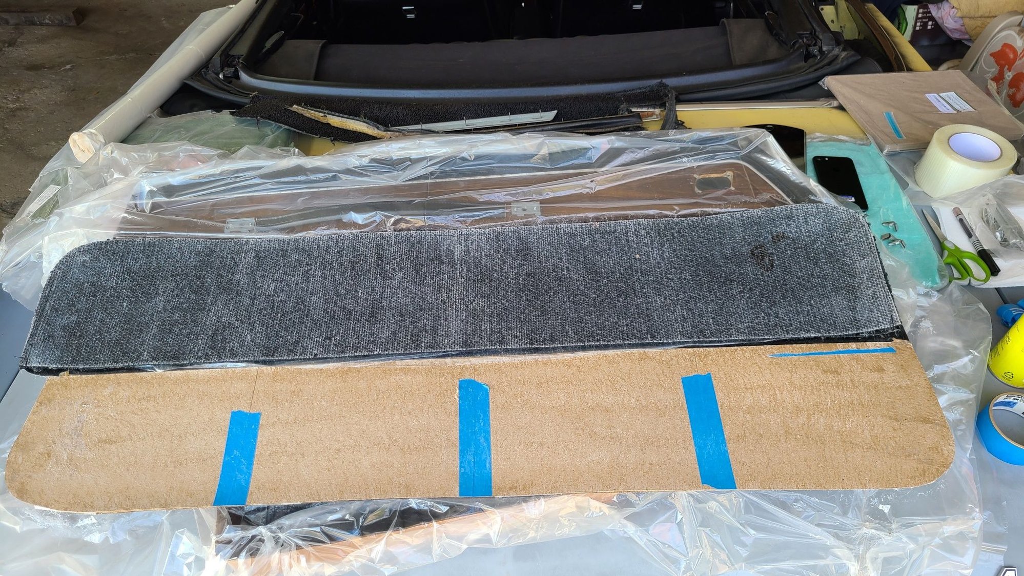

I used the 8" replacement door panel carpet from ACC.
Original door panel carpet and old speaker hole
I removed the carpet and used some card stock to re-enforce the original substrate
I used spray adhesive to glue the card stock to the original panel
I filled the speaker hole with card stock cut to fit and stacked to the correct thickness. Glued the carpet to the card stock.
I used mesh packing tape to re-enforce all of the Door Panel Trim clip slots and screw holes
Panel rehung
Turned out nice
Just need to screw the bottom of the panel to the door and do the Passenger side
The only issue I have is the arm rest is slightly crooked.
Fun easy project and I get to keep the original panels,

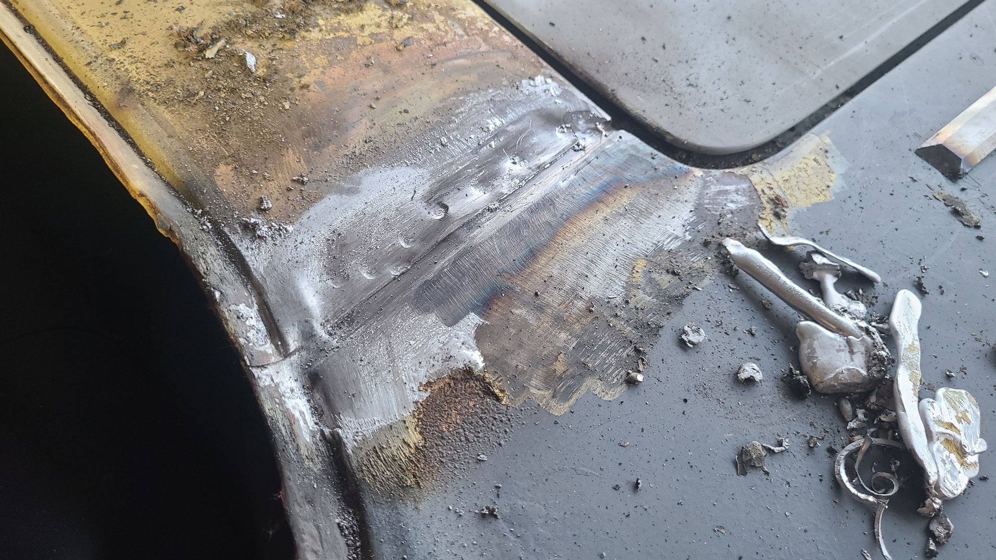

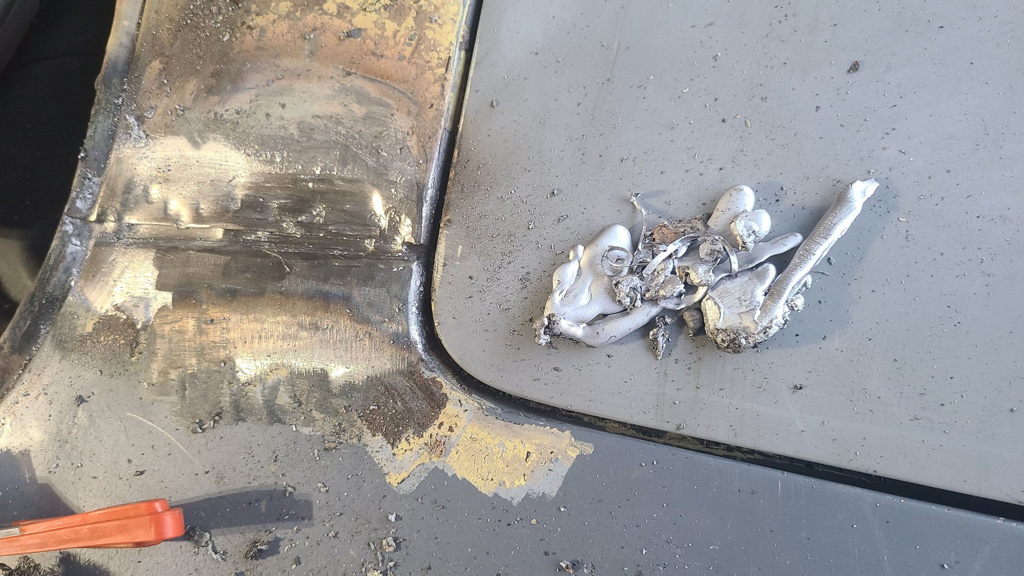

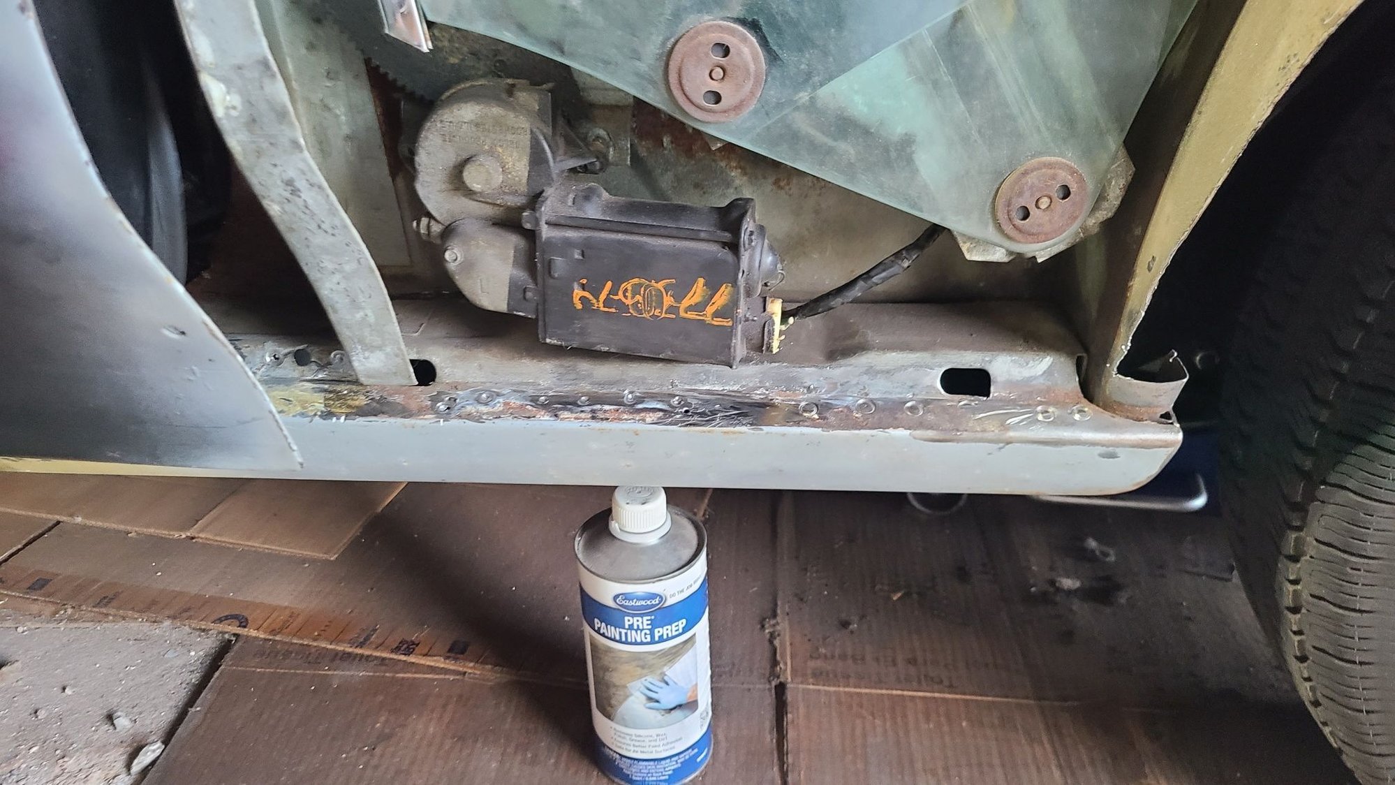

quarter panel lead removal

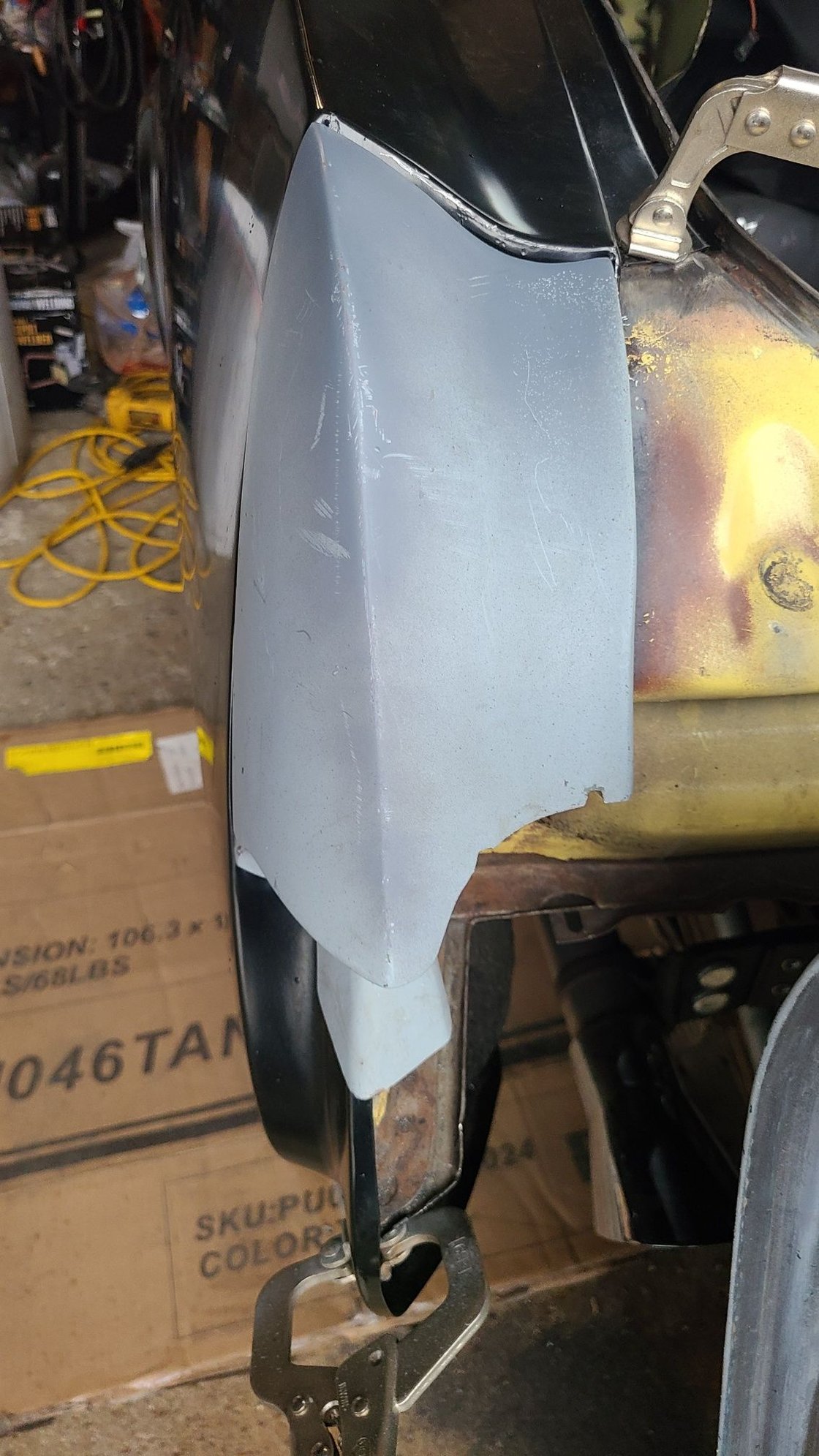

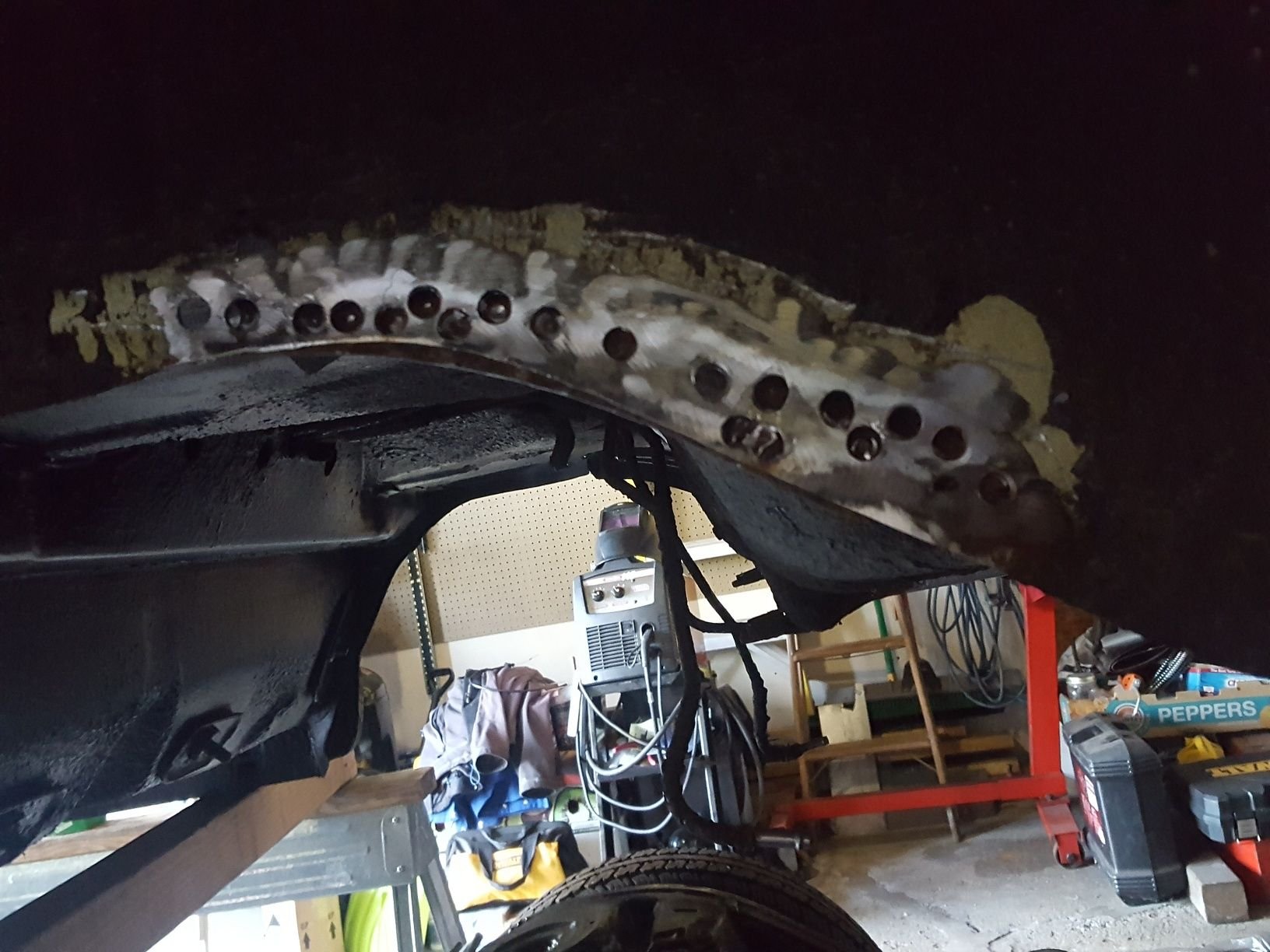

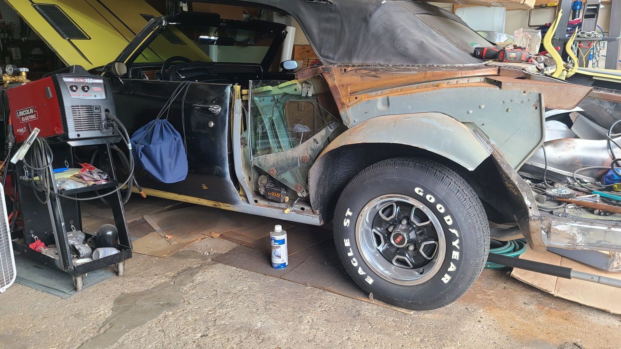

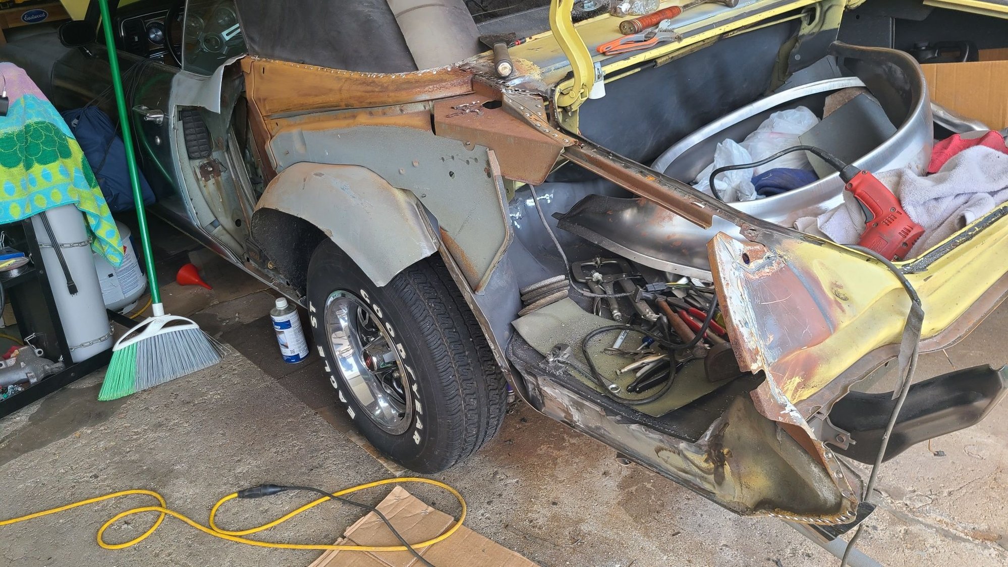

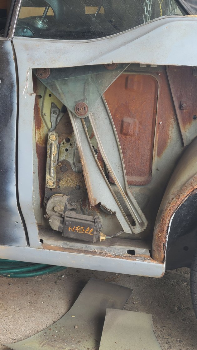

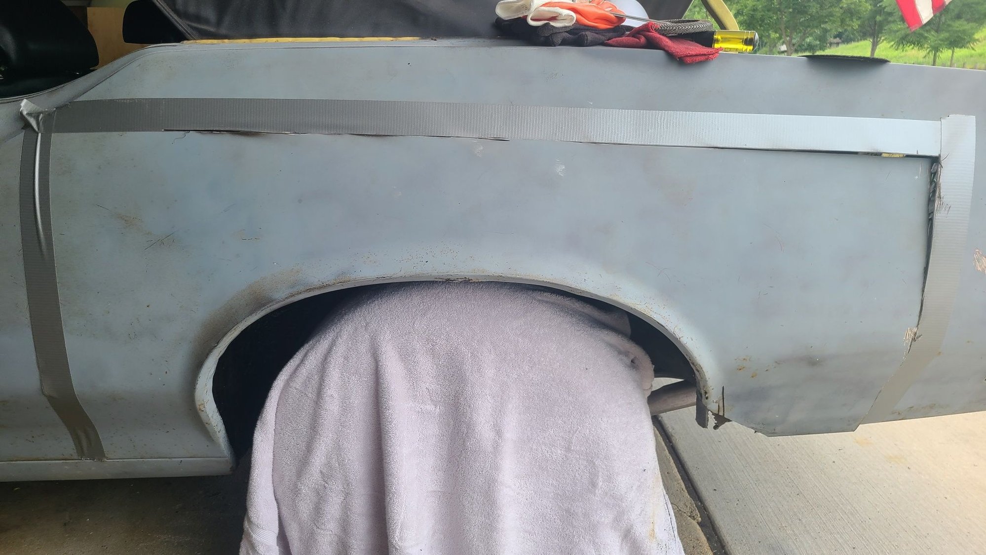

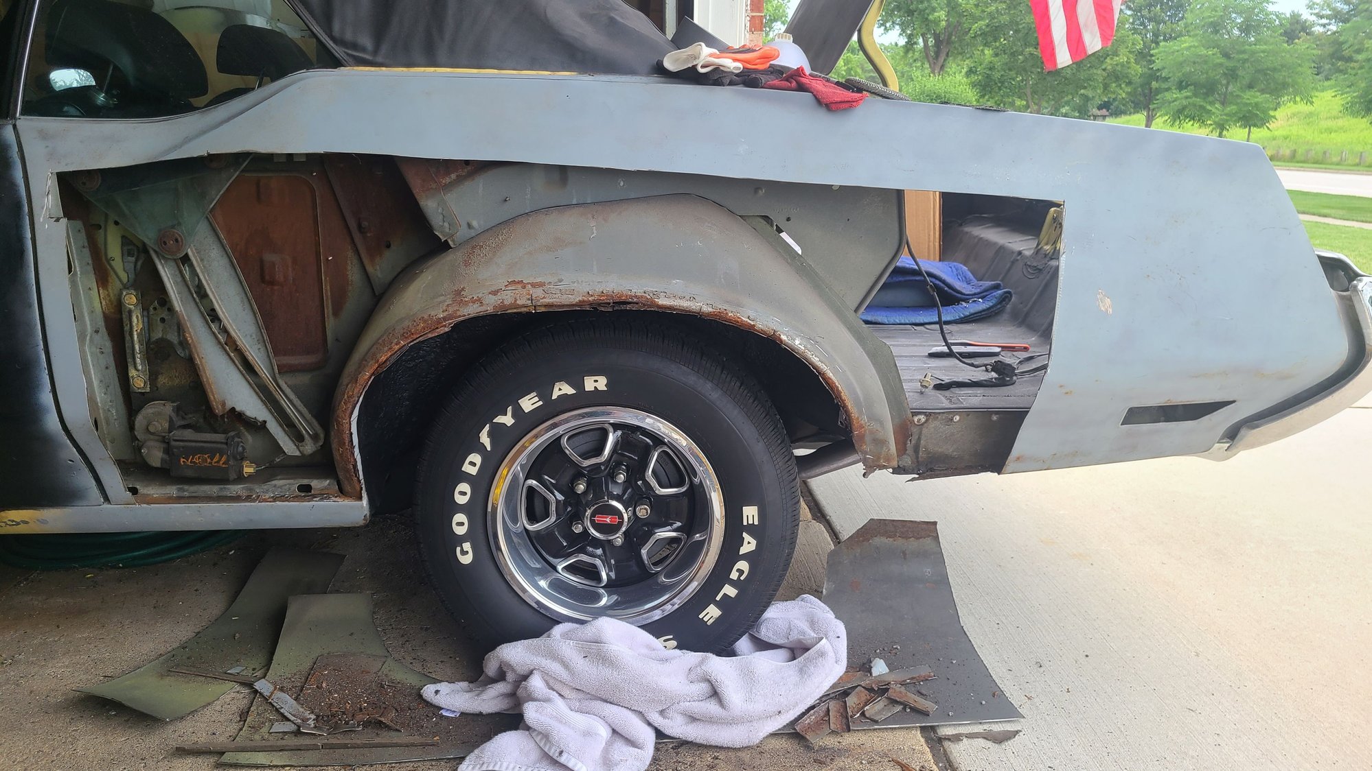

Quarter panel replacement begins
I am starting the process of replacing the quarter panels, I cut out a section to access the inner and outer wheel wells along with the trunk drop-off.
I have all the new panels and will cut and weld in what is needed to repair the rusted sections.
Old Jul 11, 2024 | 06:13 PM
Schne442's Avatar
No it's not a parts car!!
Joined: Nov 2010
Posts: 438
From: NE, Illinois
I think I need to remove the remainder of the quarter so I can fit the new one onto the outer wheel well before I cut the wheel well for final fit.
Has anyone done this repair and can give me some hints on what I should look out for, once something is cut it is cut forever

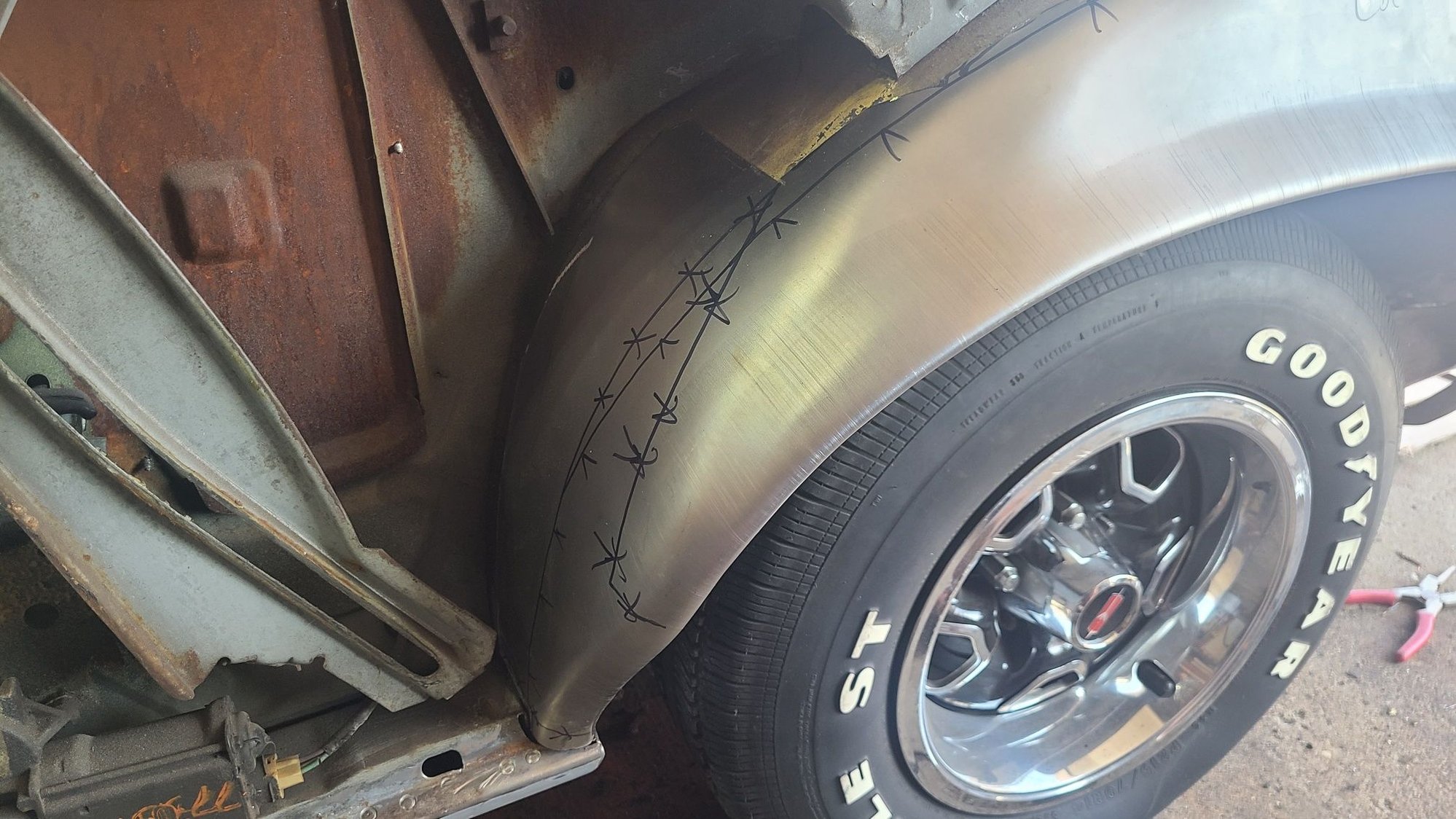

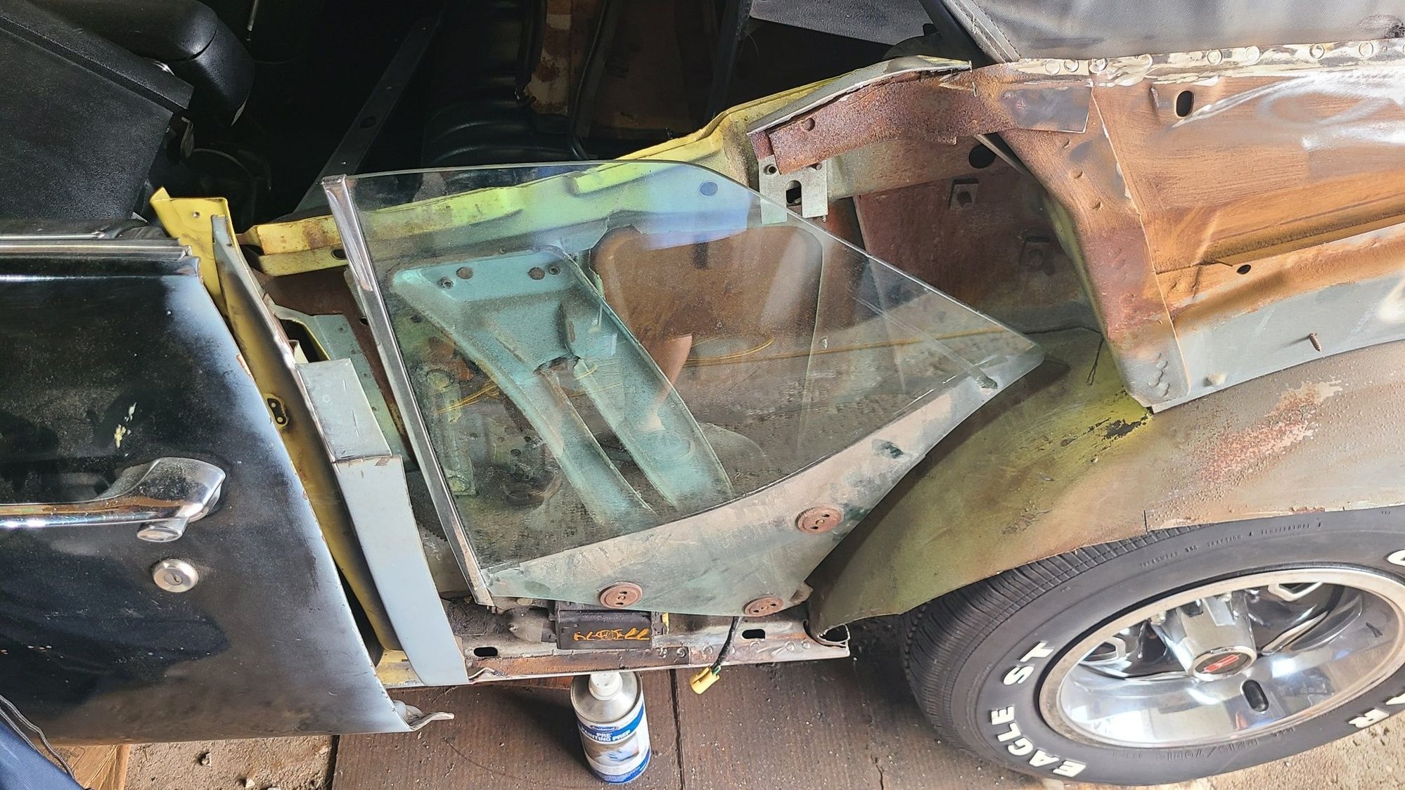

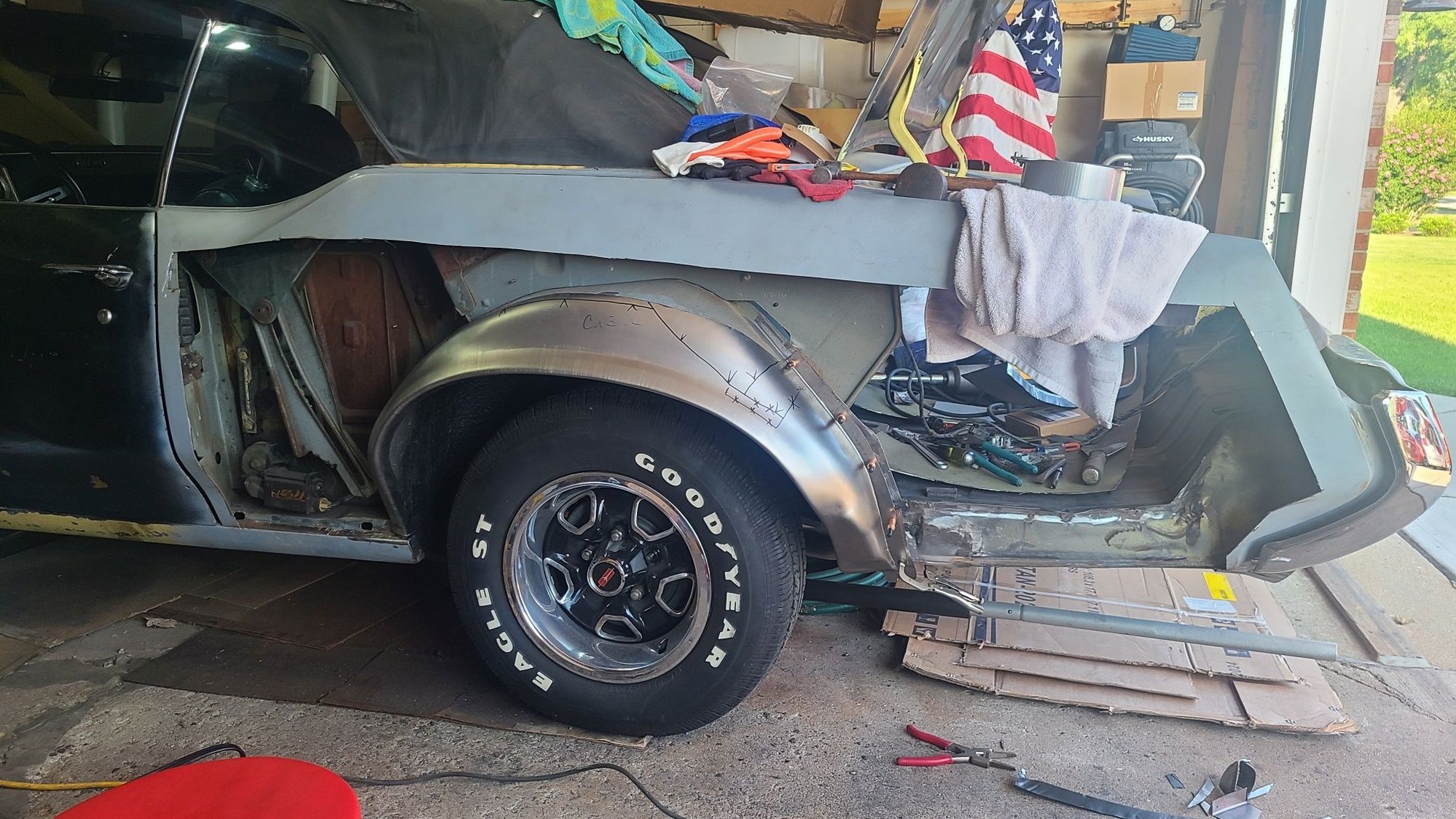

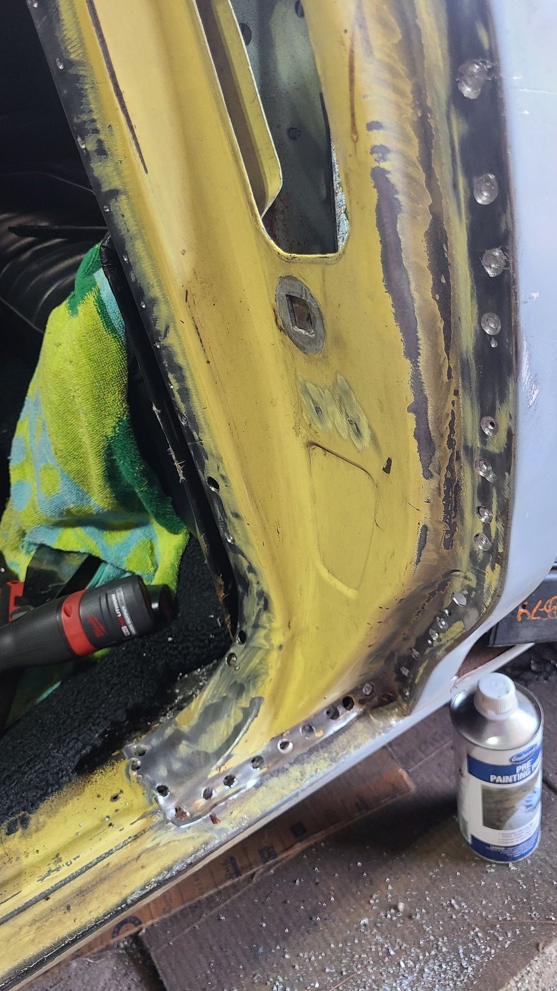

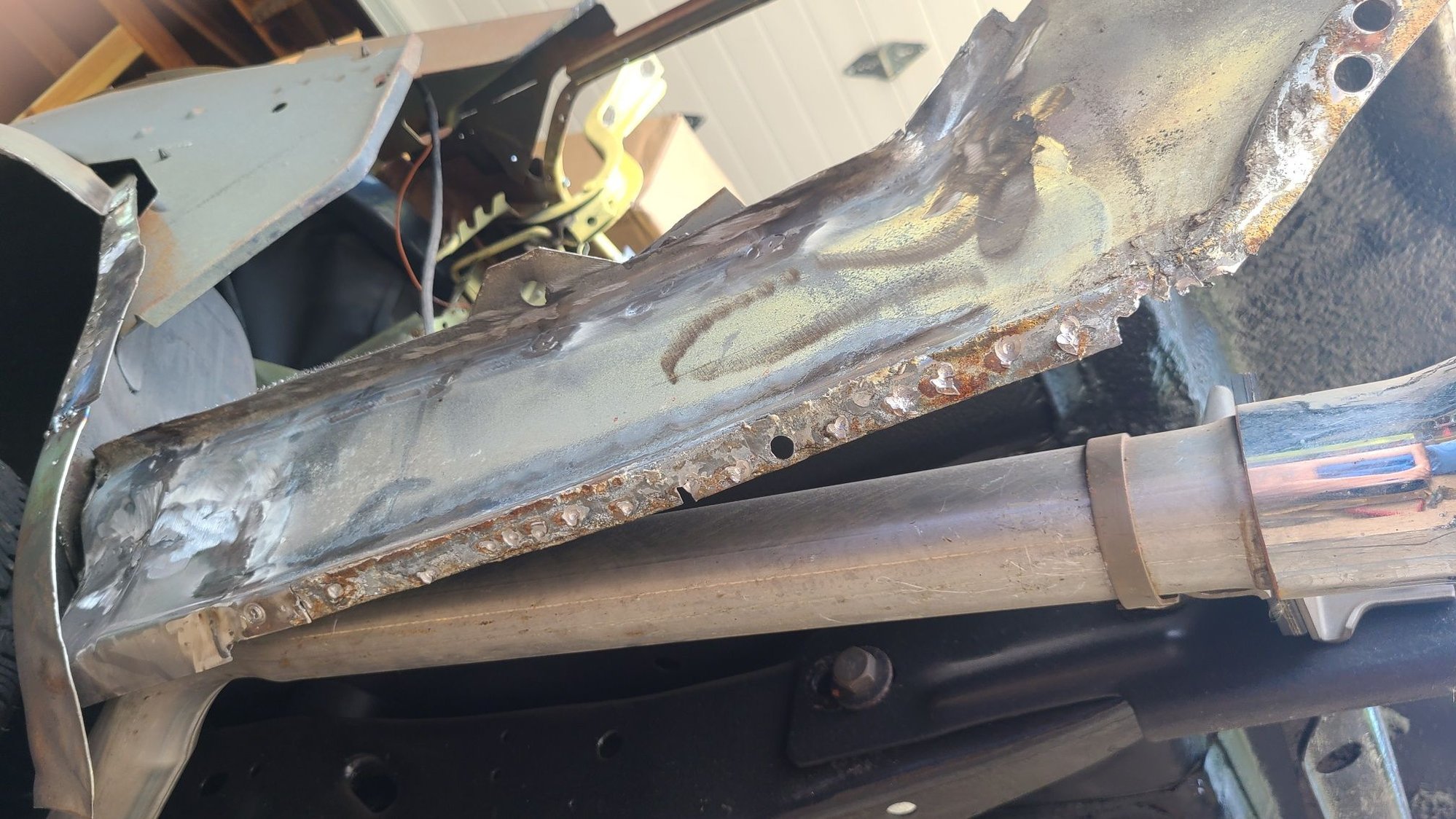

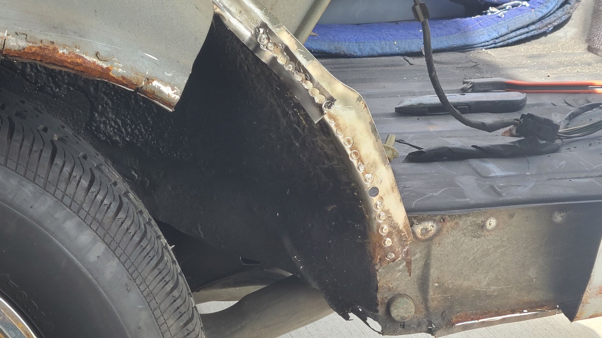

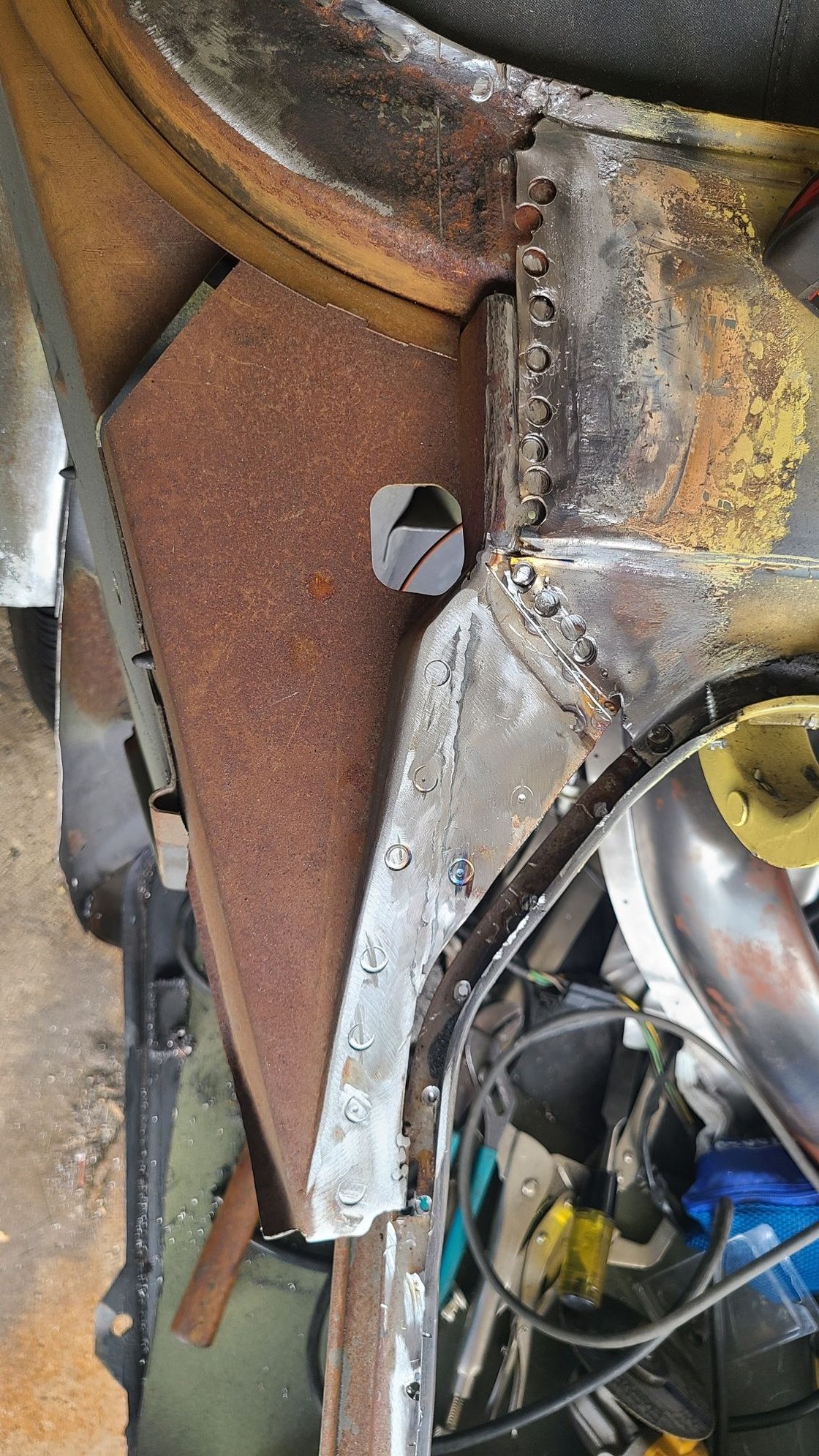

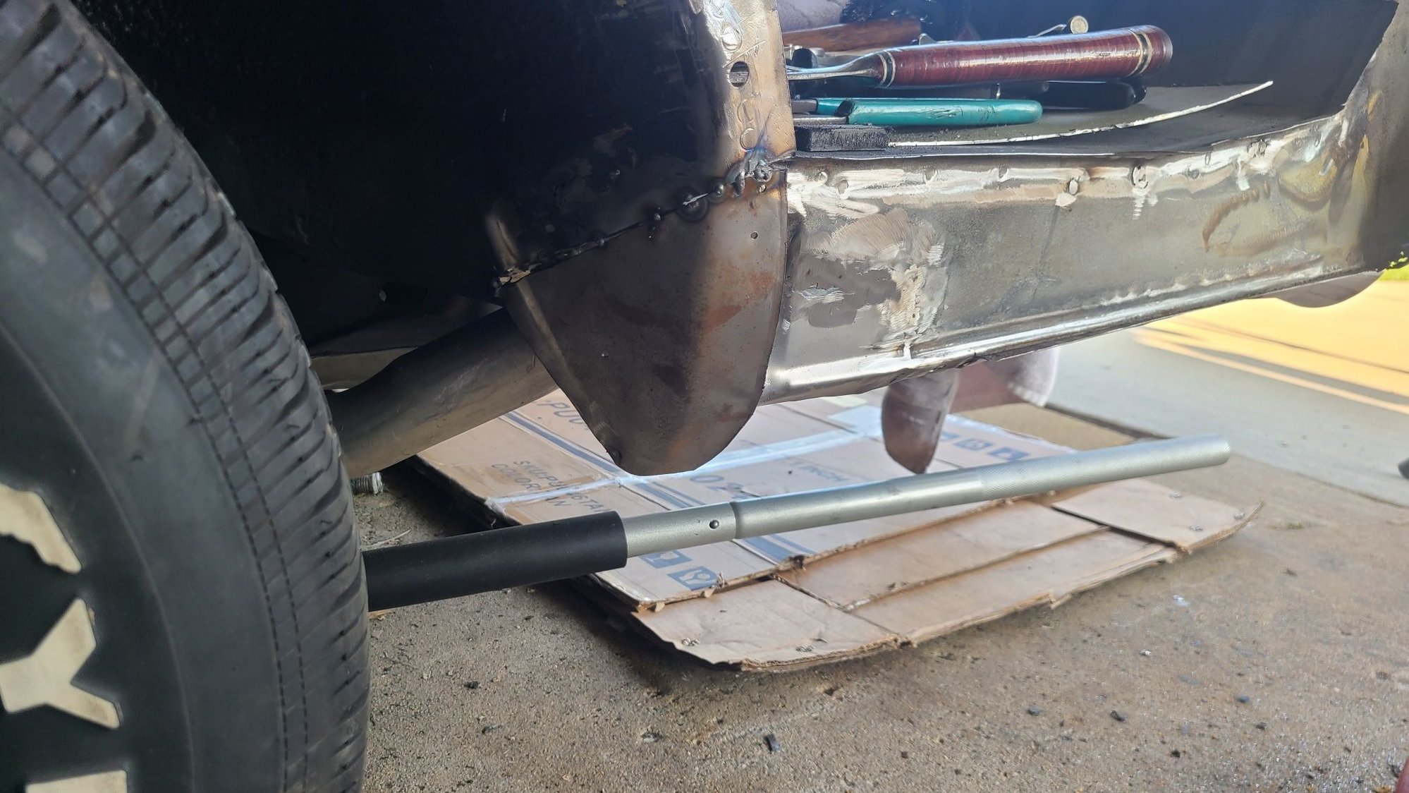

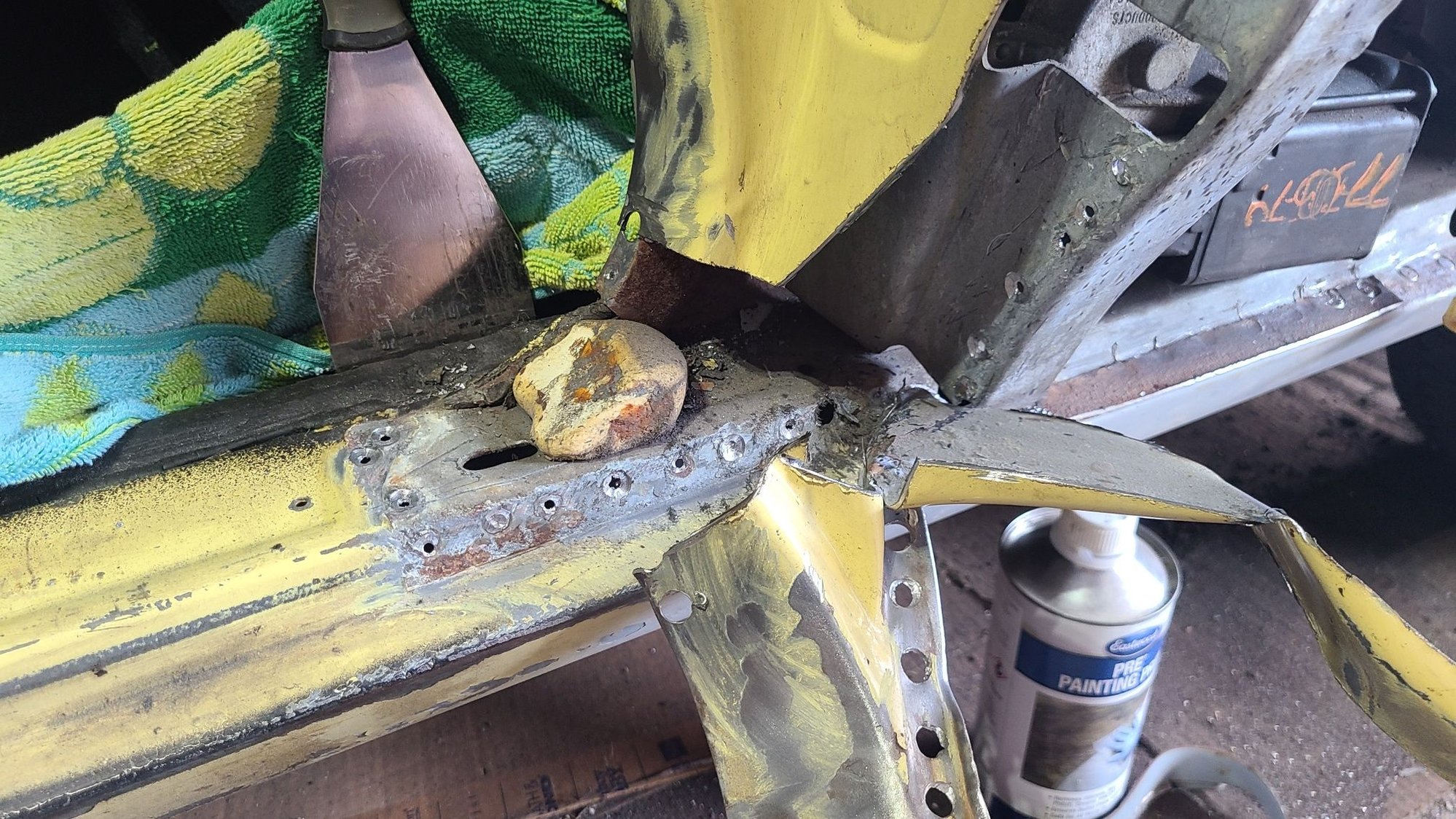

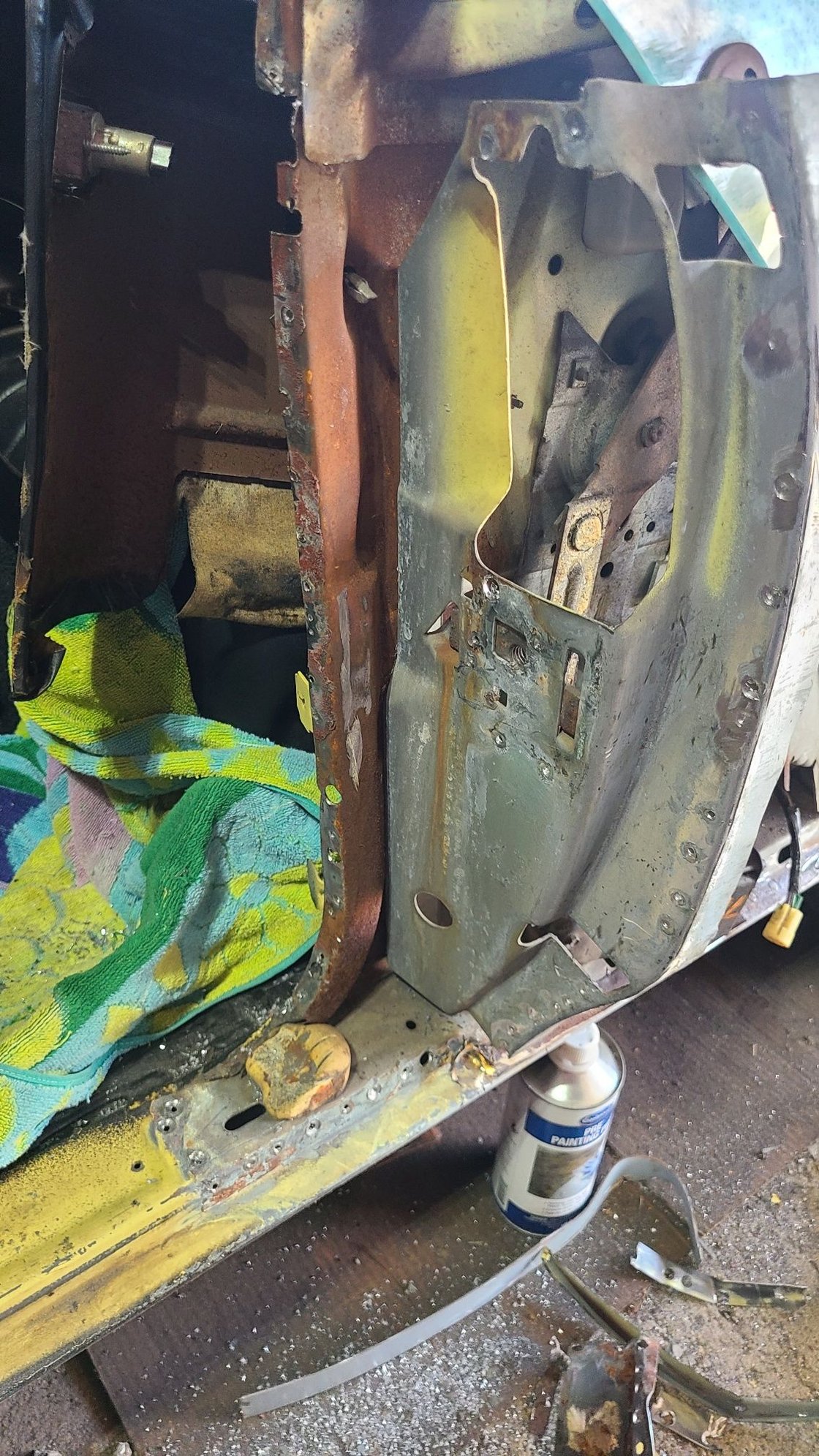

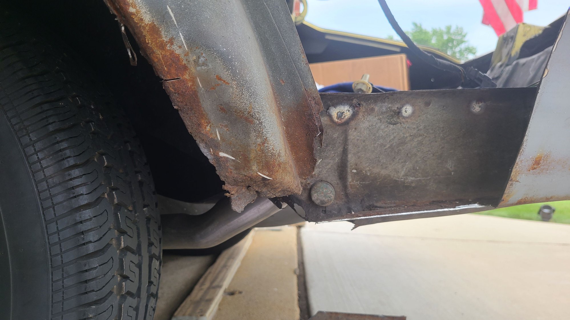

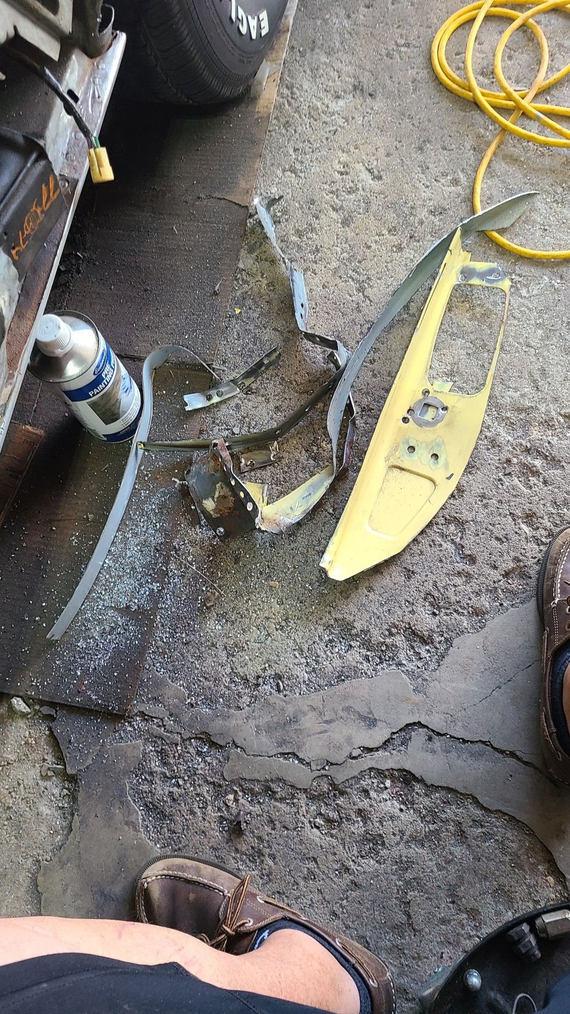

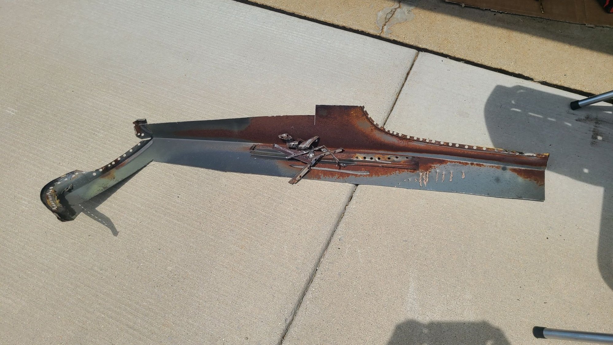

I finally have the drivers quarter off of the car,
all told it took me about 12 hours including cutting and fitting the inner and outer wheel well patch and drop off section.
here are some pictures of the removal of the door jamb area.

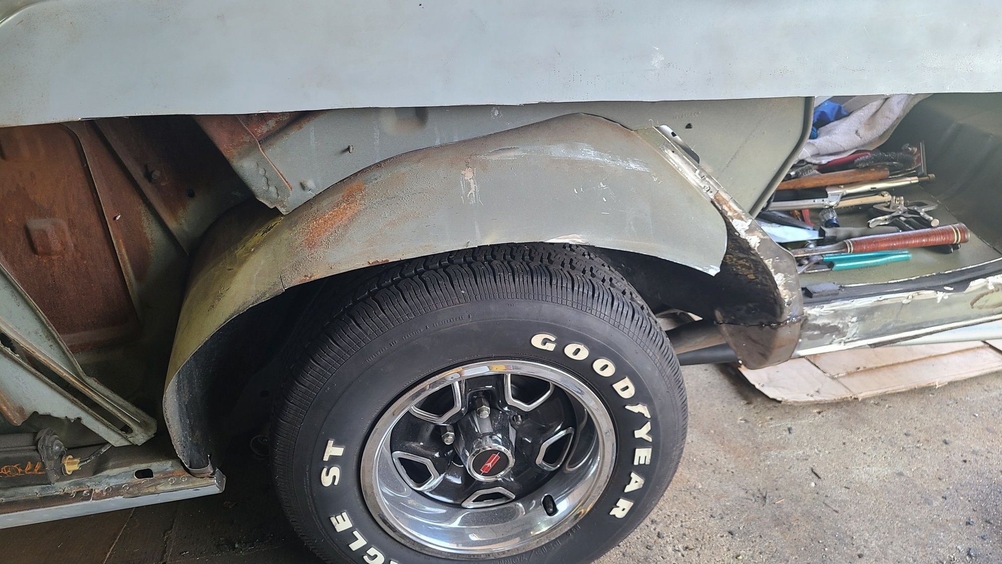

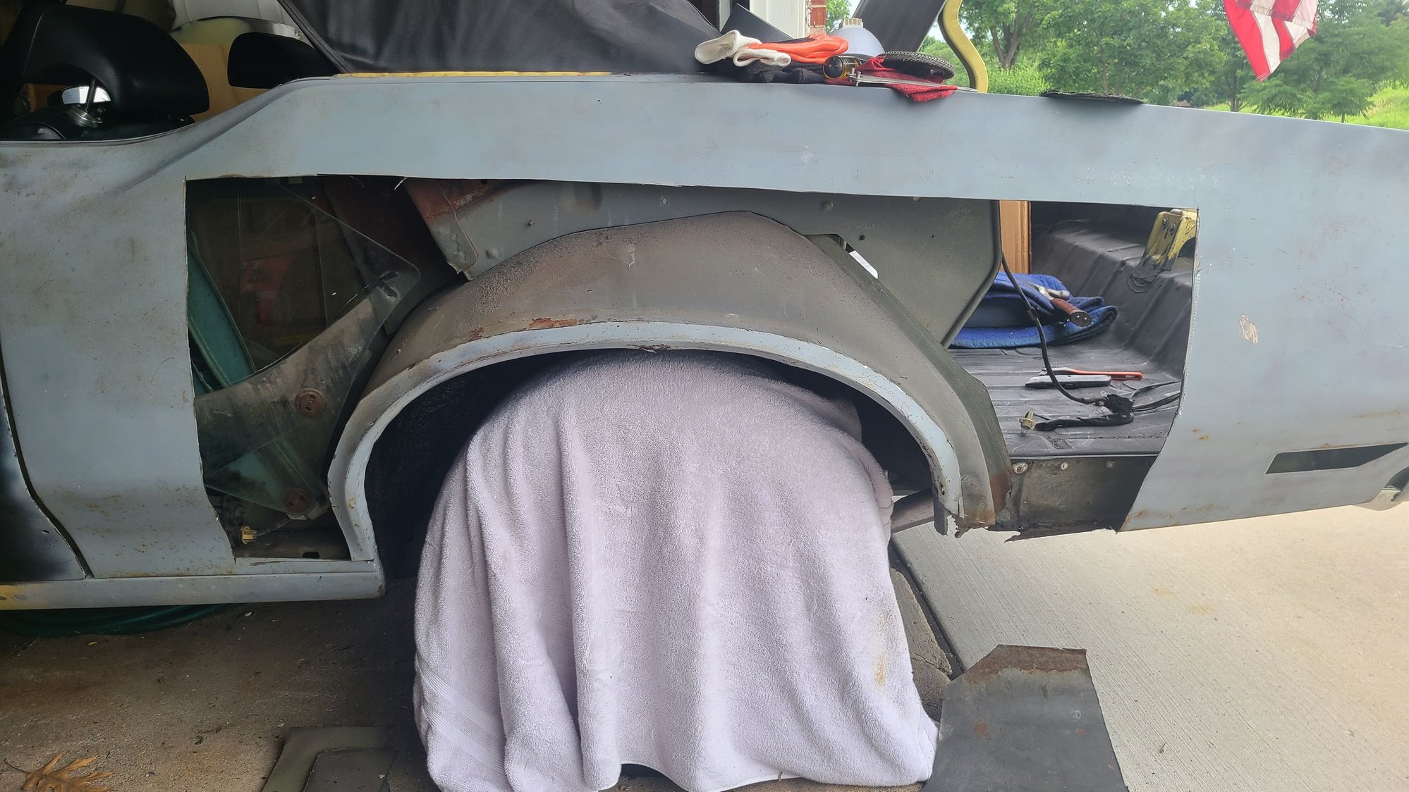

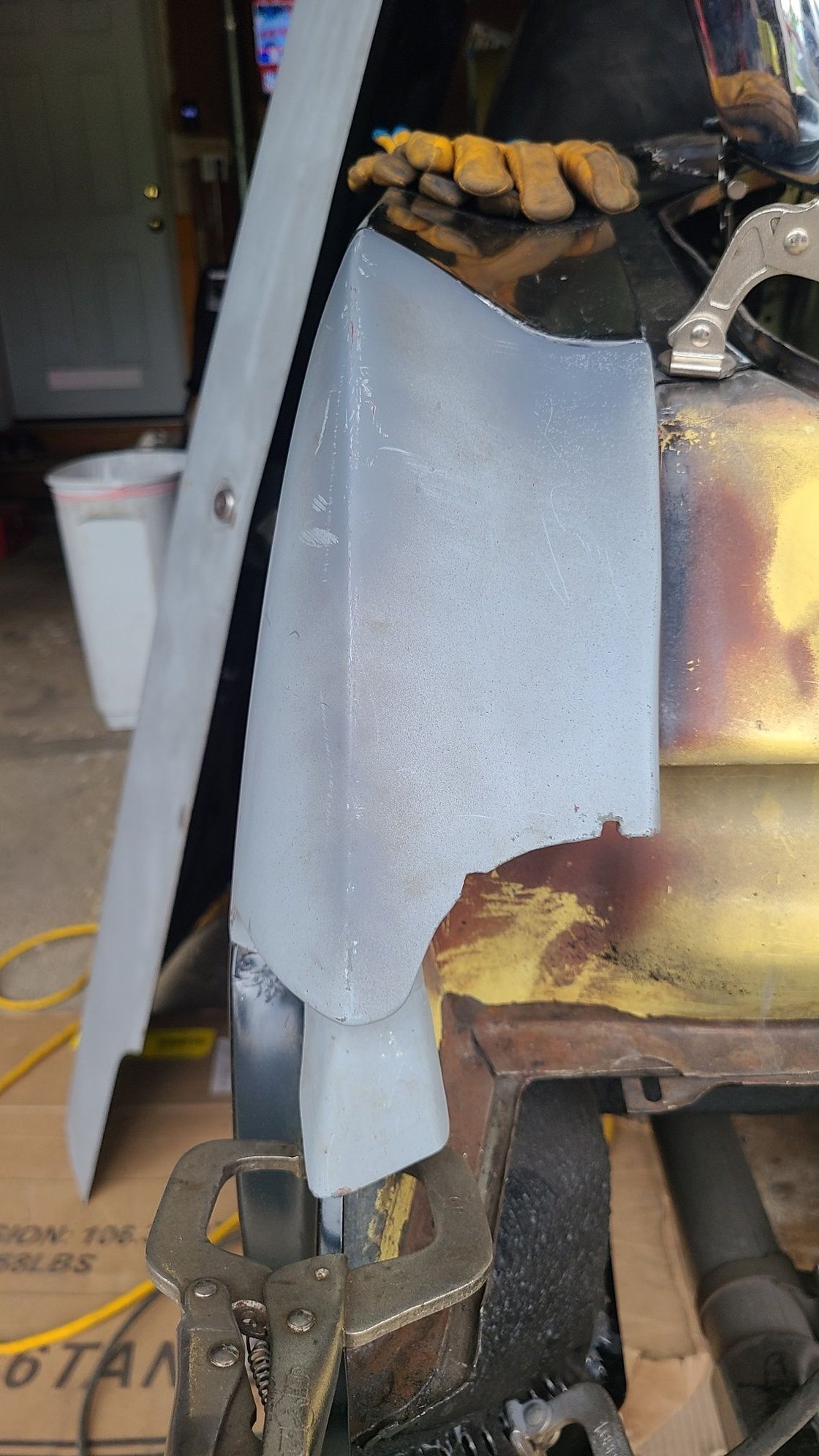

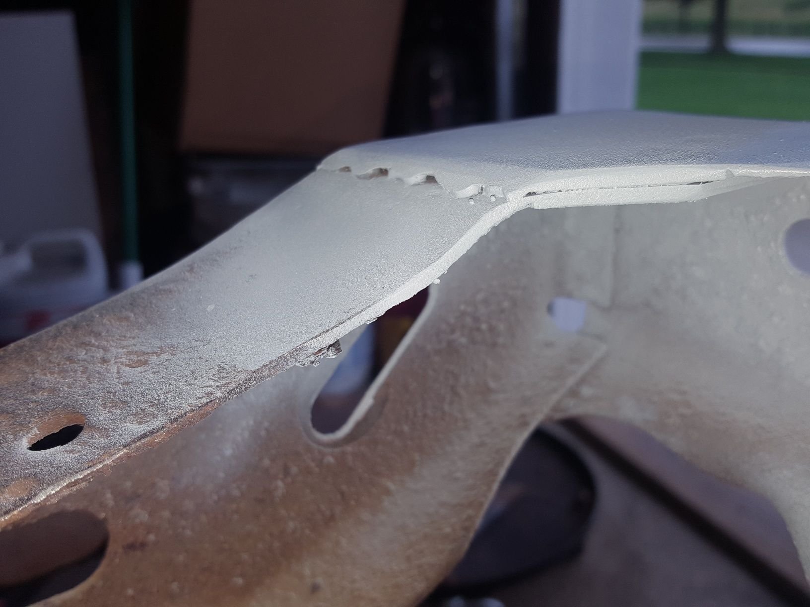

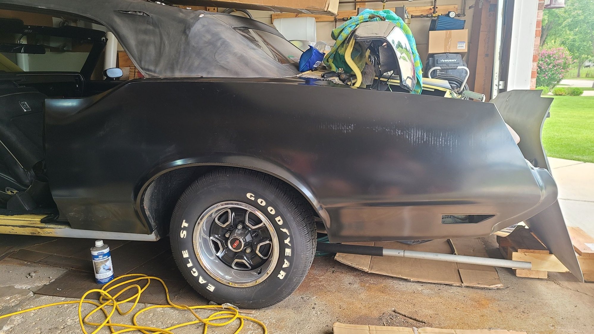

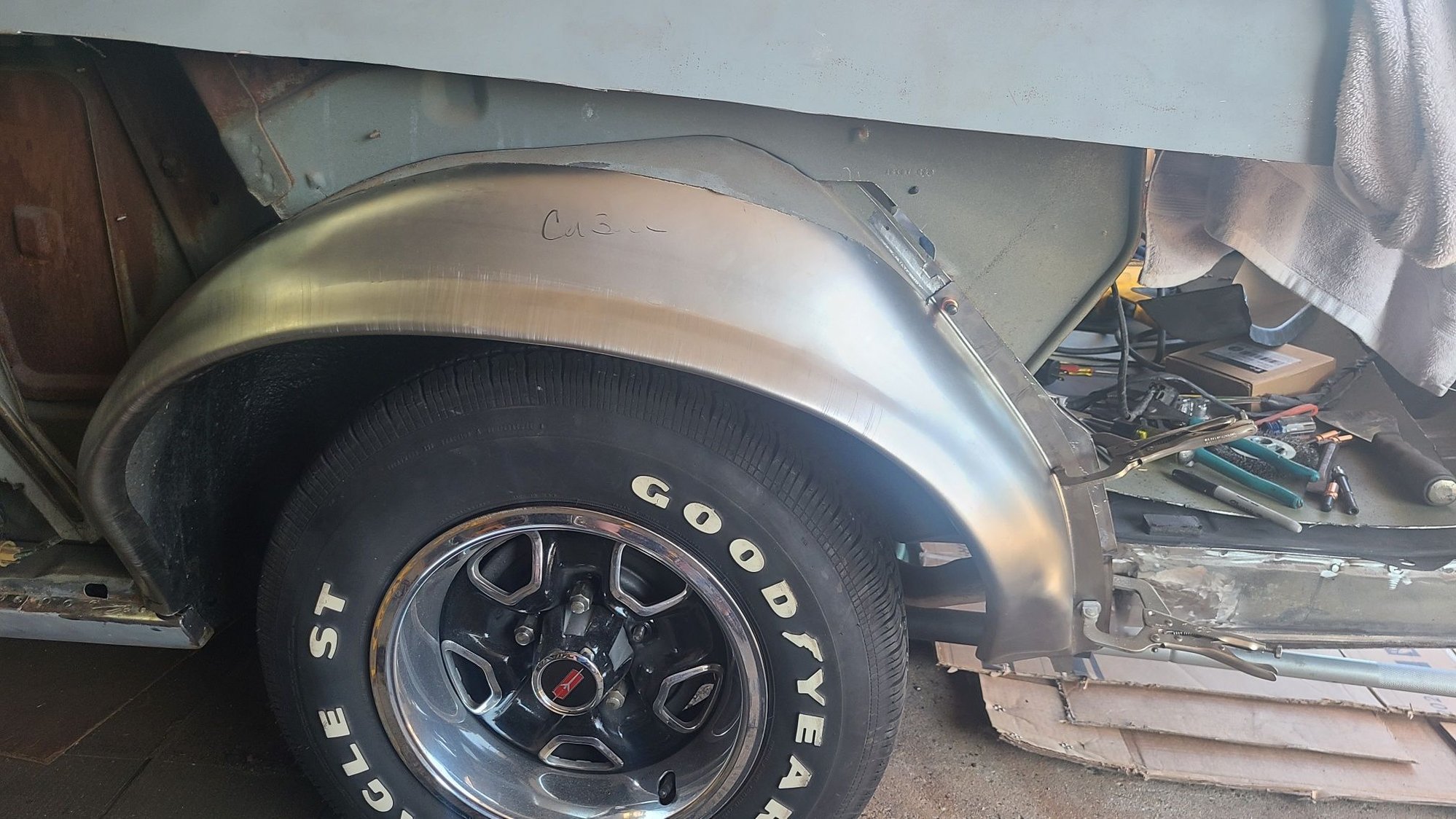

Quarter fitting
here is a picture of the driver's quarter first test fit
I started to do the final fit cut and welding of the outer wheel well patch.
pictures to come.
Old Jul 23, 2024 | 07:35 PM
Schne442's Avatar
Joined: Nov 2010
Posts: 438
From: NE, Illinois

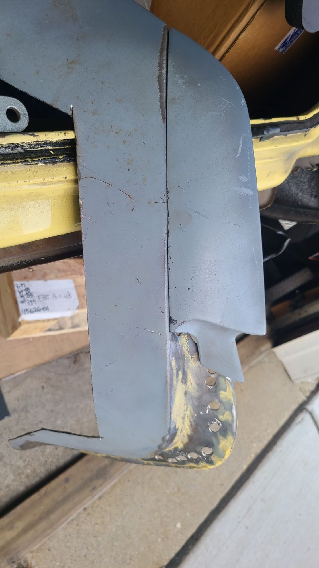

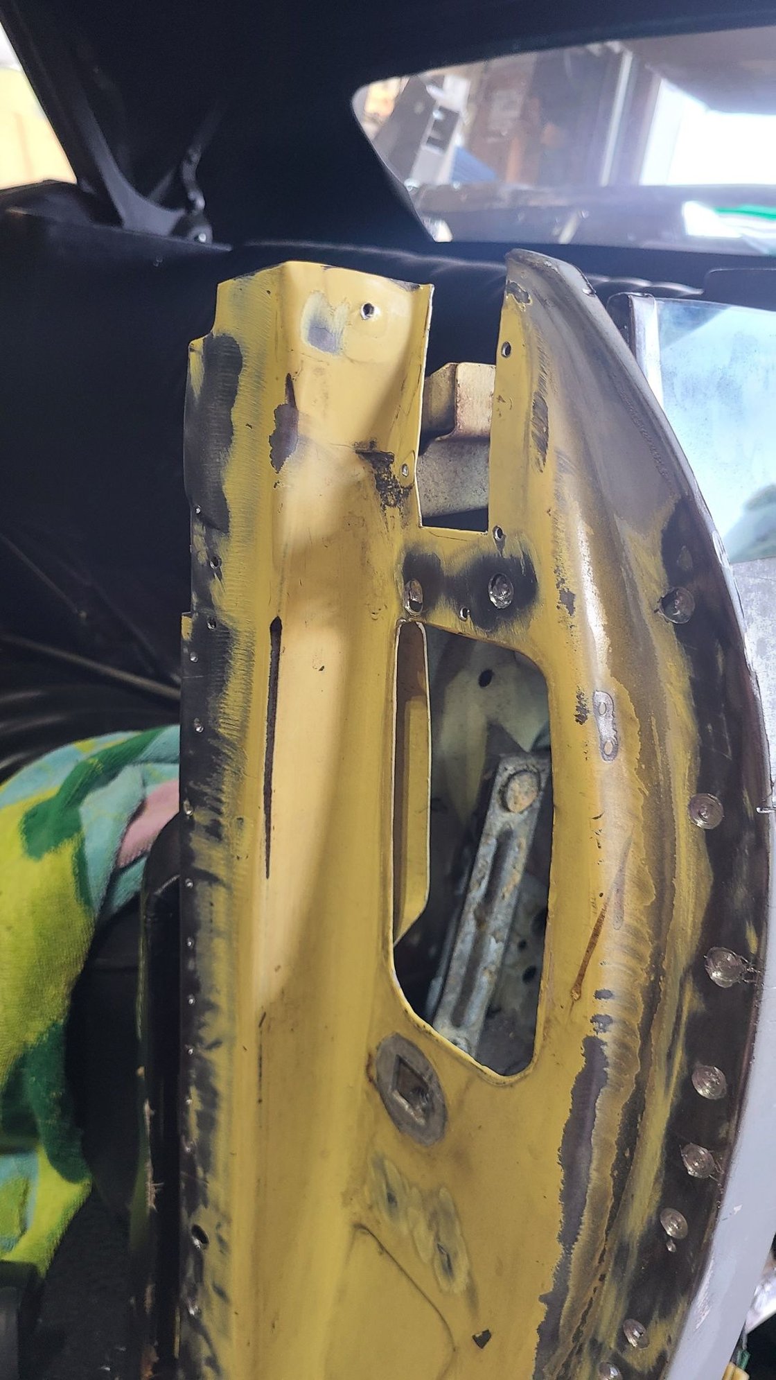

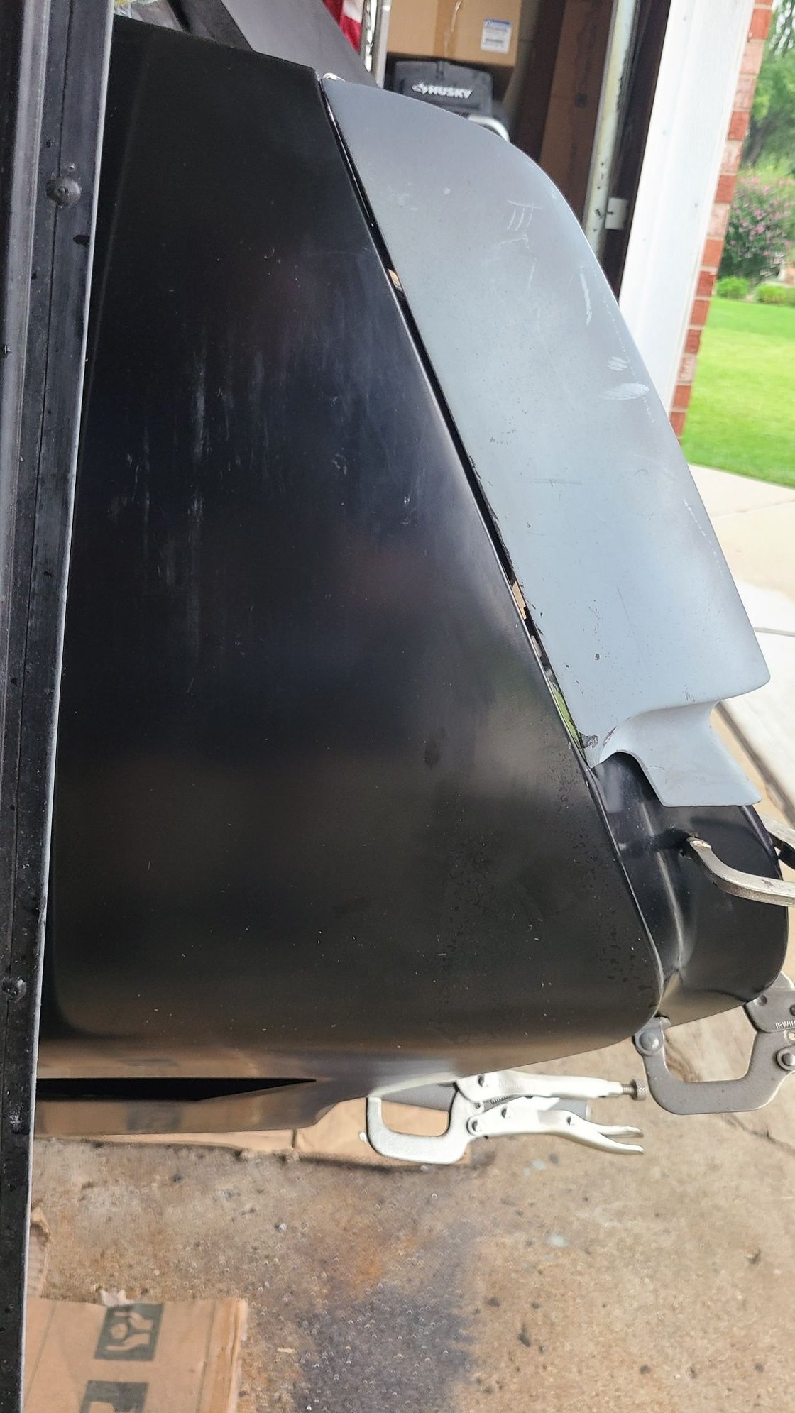

quarter end cap fitting
I installed the quarter end cap using the pre punched holes in the repro quarter, I'm thinking if I adjust the holes, I may be able to raise it up enough to fit the top body line.
I was hoping to use the end cap as a data point as the sub structure is still in place.
Has anyone installed repro quarters and fit the end cap without having to do major body work to make it look correct?
I'm thinking I will need to add some material to close up the gap
Old Jul 24, 2024 | 05:48 AM
Oldsguy's Avatar
Past Administrator
Joined: May 2004
Posts: 10,358
From: Rural Waxahachie Texas
I wonder why re-pop body parts fit poorly like that. Don't they use the original stamping dies or replicas?

This is why I asked if anyone has installed one of these re-pop quarters, I still have the rear section I cut off; I'm hoping I don't end up having to graft the old section back into the new quarter. The passenger side is a NOS one, I am hoping it fits better

Massaging, surgery and BFH
After a bit of fine tuning, I was able to get the end cap to fit as close to the original fit as I could.
Original fit on removed quarter.
After redrilling mounting holes, and massaging the quarter top contour with a piece of pipe and a BFH
