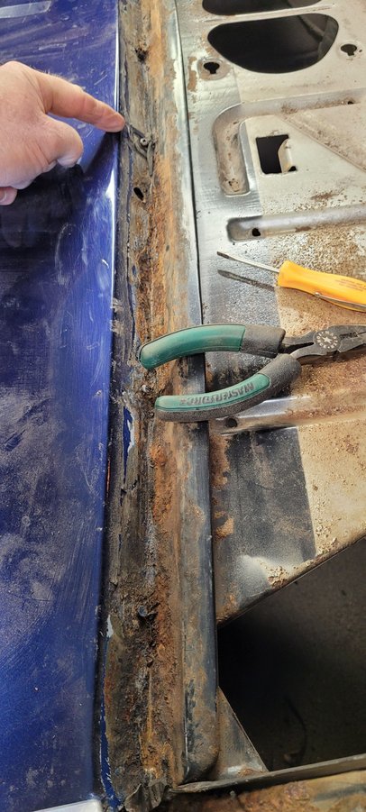

Here are 2 photos of the rear window frame.
Any suggestions on how to seal this hole?
Don't mind my finger pointing here, that's a just a reminder to myself that this is where the trim clip that gets screwed in belongs, so I don't weld it closed.
Old Mar 25, 2024 | 08:59 AM

Russ you say ( trim clip that gets screwed in ) . Are you saying some of the clip retainers are screws ? If yes then thats a red flag ,then there have been past issues . Joe P has mentioned in other threads do not use screws . Looks like the first picture is an original nail head pin . when you look at the metal trim the back side of the metal trim where the clip attaches has a curl . So looking at the back side of the trim, looks to me that the clip can be moved to another area where the metal is stronger. i think Joe P has said in other threads there is a way to weld in new nail head pins .
Seeing that you are into a big project , what about welding in a water drain fitting or tube ? part of the drain could be rubber hose in case to hit it while putting something into the truck.
I have a fox body car / hatch back the water sits / pools in the back window trim area , when i wash the car i use a leaf blower to get the water out . or at least put the hatch up so the water does not sit in the same place all the time . At car meet ups some car owners tell me they never wash their cars , to avoid rust in these areas .

I'm guessing that the clip that is held in by a screw was originally a nail head or maybe they needed an additional location to help secure the trim. I'm not 100% sure on the reason.
What do you mean by a water drain fitting? Could you show a photo? This sounds like a good idea. Thanks!

Only way to fix that correctly is cut out the rust area and weld in new metal. Obviously thee are temporary fixes like clean the rust jb weld a patch and a tad fiberglass filler, sand down etc.

Russ i do not have a picture . i read this idea on a thread , but not sure what forum that was , as i have other cars that are not Oldsmobile . The idea of a water drain for a back window i would think would be something like sun roof drain tubes . You are into a big rebuild project , so maybe weld in a drain fitting with a rubber hose . But you would need to drill a hole some where in the trunk to stick the rubber hose thru . This seems to be a design fault from the factory . Or maybe it was planned so we keep buying new cars !
I was thinking about the J-B weld route because at some point, I'm going to have the vinyl top replaced so this would be (hopefully) a good temp fix.

Water under the pinchweld is not the problem. It's the leaves, dirt, pine needles, bug carcasses, etc that turn into mulch. Once that gets wet, it molders. And FYI, any drain hole will be completely plugged by this stuff, so don't waste your time. The better method is to ensure that the pinchweld area is well protected by epoxy primer and quality paint, install the trim clips wet (with epoxy or sealer behind them) to cover the resulting scratches, and frequently blow and hose out the area to remove the mulch.
All great info, thanks Joe! Now that I own this car, it's parked in the garage. I like the idea of using a leaf blower or something similar to make sure to blow out any standing water around the windshield frame.
Old Mar 26, 2024 | 09:23 AM
Posts: 50,802
What you really want is a blow gun on an air compressor. The leaf blower will be high volume but low pressure. The narrow high pressure blow gun will get the leaves out.
