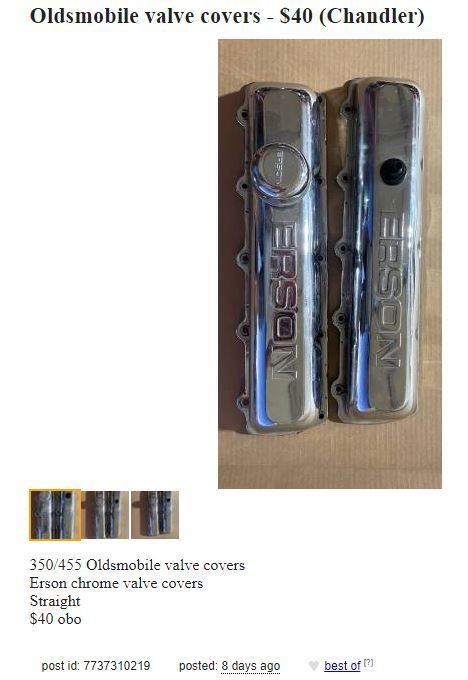

What valve covers are having the best fit?
Aluminum heads 455.
What has worked well for you guys?
Would prefer in chrome finish.
Thanks.

Posts: 15,395
I saw these on the local Craigslist:
https://phoenix.craigslist.org/evl/p...737310219.html
